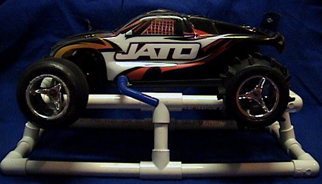

im not sure but you know how you can get that 4wd monster truck that you build over a number of weeks
well i started to buy that but found out that after 2 years it would add up to $1000
but the first thing you get is one wheel so i got 4 of em and they wherte only $2.50au each and they fit on my mini
so im thinking they might fit on the jato, but maby not

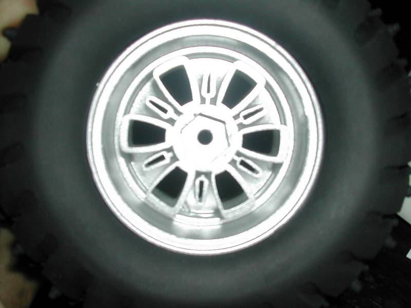

The wheel you must get for the Jato are ANY 2.2 Wheel that will fit the Nitro Rustler. the front and rear wheels are differnt. So make sure you get Rears for the rear and Fronts for the front. Differace is Rear is Hex drive, front has holes for 5x11x4 bearings. I would get Proline Edges for the front in the sand Also Panther makes a set front and rear's for 1/10 scale 2wd [link=http://www.pantherteam.com/index.php?main_page=product_info&products_id=233]Paddle tire set[/link] that look cool. I am not running any foam in my sand paws, I just taped them. They are a very stiff tire compare to the others i am running. Also you will have to either get this [link=http://www.neweramodels.com/item.cgi?part_id=2748]2.2 conversion[/link]or as I did just get 4 #10 washers from the local hardware store and put them on befor you mount the front wheels. So it will take up the slack since they are narrower hubs. The rears will rub for a sec. if you don't get the conversion kit but has not hurt anything on my Jato. I would get at least 3 glow plugs. i use McCoy 59's Also would get a Temp gun. It is the only way to tune you new ride correctly. You did not say anything about battery for the EZ start and a charger for that.

Old 12-07-2005 | 04:13 PM
CarTireDragbike's Avatar
Joined: Aug 2005
Posts: 290
From: Chesapeake, VA
Default RE: I need help fast
The proline ones work great. i think having the splits help a lot.
