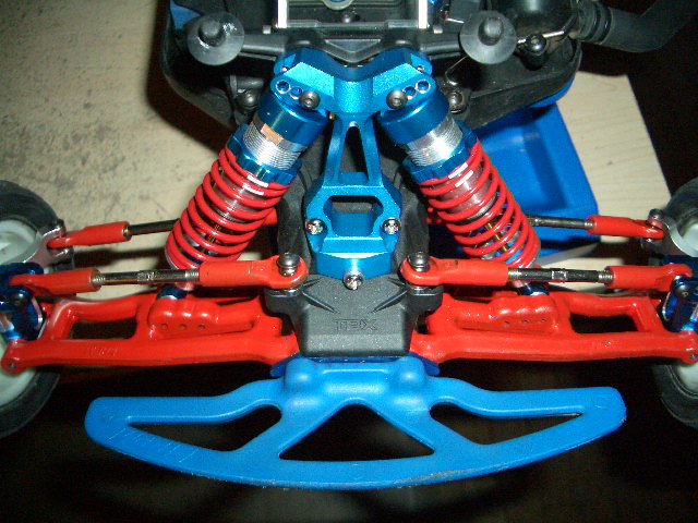

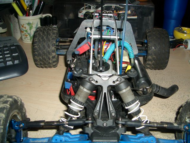

its not the oil its the springs, you can adjust the tension with the collar on the shocks, or change out the springs, some people use heaver shocks to prevent preload,preload is when you car bottoms out when you land a jump,soft springs means you dont bash manly for on road no off roading, play with the collar, it does make a difference,hears a pic of 2 different springs, the white ones r stock the red ones r revo

well i have the truck because i bought it from him so ill check but most likely ill just put the original shocks on because they just seem more smoother and it dont bounce up and down like that but ill see what can happen but thanks

Default RE: jato shocks
well last night i put the original shocks back on and i noticed it feels alot better its not so stiff or bouncy. the only things is the other shocks look alot better lol but im thinking if i put lower % shock oil and put some springs from the jato on it they might work alot better i tried the original springs on them they fir perfect they are just way to stiff and bouncy so i just put the originals on untill i find out what i want to do thanks
