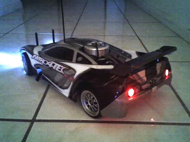

$14.99..run`s on a 9 volt

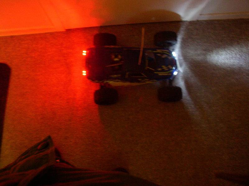

ok i hooked them up and everything was fine the lights worked the on off switched worked then my battery over heated and started to bubble up on the top.
Old 03-01-2007 | 10:10 PM
Joined: Jan 2007
Posts: 628
From: Hamiltonontario, CANADA
Default RE: L.E.D'S
ok got that fixed think i had a crossed wire when i was testing just didnt notice. So now i think it might be draining the battery i made a disconnec tpoint so im ok there but i would think the switch i got would shut it off. thx O.K.

Here's my led's

Old 03-05-2007 | 10:01 PM
Joined: Jan 2007
Posts: 628
Default RE: L.E.D'S
now i get the battery overheating when i turn the lights off does someone know what order i should have the wires on with a switch with three terminals and on - off
