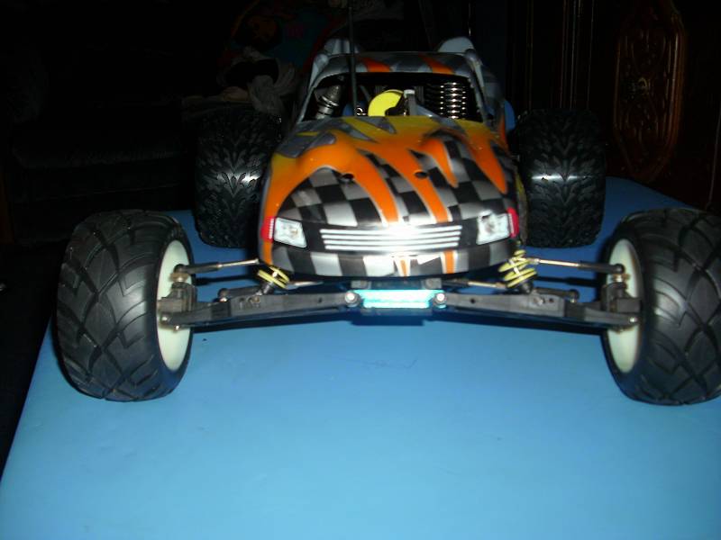

hi im new here and i have a nitro evader and i love the truck and i have some questions i was wondering if u guys gould help.
wen it is running some times it will die and the pull start wont pull ???
and how big is stock gass tank i went 2 the hobby shop and they sed my tank is not the stock tank and wont 2 know what tank it is but idk i bot the truck off ebay $80 it was used (pull problem is my folt dident do it wen i first got it)

here r pics of my evader with the bigger tank
