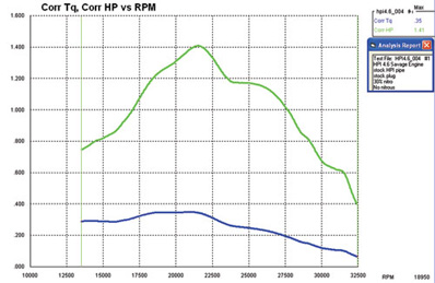

NITROUS EXPRESS SYSTEM just seen this on xrc check out link read for your self [link]http://www.rc411.com/pages/scopes.php?scope=28&page=2[/link] ok look at link before you say any thing lol ONE MORE THING LOOK AT THE REAL HP NUMBERS 1.75 HP not sum wild hp rating lol this was a hpi .28 motor

I dont think it's worth the money. I still done get how the extra fuel is getting to the engine to stop the lean condition that would occure when the nitrous is injected. They said nothing about that which seems a little odd to me. IDK maybe I missed it, but from what I have seen they didnt say anything about it, and if you have to adjust the needles manually then yoru engine will be as rich as Bill Gates and wont have anymore power until you reach 100% throttle. And only 8 seconds of power seem's way to short for the money that is spent. A better engine would be better, and I can almost guarantee you that you dont have the best engine out there. So you can always step up to a better engine and maybe do a little porting and stuff, but to each his own and if you want it go ahead and get it. But 8 seconds, nah thats just not for me.

From what I read about it, there's supposed to be a toggle switch near the throttle switch. When the servo hit's 100% throttle it then pushes the toggle switch over from the off to the on mod where it then gives appox 8 seconds worth of nitrous. 8 seconds is enough to do damage, as it will run lean which means not enough luberication. It doesnt matter weather it gains a whole lot of temp or not for the 8 seconds, there's a lack of luberication there which means some wear and tear will happen.
And when you really start to think about it, here's how it really works. The servo hit's 100% and flips the toggle switch. The nitrous goes off adding it's own oxygen but no extra fuel is added. Well when no fuel is added I dont see how it would add ANY extra power if the engine is already tuned for maximum performance, then it's already using all the fuel. So when you think about it there should be no extra power at all until you retune your engine as the nitrous is not flamable it just add's it's own oxygen when being injected. You need fuel to add the extra power, but no extra fuel is added so no extra power if you really think about it.
So you need the extra fuel to add power and with no extra fuel no extra power, just an overly lean condition. So do you want really crappy performance up until you hit 100% throttle and have awesome performance for those 8 seconds and then once again go back to an overly rich condition. Or would you rather have that performance all the time with just a new engine or a new pipe or something of the like. I know what I would pick for $200 and it wouldnt be the 8 second version of power.

and i post this for the few that want to read,, not fight and flame big words
ORIGINAL: dude7422
some people say it does not work well here is the proof it works it not perfect and needs more time to work out the bugs but last time i seen dynos dont lie
