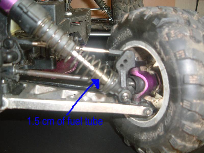

a bit off topic as it doesnt raise the ground clearance !! but i put some fuel tube around the suspention shafts which makes the suspention bottom out ,before the car hits the floor . this stops my car's chassi etc .from hitting the ground off big jumps !

great idea lewis i will try it
