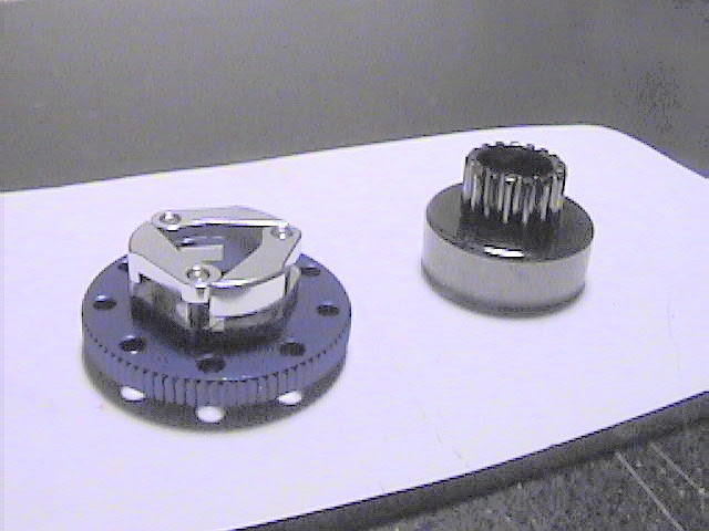

Mspeed-well i ended up at the hobby store today and while i was there i picked up a couple clutch/flywheel set up's for the jato and my revo.I also got a 17t cb and a 56t spur.I know about the wearing of the shoe and cb and i plan on being on top of it .I only bash and race my wife with a revo (she drives the jato) on a backyard oval track with about a 150 foot straight so it gets into second about 20 feet out of the corner.Just so you can understand some what the driving conditions.
So how often will this clutch need to be serviced?I run through about a gallon a week.

Its so hard to tell how long each alum. clutch set up will last, some are harder alum. grades than others. If I remember correctly, my savage alum set up lasted about 3 gallons max give or take. I dont remember, but I can tell you without a doubt my stock clutches in reverse direction last and last, I dont ever have to think about it being a problem. You might like the alum. shoes for performance, mine just didnt last. On my revo I did the same thing with the shoes, reverse them. They held up on a .32 axial big block with gearing all the way to 18 cb 36 spur. After I maxxed out the gearing to 20cb 34 spur the stocks couldnt hold it, so I went to my savage 3 shoe set up (not alum). It was amazing how much those stock shoes could hold up to after they were reversed. If they were not reversed the big block would just tear them a new one.

I am pretty sure the stock shoe's are ok but i want to try the alum 3 shoe so i know first hand the difference between the two.It is suposed to rain here for the next two day's so i have to wait.What will i notice with the 3 alum. shoe's?

Well, its so hard to judge cause of the different types on the market and as you know I am not a fan of them. I can only tell you what I have found from my limited experience with mine on the Savage X. I noticed a more stable idle. I guess they are lighter on the savage than the stock ones, just seemed to idle better, I did have a nice engagement, good control over it. Just over all they were a bit better in low speed engagment and performance at idle. They wore out way too fast for me and ate into the clutch bell. For racing I would consider them. If those are integy, I have heard bad and good things from them.

I got them at my lhs here is a link to them http://www.hobbyetc.com/cgi-bin/item.cgi?part_id=44321
They say the shoe's are 7075 time will tell.

The rain cleared this afternoon.My back yard track was a bit wet but the jato didn't mind.I am very happy with the clutch.It is a quicker transition from stop to go and comming out of the corner it dosen't bog any more it just shoots rooster tales.
