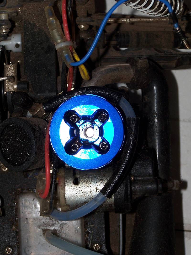

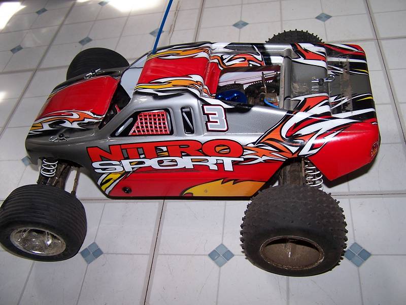

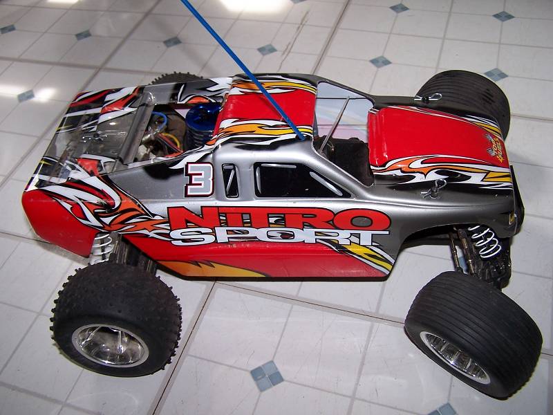

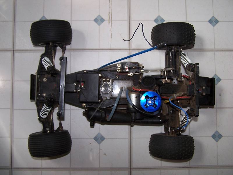

my nitro sport keeps over heating and cuts out at top speed
i cut out the whole wind shield to see if that would help but i ran out of gas so i cant test it to see if it helps

tune your engine back to factory setitngs then follow the tuning instructions shown here...
http://www.rcuniverse.com/forum/m_5517128/tm.htm
Tuning is hard and takes some practice.

Back your HSN out at least a half turn and try it [:-]
