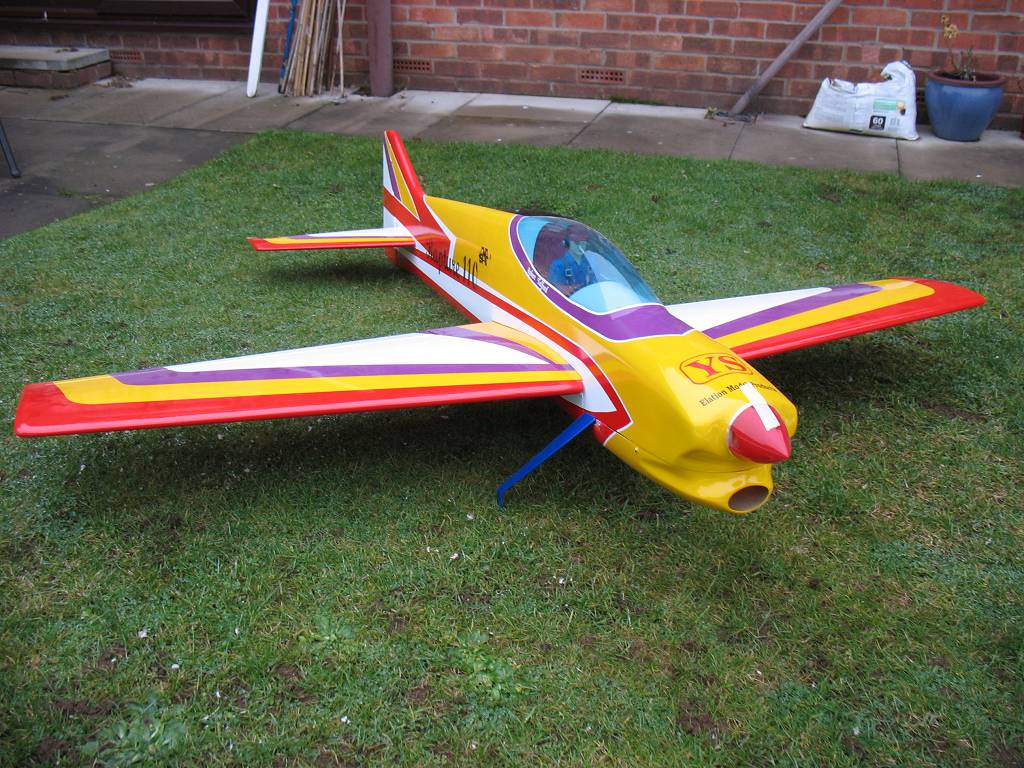

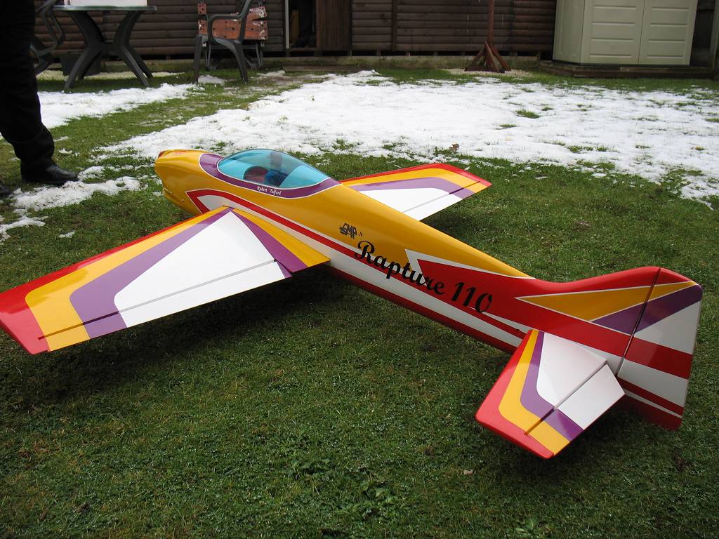

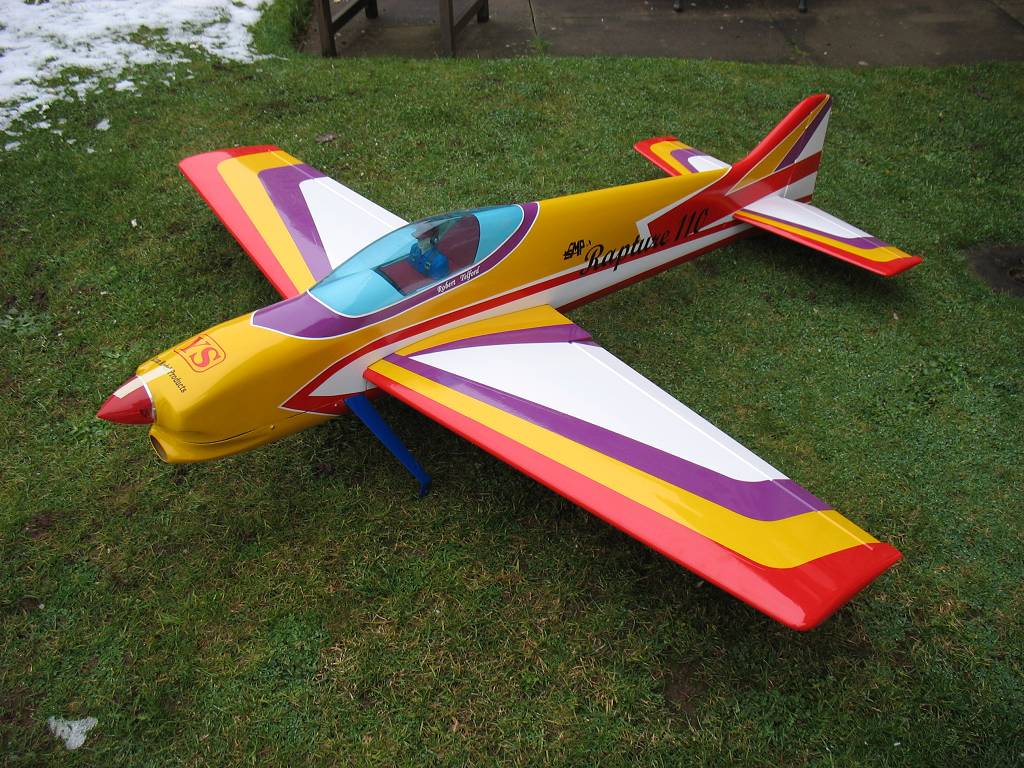

Crankpin, that is actually the model I'm flying my 110 in. Very nice indeed
I don't have a camera so don't have any shots of it complete. It's a bit draggier than my last airframe, I've found landing it a dodle so far.
Best part is you give him a colour scheme, and he makes you your personalised ARTF! Don't have to worry about oil getting under the covering either as the fus is painted...
