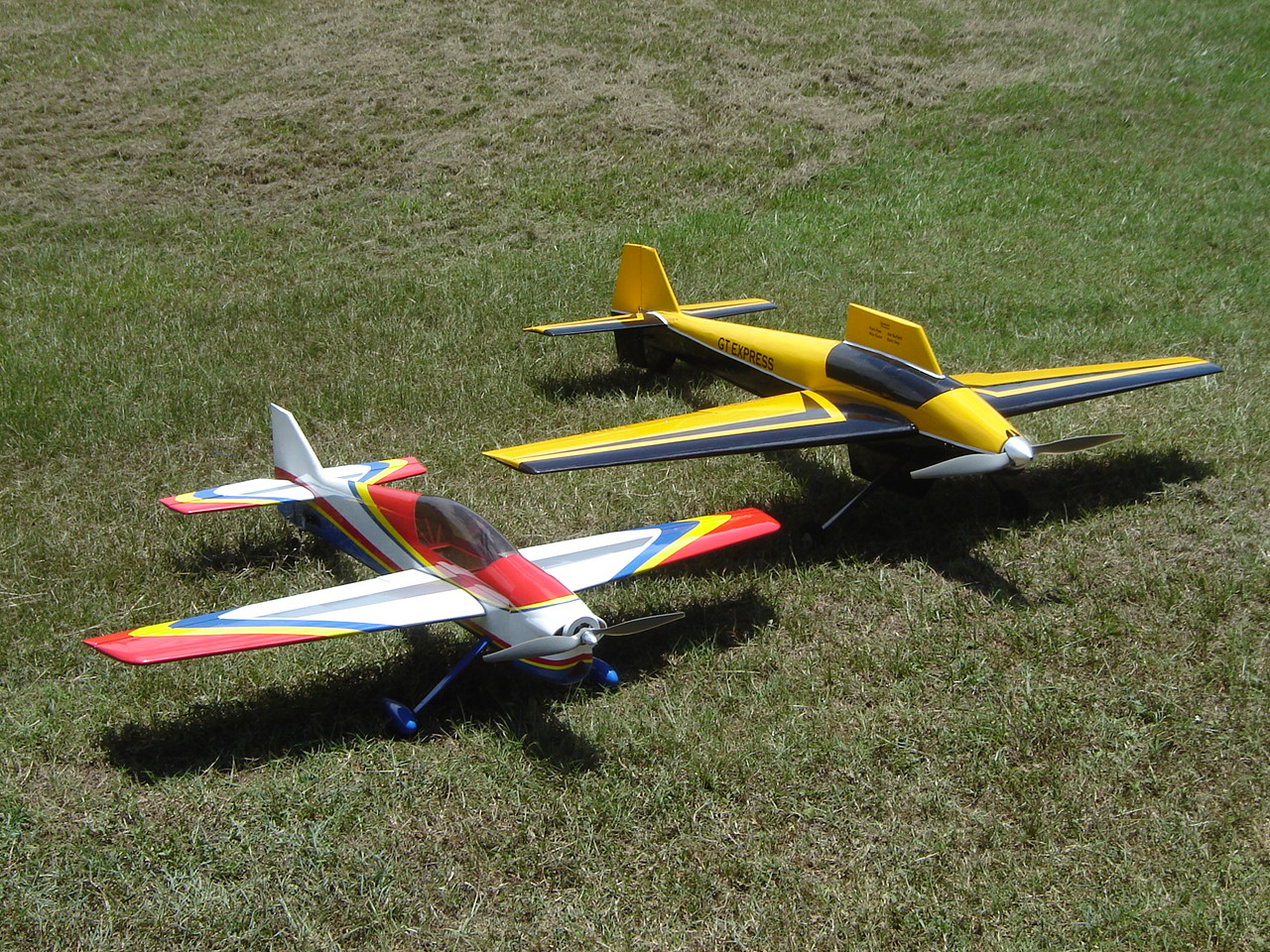

Here's a Voodoo Express I built this year from plans I got from Mark Hunt.

Old 12-12-2010 | 03:22 PM

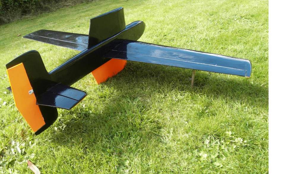

Here is mine:
The construction:
http://www.rcuniverse.com/forum/m_9749764/tm.htm
It's realy a nice pattern plane! In particular with the electric propulsion.

Thanks guys, this is most interesting. I'm keen on giving this a try.
I've got a modified Mirage (Cheetah) with canards etc, but all these mods are only horizotally orientated. Just shows one can learn always something new... even after 40 years.
Just a question - would you place these dorsal fins at the same cg point as the main wing or does it not matter too much?
Bundu

Yes the cg of the dorsal fins and the cg of the main wing are the same.
