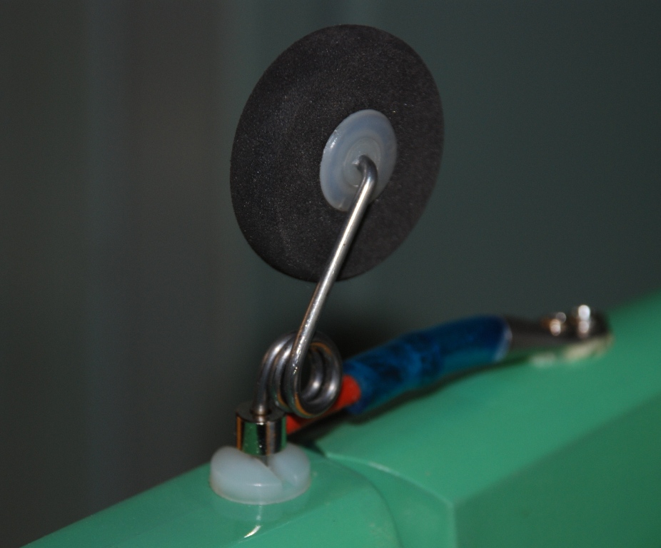

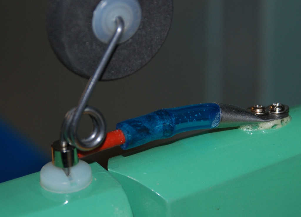

Tail wheel assy is super simple. I used a 1/4x20 nylon bolt about 1/2" long, drilled a central hole in it for the wire. A hole was drilled and tapped on the bottom of the fuse to accept the bolt, which was locktighted in place.
The tiller is something I've done for a long time too. The 4-40 bolt that secures the stop collar also as steering tiller. I add a short fuel line extension and secure onto the rudder with a cup fashioned from a 1/4" metal tubing. A pair of screws installed into short nyrod inner pieces in the rudder, complete the assy

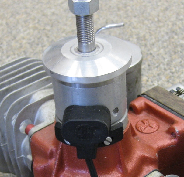

Something Shawn wrote triggered me to remove the hand cut spinner and run the engine without. I also reduced throttle throw to about half.....so now, full stick gives me barely 50% opening of the butterfly.....
The engine started immediately and fullstick gives me just about 5500 rpm, or about 1300 rpm off its real full throttle. The most important thing was that the engine was smoother without the hand cut spinner. Never did check balance on it but obviously, it has to be way off. Bob Obbenberger at Tru Turn is cutting me a custom light spinner.....
I need a wood 20x12 electric 3 blader to laminate for gas. The Mezjlik is a terrific prop but is a little heavy.

Hopefully there's enough hub area to allow 4 bolt holes....for the life of me I don't get the reason why gas engine makers insist on 4-6 bolts to mount a prop. Not necessary for anything up to 100cc

Matt, maybe use a couple G-10 disks larger then the current hub and then fill the voids between blades with an epoxy milled fiber and cabosil slurry followed by your lamination process. Hysol 9396 would be a great epoxy for this especially if you did a 150 degree post cure with 5 degree per min ramp rate. Just don't forget breather holes. I know I really didn't have to mention breathers with you, just the composites tech in me. Lol

Matt, I checked the stash of props today and in fact have 2 of the props on hand, so I will bring them to Pocono.
Looks as if there is a viable single-bolt solution, and you have some suggestions from those who know way more than I do. As they are, the unmodified hubs are quite delicate for a gasser application, but I know that you will figure out how to make it work.

Thanks for the suggestions Shawn. I doubt that there'd be any issue with prop modifications. When I see Bob's I'll know what needs to be done.
The biggest issue is weight savings. The Mezjlik prop weighs 156 grams. A modified e-prop could be built at 100 grams I believe. Having the prop work as well as the Mezjlik does will be the key......
