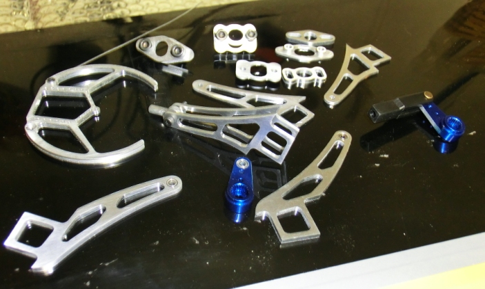

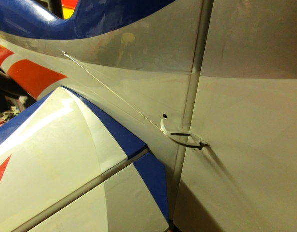

I machined a rudder pulley for my Wind 110 (along with horns and wing adjusters) using the H9 wheel up front. Very smooth operation and constant tension

Wow, Bill! Beautiful work!!
How did you secure them to the surfaces? Aeropoxy, Gorilla??

thanks for the compliments guys. I used 3M Scotchweld which bonds incredabley well to the aluminum and wood. Ken, I incorporated a hinge point into the pulley as ithas to be dead on center. any slack can let the wire jump out which could make for some excitement.
