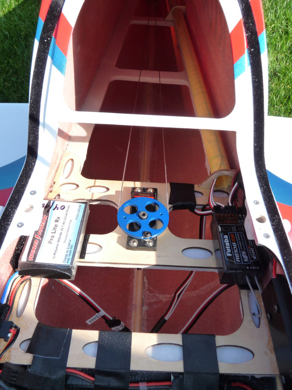

Hi,
Any idea where one can get a round rudder servo arm (futaba) similar to the one in the picture, which Wolfgang Matt appears to use in his planes? The round arm should result in a more linear movement of the rudder. Any comments or suggestions would be appreciated.
[img][/img]
[img][/img]

For JR/Airtronics
http://www.horizonhobby.com/products...-large-HAN3512
For Futaba
http://www.horizonhobby.com/products...-large-HAN3515
http://www.horizonhobby.com/webapp/w...pe=productgrid
They also make a version for Futaba.

Thank you, Ryan.
Don't know why I couldn't find them on the HH site...[
Thank you, Ryan.

@ Bob - I stopped using the wheel on the servo arm (and on the rudder) since I really didn't find a benefit in terms of actual flight performance. The wheels can be a bit pesky with respect to the cables jumping out of the grooves.
I use crossed cables...with or without the wheels.

In that case, it would be interesting to see the other end of Wolfgang Matt's "equation".
I suppose the only way to keep the tension the same in a pull-pull with a straight servo arm is if the connection points in the control surface horns were exactly the same distance apart as the servo arm connection points, and that the control horn connection points were lined up perfectly with the rudder hinge line. Which isn't very likely.

My experience has been that the most critical element for keeping equal cable tension throughout the throw is to have the connection point on the rudder exactly on the hinge line. For me, it doesn't seem to matter if the rudder connection points and the servo horn are the same distance apart (mine rarely are) as long as the connection point on the rudder is exactly on the hinge line. For example, the servo arm holes in play can be 2" apart while the rudder horn connection points are 1 - 7/8" apart. As long as the rudder horn holes are exactly centered on the hinge line, the cable tension will remain the same throughout the throw. Hope this helps.

On the rudder side Wolfgang uses a very traditional rudder horn that puts the connection point close to the rudder hinge line. A question to those that have used this setup (pull pull wheel on the rudder servo and normal rudder horn close to the rudder hinge line), do you get cables slacking and tensioning at the extremes of rudder reflection?
I have used the traditional approach (normal rudder servo arm) with the rudder horn on the rudder hinge line with good results. I agree that the servo and rudder horn lengths don't need to be the same. The pull pull wheel should however require smaller rudder wire exit holes in the fuze and less expo on the Tx. I however don't want to go the pull pull wheel route if it results in significant cable slacking/tensioning.

My question is, if you choose to use the 45mm pull-pull wheel on the servo, what would be a good width to use on the rudder control horn? Is there a ratio that would work consistently from 2m plane to 2m plane (I've always used a starting point like approx 1:1 and adjusted the length of the rudder control horn/clevis from the surface to get the desired feel)? I'm like Clint, I want to avoid any possibility of slack being created. BTW, Ryan, I called Horizon yesterday and was told by the phone rep that the above pull-pull wheel was only 35mm. Thanks, Everette

It's been a few years since I used a pull-pull wheel but never had a problem when I did. The wheel, like a conventional servo arm is going to have equal throw in both directions (if the right side goes forward 1", the left side will go rearward 1"). The trick in all of this is to make sure the pivot point back at the rudder is exactly on the center of the rudder hinge line which is the pivot point of the rudder. If the connection points on the rudder horn are offset from the hinge line, you'll have unequal rotational movement of those points. That's when you get cables that tighten on one side while going slack on the other. You've got a rudder arm or wheel that's moving equally in both directions on the servo end and connection points on the rudder that aren't moving equally because they're offset from the pivot point of the rudder which is the hinge line of the rudder.
Finding horns that will put the connection point on the hinge line can be difficult. Most of the ones I've seen don't project the attachment point far enough forward of the mounting base of the horn. By the time you sand the bevel into the leading edge of the rudder, there's nothing left to screw the base of the horn to while still keeping the attachment point on the rudder hingeline. I designed some horns a few years ago that projects the attachment point 3/8" forward of the front of the base to take care of that. They were machined by Geoff Combs (former F3A pilot) at his rapid prototype shop in Ohio and are still available for sale. I use the shortest ones for the rudder, but all three sizes are designed to be interchangeable with the pivot points 3/8" forward of the front of the base. I'm not sponsored by Geoff and don't receive any royalties. I was happy just having a nice set of horns available that would take care of the problem. Here's his website with a direct link to the horns: http://www.aerosportproducts.com/rclinkage.htm
