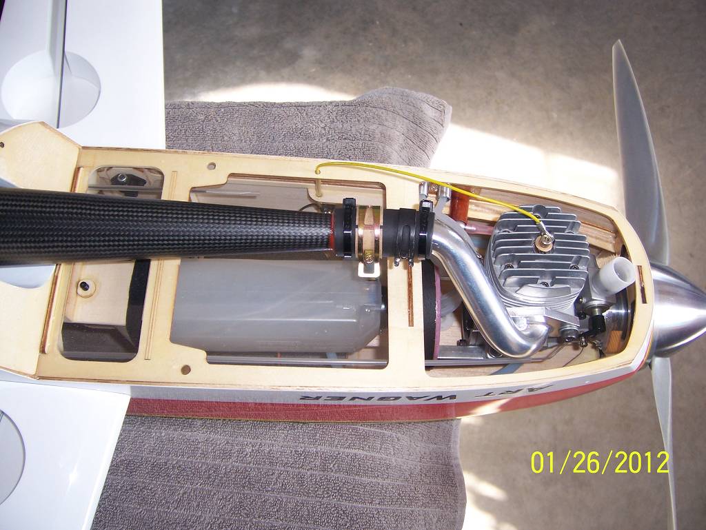

Art Wagner in the North Dallas area has been flying FAI competitively for years with an OS160/bladder tank setup. You can ask anyone who has seen him fly, he does not lack for power with this setup. BTW, he has OS headers available for sale.

I will pass on your comment to Art
He does exceptional work. All paint - 10lbs.7oz. And yes, those are retracts. He uses a piece of viton tubing to join his pipe to the header.

Default RE: OS 1.60 for a 2x2
What pipe is he running? And what pipe length (plug to first baffle)?
Thanks!
Excellent craftsmanship, by the way
