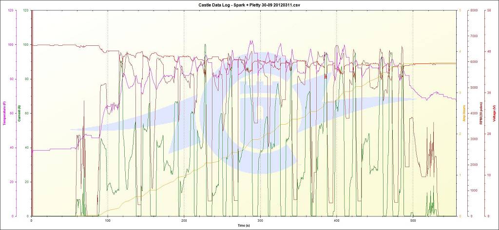

Am I going to toast my Ice2 80HV with brief peaks of 100-amp load??
We finally got some flyable weather today - albeit with 15-20 mph dead cross winds - and a chance to test some different props with the Pletty Xtra 30-09 V2 and the Ice2 80HV.
This motor is known for high amp draw, which I also saw in the CC data logs for mine when running even the less steeply pitched PT 20x13, which was peaking at 100 amps. I tested a couple more props today and was hoping to get some useful info from the data logger, and I assumed incorrectly that the data logger simply overwrites the old data, which it does not. So a bit of wasted effort there and no new info about amp draw with the other props, a Falcon 20x13 and a PT 20x12.
Although the amp draw has some high peaks, the temperature of the ESC is barely warm, the motor is only warm (maybe 120degF on the hottest area on the back of the case) and the batteries barely warm, so it doesn't seem that anything is being stressed at all. It behaves like a "happy" set-up, you might say.

Hi Bob, without knowing alot about your set-up, I'd say you are right on the edge of over-amping your ESC/motor combination. I've heard the figure of 20% (over and above their posted rating) bantered around that most esc's have supposedly built into them. Does than mean you can go out and safely run/peak your set-up at approx 96 amps+ day after day? I doubt it! I can't speak for nor will I try to speak for any of these manufacturers. The ESC business is a very competitive and the manufacturers are reluctant to discuss much other than their basic ratings. Yes, I do run Castle Esc's and have been happy with the new V2 controllers but I also run Spin Jeti's (77 and 99). I know the consequences of over-amping and try my best to avoid it by the careful selection of motors, Esc's, props and believe it or not, the AUW weight of the planes I build. Keep in mind, everything has it's limitations and these manufacturers know what they are looking at in over-amp situations. After all they built and tested these Esc's. I guess what I'm trying to say is "you can't send a boy out to do a man's job"! Hope this helps, Everette

I guess I am confused (and doubtful) about the data I am getting, which does not seem to correlate with the observed effects.
Which is to say, if I'm pushing it that hard - on the ragged edge of smoking it - why is NOTHING getting anywhere near hot? I read about guys routinely running ESCs around 140-180 degrees, and this one has thus far registered a peak of 109 degrees and averages way below that! Similar findings with the motor and batteries... There seems to be a bit of anomaly with the data.
One bit of 'clean' data I will manage to get is actual mAh comsumption when I recharge the batteries. I made it a point on the last few flights with various props to take off, fly the sequence and then land promptly as if flying a contest round, so that data will be good.
I am inching my way toward getting it right and plan to record 3 good flights next time with 5hz data sampling with the 3 different props, Pt 20x12 and 20x13, and the Falcon 20x13.
Below is a log from the first day of flying with the Pletty (not from yesterday) to give some idea. Poor throttle management, but at least it shows the peaks.

HI Bob, perhaps you are going to experience even higher temp readings as we get later into the season. What was the air temp and humidity levels when you flew your Spark? The point I'm trying to make is if the temp readings are this high now and the summer season of pattern flying is coming, what can you expect? Just so you know, I document every flight including, duration, post flight voltage, milliamps restored following charging, length of charge time, post-flight pack temp, IR reading at end of charge cycle and post-flight motor temp. I do this because of what happened during the time I was transitioning from glow to electric 6 years ago. My mistake was to listen to people who "thought" they knew about electric flight, etc. It proved to be an expensive mistake. Basically, if possible, I leave nothing to chance. Over a period of time you can actually see the trend of the batteries as the age and slowly become unsuitable for my needs.
I am aware you can experience high amps with the Pletty Xtra 30-9 if you are not diligent. Personally, I don't use or trust the on board data log system. I guess it's OK if all you want is a "snap-shot". Now, if someone comes up with a true data log system that say stores the last 10-12 flights, I'd be excited about that. Bob, I know you know what your are doing. Just don't expect too much from this Pletty/esc/prop combination. Then and only then you run the risk of "smoking it"! Hope this helps you, Everette

The first day of flying (for the displayed log) it was cool outside, starting at 26F and rising to about 42F later.
However, yesterday it was 64F for the last few flights and the same component temps were observed. Maybe when it's 85F I'll start to notice some difference. The model does, however, have very good ventilation, with the spinner nose lopped off and an air scoop for the motor, and the ESC and batteries with very good airflow over them.
I love the power of this motor so if necessary I will get a 120HV when they become available.

Bob.....I think your graph looks pretty normal except for that one current spike to 100A at 230 seconds.
It would be nice if CC had an option for overwriting data on the logger! And maybe time/date stamp!!
Next time, the laptop goes to the field with me.
With a whopping total of 10 e-flights under my belt now, I can relate to your need to manage the logging buffer contents more easily. The feature that you want to ask them for isa circular buffer with time stamps at the start and end of a session, or at least with a unique session ID to discern what you have left in the buffer. A circular buffer simply wraps around when it becomes full and startsoverwritingthe oldest data, so you always have the most recent data that will fit the buffer memory that is available. A snake eating it's tail, if you will. The other handy thing would be an LED code/beep code to tell you that you're approaching, or are already into a wrap around condition, thus alerting you to grabthe datafrom the controller before you lose thehistory that you may want.

With a whopping total of 10 e-flights under my belt now, I can relate to your need to manage the logging buffer contents more easily. The feature that you want to ask them for is a circular buffer with time stamps at the start and end of a session, or at least with a unique session ID to discern what you have left in the buffer. A circular buffer simply wraps around when it becomes full and starts overwriting the oldest data, so you always have the most recent data that will fit the buffer memory that is available. A snake eating it's tail, if you will. The other handy thing would be an LED code/beep code to tell you that you're approaching, or are already into a wrap around condition, thus alerting you to grab the data from the controller before you lose the history that you may want.
More of a "Don't you wish they would also..." kind of musing. And while I'm musing about "Why don't they...?" kinds of things, it would also be nice if the Data Connect circuit (the one that lets you download ESC data logging without unplugging the ESC signal wire from the receiver) was also contained on the ESC circuit board instead of an add-on, in-line accessory which introduces more weight and another point of failure. I'm sure that's on CC's to-do list.
OK, so what model and electrical bits are you flying? Enquiring minds want to know!
