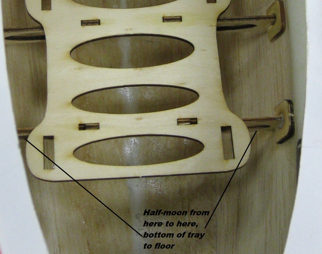

Excellent point! Nothing will tell you the condition of your battery as the internal resistance reading. It also will help determine if your "genuine 30C" pack is really such or is just a repackaged 20C or 25C which does happen more then we realize. Comparing IR numbers is not easy unless you are using the same charger or IR meter as the means of testing IR are not the same from manufacturer to manufacturer. With most people now using Celllpro chargers, a good 25C pack should be about 2.5-3.5 and a good 35C pack about 1.2-2.2. Keeping track of the IR numbers will help you see a cell going bad way before it actually becomes too weak.
I've done a couple of things on my planes to help keep the air flowing around the batteries. Since 04 I've used clear packing tape (2-3mm depron also works) to 'seal' the bottom of the canopy to keep the air down around the batteries. The other thing I started to do is to close off the area under the battery tray with some 3mm depron. I attach it to the front cross support, down and around the bottom of the fuse. That way no air goes under the tray and out the exit's, now it goes up over the batteries before exiting. I did this on my Envision and the batteries were 15 degree's cooler, and that was June/July FL weather. I thought about other airflow 'directors' for the batteries, but the canopy tape and air dam seemed to work well enough.
For me I like to break-in my packs for 10 flights, 4 minutes a flight, no full throttle for the first 5. This also gives me plenty of time to practice my rolling maneuvers. I learned how to do the Rolling-8 in F before the Nats with the Sensation this way and it worked out just right.

The 3x exit area is a rough estimate. There is nothing set in stone saying it has to be that. Exit area could be 1:1 if the flow was straight with no restrictions. The extra area is to compensate for a non-direct flow path. Even on the same airplane, two different setups would technically need different exit areas to equal the same airflow.
And, all this assumes you need 100% capacity of the intake area. Most of us don't know how much of an inlet or exit we really need, but the rule of 3:1 outlet to inlet is thought to be a safe assumption that you are maximizing your inlet area.
Nothing is ever that easy.
