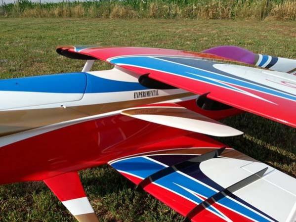

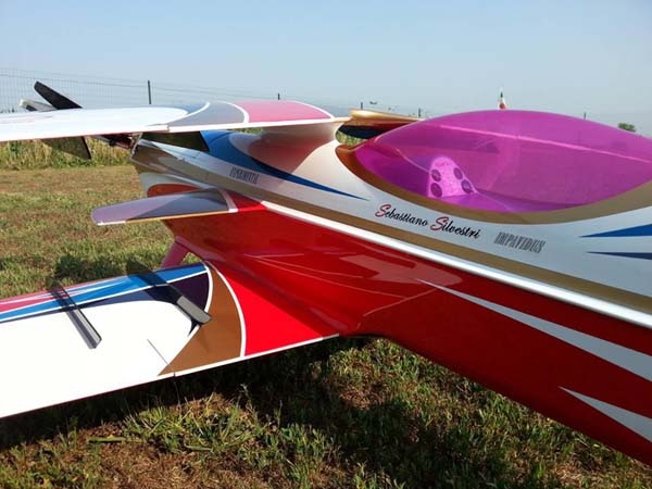

I guess bi-plane is no longer in fashion ...

I wonder how slow he can fly the pattern with that?

ORIGINAL: RCBruski65
I bet he can walk faster than his plane ...
Adrian

The way F3A schedules have evolved, a triplane (and soon to be seen quadriplane with a twin cylinder gas engine up front) was inevitable. It is a straight forward way to minimize wing load. Consider the tripe has around 1500 squares and weighs 11 pounds. Loading is a scant 17 ounces per sq foot. Not quite foamy like but much closer. Also consider the quadriplane with it's 2200 square inch wing.....a wing load of 11 1/2 ounces per square foot. That's foamy territory
The dimensional limit up is 2 meters. The box is a 2 meter cube....unless FAI changes the rule (doubt that)

Wow. Seems like original aircraft design has come full circle. Back in the very beginnings of powered flight, people thought more wings made an airplane fly better. Hence, there were some really ridiculous examples developed with 5, 6, 8 wings or more. I applaud Mayr for trying new things, but at those wing-loadings, the airplane will NEVER truely snaproll (although I suspect nobody really cares anymore), and the aerodynamics of that setup are going to be hell to trim for precision flight.

Not to mention keeping up with six ailerons and six aileron servos.

People watching him practice in SA have said his snap rolls have an 'interesting' look to them. I'm sure this is going to spark more discussion on that topic in the near future.

I watched it at the worlds and I have to agree with your thinking Doug, it really doesnt snap or spin well. I wouldnt think he would have added a third wing to try reduce wing loading as that doesnt seem whats needed in F3A. The KE edge capability is what is being tested with the new generation schedules. Maybe he was hoping for improved straigtening of air flow over the fuselarge for better KE effeciency. Maybe all the wings need are very narrow tips and sharp LE's to help stall the tips. Even the bipes struggled with the inverted KE triangle loop in the unknown schedules, especially in the strong winds. The top base of the triangle being downwind meant that the pilots had to apply abrupt rudder to get through the downwind 135 degree corner. Very few of the top 10 managed to keep the wings on edge during this as the planes get very squirrely. It would have been nice to see how Mayrs plane handled this but he unfortunately didnt get to fly the unknowns.
