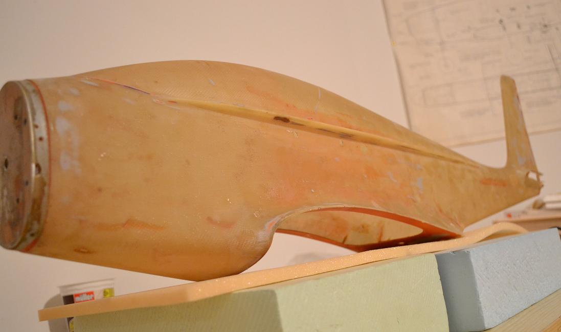

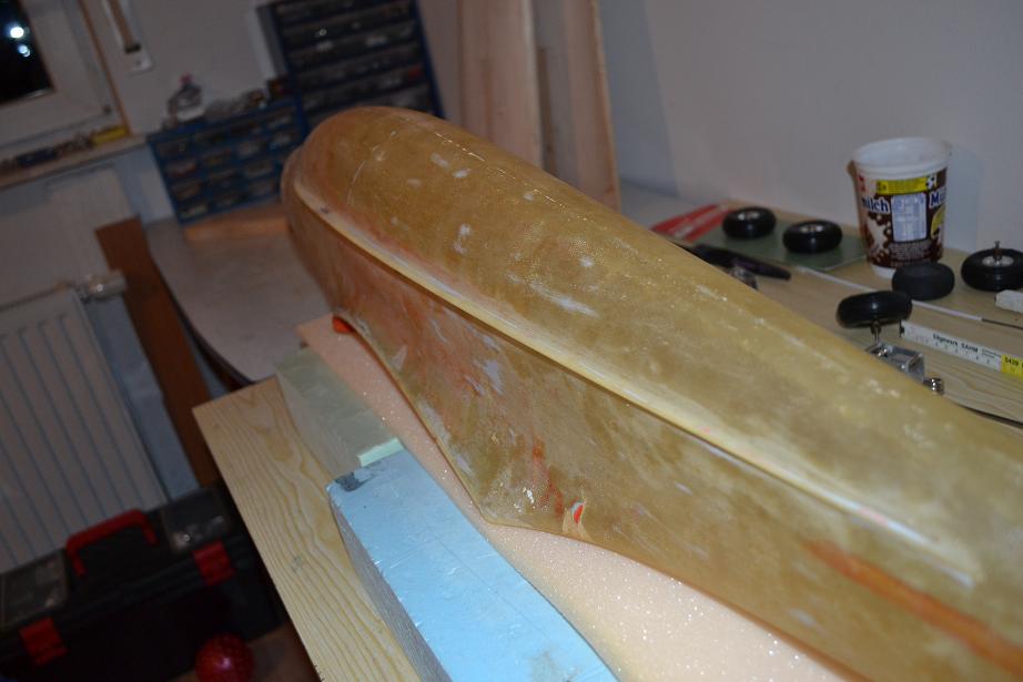

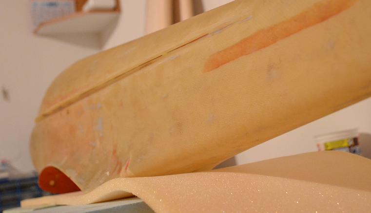

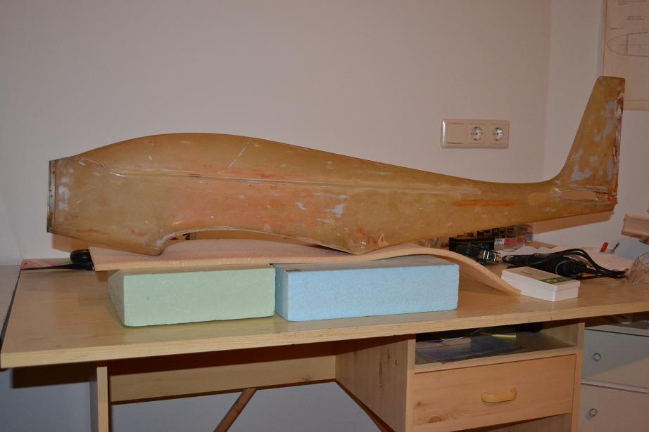

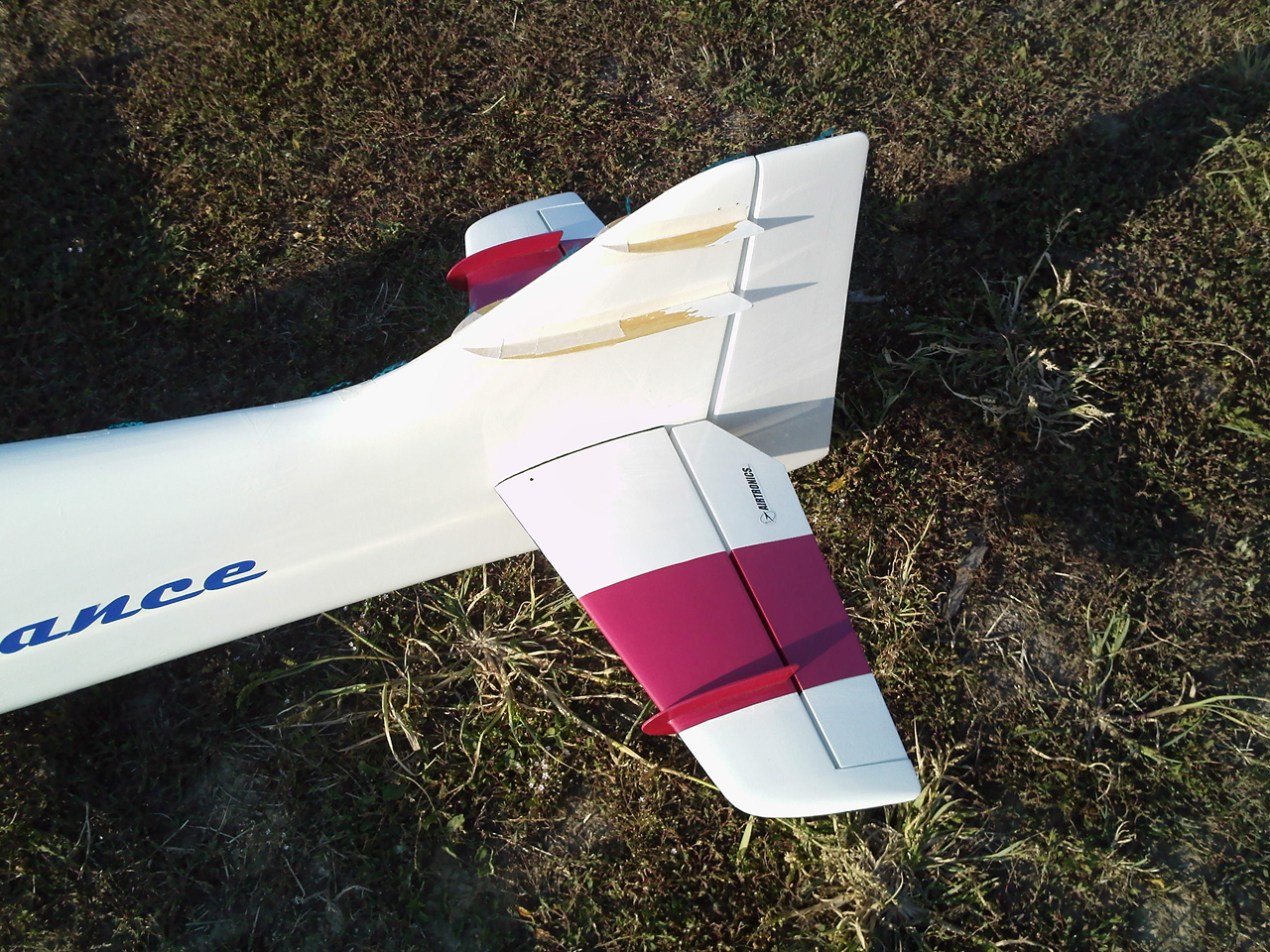

Alex,
I followed with great interest your airflow tests on pattern planes. Brilliant idea to use those new micro cameras and tufts, and send the plane through the classic manoeuvres.
As I read about the knife edge situation, and the discussion to attach some "fences" along the sides of the fuselage it came to my mind that I bought about 15 years ago an old, used and well worn pattern plane fuselage for very little money. Once it was shipped to me, during unpacking I recognized it had just such fences integrated to the fuse sides. I forgot about that until few days ago!
Obviously, some other guy had the same idea as it is discussed here. I still have no idea what was the name of that plane, nor do I know who was the designer and if there has been any report if those fences worked well.
I will post some pics later tonight.
Hope to read more here from your very intersting investigation!

Here are some quick photos. I will ask in our national RC web community if someone recalls this airframe.

Interesting plane, looks like a classic pattern model. I wonder why they added the fuselage fences, were they flying KE maneuvers back then?

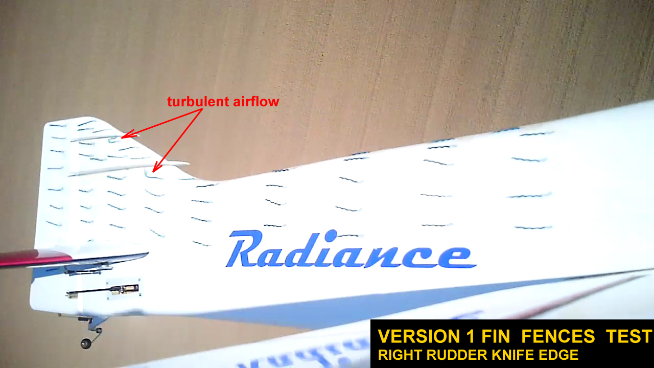

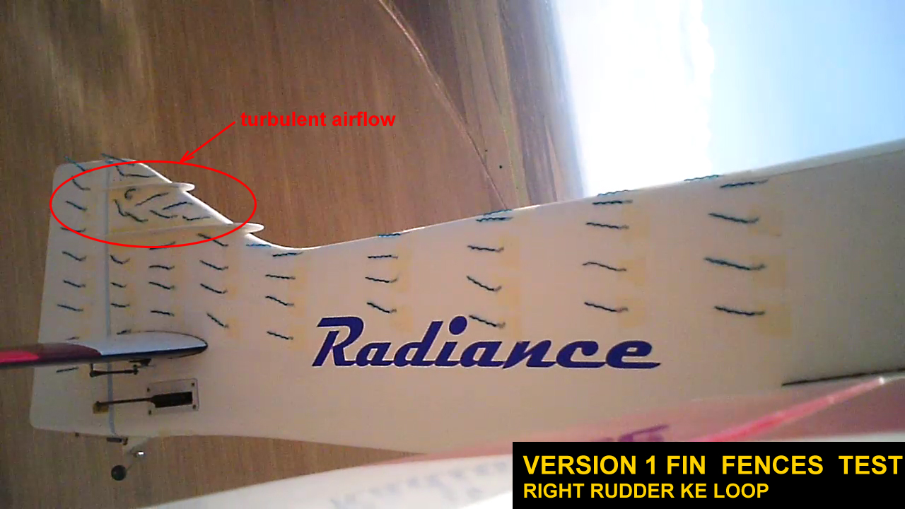

Default Fin Fences test (version 1)

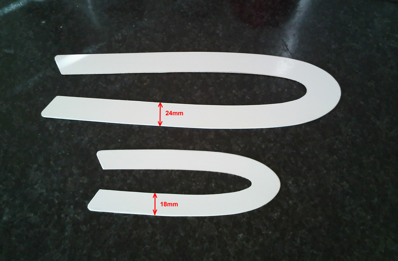

Finally here are the results from the fin fences and canalizer test.
Since the airflow was almost symmetrical on the left and right sides of the fuselage in previous tests, I decided to tuft only the right side and concentrate on the rear fuselage and tail area. Fin fences obviously don’t have any influence on the airflow around the nose section, the canalizer may have but only for a small area on the canopy.
I initially built and tested 2 fin fences, shaped as seen in the image below. They have a constant width and follow the shape of the fin airfoil.
I expected some visible improvements in right rudder KE maneuvers, but the results were disappointing at first; in KE horizontal flight the spanwise flow was indeed limited by the fences in the trailing edge area, but I could see some turbulence near the leading edge, probably caused by the front end of the fin fences.
In KE loops it was much worse, you can actually see the disrupted airflow caused by the 2 fin fences:

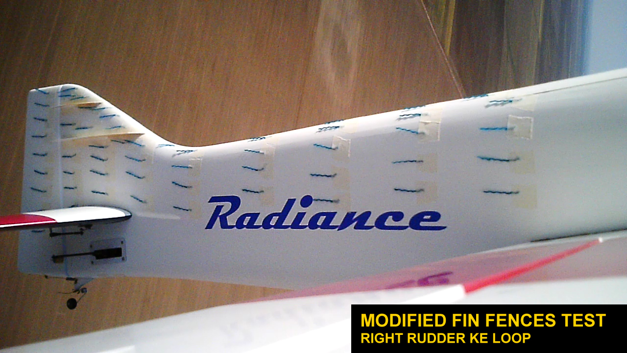

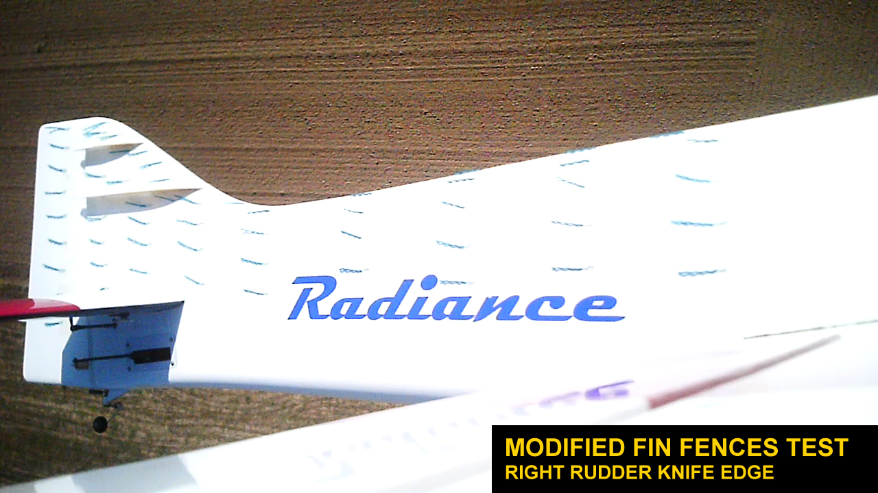

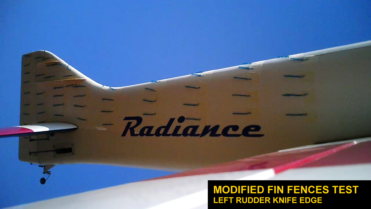

Default Fin fences test (version 2)

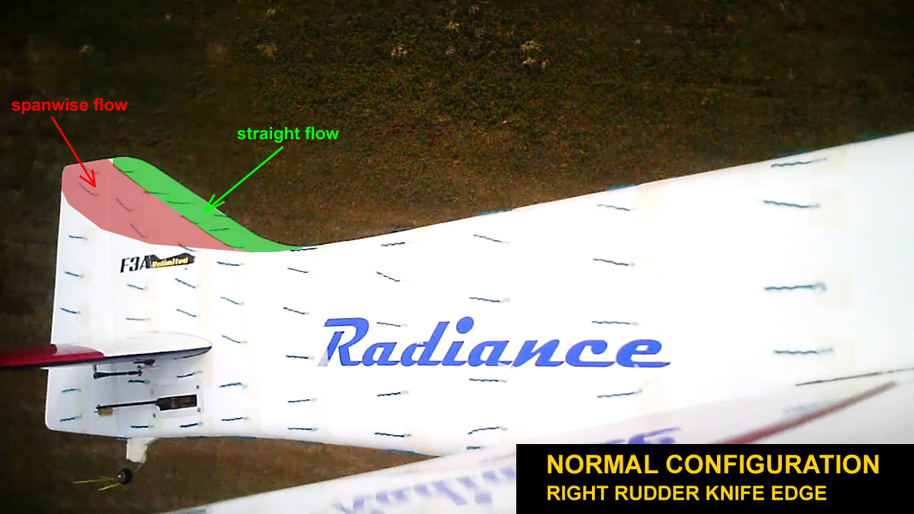

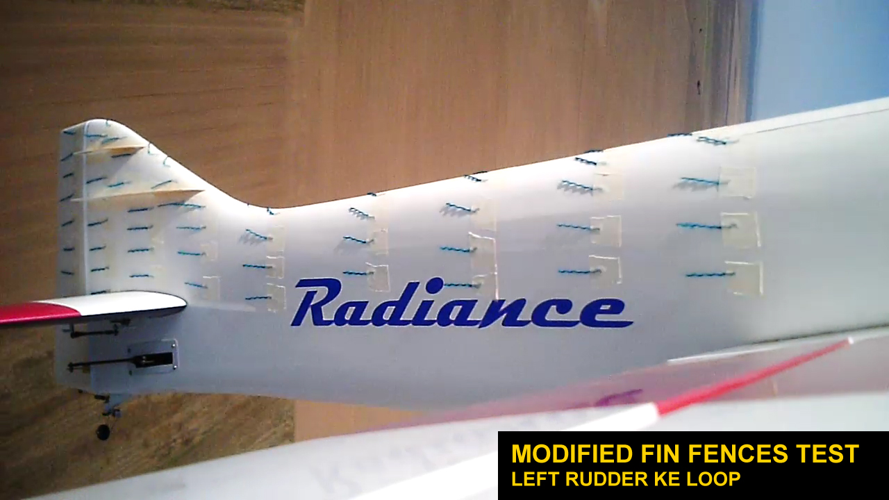

Anyway, instead of giving up on the fin fences, I went back to the images from the previous tests. I noticed that without the fences, the airflow is pretty straight near the leading edge and only goes spanwise in a clearly delimited area:
The obvious conclusion was to try a new type of fence, one that goes from 0 width near the leading edge to full width near the rudder hinge line. I quickly removed the fences from the model, reshaped them right there on the field and put them back on for more tests.
I didn’t expect too much from this, but I was very surprised to see the results are clearly superior to the previous version of the fences and also showed a marked improvement compared to the normal configuration (without fin fences).
I tested the model with and without the camera and the rudder is clearly more powerful, especially on KE loop exits (last quadrant) I can be more relaxed, the model is smoother and comes back to horizontal KE much easier.

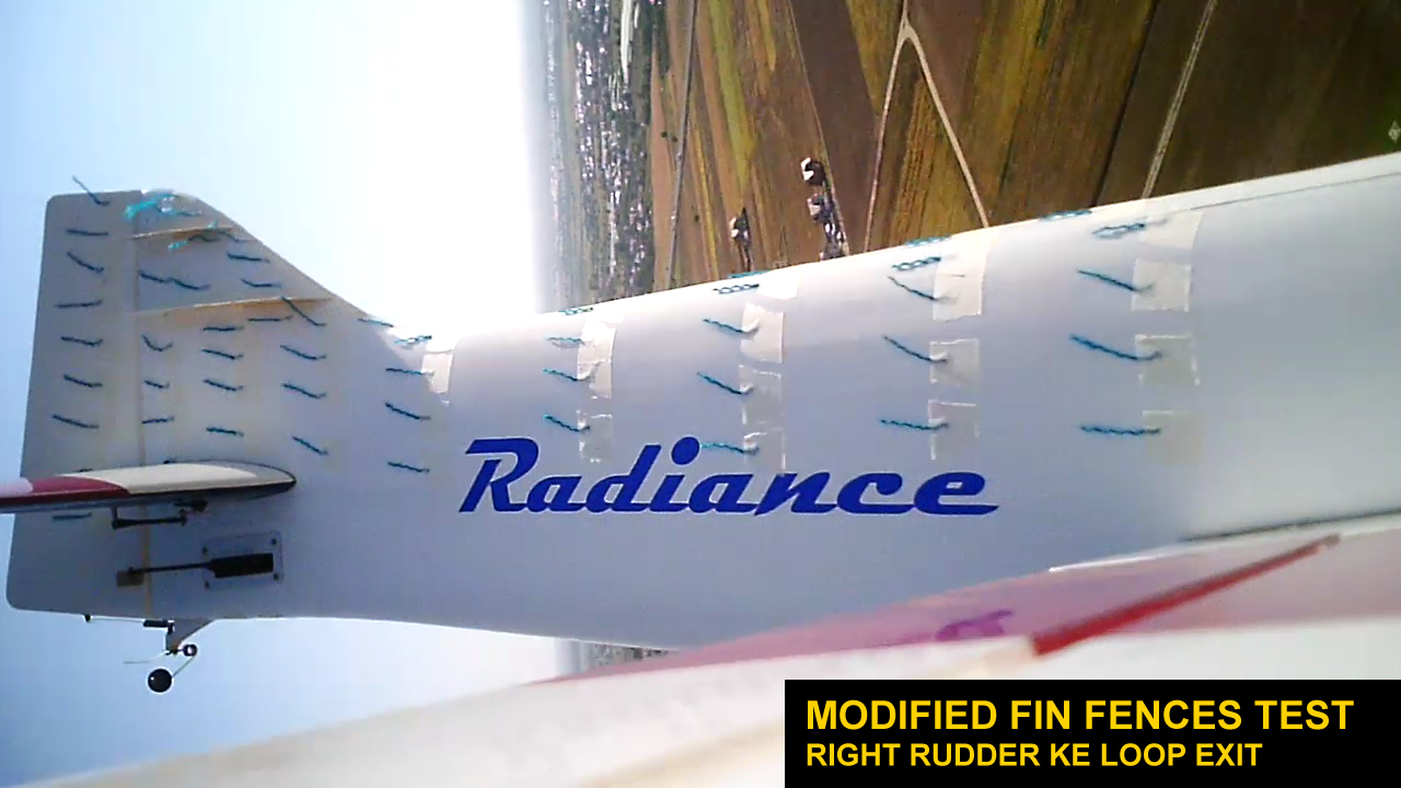

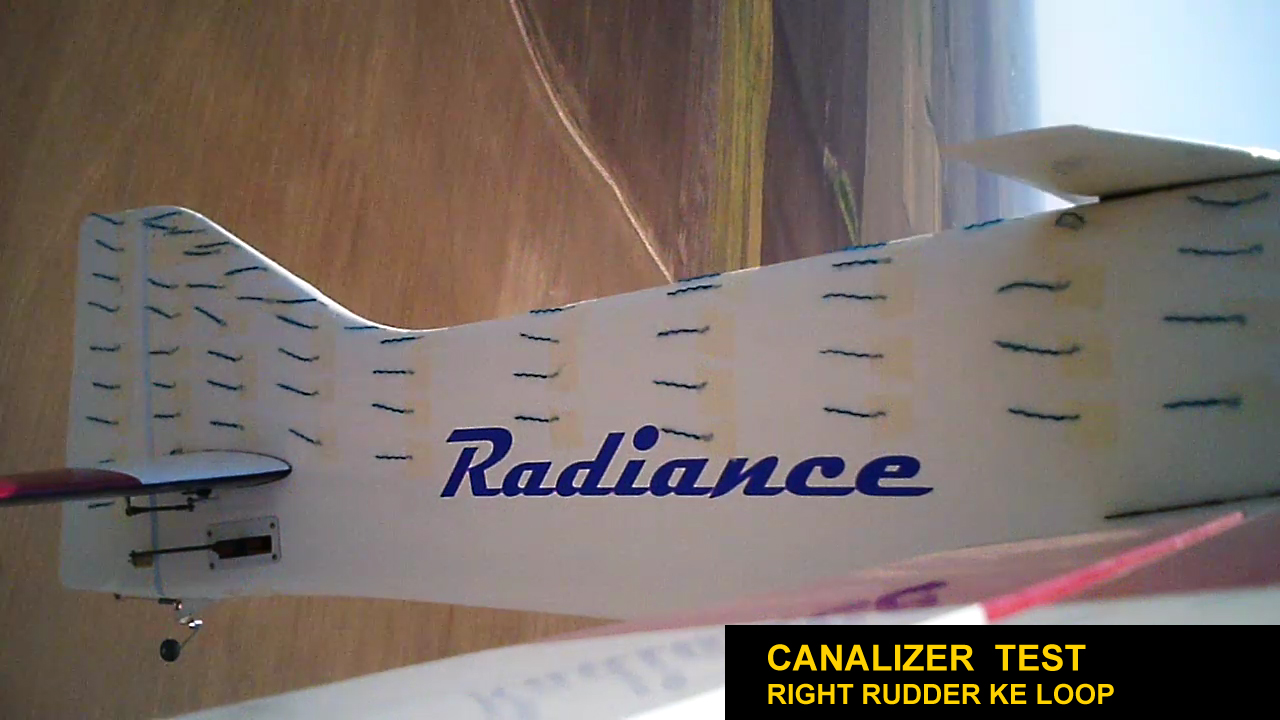

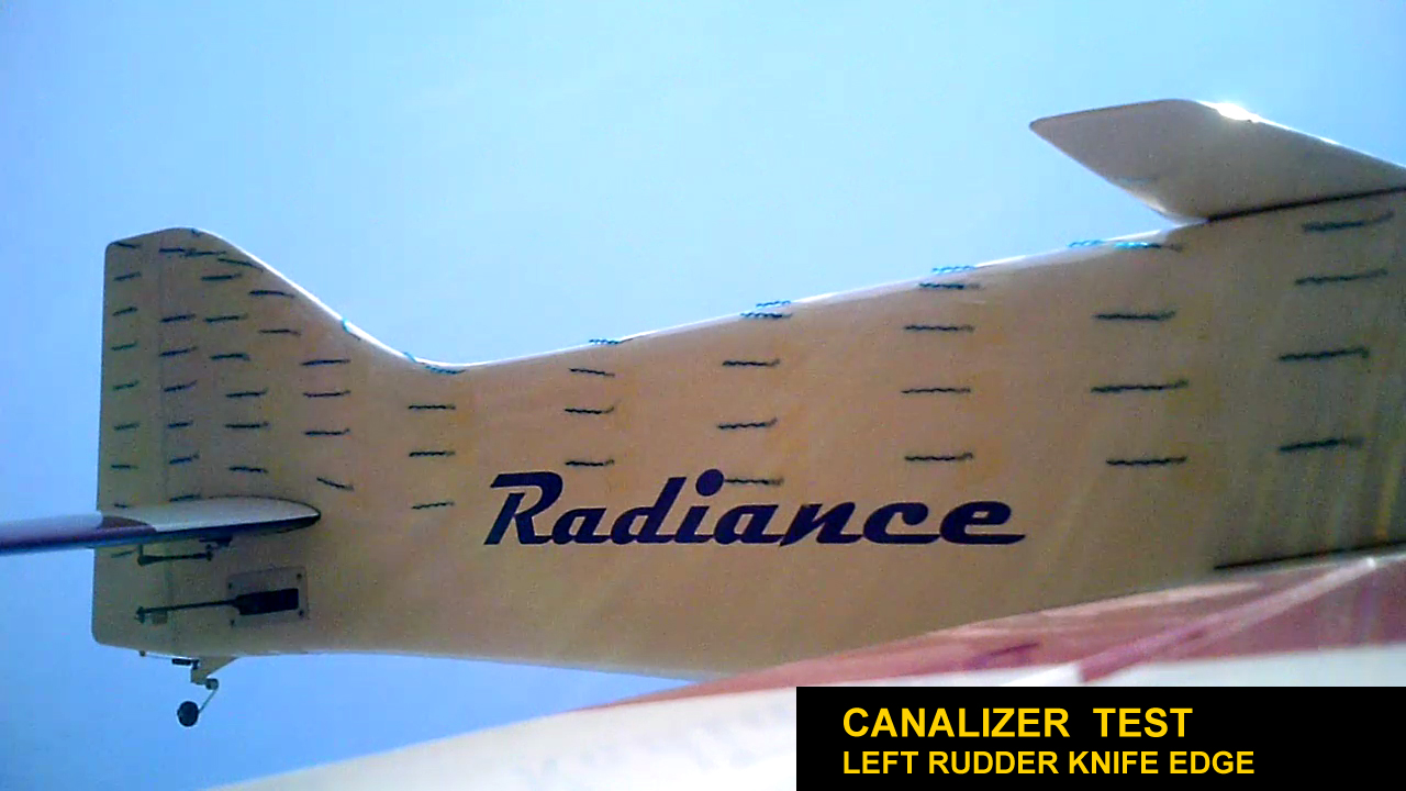

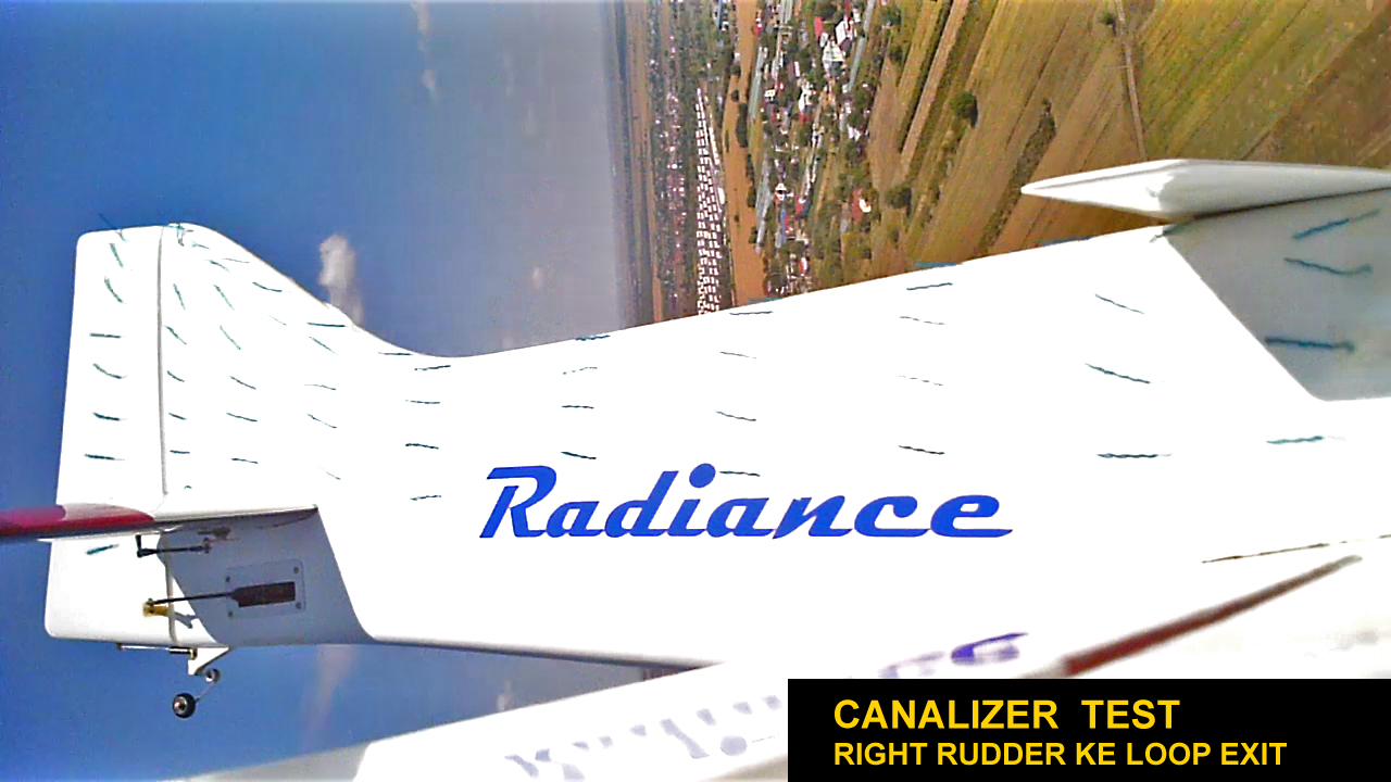

Default Canalizer test

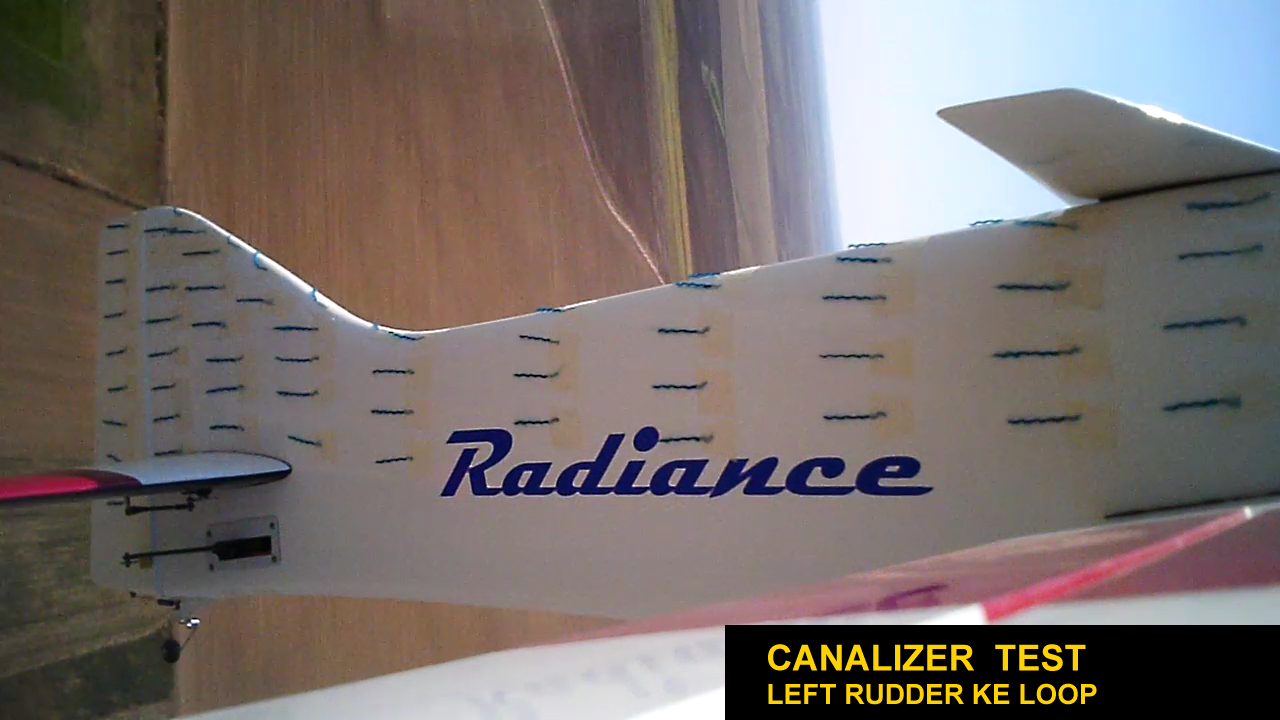

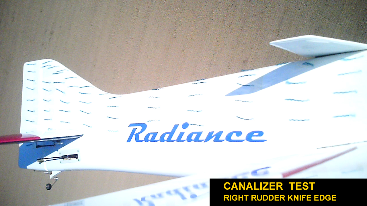

I also tested the canalizer and it’s clear from the videos that it works in a similar way to the fin fences, effectively limiting the spanwise flow on the vertical tail.
You can see how well it works in horizontal KE; it’s interesting that it also helps with the airflow around the fuselage (less air moving from high pressure side to the low pressure side.
In KE loops it has its limitations though, probably because is too far from the vertical tail to effectively help in all situations. Compared to the modified fin fences, there’s more spanwise flow.
In KE loop exits, when high rudder deflections are required, both have their problems, but there’s a noticeable improvement in rudder response compared to the normal configuration.
Anyway, not all models are the same so results may be different, but in my opinion if you’re looking for a way to increase the rudder authority, the second version of the fin fences worths trying. It’s very simple to manufacture them, they weight almost nothing and they don’t have any negative impact on the flight performance. I will definitely keep them on my model.

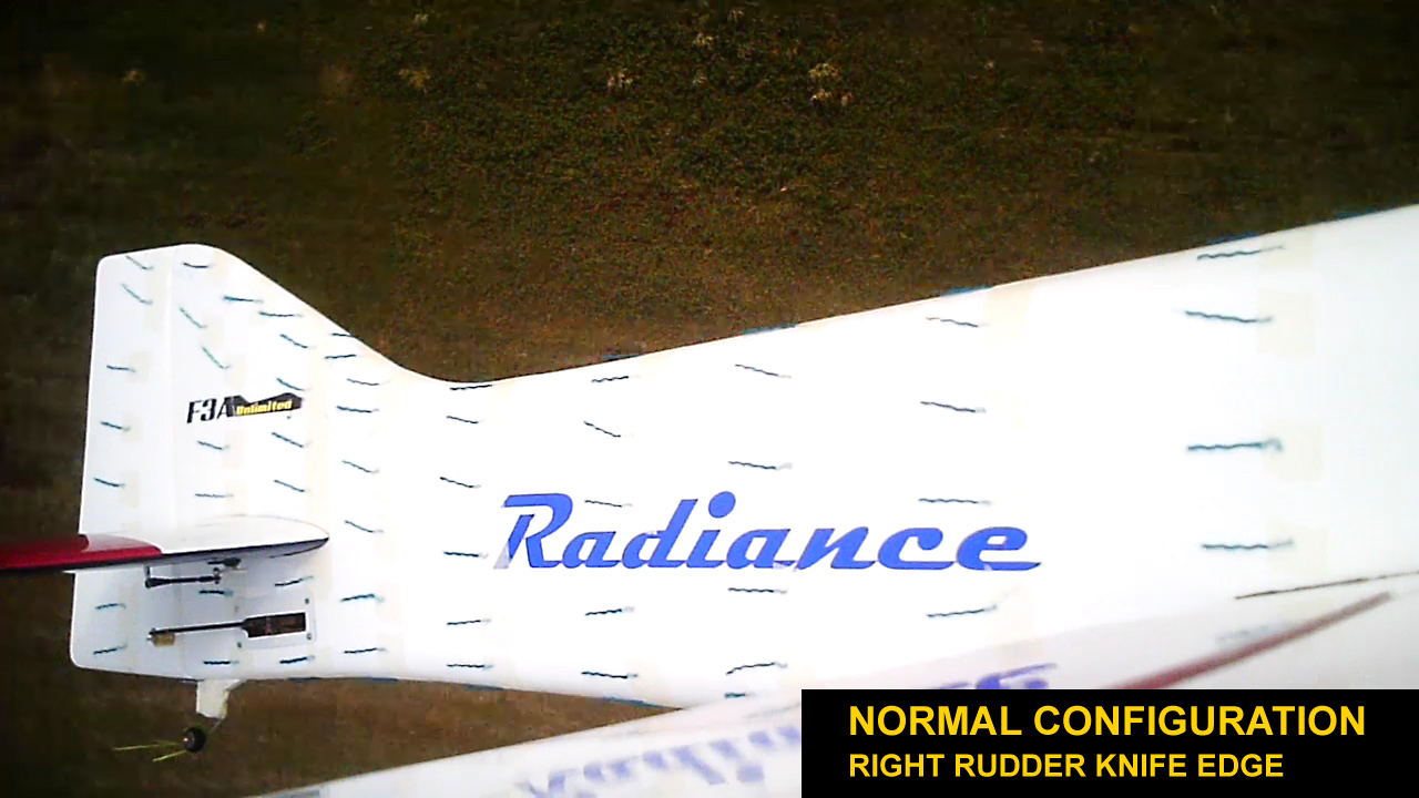

Default Side by side comparison

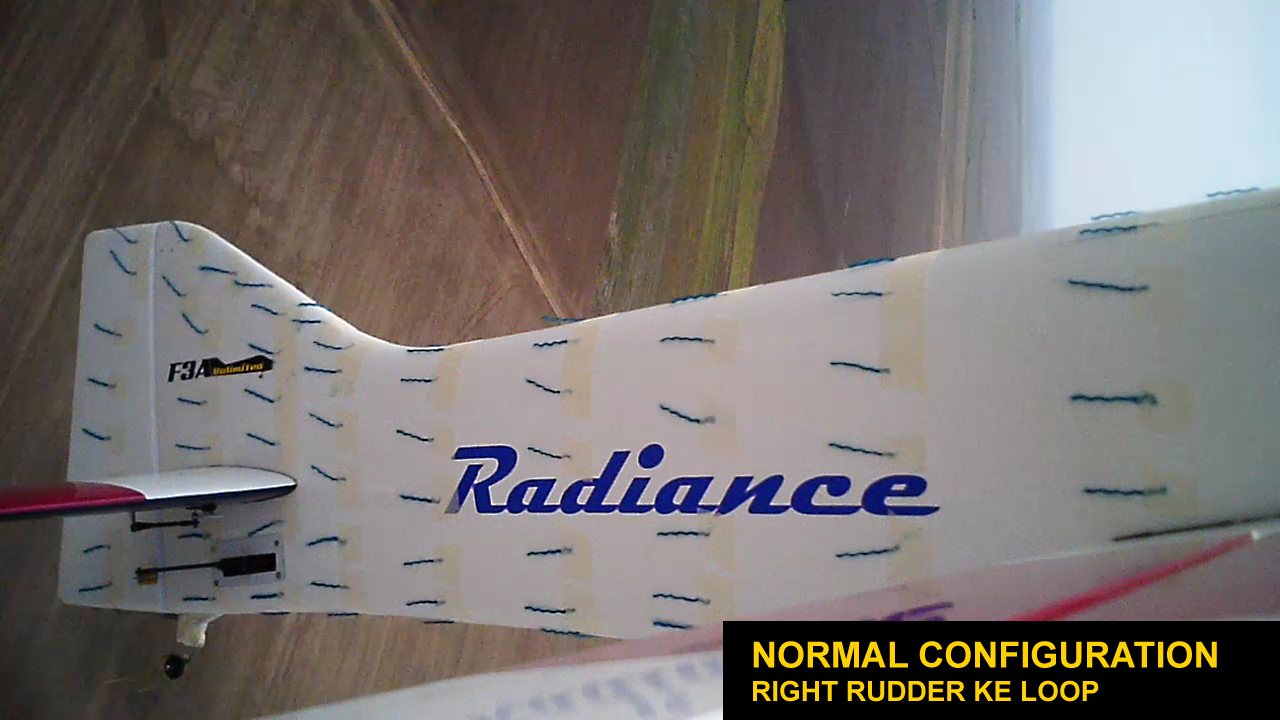

Right Rudder Horizontal KE:
Right Rudder KE Loop:

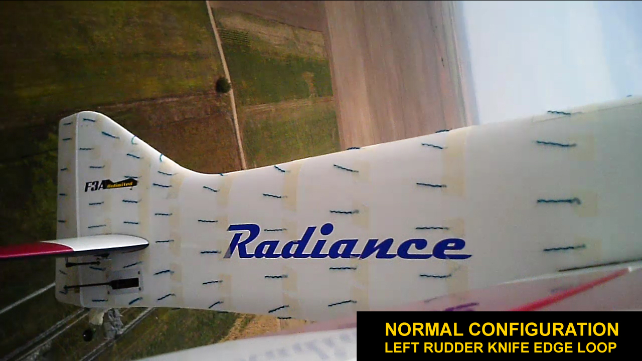

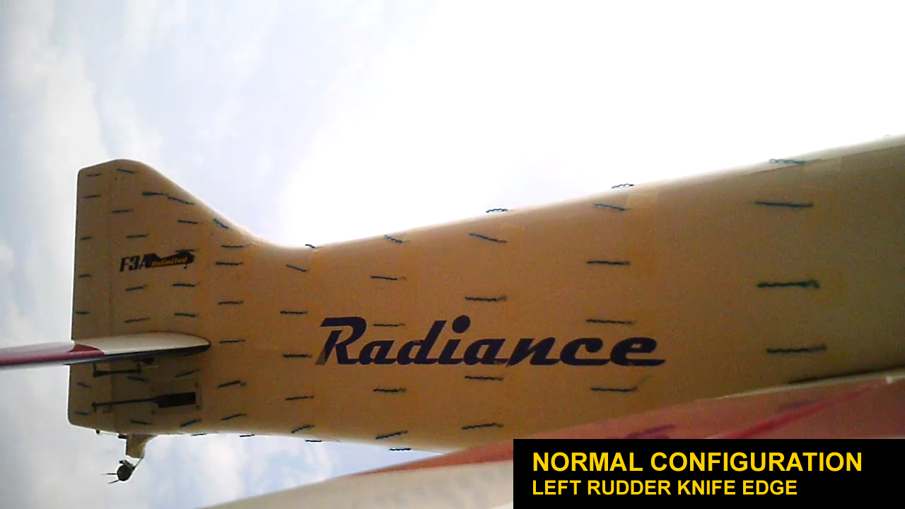

Left Rudder Horizontal KE:
Left Rudder KE Loop:

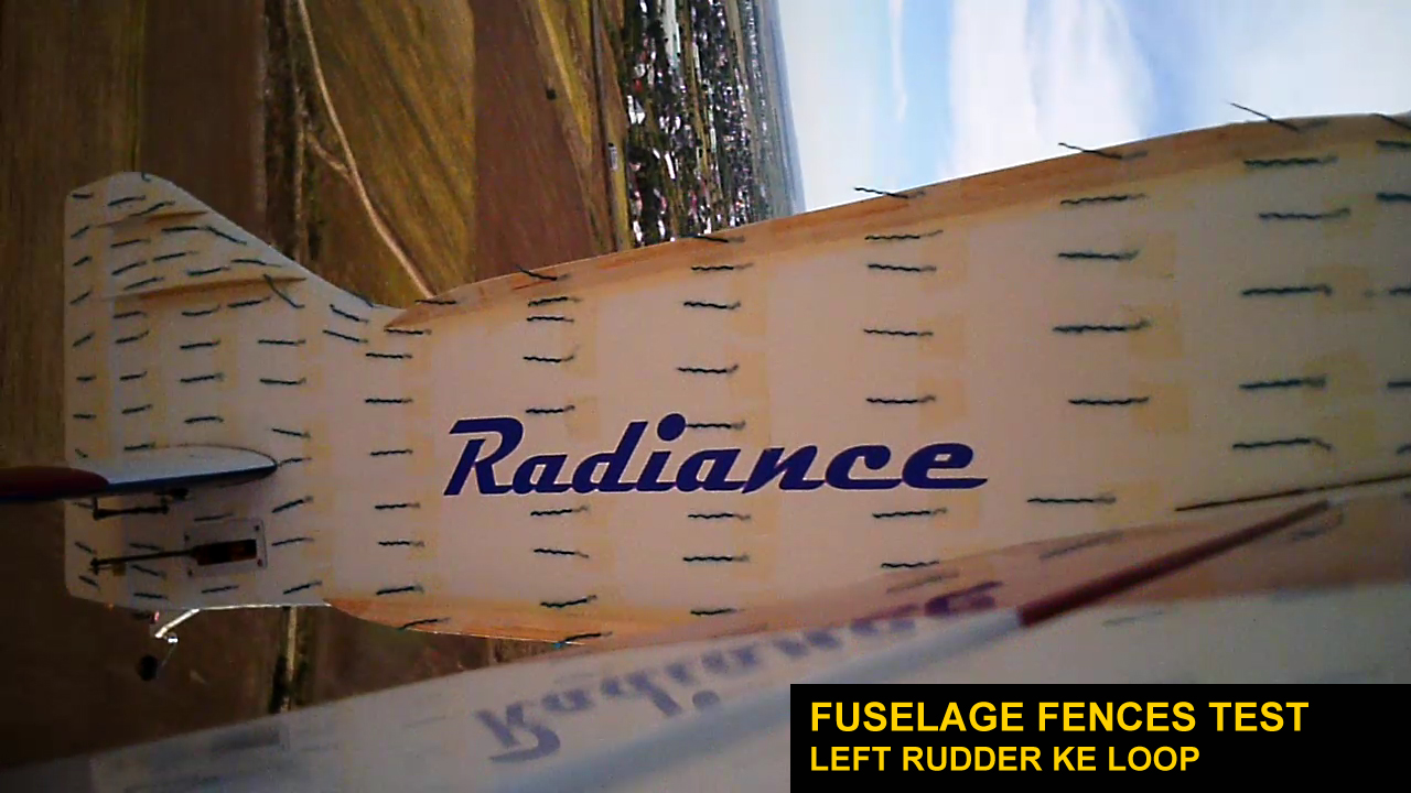

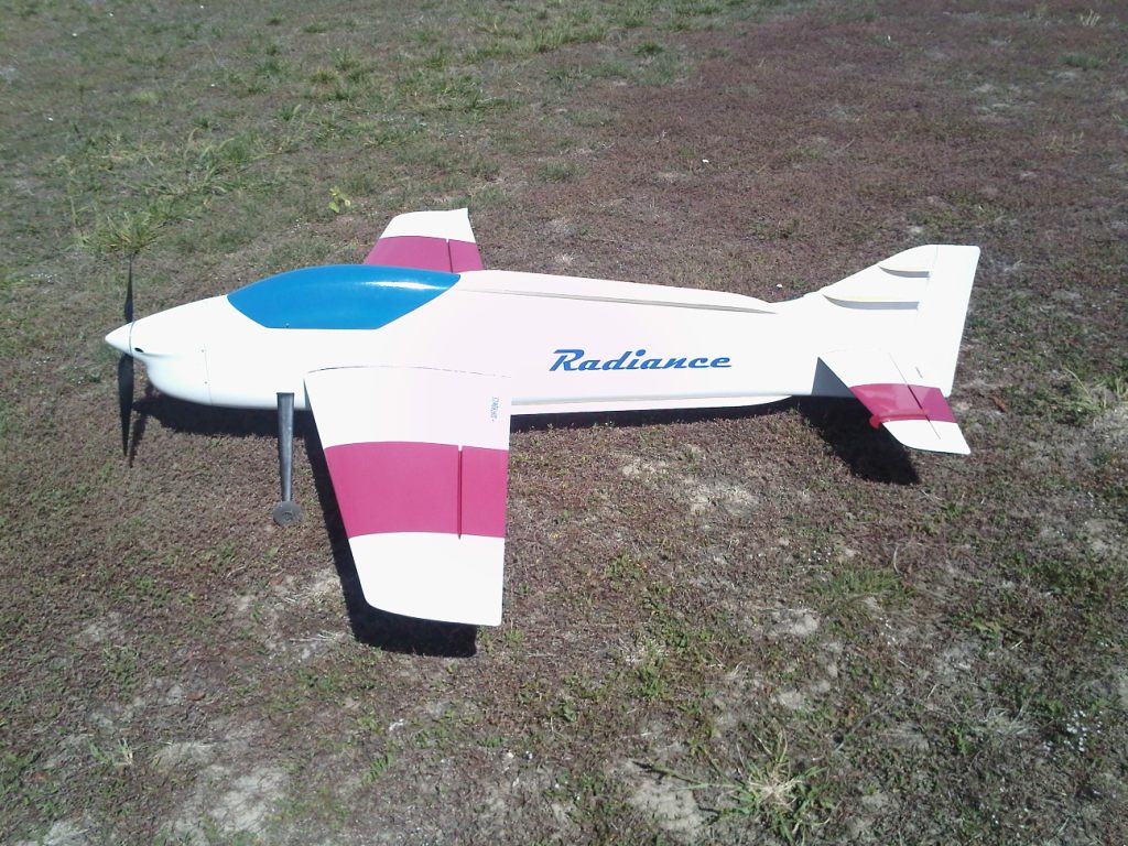

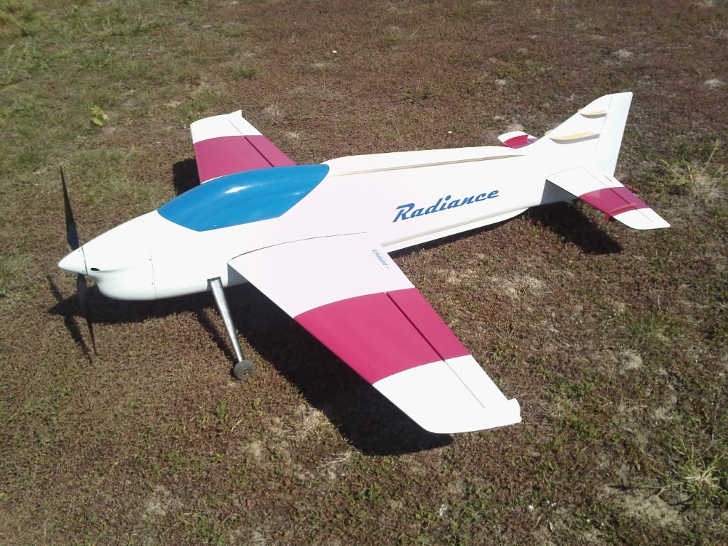

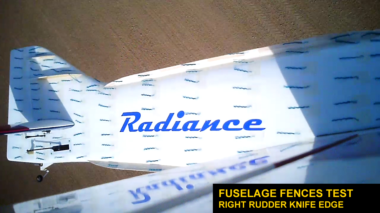

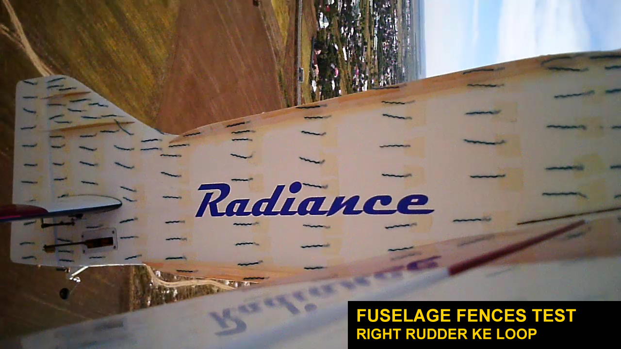

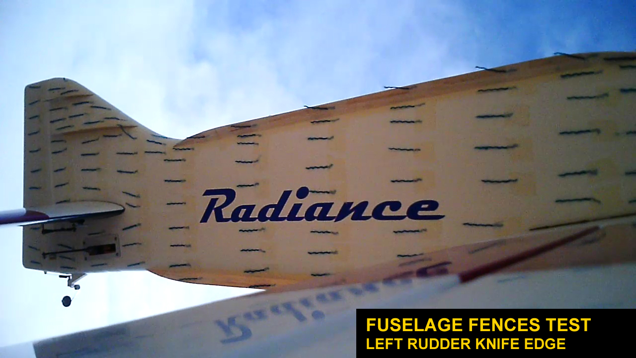

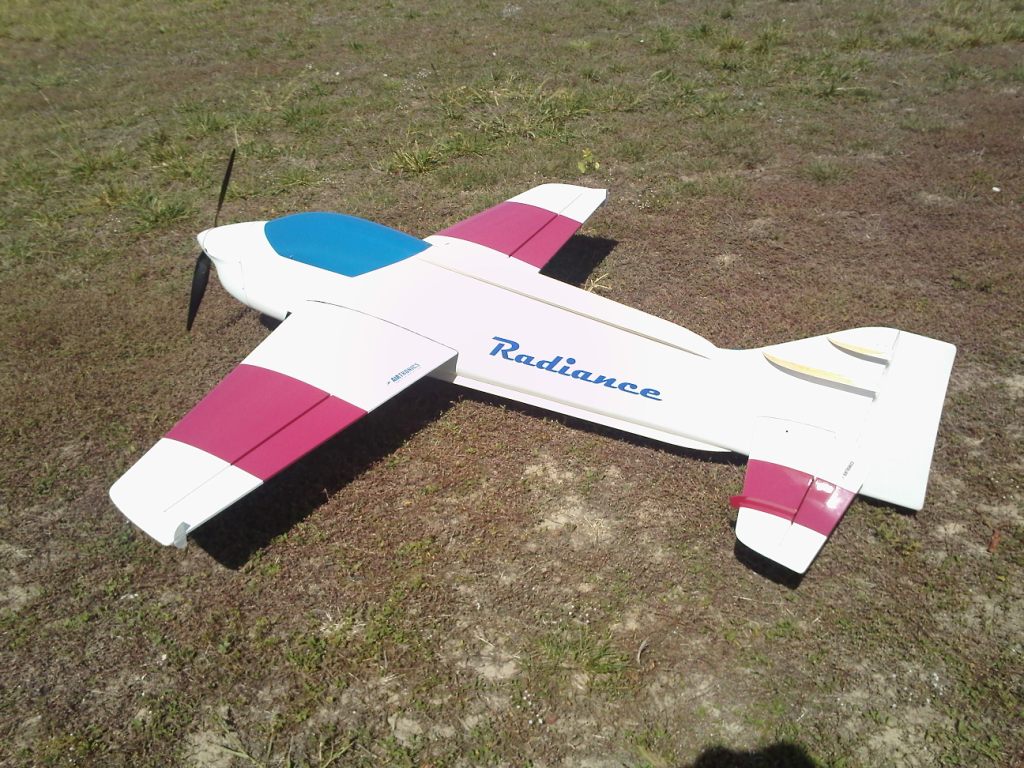

Default Fuselage fences test
I added the fuselage fences and went testing today. First thing I noticed was no change in pitch trim, probably because they are aligned with the local airflow around the turtle deck and belly pan.
The improvement in horizontal KE was nothing short of spectacular. My model always needed some visible fuselage incidence in KE flight (very similar to the Integral in that aspect), but with the fuselage fences on, the fuselage angle in KE was now close to 0, looks almost parallel to the ground.
To be honest I’m not crazy about the looks of the fuselage fences, so before testing them I was just looking for a reason to take them off, but now it looks like I have to keep them.
The video recordings confirmed my impressions; the fences stop the air leaking over the turtle deck and belly pan from the high pressure side to the low pressure side, making the fuselage much more efficient in KE flight. The tufts are barely moving during transitions from horizontal to KE.
Even more performance can be found by extending the fences forward on the canopy at the top and up to the cowl on the bottom, but I’m not sure I’ll have the time for it. We have our national contest coming up in October, so I’ll need some time for training.
Left rudder knife edge (horizontal and loop):
Right rudder knife edge (horizontal and loop):
