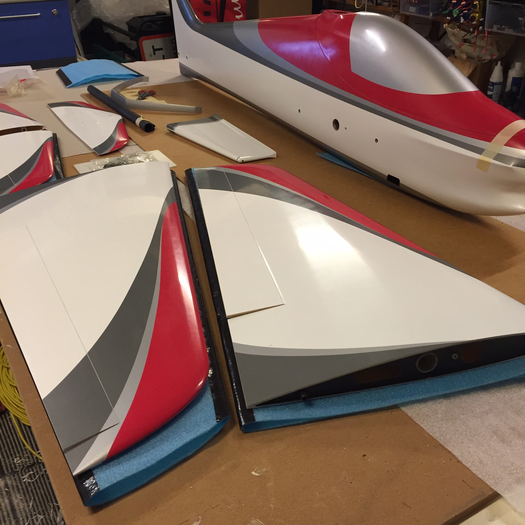

The Gaudius has survived, the yellow M14 did not, due to a bad anti spark female connector.
The new white color version
is just finished........
I have, once again, raised the trailing edge of the top wing some 5 mm, and further trials is probably needed in the field, but nothing else has to be changed. It is laid out for slow flight

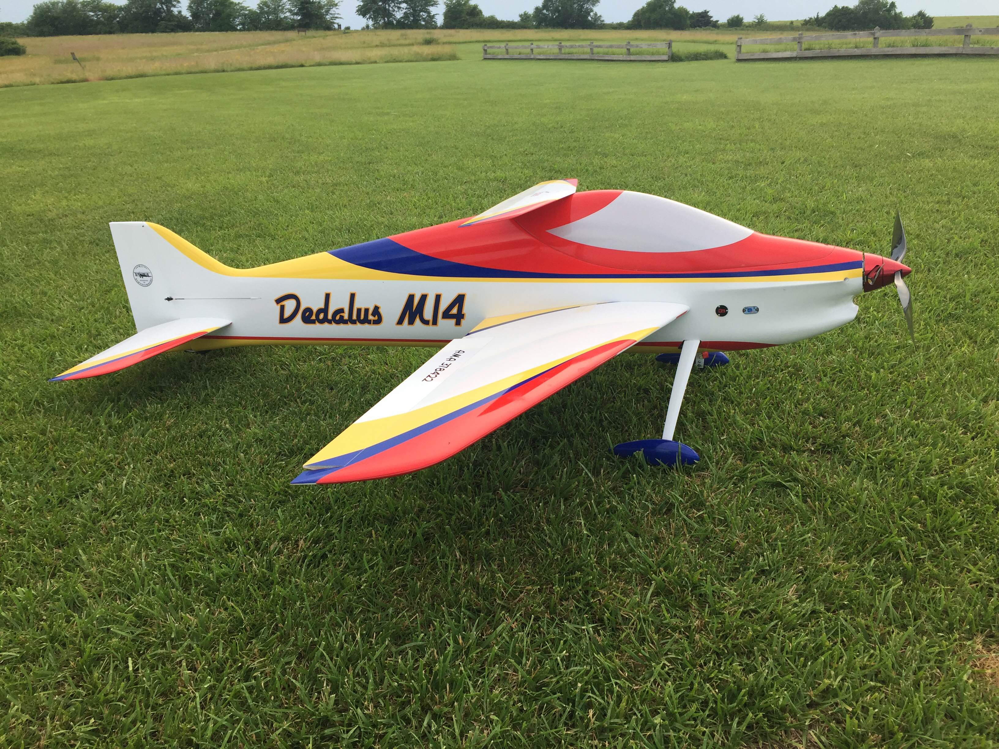

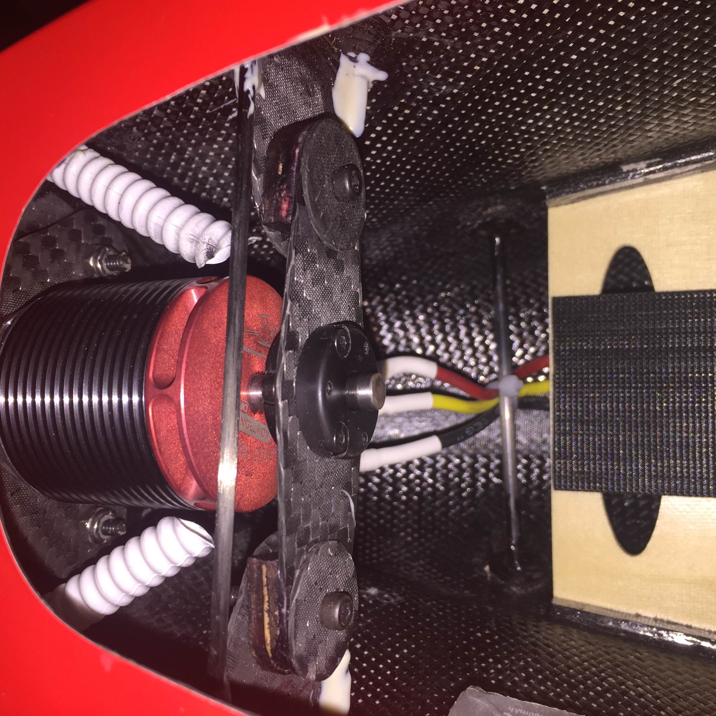

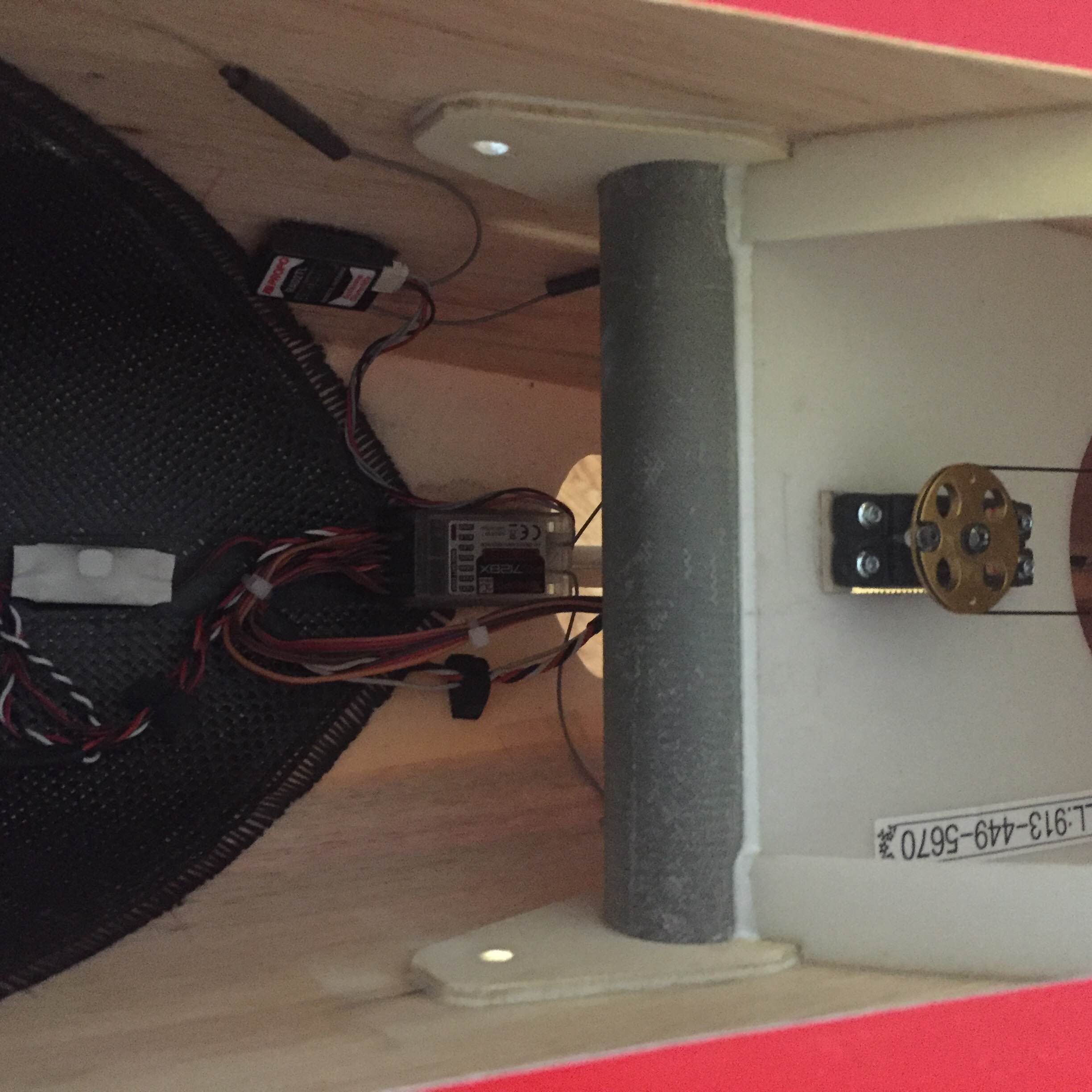

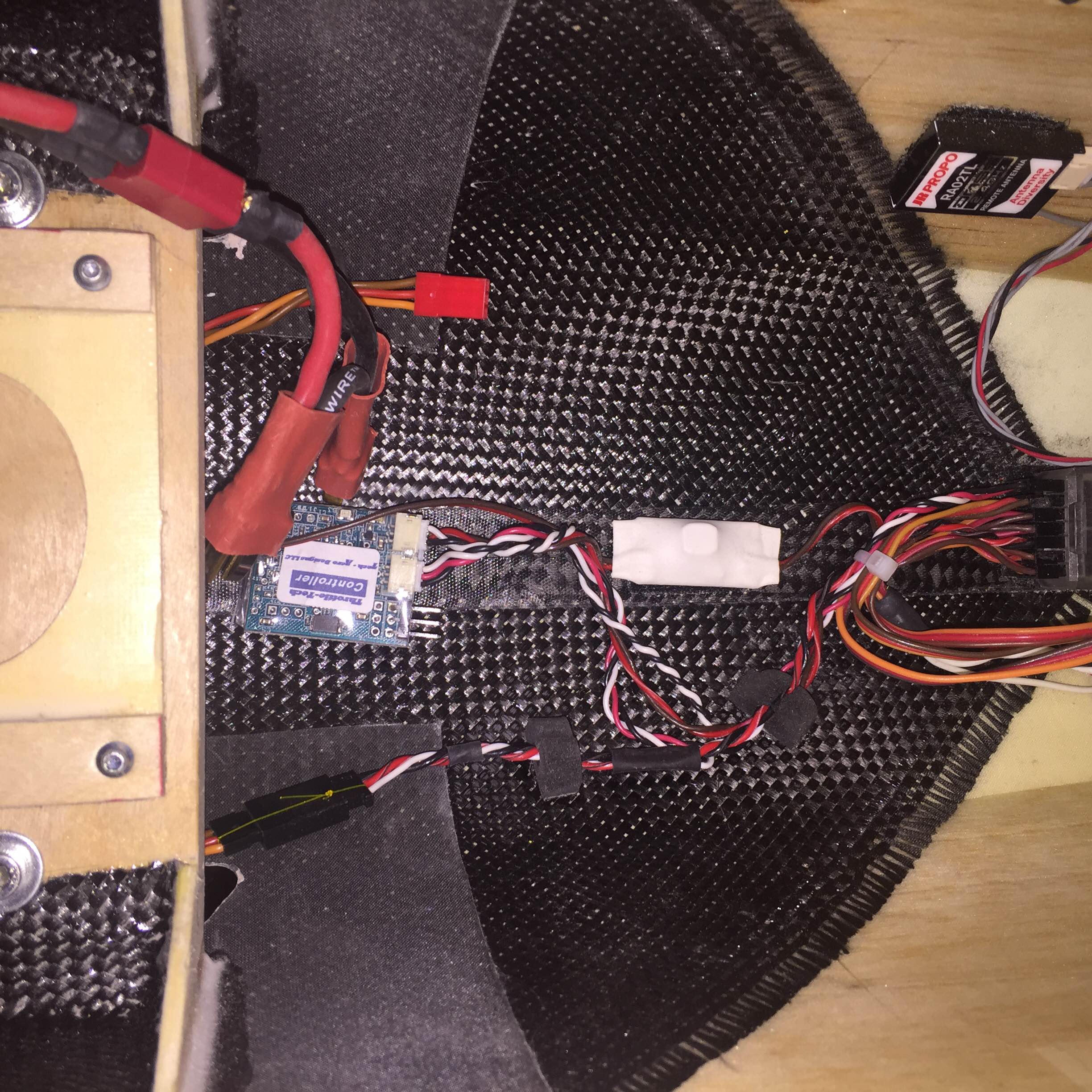

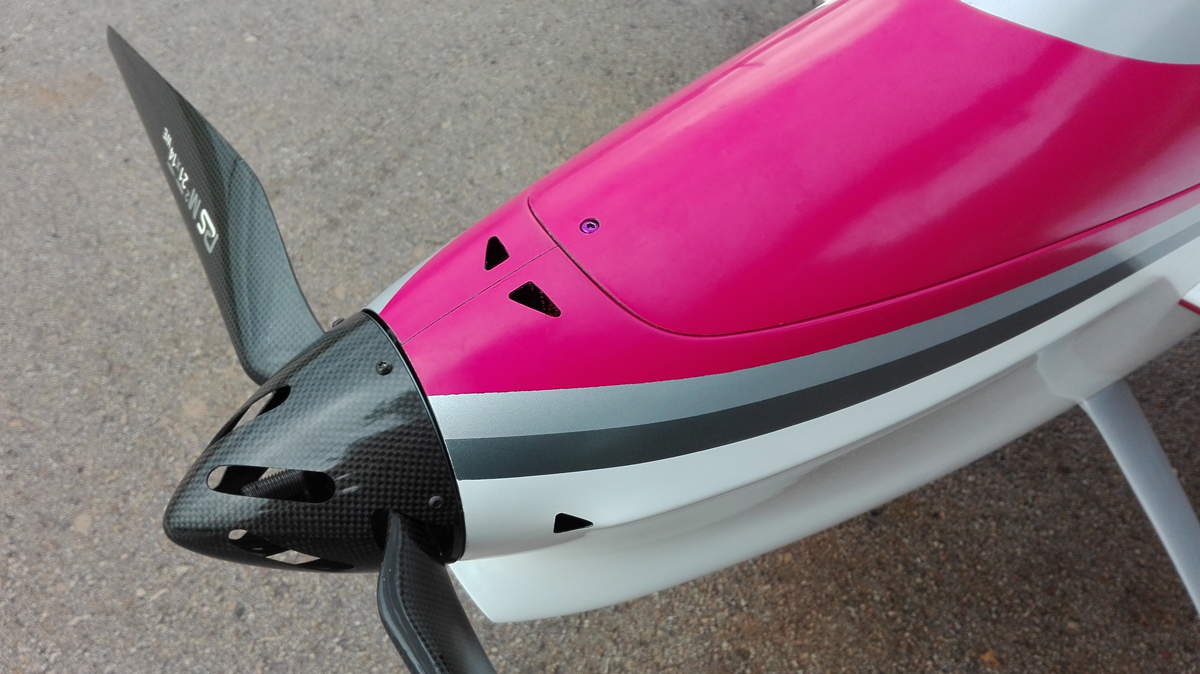

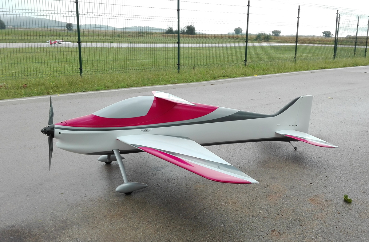

Hi Vince,
Nice to hear that we are close on trimming.
-About the canalizer, what I did on mine was to glue the rear fuse canopy metallic pins (they are screwed to the fuselage and tends to screw off with flights), I use a screw on the front part because I only have a 2mm gap with the Hacker Q80 14xs (I did a lot of snaps and it is rock solid).
-About rolling tendency:
At the beginning I was carrying about 5 clicks of left aileron trim, The knife edge was close to perfect on one side and with 2% mix to the other.
I decided to check the incidences and I found a small misalignment on wings and stabs. I could solve the wing difference sanding a little bit the wing pins and the fuse holes. I decided not to touch the stab incidence because it was a very small difference and it is so difficult.
Now I have 0 trim on my ailerons, but still have the rolling tendency.
But..., If you try a knife edge loop with full rudder you will see that the mix decreses a lot at the 30% of the travel, you only need it for the very first part of the rudder travel and then remains flat (it isn't linear mix). As I said on the last post I need to check it again, because now, I have my engine thrust close to perfect and improved the flight performance a lot. I think this is a normal mix on most F3A planes ( but as you, I don't understand why one side is perfect and the other no) If you can solve it please let me Know.
I post some pictures of my plane, you will see where I have my battery pack now ( 980 gr.)

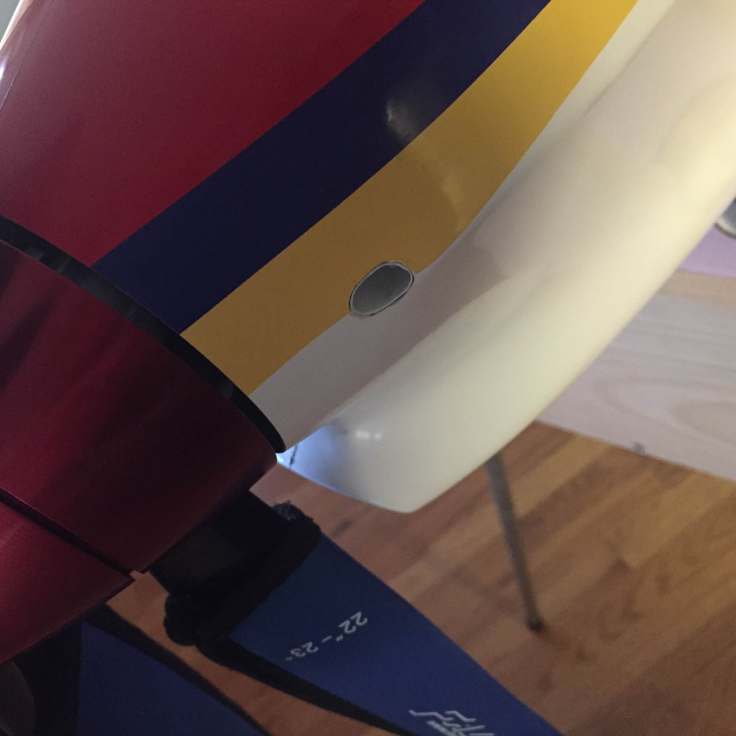

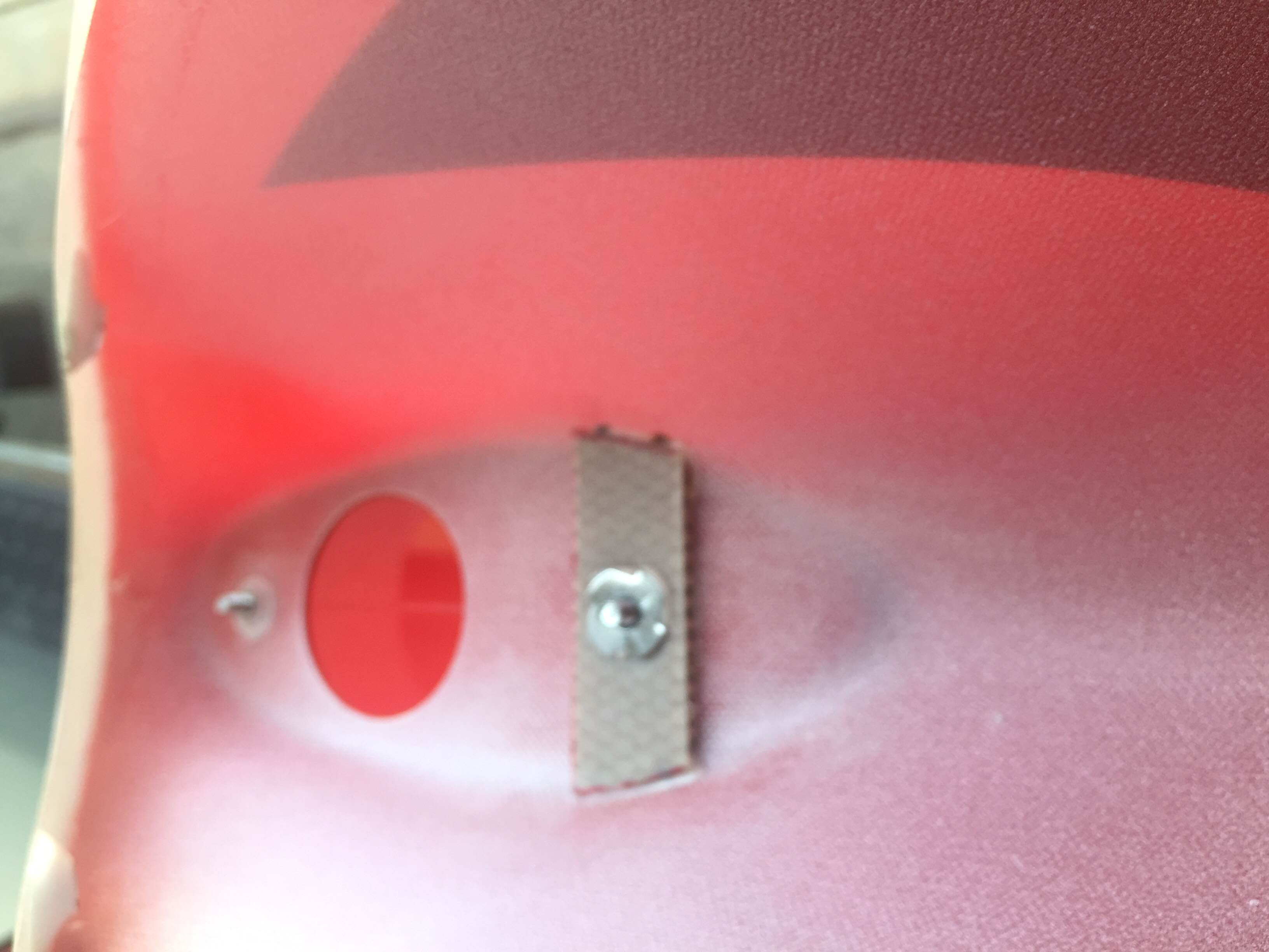

Hi Jordi,
- About canalizer. See attached picture. I wanted to say that the canalizer support flex over the canopy. I glued a piece to improve the support. It is much better now.
- About rolling tendency with left rudder. We need to try to figure it out. I know that will be difficult. My plane aileron trim is at zero. It is perfectly aligned. I checked with digital meter and could not be better. I agree that mixing is notl inear. Also agree that there is almost not mixing with left rudder.
- Pictures are perfect. Very nice detailed work. I am attaching some too.
- Battery. Your battery is very light. Mine are around 1150 gr. They are 5000 mah. Where you got those?
