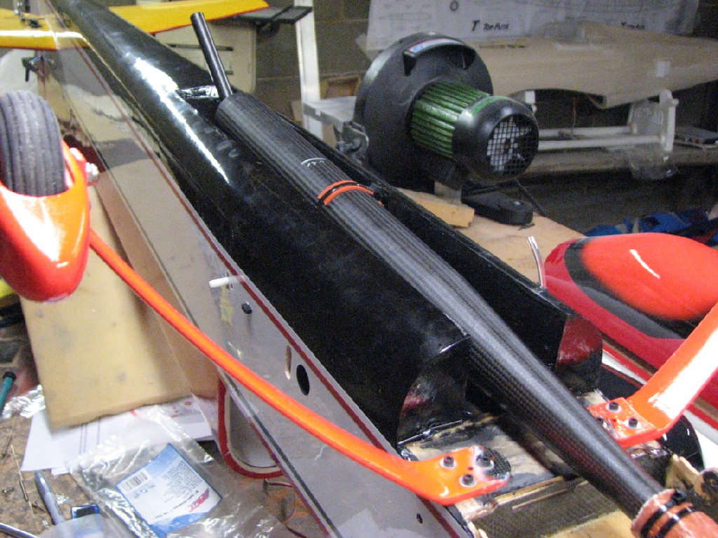

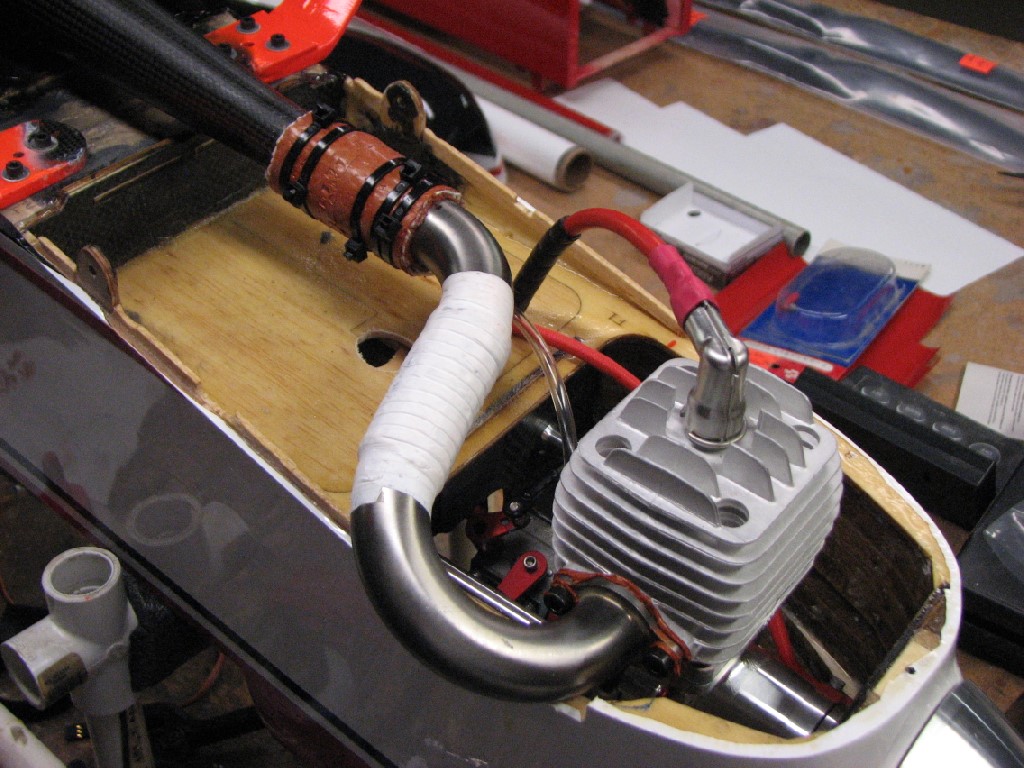

RM,
When the flex header goes, do the fiberglass and ultra copper repair. It's much better than Teflon unsintered tape that DA uses. Or you can do it now before the tape leaks all the black gunk through it. You would have to remove the tape and rewrap the flex joint with the treated fabric. I found its easier to place the fabric in an envelope of parchment paper and work the Permatex into the weave with a wallpaper roller. Three wraps around the joint with plastic cling wrap wrapped tightly to hold everything snug, will have you back in business. Allow at least 24 hours of cure
A shame that engine problems seem to persist. You have had more than your share.

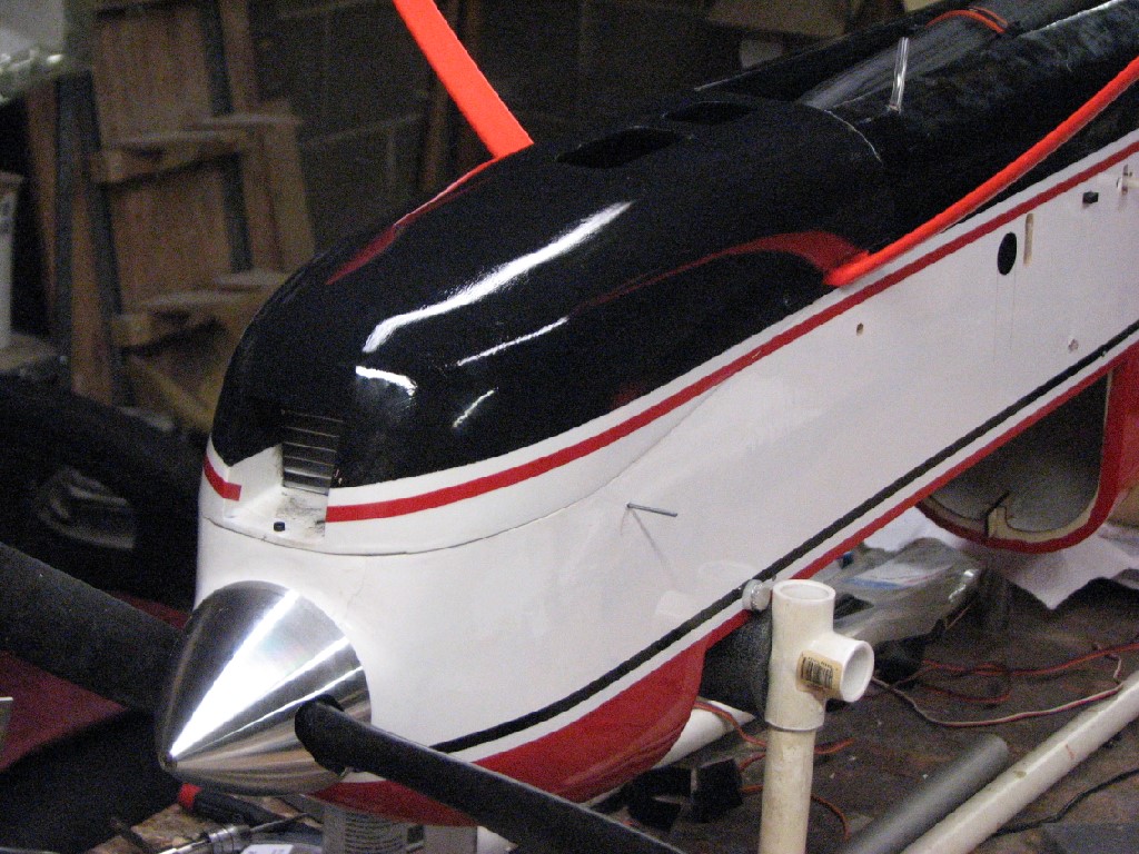

Thanks guys. Talked to DA today. They're sending me out a new ignition today without waiting for the old one to get there (and I didn't even need to ask). That's great service.
If the problem then persists I'll need to return the motor. Hopefully, it won't come to that.
I was thinking of using rescue tape when the header started leaking. Guys seem to like it and claim it lasts, Would be a lot easier. DA has come out with a new solid header for the 35 in 0, 25, and 50mm drops. I got them to add one with my ignition shipment.
Viton, according to mcmasters has a heat rating of 400 deg. The copper goop is rated at 600 and the fabric is 1100 deg. I don't think the viton would stand up. Matt prob knows more about this.
Austin, can't really say at this time. I've got a lot of time on my pentathlon. My initial thoughts when I flew the cadence on the first day and the motor was running perfect was wow. It looks a lot bigger and felt lighter on the sticks. Was running the 20x10 turning around 7000. Wing was set to +.75, cg was about 3/4 back of leading edge of wingtube. Upline 4 pt were effortless and the plane held its line really nice and the DA could have went forever. Downlines looked to need barely a touch of throttle/elev mix. Knife edge coupling was present. Rolls looked nice. My thoughts are I want to get this plane in the air and working on as quickly as I can.

Turbo hose is pretty good. It's thick walled and heavier than desired but it does the job.
My solution was a thin walled, very flexible ceramic fabric impregnated with Permatex ultra copper. It has turned out to last 1000 runs and still going and only needs plastic tie wraps to hold. It doesn't get stiff with time and has not burned through yet, for good reason. Works as well on the YS too. One neat feature of this method is you can custom mold whatever shape you like. Curves, bends, bulbs, dissimilar diameters, whatever, are all straight forward.

RM, I am leary of solid DA steel headers. I had one on my 55 and it broke in four or five flights at the flange. Their flex steel headers are heavier but are a better solution.
Let me throw this out....I've made aluminum adapters before to couple dissimilar exhaust shapes. I used hand tools which was tough, but if you have access to a machine shop, it's elementary.
