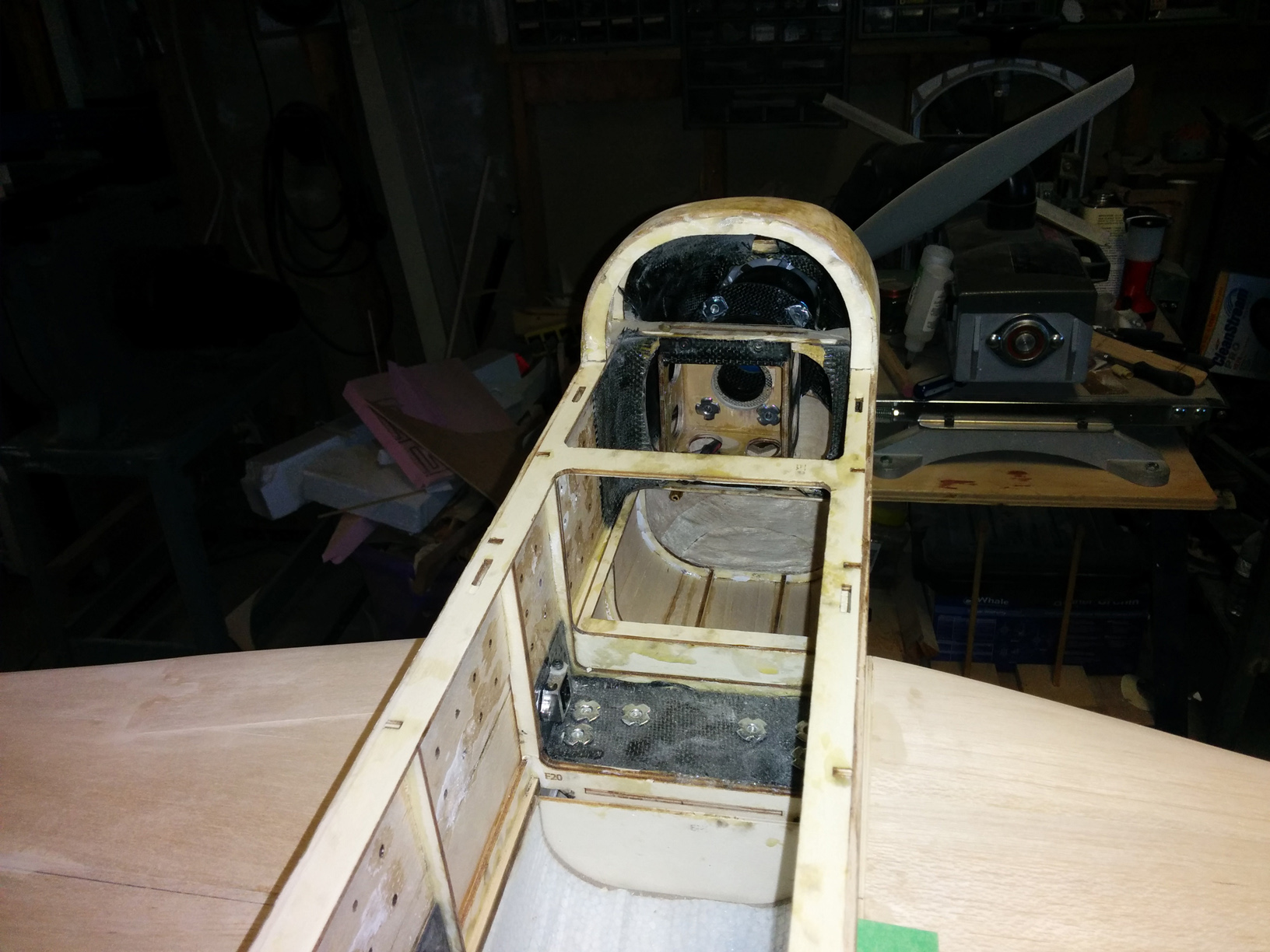

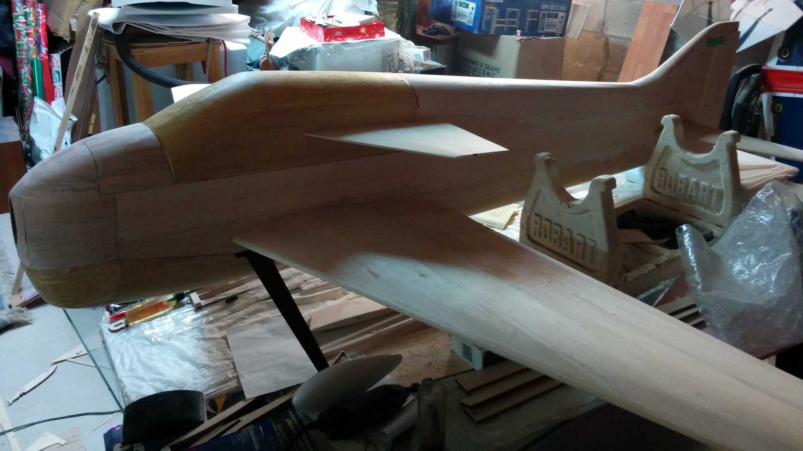

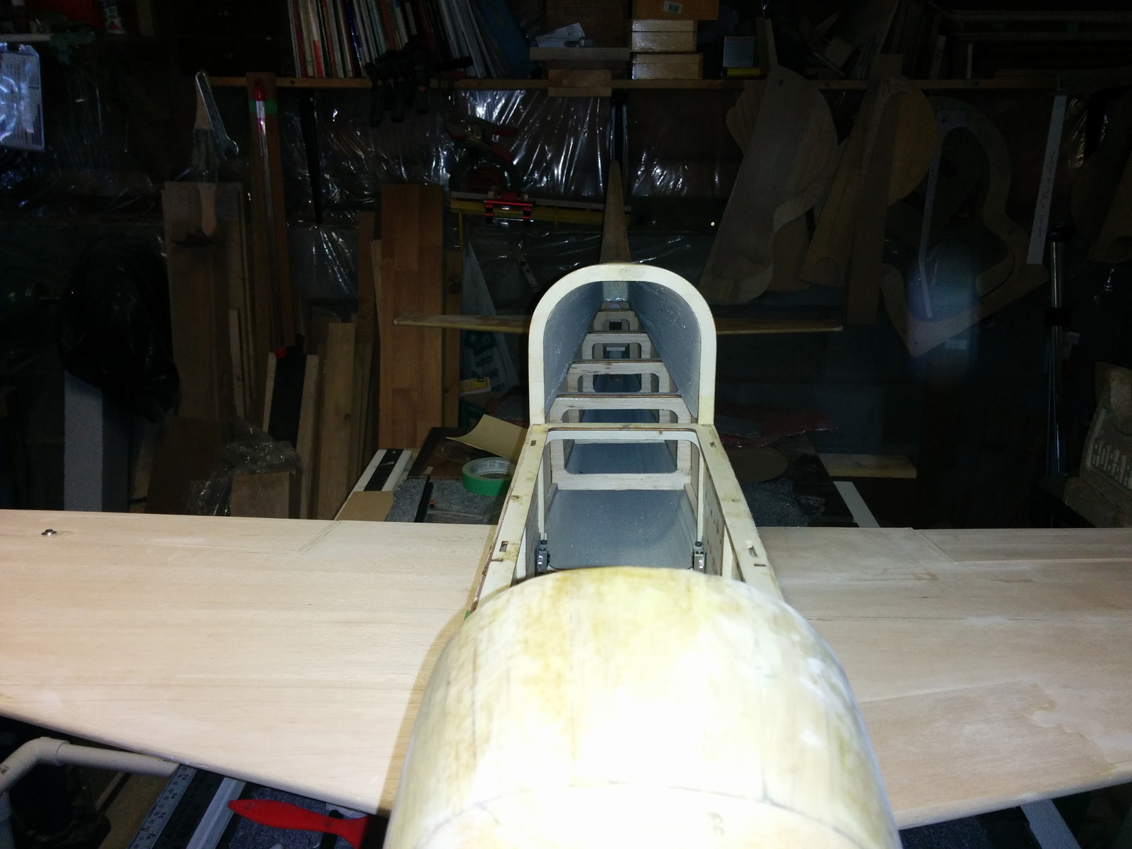

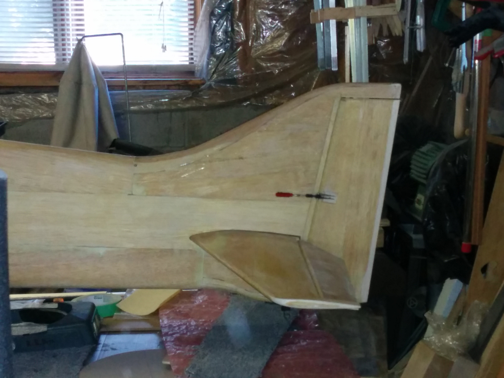

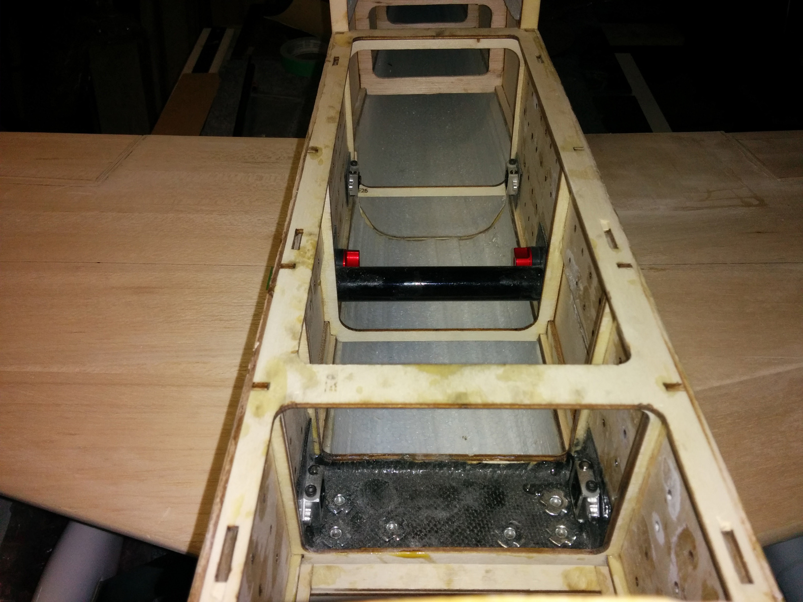

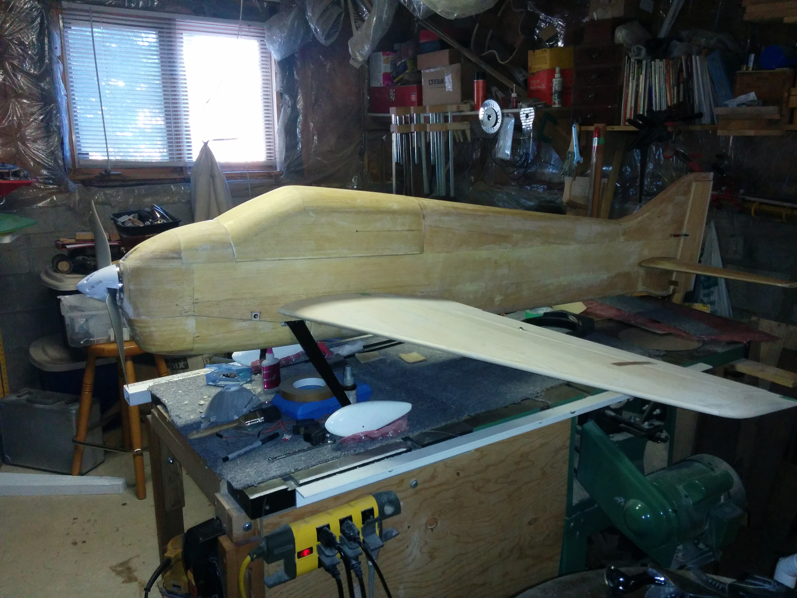

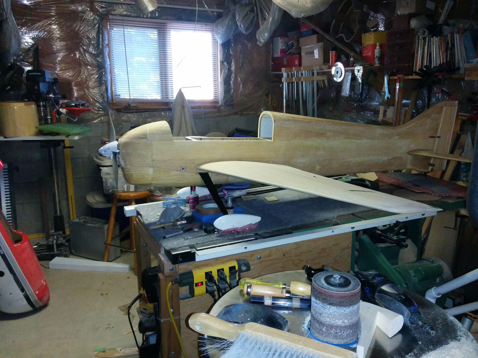

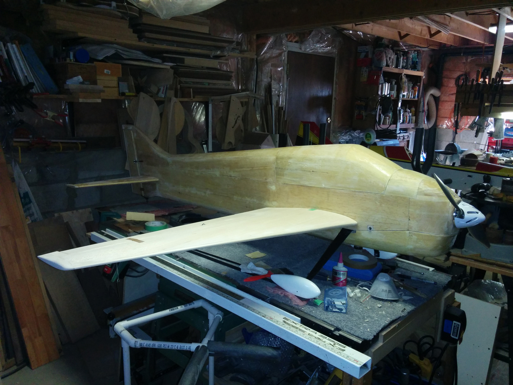

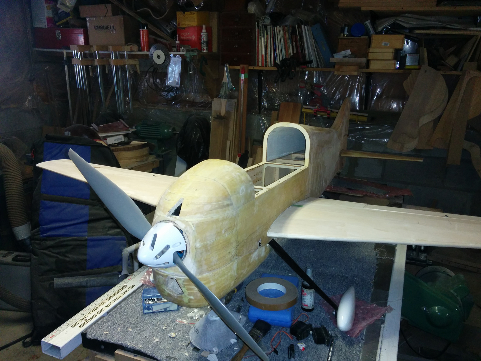

Yes, doing the glass route. Fuse and tail section has been done, wings, almost ready. Used 1/2oz cloth and Z-poxy finishing resin.
Here are a few more shots...
Himax Pro for power, rear mount (with small Hyde type mount incorporated). Jetti Spin 125 opto for control. Dual CF control horn for rudder (similar in concept to the Ralph Schwiezer CF control horn), BJ wing adjusters from F3AUnlimitted and CF wing tube and adjustable stab (along with other hardware and a power setup, 5400mh cells, cellpro charger, must thank Mike for help there). You can see a bit of the CF reinforcement inside. I had small Hitech servos mounted in the stab but came out tail heavy (before sanding etc.), moving to deps with a single JR8231 (same on ailerons and rudder). Old style Bolly CF landing gear and pants I managed to acquire from Australia.
