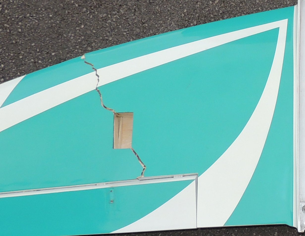

I've recently badly damaged the wing from my Oxai Axiome + and as such is not repairable by me at least. The rest of the model is undamaged but consequently un-flyable. I have asked Oxai for a replacement but the wing is out of production. I wondered if there was anyone who would have a spare wing or could undertake to build a new wing for this model? It is the version with the curved leading edge. It's a bit complicated by the fact it is a custom paint job so I could send the wing over for paint matching as required.

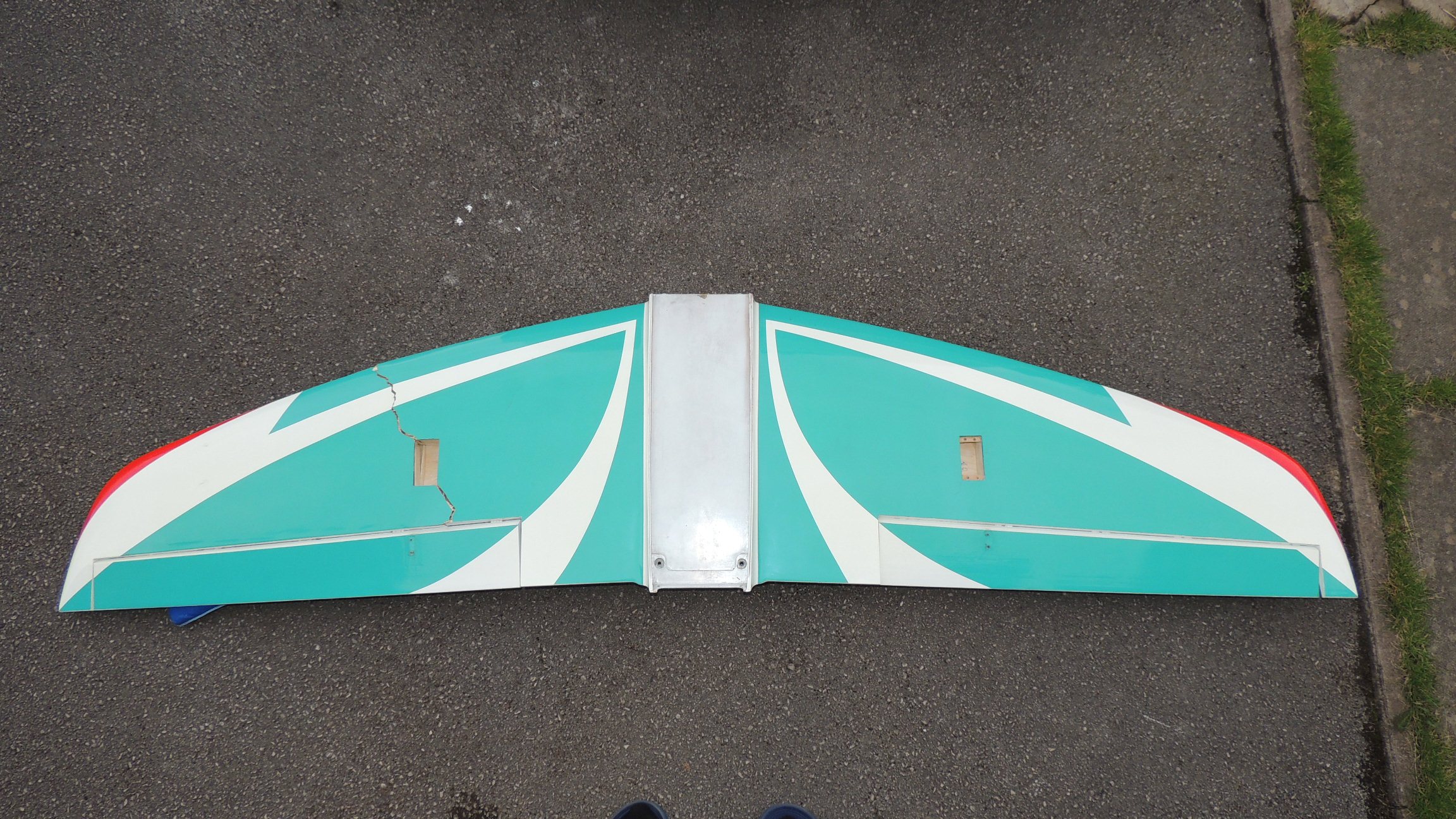

I think its unsalvageable; see below!
Hi Mavros,
I beliebe the Galactika is a two piece wing whereas the Axiome + wing is one piece
Best wishes
Keith

I can't really tell how much damage there is from the photos, especially internally. Still, the wing is essentially intact. If there is a professional builder to be found locally, they could make a better assessment. I think papaone (his RCU handle) over in France could help, too ( he just built a very similar wing from scratch - it is in another thread here in the pattern forum). The existing wing could be reverse engineered to produce a replacement, too.

Thanks for your reply Will, I think this pic might show the damage clearer. The wing is only held together by a portion of the top skin. Even repaired its doubtful it could be made cosmetically acceptable and as the models on the weight limit, its not worth pursuing.
Best wishes
Keith

Sent you a PM, it can be repaired and weight should not change more than 30gr.

Mate it doesnt look that bad I think it is repairable.Pleae post some photos if you decide to repair it,,

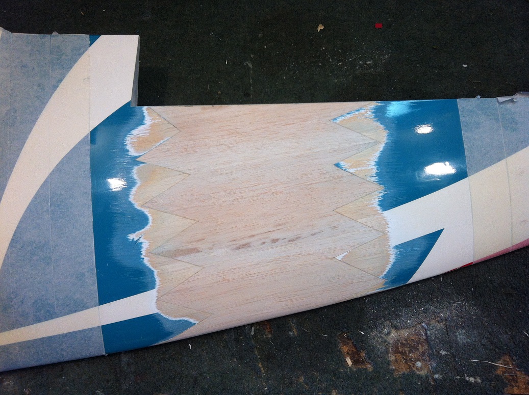

that wing is totally repairable. I have fixed worse. CA the skins together to align the wing. then cut out top and bottom sections to splice the spars and leading and trailing edge. glass and refinish. should be able to keep the weight accepta
Old 09-10-2015 | 06:47 AM
Joined: Dec 2004
Posts: 67
From: hot springs, AR
that wing is totally repairable. I have fixed worse. CA the skins together to align the wing. then cut out top and bottom sections to splice the spars and leading and trailing edge. glass and refinish. should be able to keep the weight acceptable. the key is the approximation of the skins for proper alignment. Ca everything you can then go internal and fix it.

Hi,

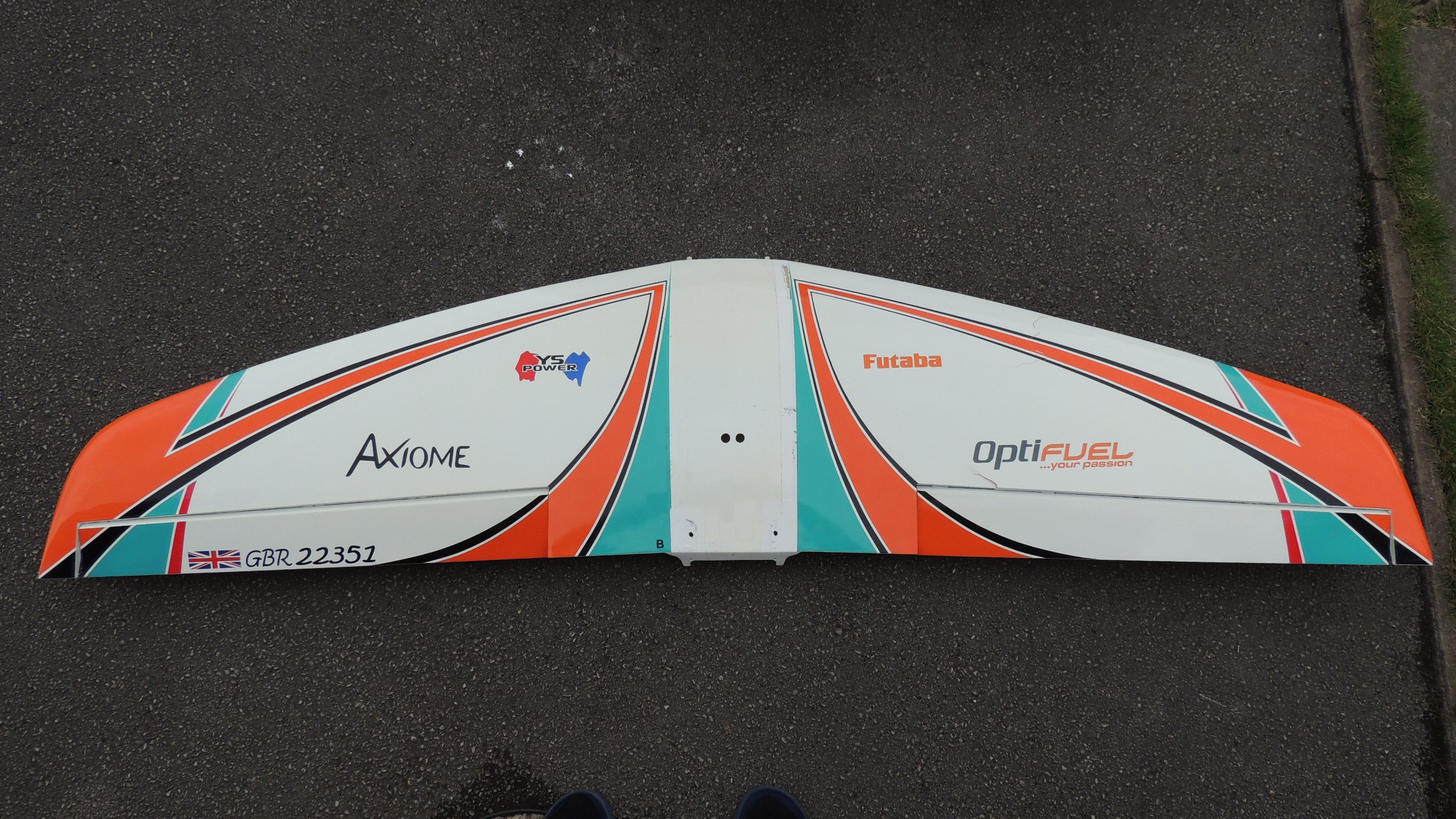

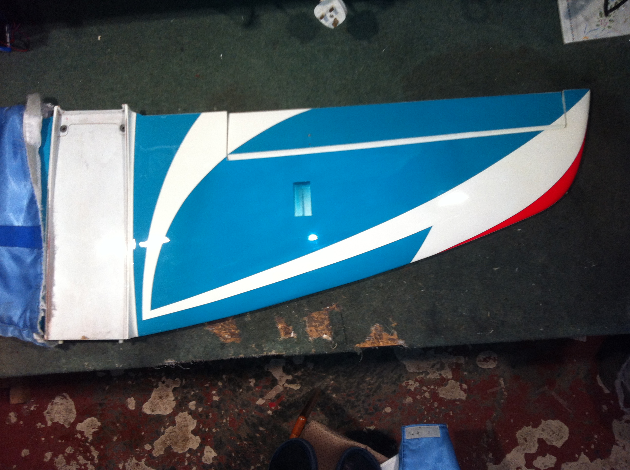

Just an update from where I was a few months ago and thanks to you all for your messages of support. Wing is now fixed, a little heavier but not disastrously so. Just waiting for an opportunity to test fly...
Best wishes
Keith

Very nicely done!

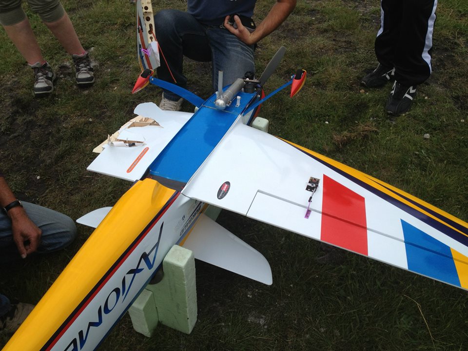

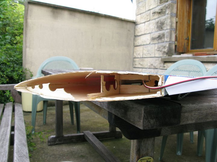

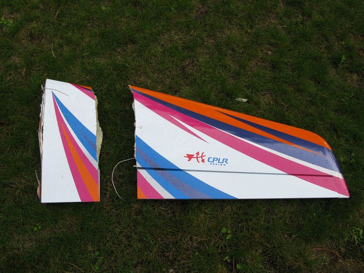

Hello

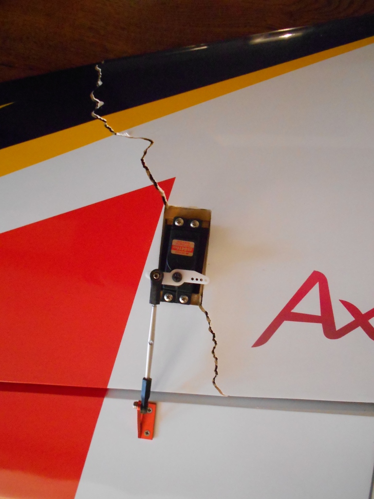

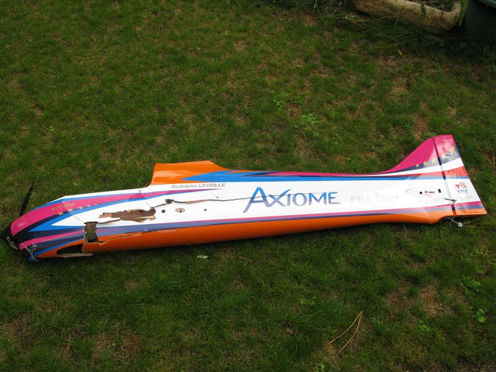

Same failure on Axiome of Leo Heckmann was arrive.
On Axiome of Rodolphe Leveille and Loic Burbaud failure was différent but result is the same.
Fuse of Loic is in Great Britain but I dont remember who bought the fuse. Keith may be know.
Claude

Is this failure due to a collision or a design fault by the manufacturer?

Old 01-10-2016 | 05:39 AM
papaone's Avatar
Joined: Mar 2005
Posts: 1,414
Received 137 Likes on 74 Posts
From: Salon, FRANCE
Hello Mavros
Failure due to Manufacturer.
On Rodolphe Axiome and Loic Burbaud, It arrived after snap.
So Rodolphe was more unlucky, fuse was destroyed.
Claude
