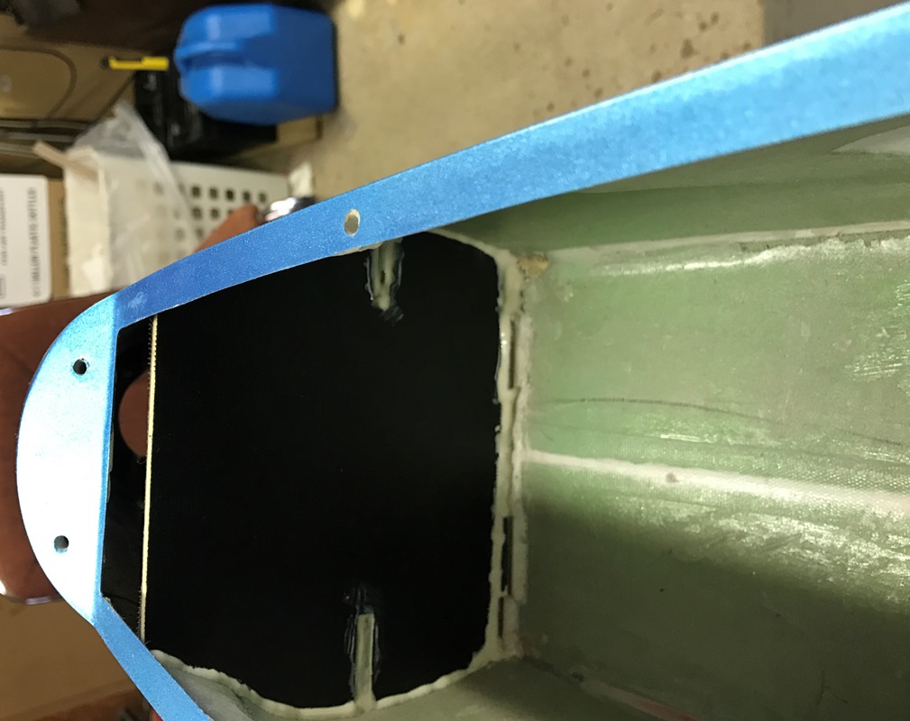

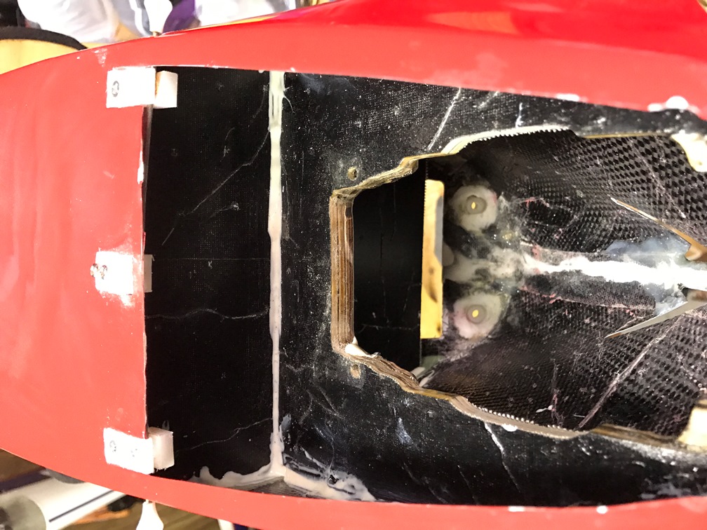

Next, trim and fit the fire wall plate to fit in place inthe fuse behind the beam plate. Be sure it keys into the beam plate asintended. It will fall behind front edge the canopy opening and sit on top ofthe plate that holds the chin cowl latch. Once it is fit in place, tack it witha couple drops of medium CA. Fit the small cap plate to sit on top of the firewall and the fuse to close the top of the firewall engine compartment, butdon’t tack it in place yet. Using a syringe gun and thixotropic epoxy (i.e. itstays where you put it) like Aeropoxy, run a bead along both sides of the beamplate and firewall to secure it in place. Then set the cap plate in place andtack it with medium CA, and seal it to the firewall and fuse with the Epoxy.Make sure the engine compartment is totally sealed from the radio compartment.Allow to dry overnight. See pictures below.
