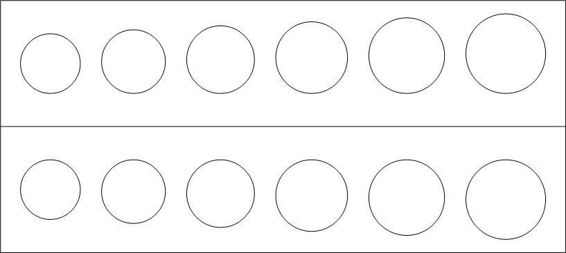

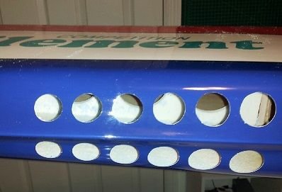

Vent template

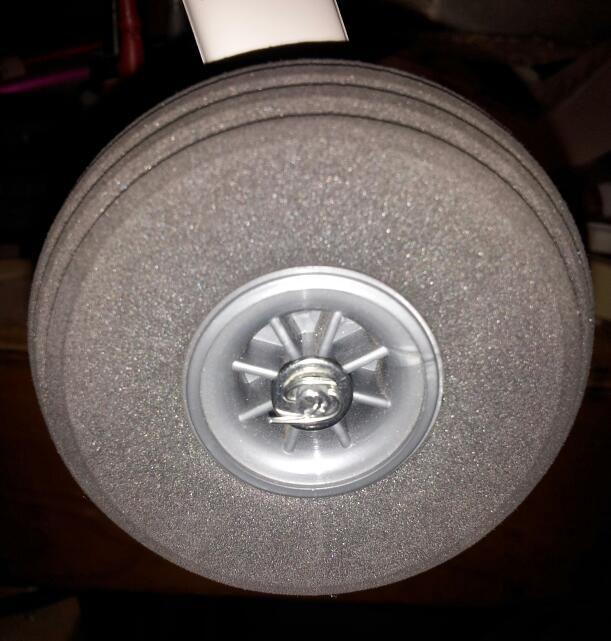

No wheel collars. No lost wheels.

Originally Posted by vatechguy3
Which axles are those?
how do you mount the wheel pants?
want to sell a pair of those stiffeners?
tony
tony
Those are Dubro axles. The wheels are put on and the axles are measured and cut. The end of the axle is heated to orange, cooled, and a small flat is ground on one side. Then a hole is drilled (maybe #60) at the ground point thru the axle to accept a short piece of .032 aviation safety wire. A washer or washers are used for spacing. You will not lose a wheel in a contest using this technique!
I fly on turf, so there will be no pants and the associated hassle.
Wheels are Dubro Lite 2-3/4".
I cannot guarantee the function of the stiffeners as the plane has not flown yet, so you're on your own. They were designed with scraps of information I gathered word-of-mouth. Kyuho Lee checked the photos and felt it functionally matched the structure he added on his Agenda, but I deviated from what he actually did by adding the front stiffener instead of carbon tow around the front screws.
What? No comments about the tailwheel?
-Ron

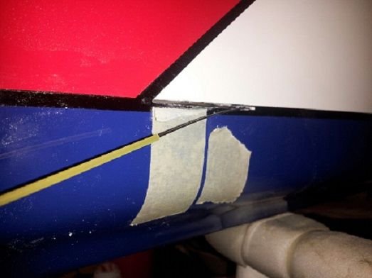

Rigging Pull-Pull rudder.
