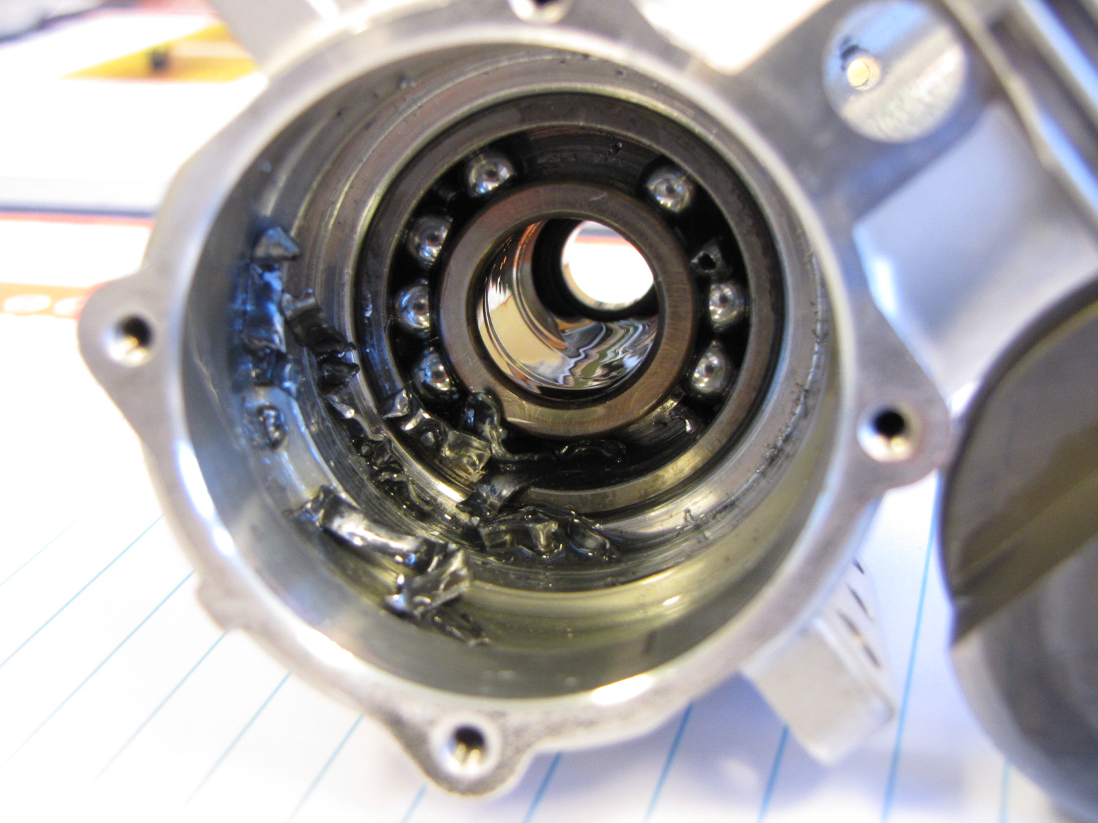

This is what greeted me 3 flights after winning my first comp with this engine. It clunked to a stop in the starting gates when I throttled up.
The crank ring sealing area was a bit dinged up, but not enough for YS to replace the crank case when they fixed it under warranty. Once this was fixed and the later problems sorted out in that first year it ran like a train..

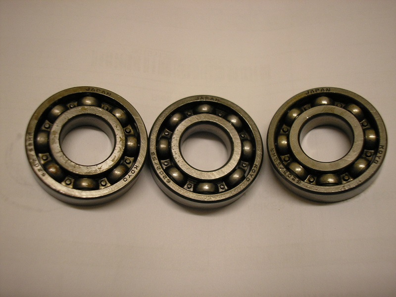

The cam gear bearing is the bugger, the one in the cap comes out just fine with heat and a quick tap, but I always find myself bending up different shape pieces of wire and other oddments to get the crankcase one out. I've vowed to make up a tool but I'm just to lazy.
I just replaced the cam bearings with the ones I had in stock, and you can change them without pulling the head (or throttle) off. I just slid the tappets off their pivots, pushed up the lifters, pulled the cam gear, removed the lifters, pulled the bearing and put it back together in reverse order.
I did put a timing mark on the prop driver first though!!
