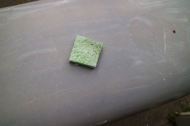

Old 06-29-2018 | 03:03 PM
  #211
RodneyFord's Avatar
Joined: Apr 2015
Posts: 424
From: Lower Hutt New zealand
Plenty of pinholes.
Applied light weight filler thinned with water. Easy to put on and easy to sand off.
I will end up with just a very thin layer of undercoat.
