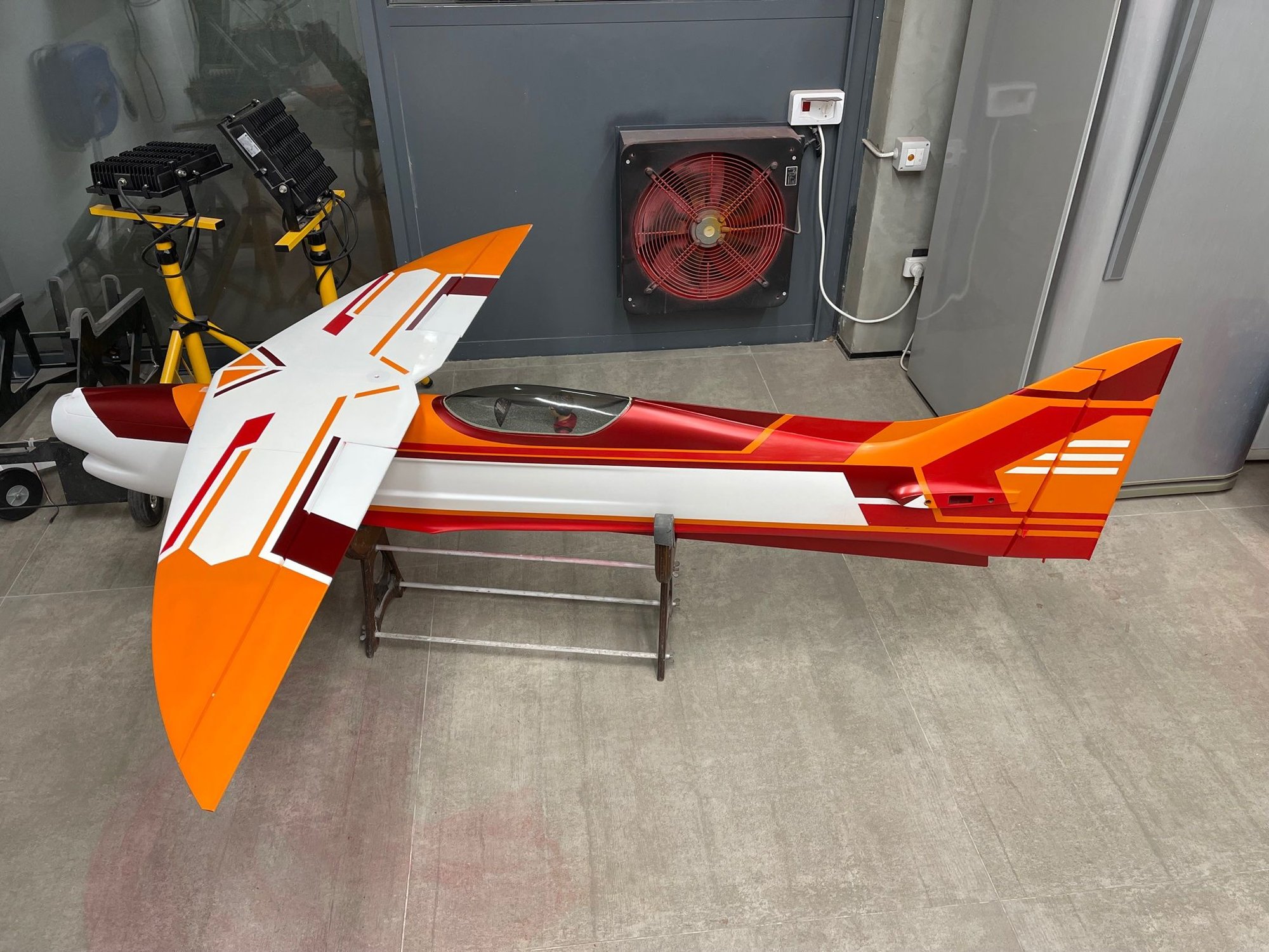

Does the Karat have have any wing stagger. Most designs seem to have some positive stagger but looking at the interplane strut arrangement on the Karat it may have no stagger or possibly negative stagger. While positive stagger may improve lift efficiency this doesn’t make sense with an aircraft that spends half it’s time inverted where positive then becomes negative stagger. I guess the best arrangement would be zero stagger. Maybe aerodynamically stagger doesn’t matter that much and then it just becomes a style issue, where a little positive stagger “looks nice” when the model is sitting on the ground and it looks right.
What do you mean by positive or negative stagger?

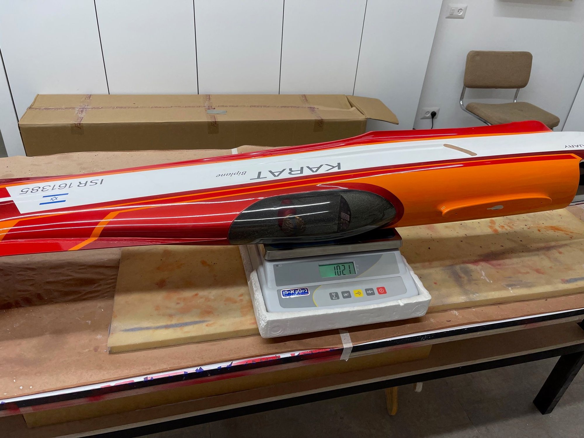

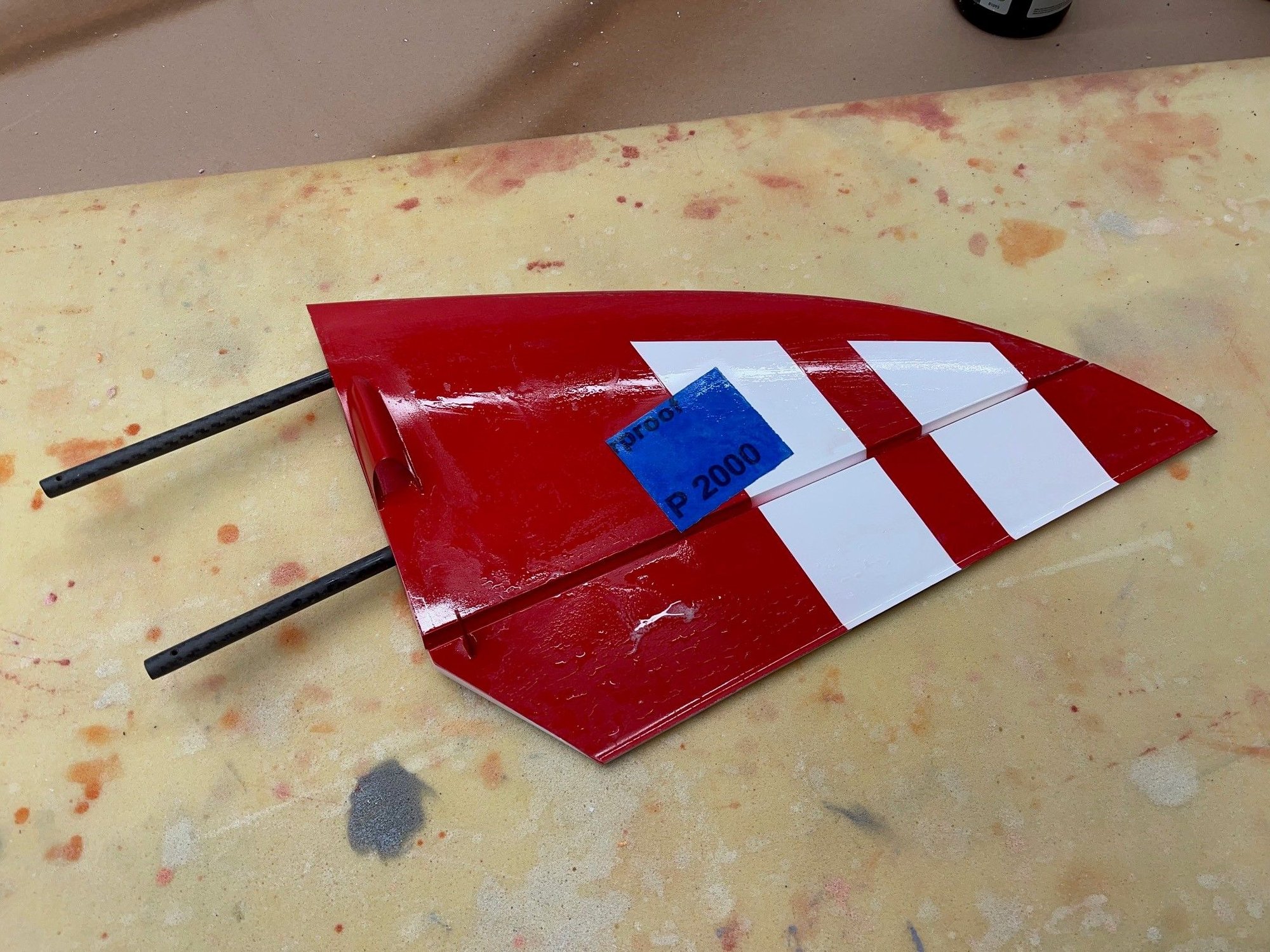

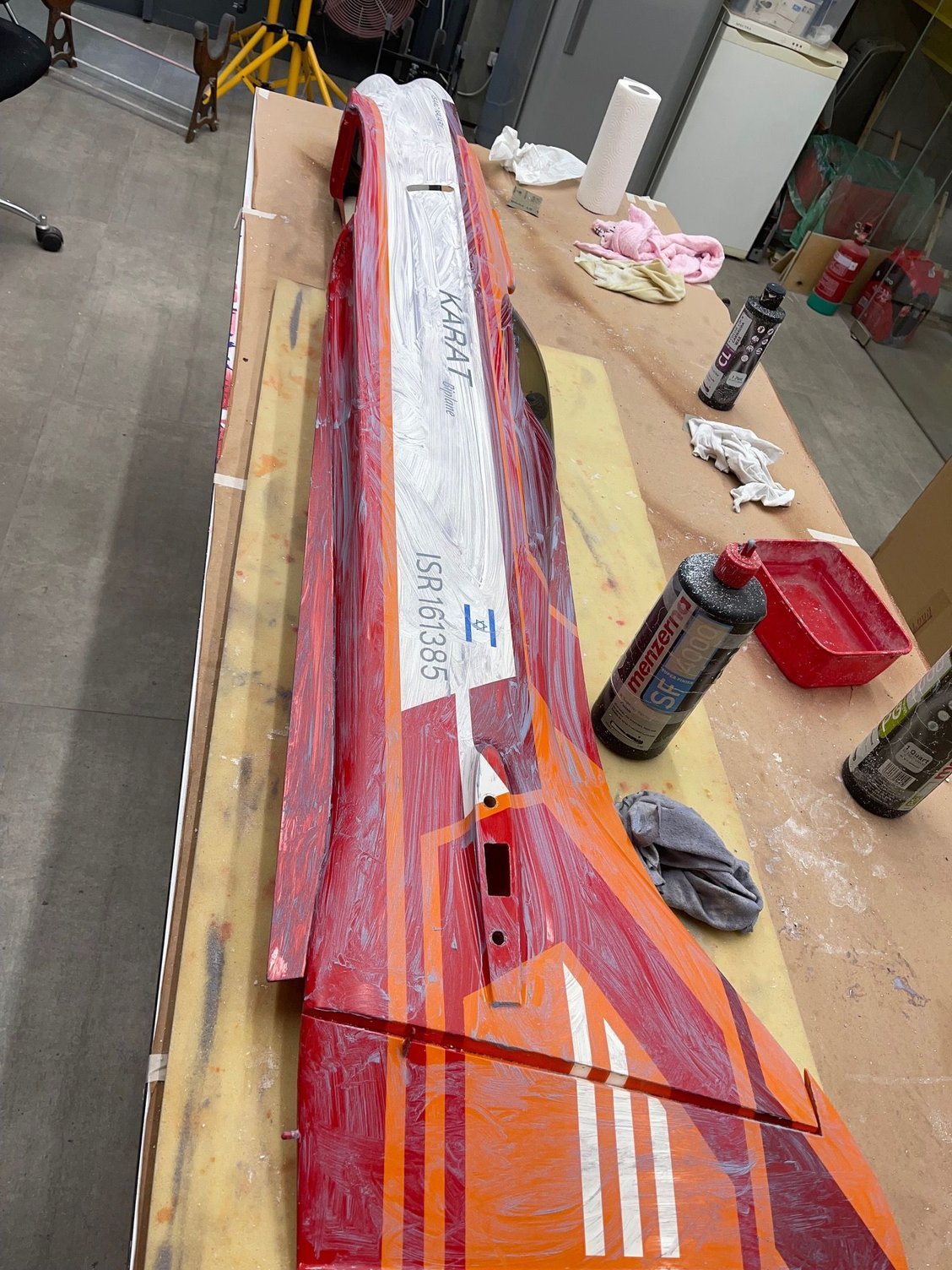

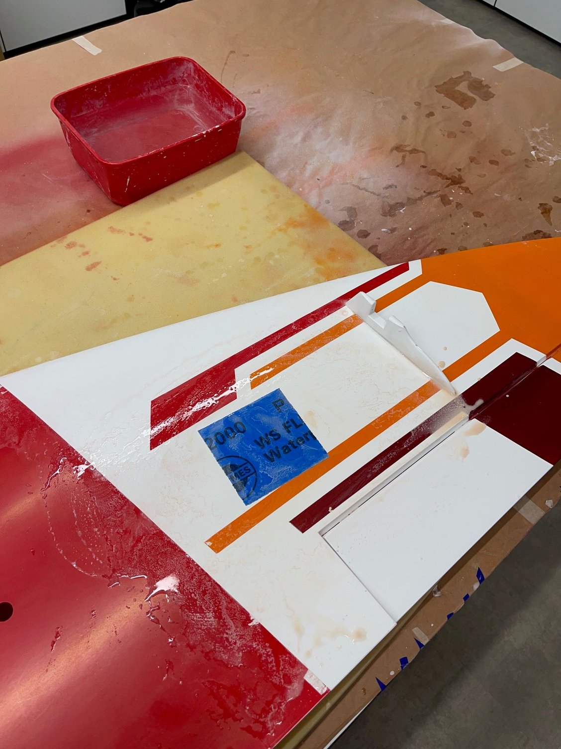

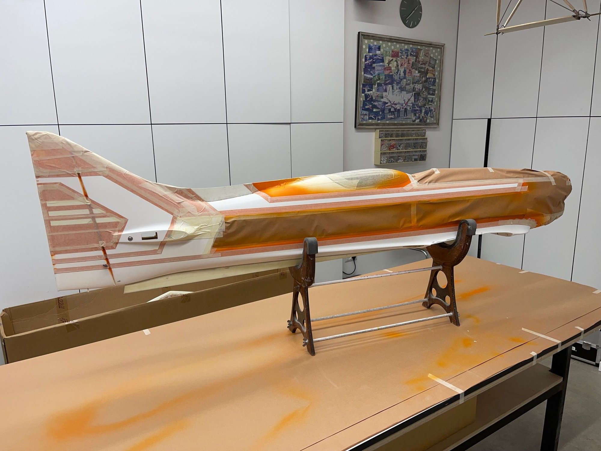

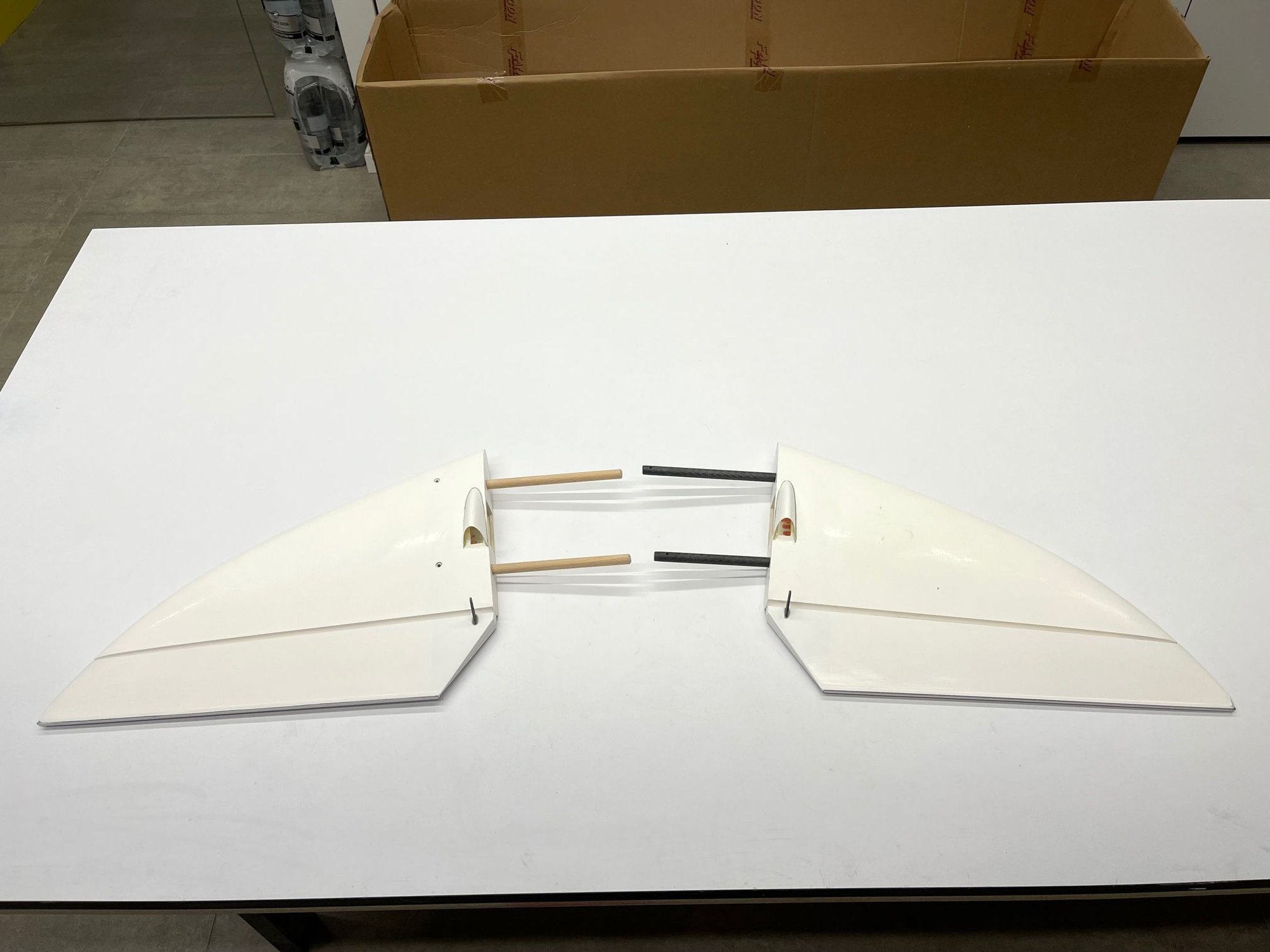

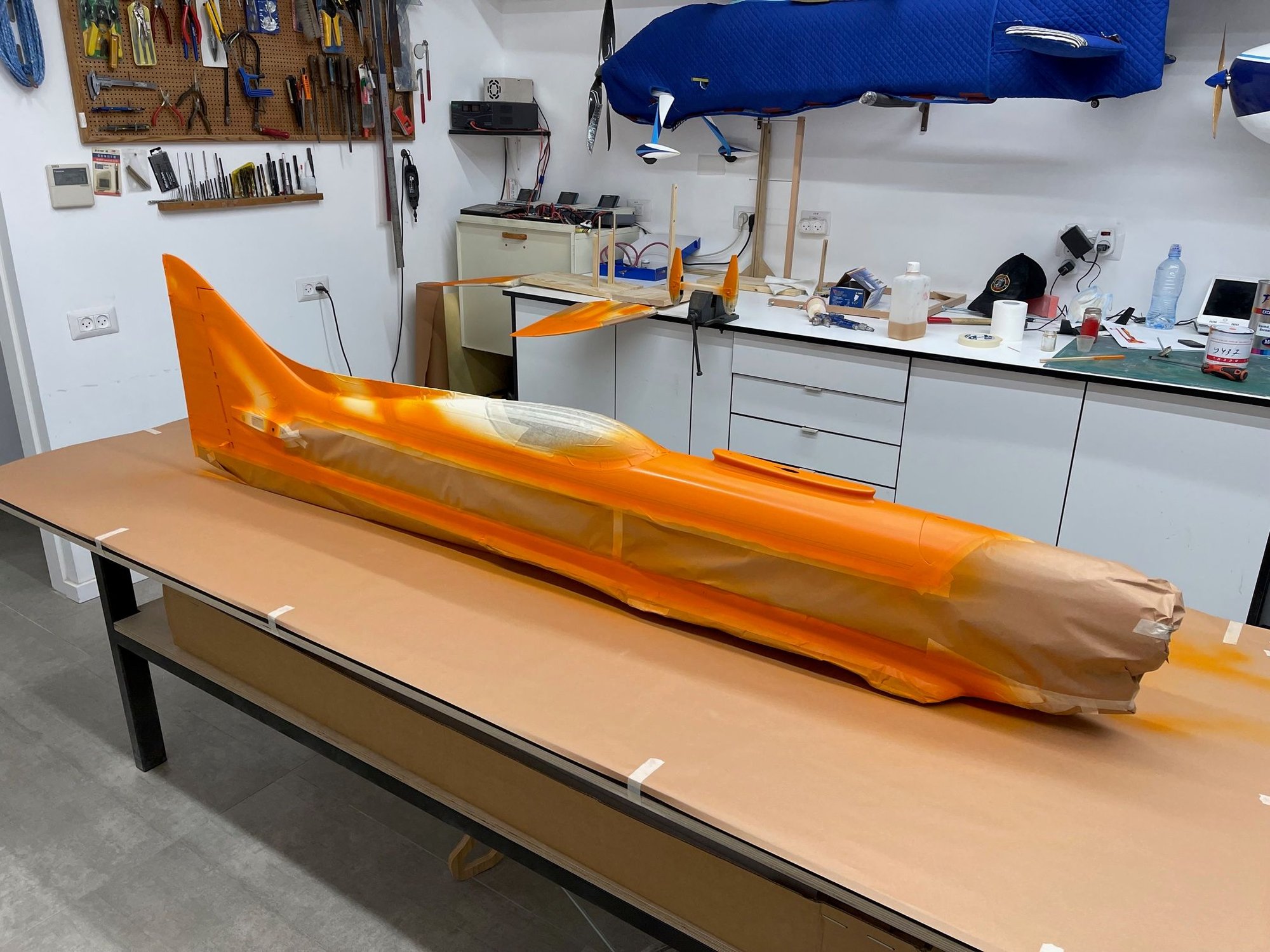

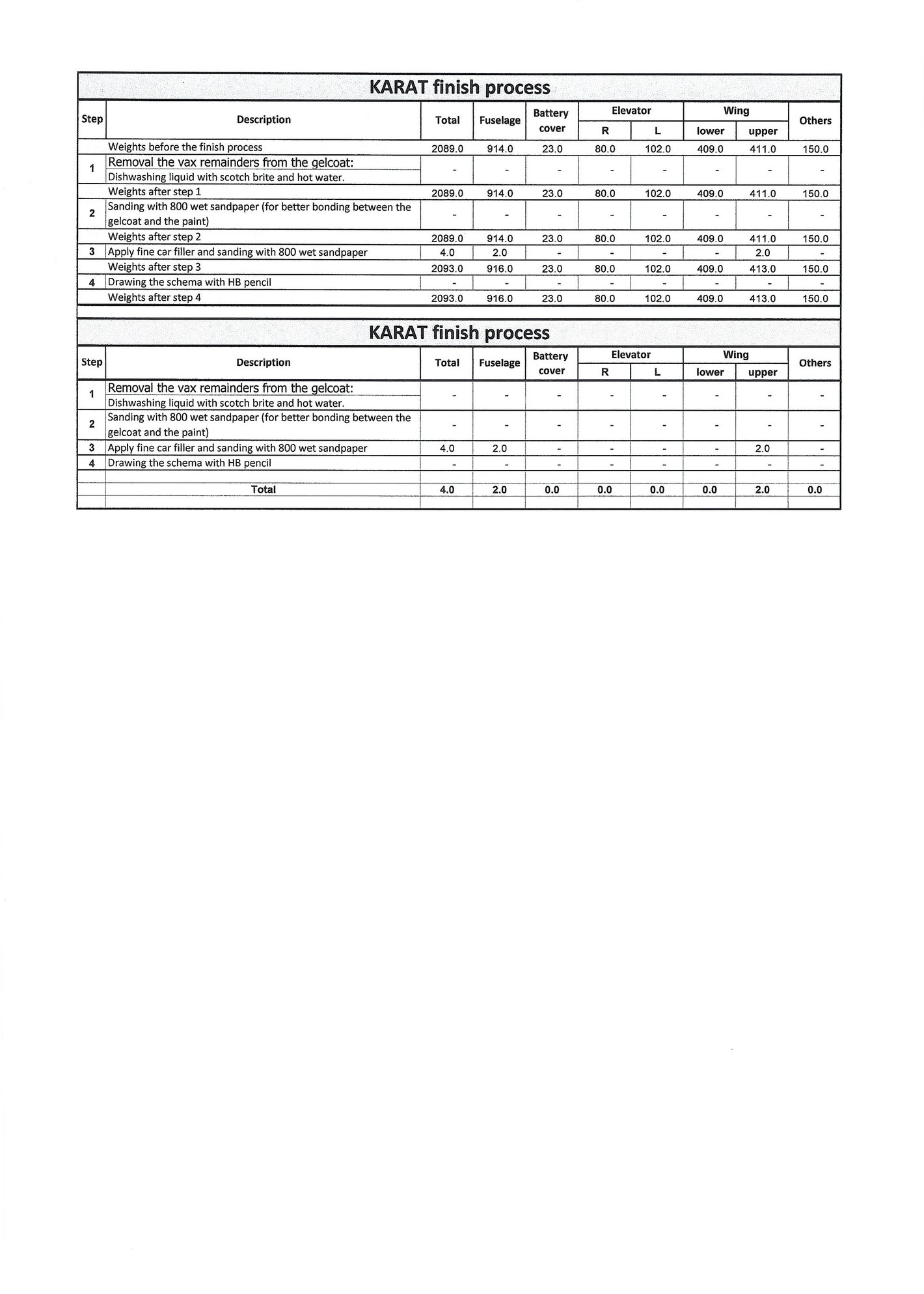

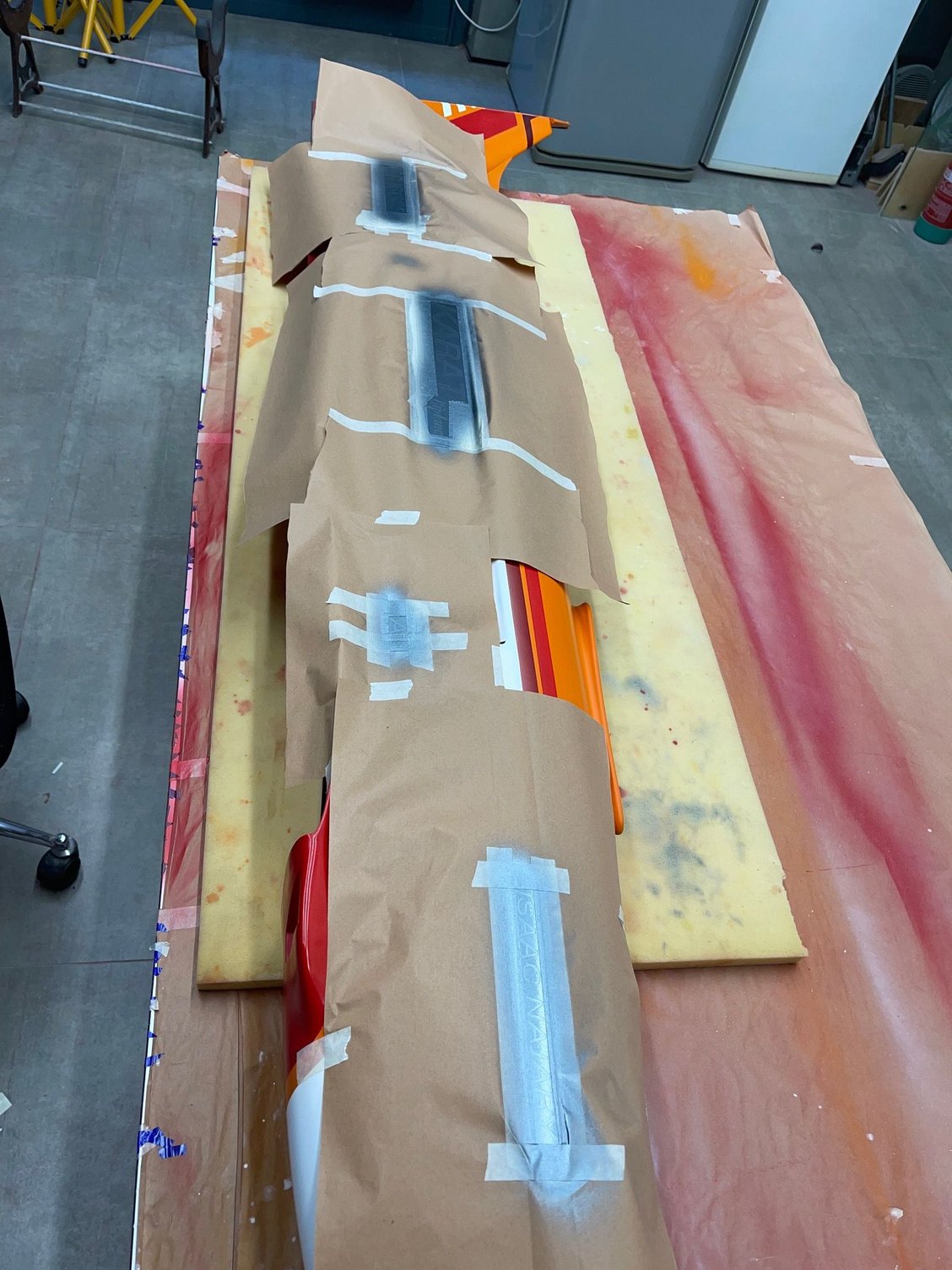

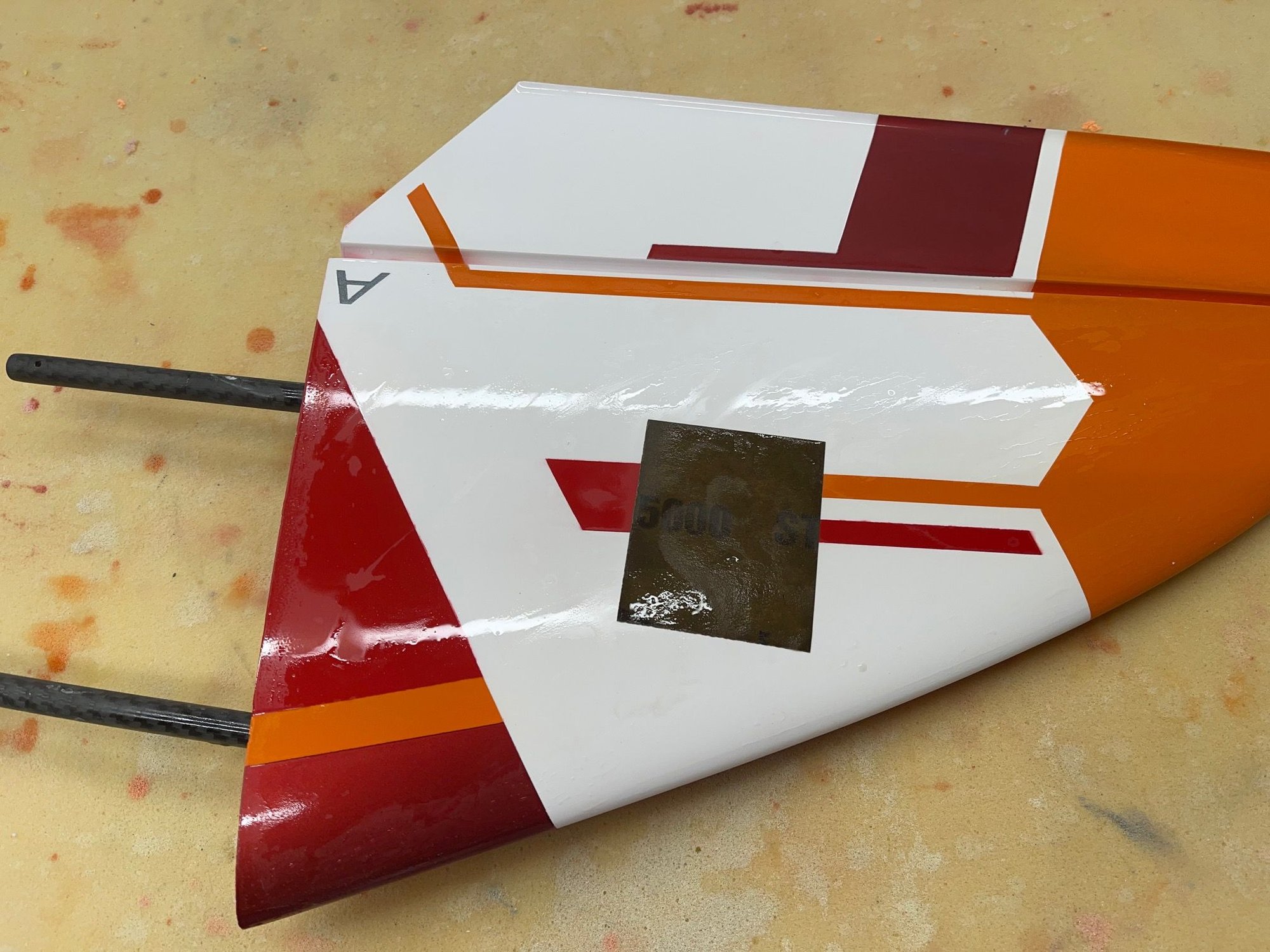

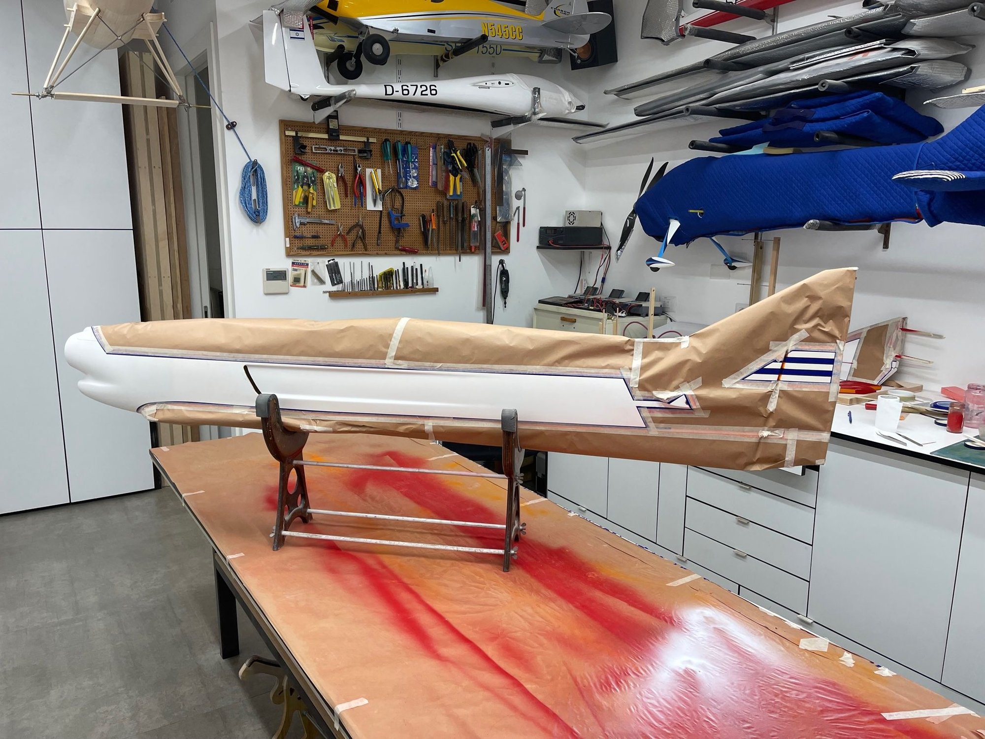

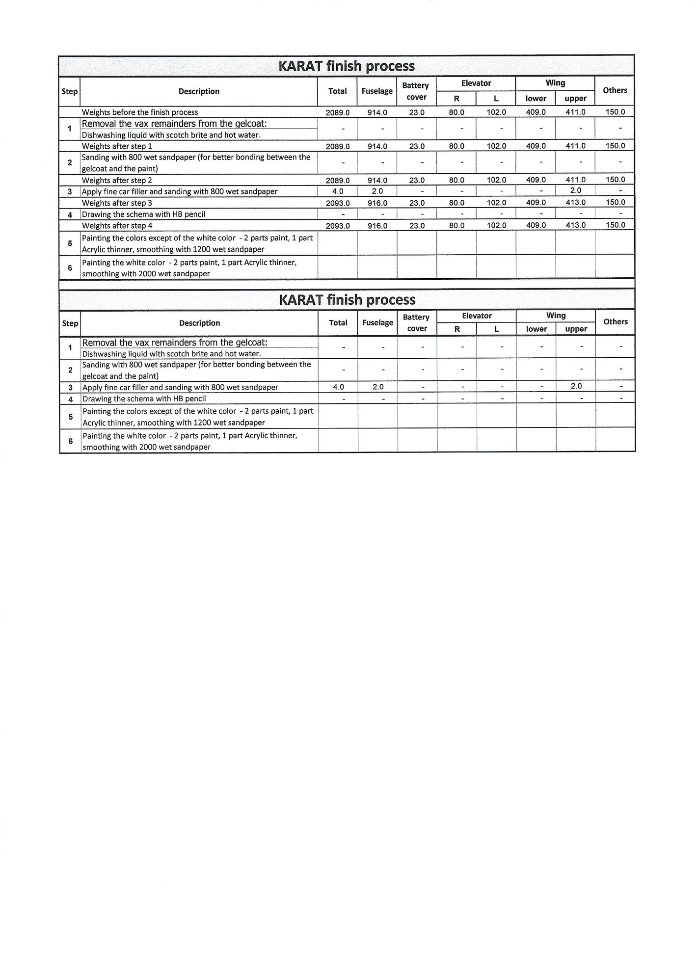

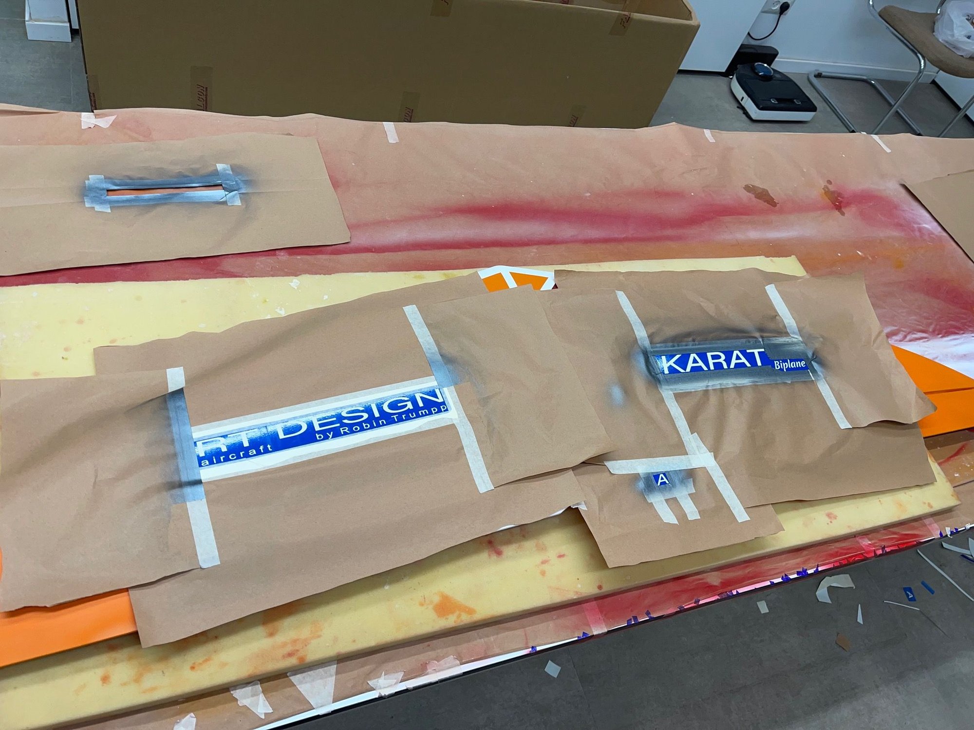

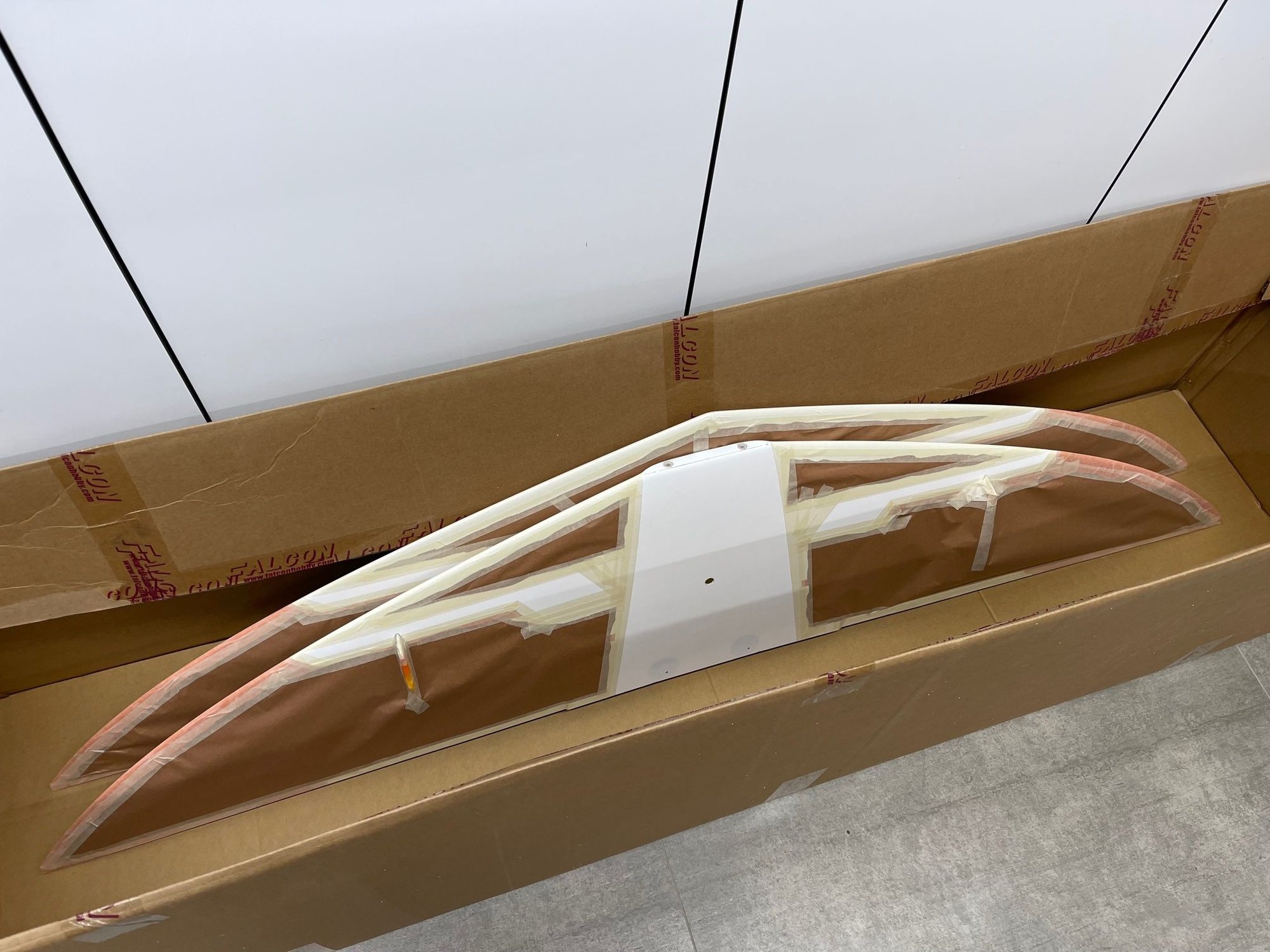

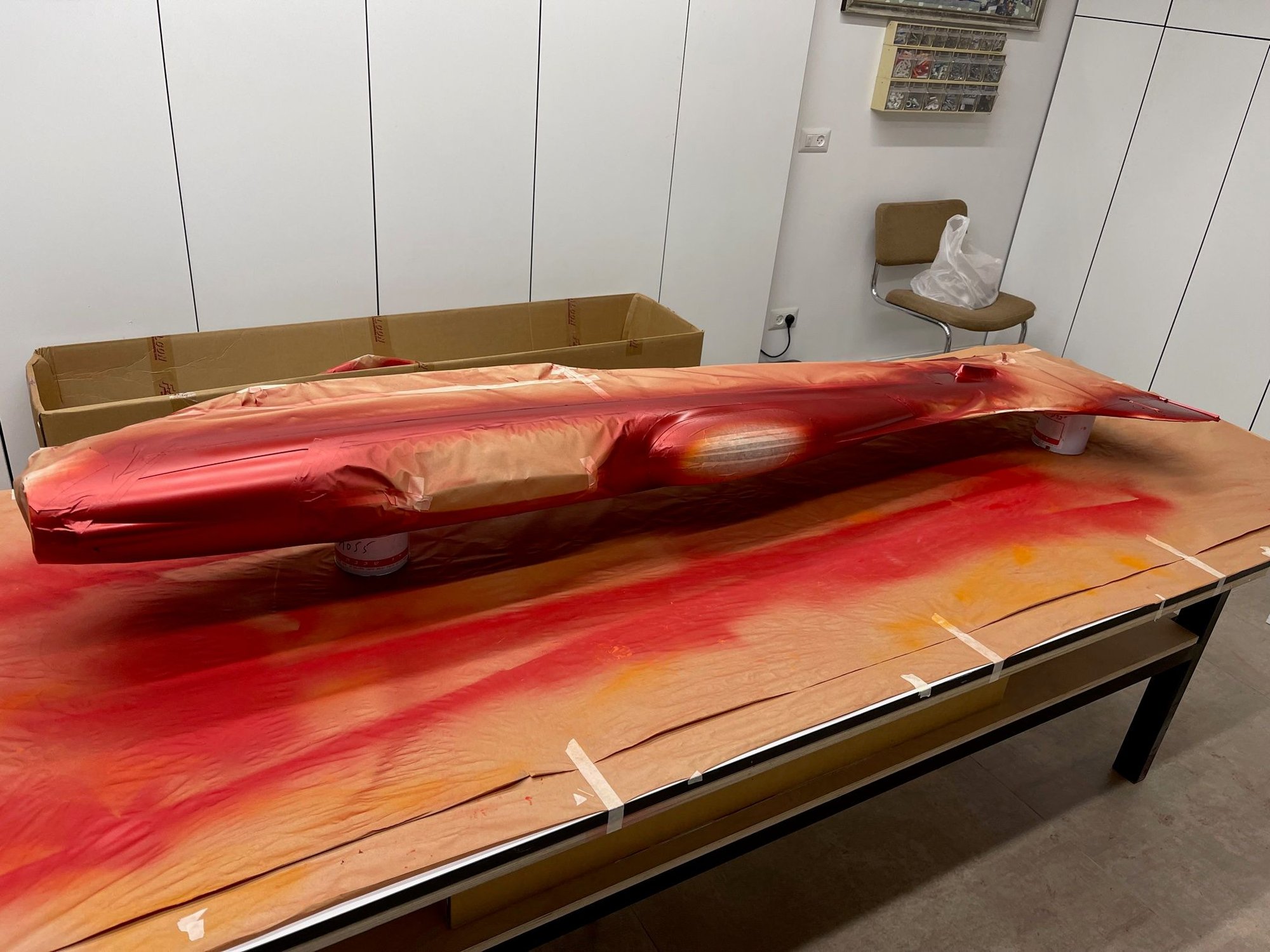

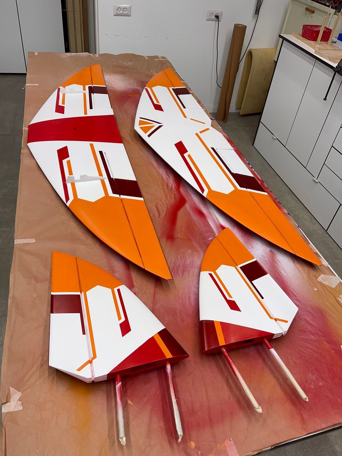

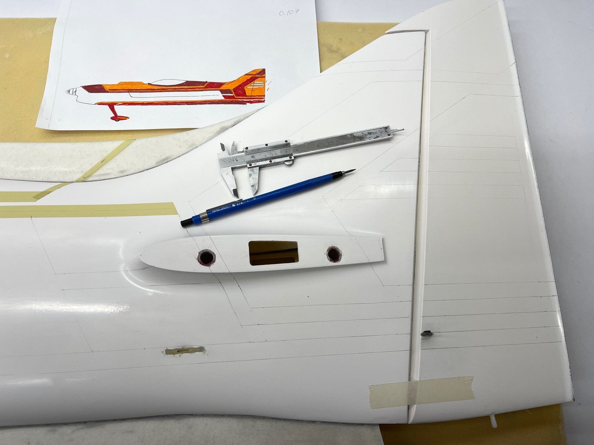

KARAT finish process - step 3
wattsup (10-10-2021)
Old 09-07-2021 | 04:34 AM
  #28
Joined: Jul 2003
Posts: 314
Received 21 Likes on 17 Posts
From: Montevideo, URUGUAY

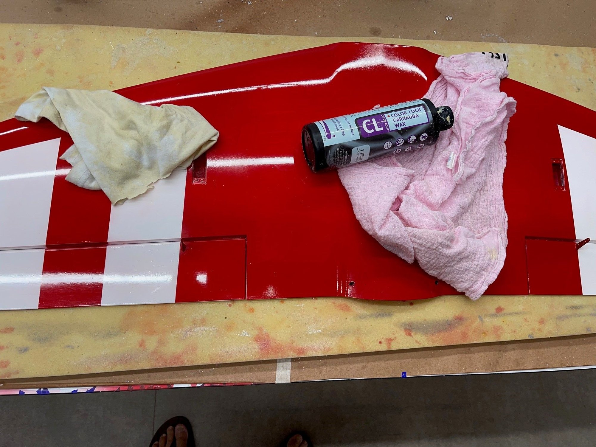

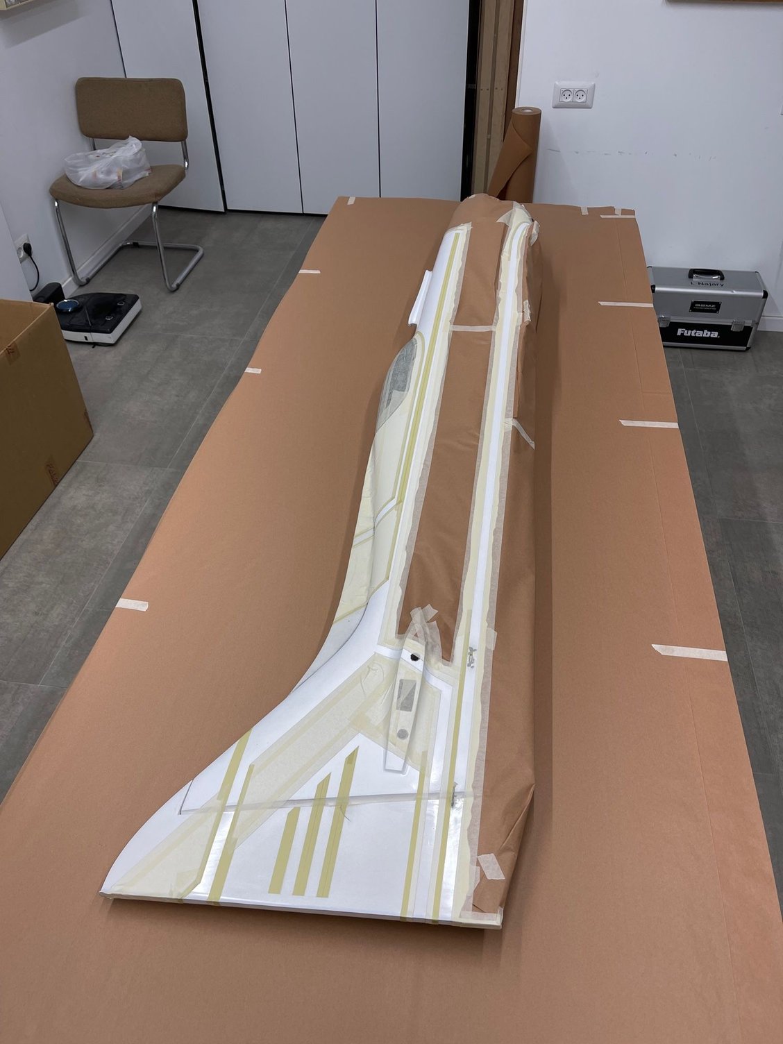

Originally Posted by najary

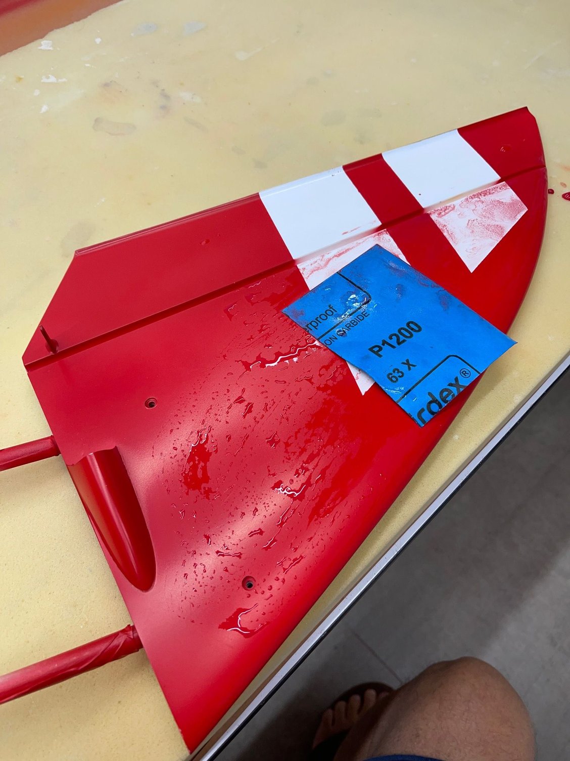

KARAT finish process - step 2
Isaac, silly question. How do you clean the fuse after wet sanding with dish washer soup?
Thanks.
Hi Isaac
My understanding is that positive stagger has the top wing forward of the bottom and negative the top is behind the bottom. With no stagger the top and bottom wing LE would be inline/square to each other with reference to the fuselage datum.
Thanks.
Hi,
This is not a silly question, after wet sanding I clean with soft cloth and methanol.
Best regards,
Isaac Najary

Originally Posted by bandicootf16
Hi Isaac
Hi,
The KARAT has no stagger.
Best regards,
Isaac Najary

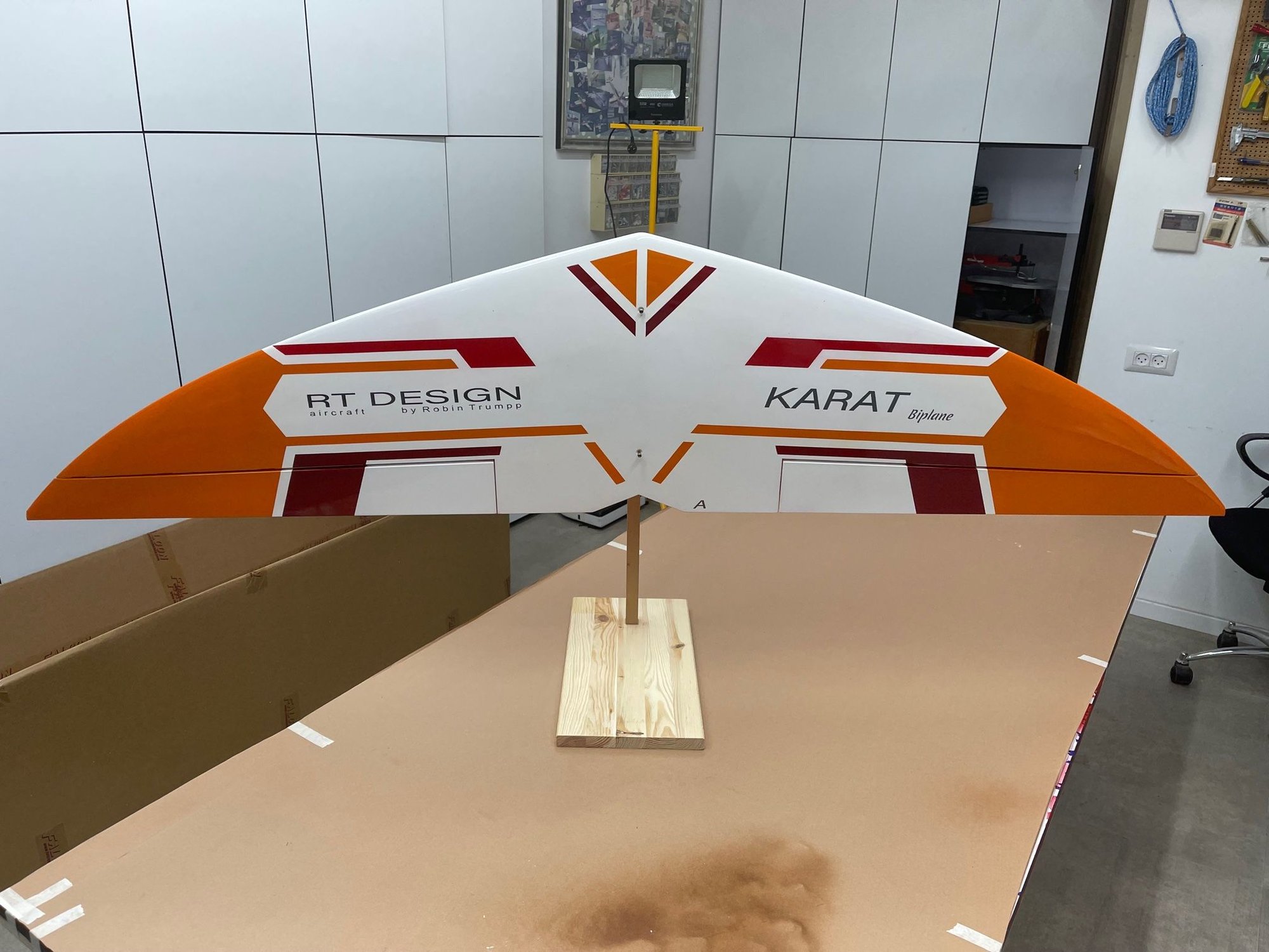

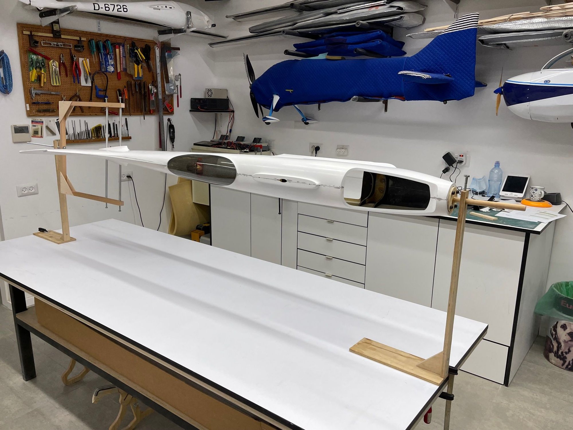

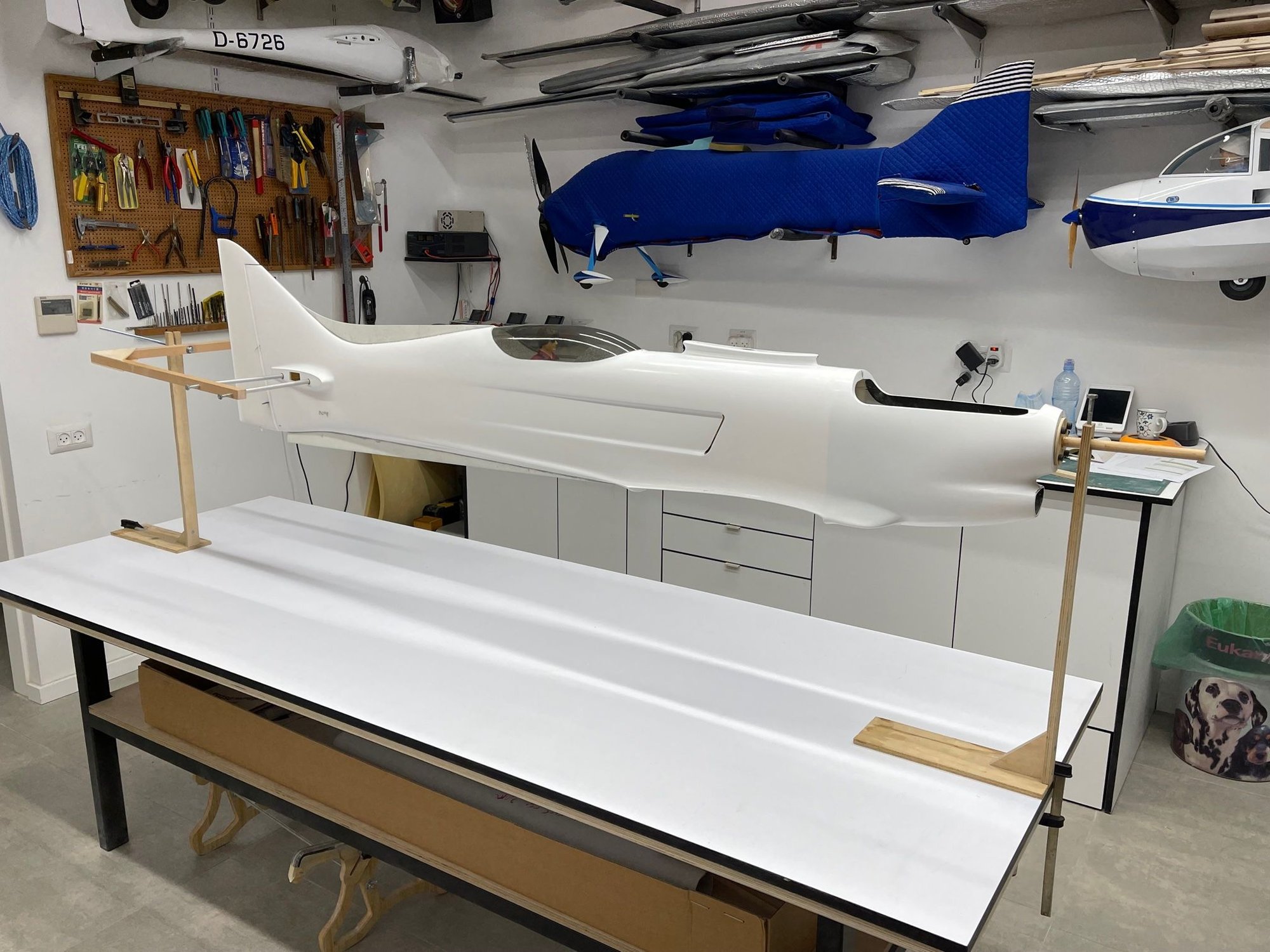

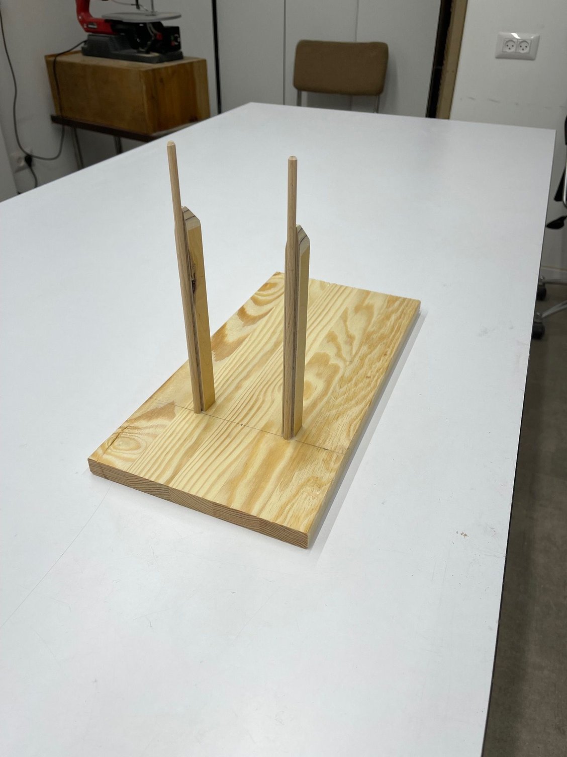

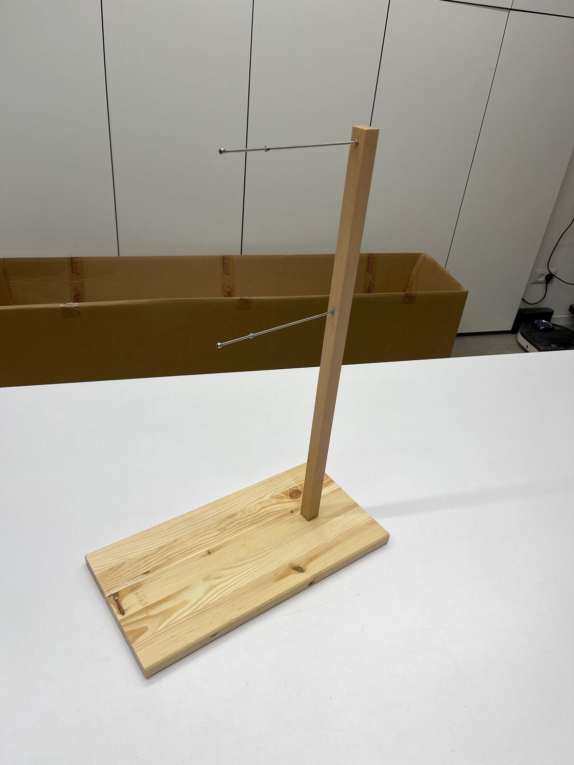

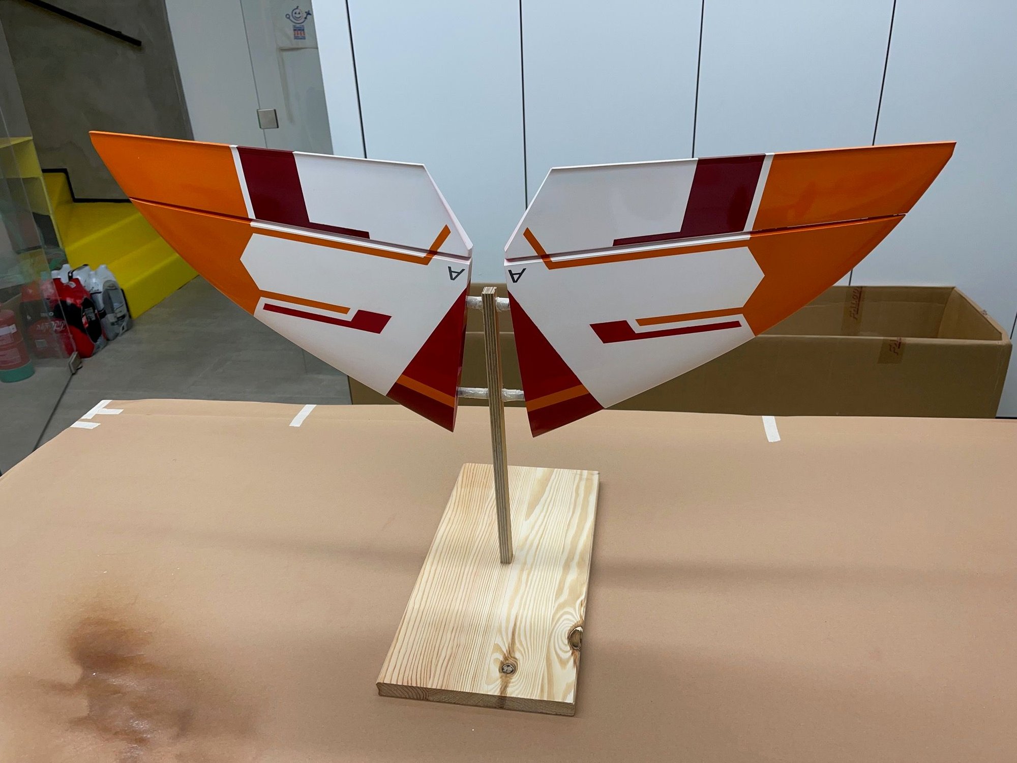

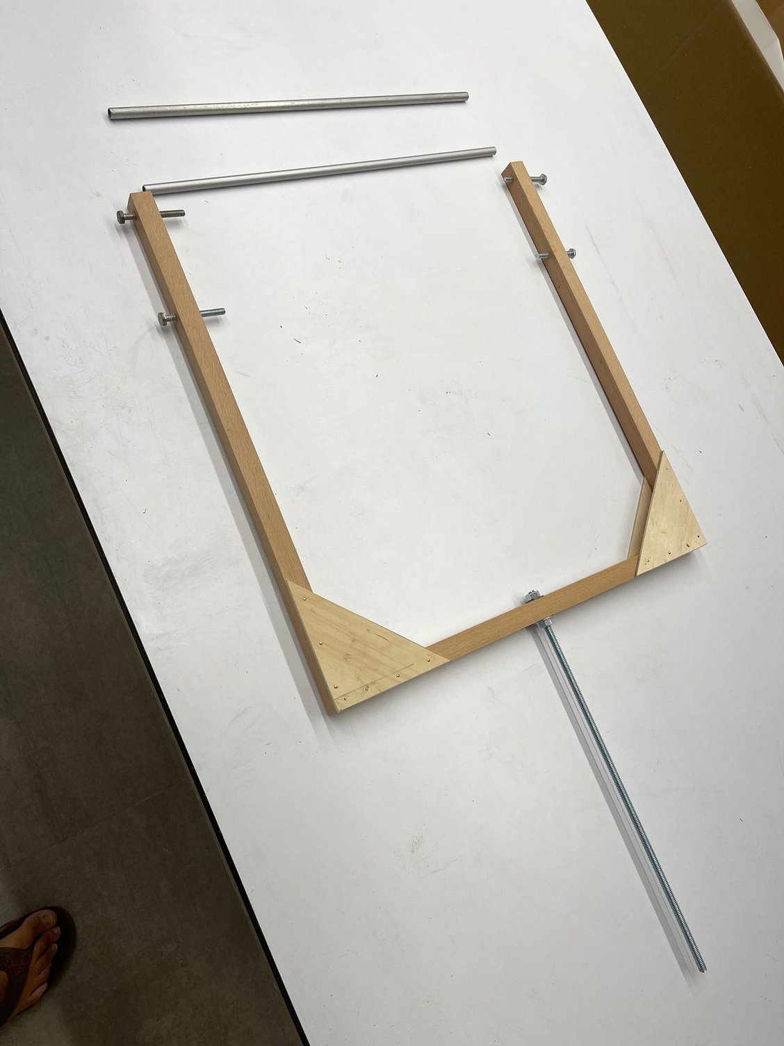

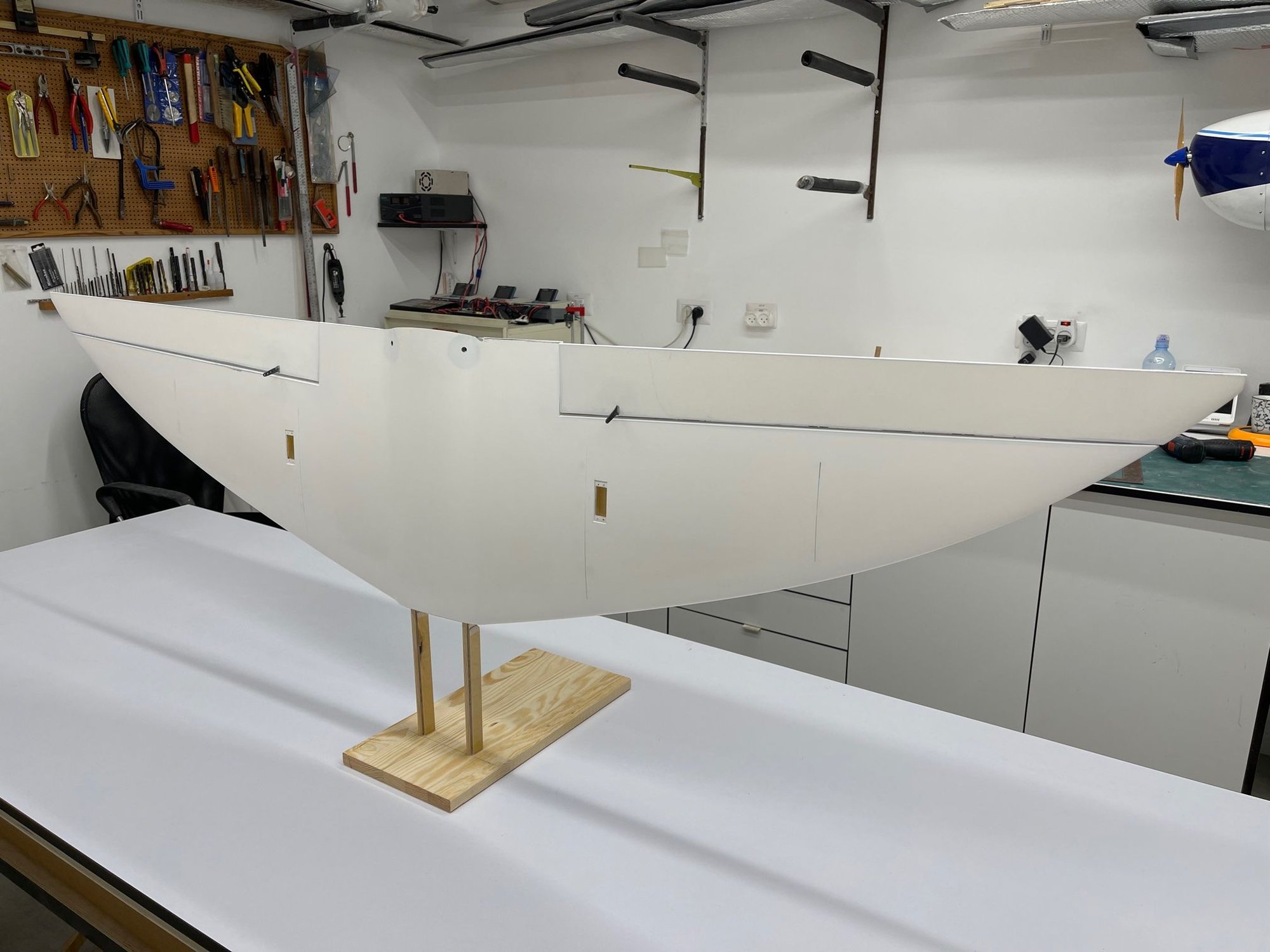

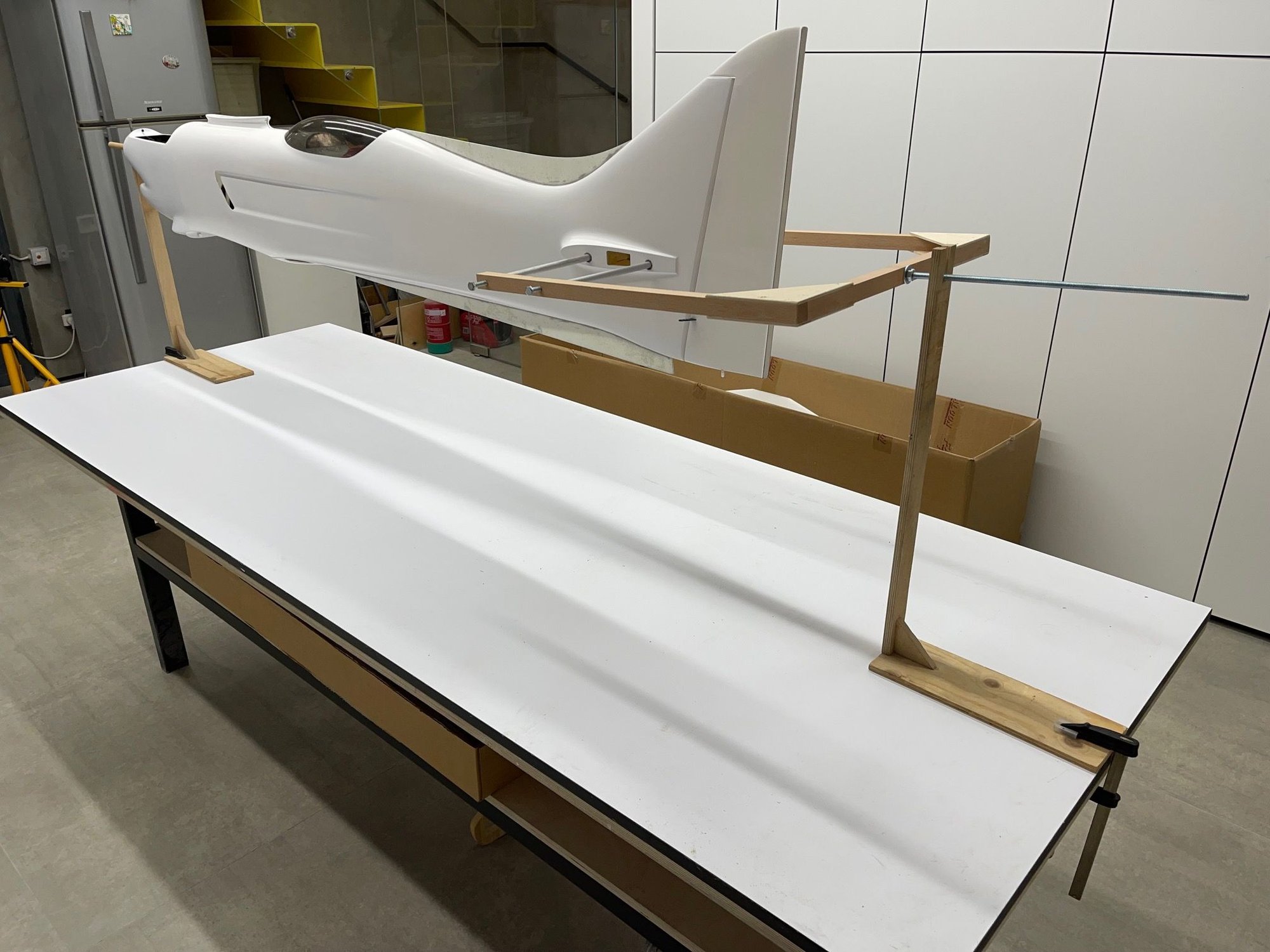

Preparing the stands for the clear coat

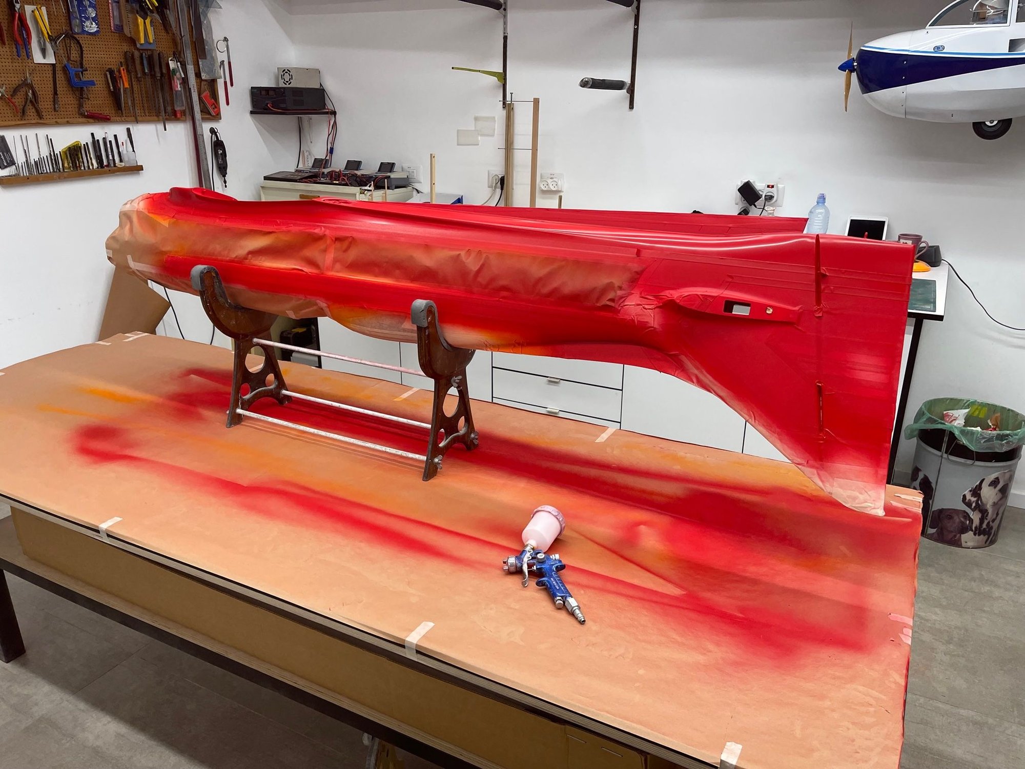

From: Ramat Hashrone, ISRAEL

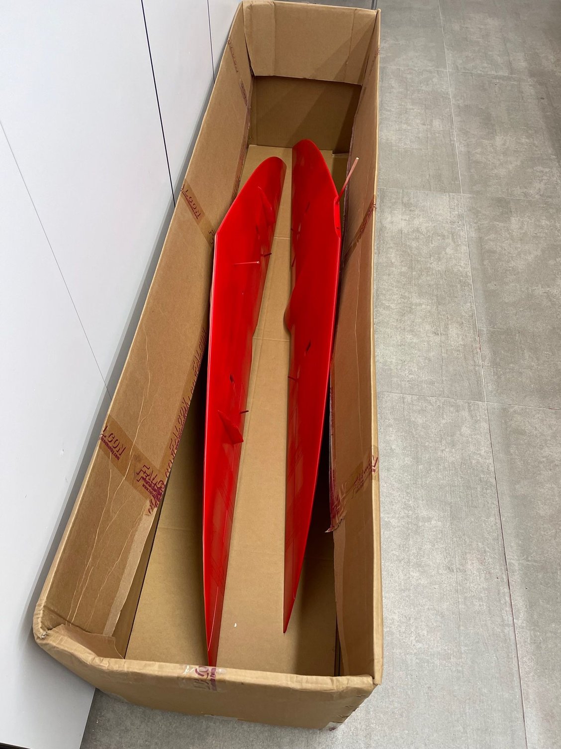

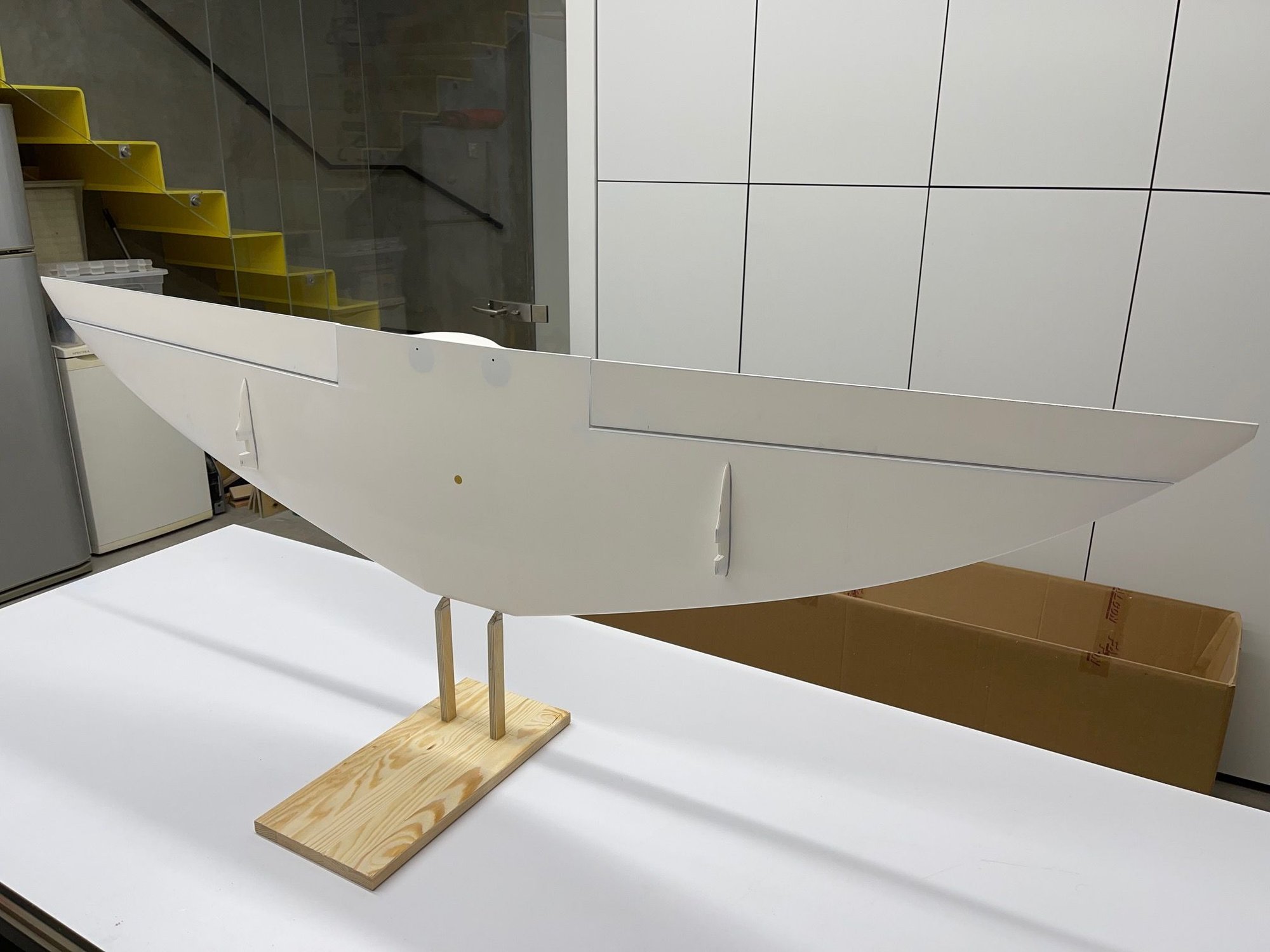

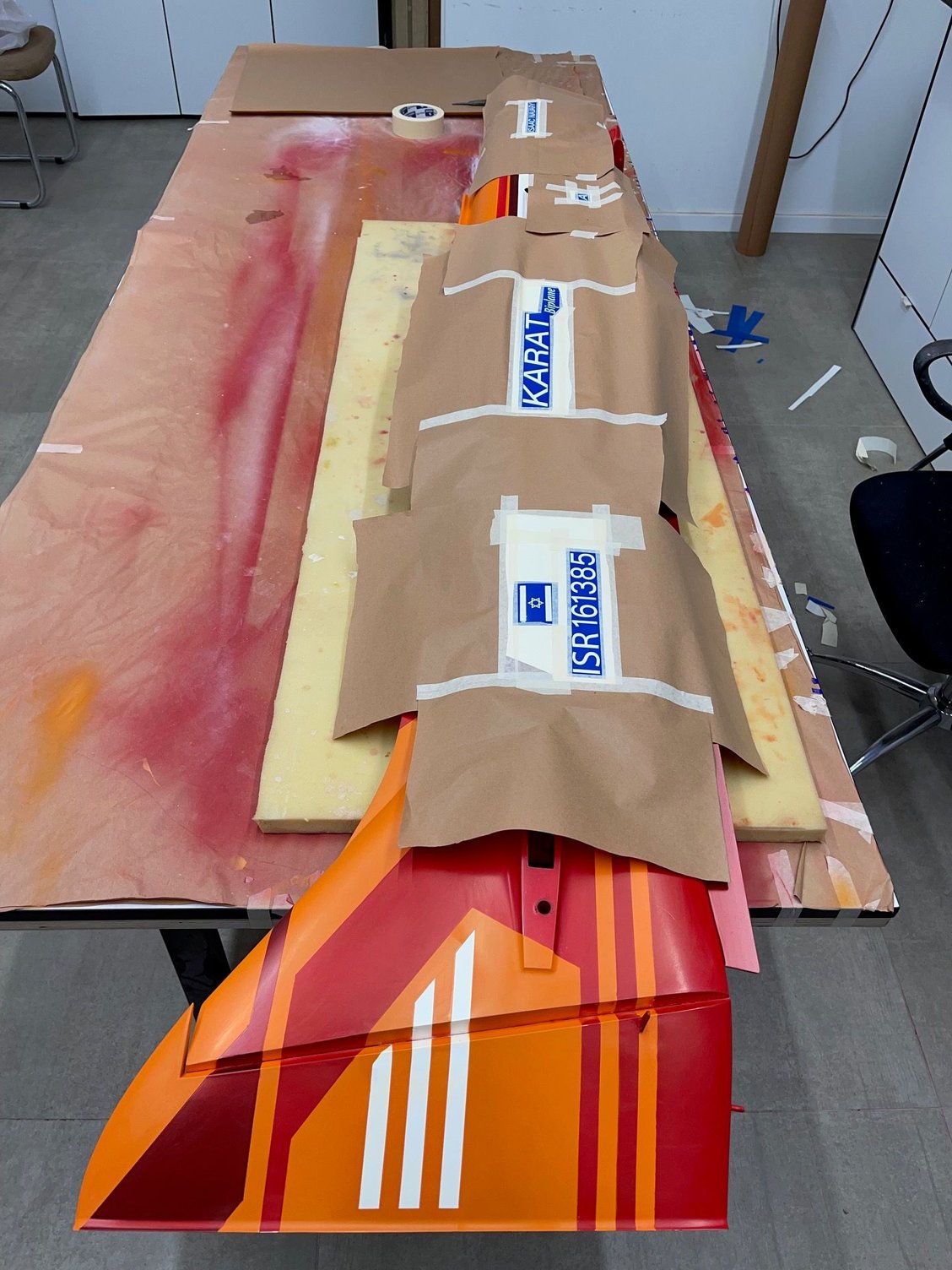

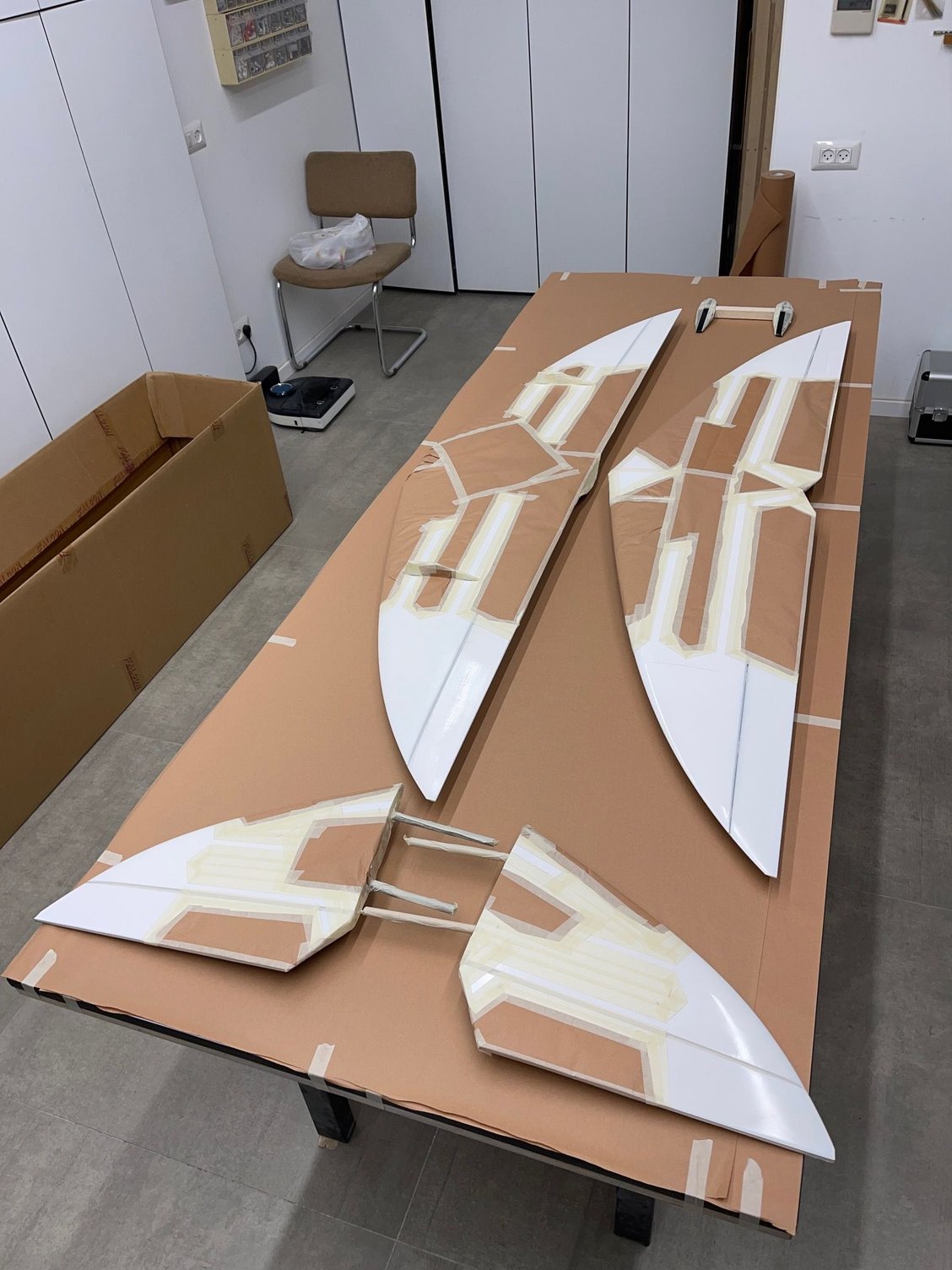

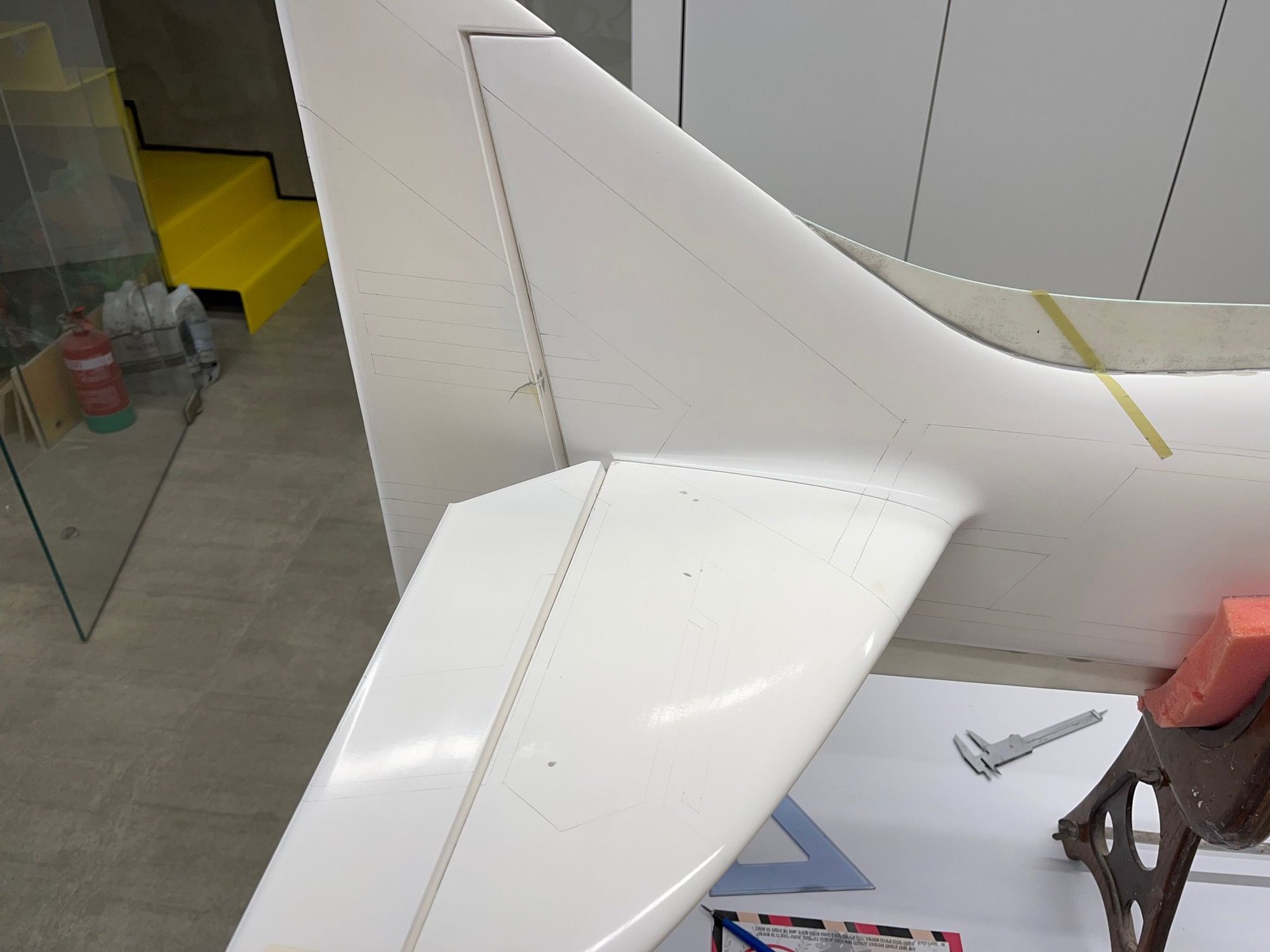

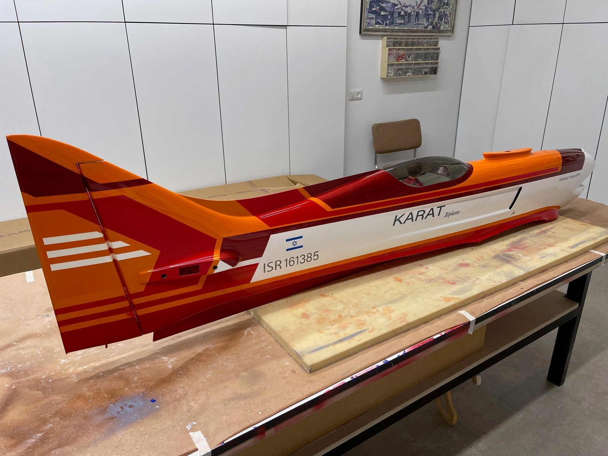

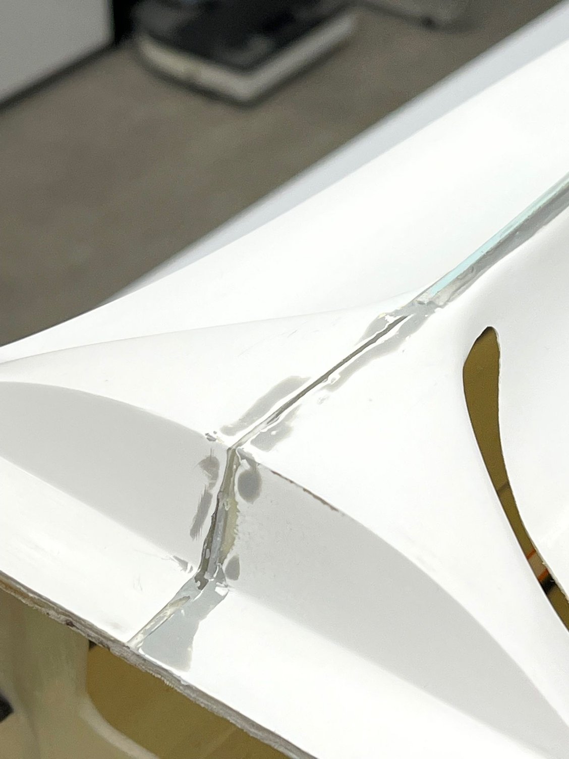

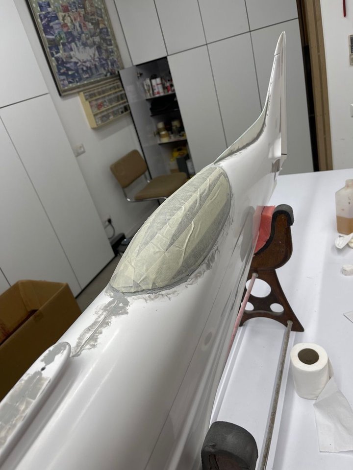

KARAT finish process - step 4
The following 3 users liked this post by najary:
ini (09-22-2021), Ricardo M. (09-22-2021), wattsup (09-22-2021)

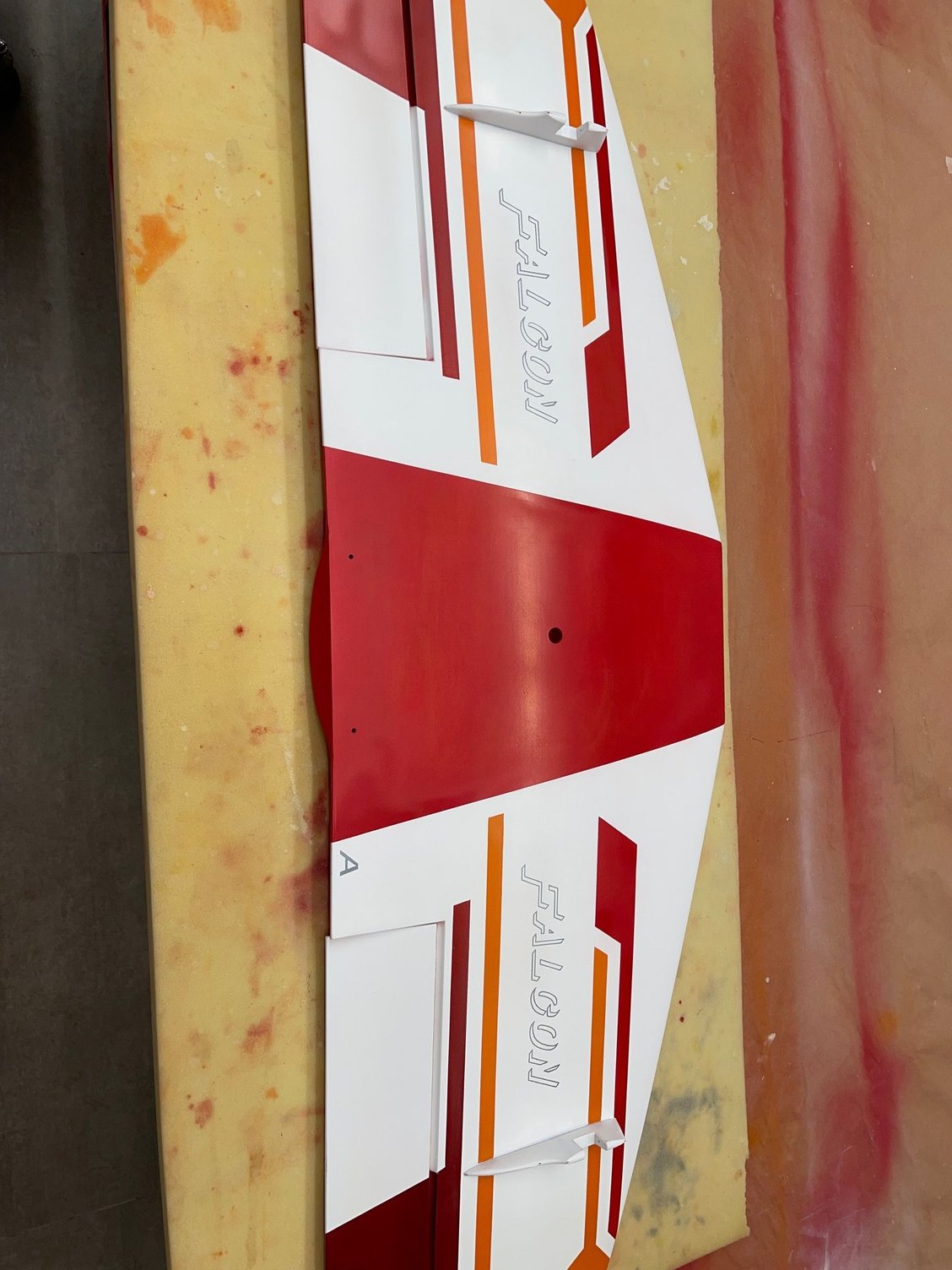

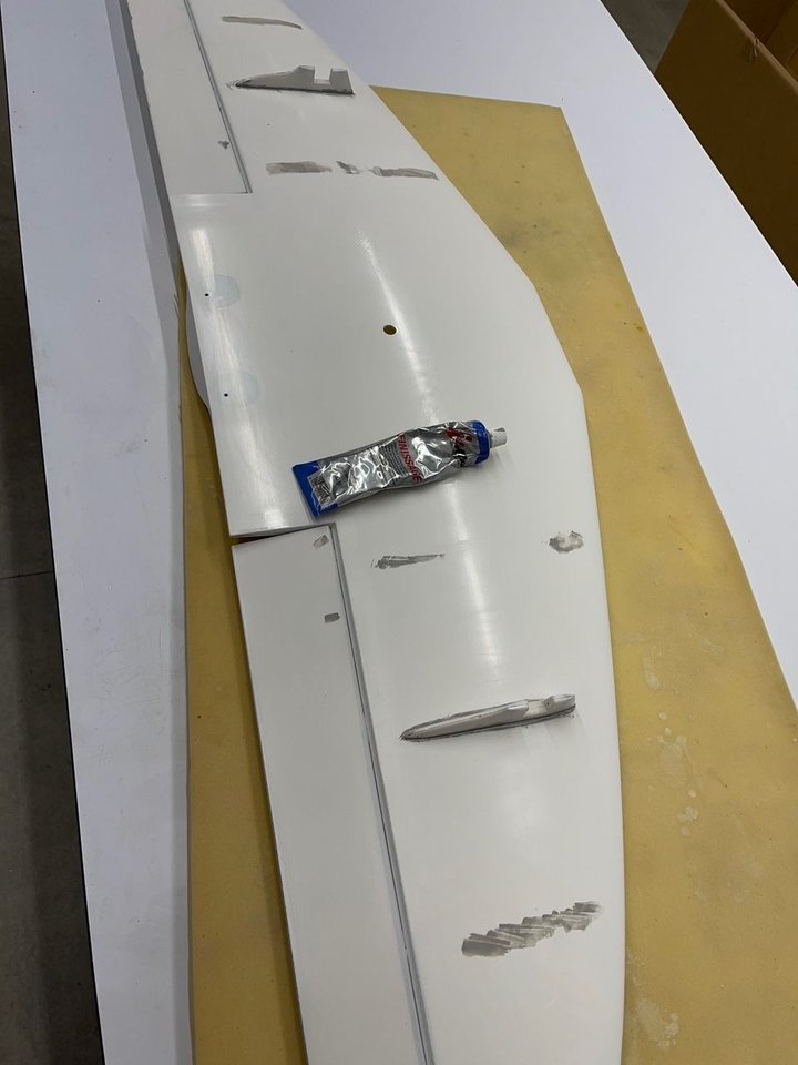

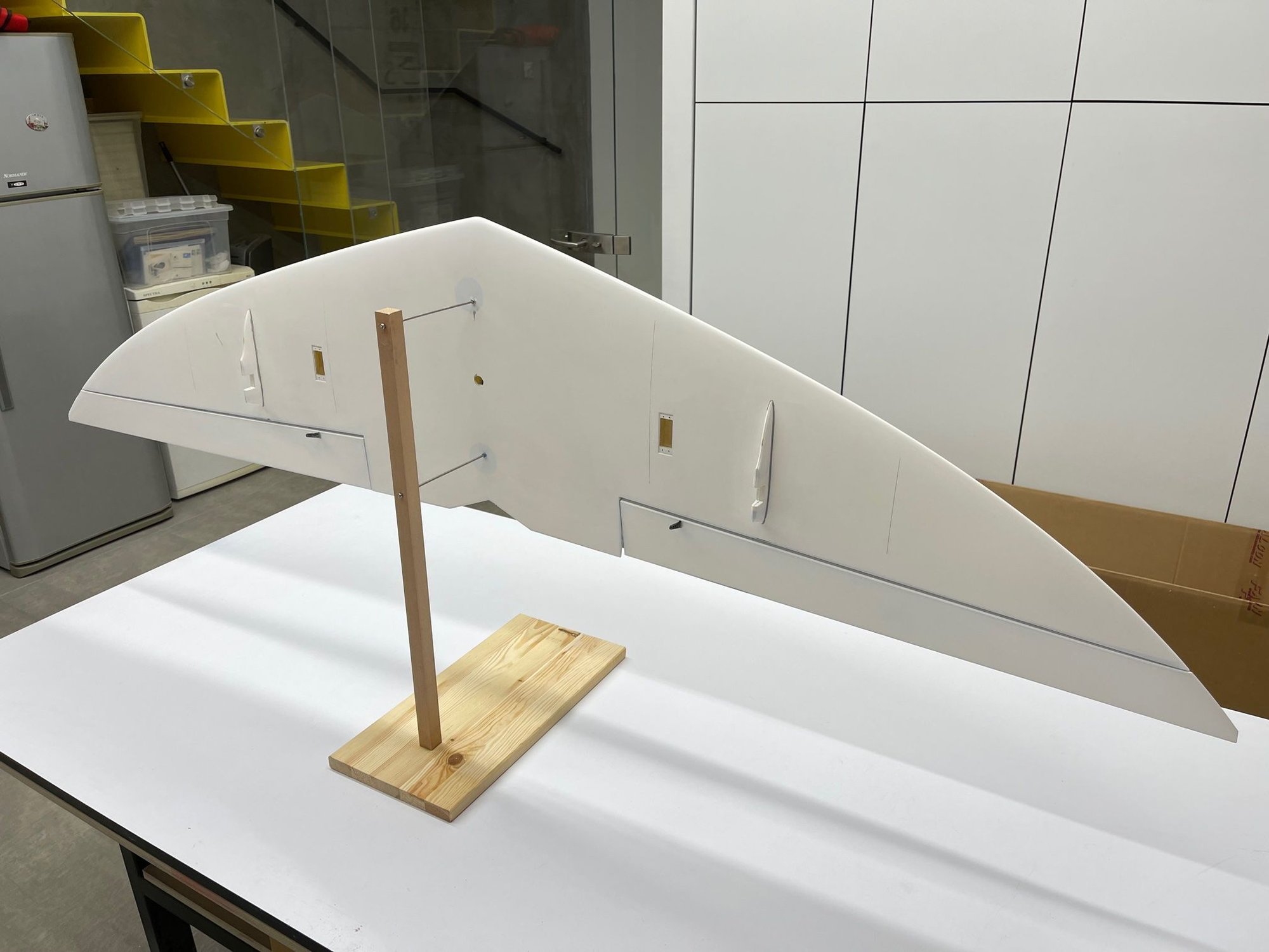

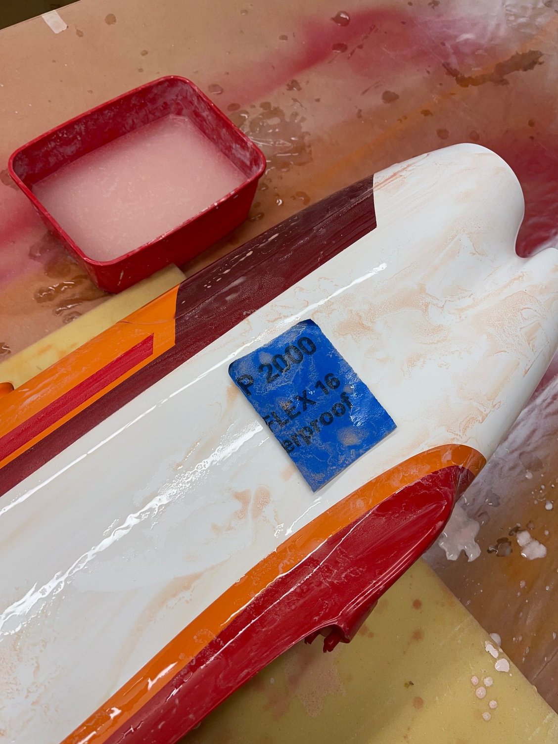

KARAT finish process - step 5
wattsup (10-04-2021)

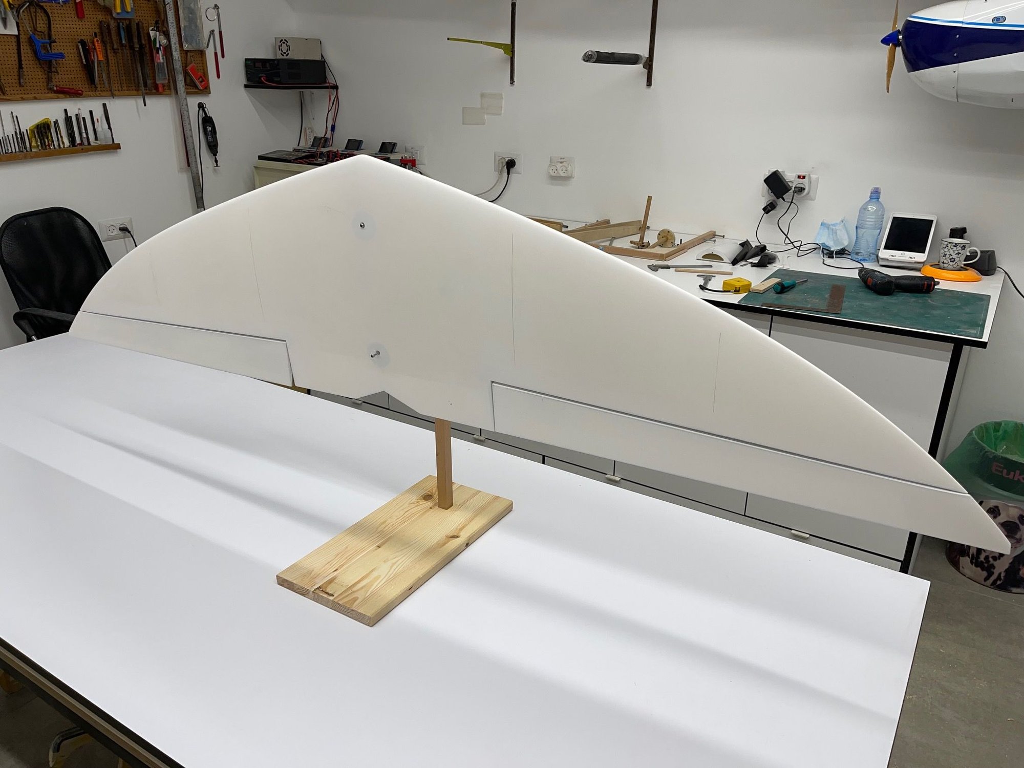

KARAT finish process - step 6

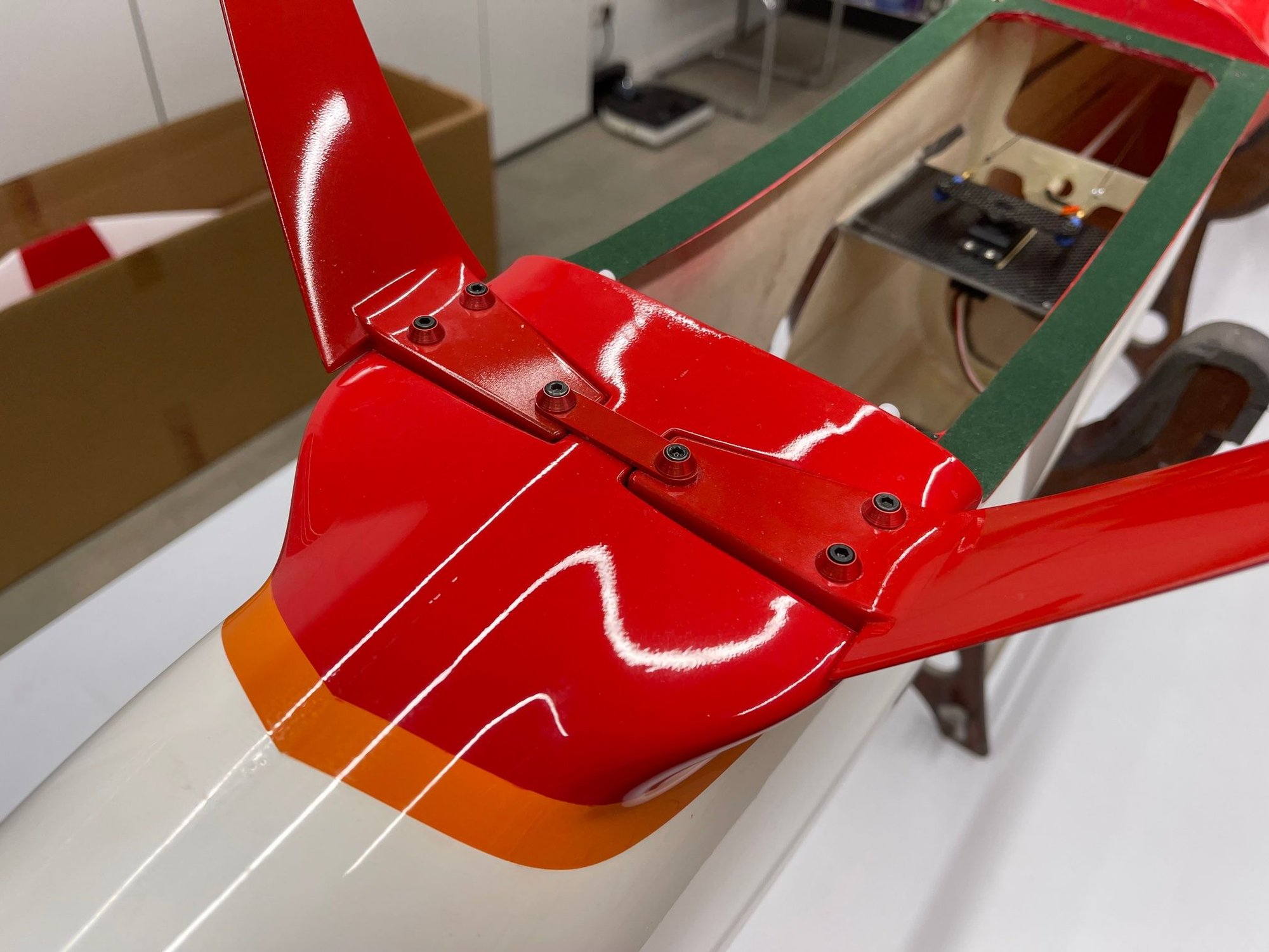

KARAT finish process - step 7

KARAT finish process - step 8

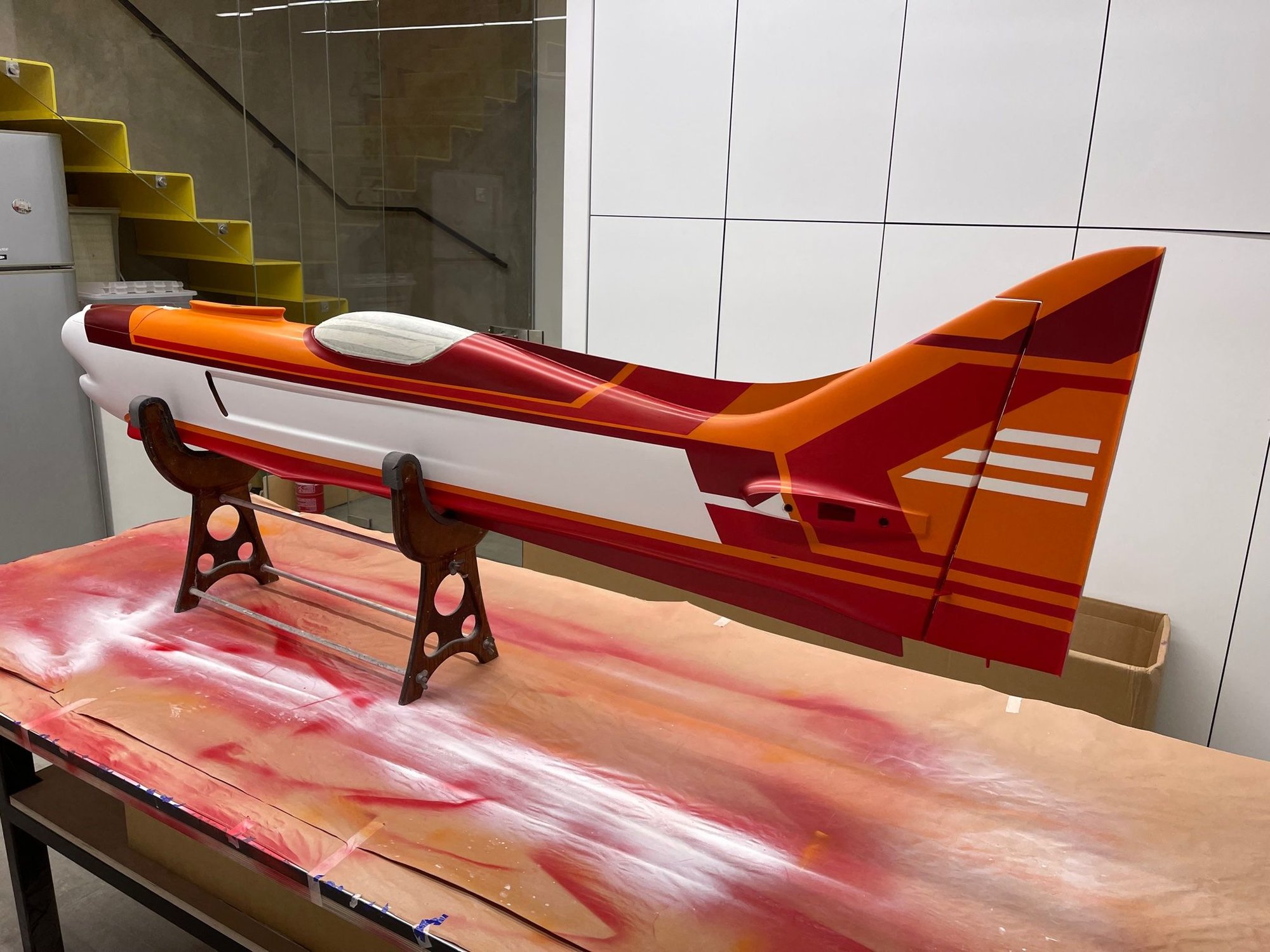

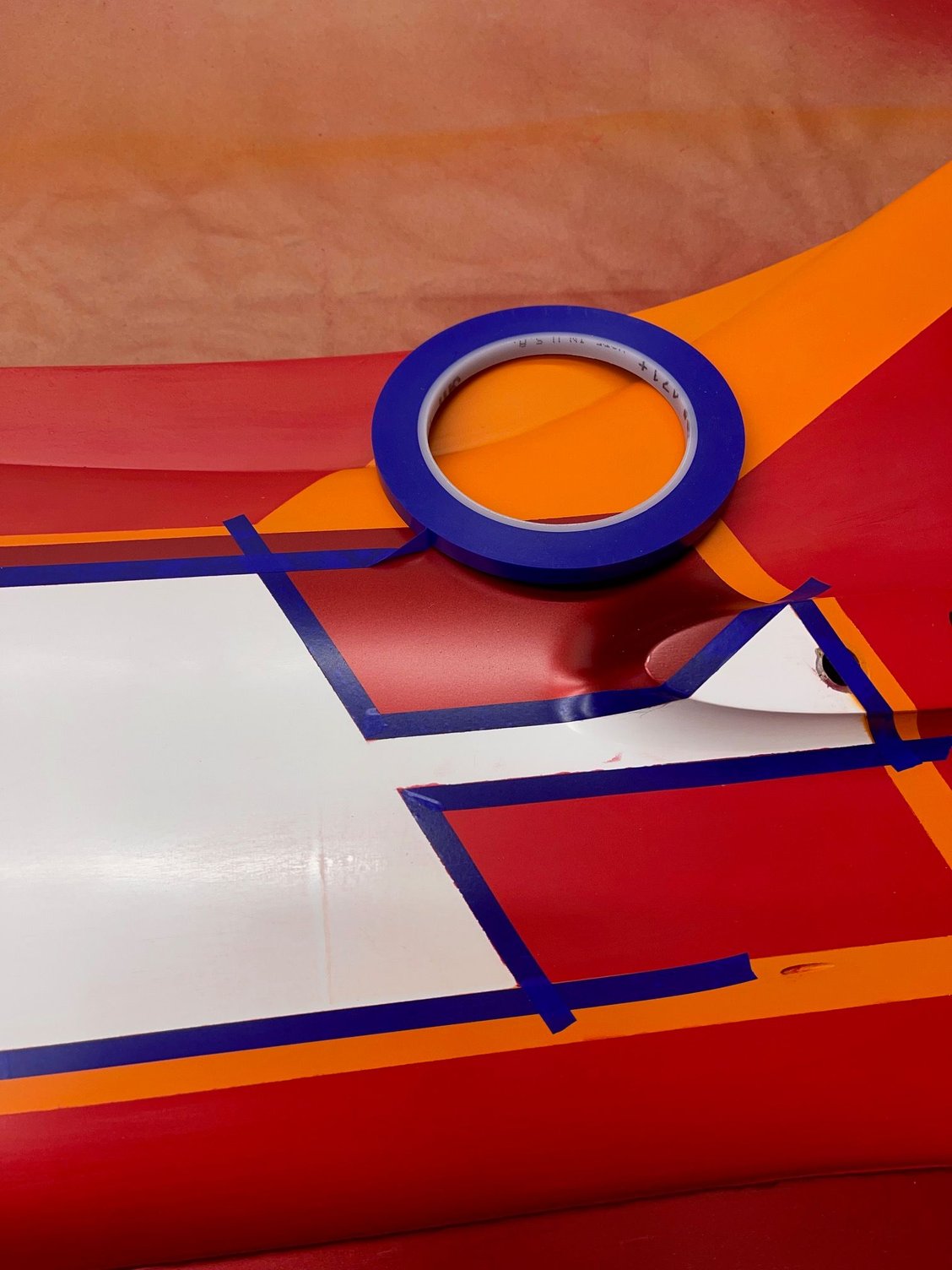

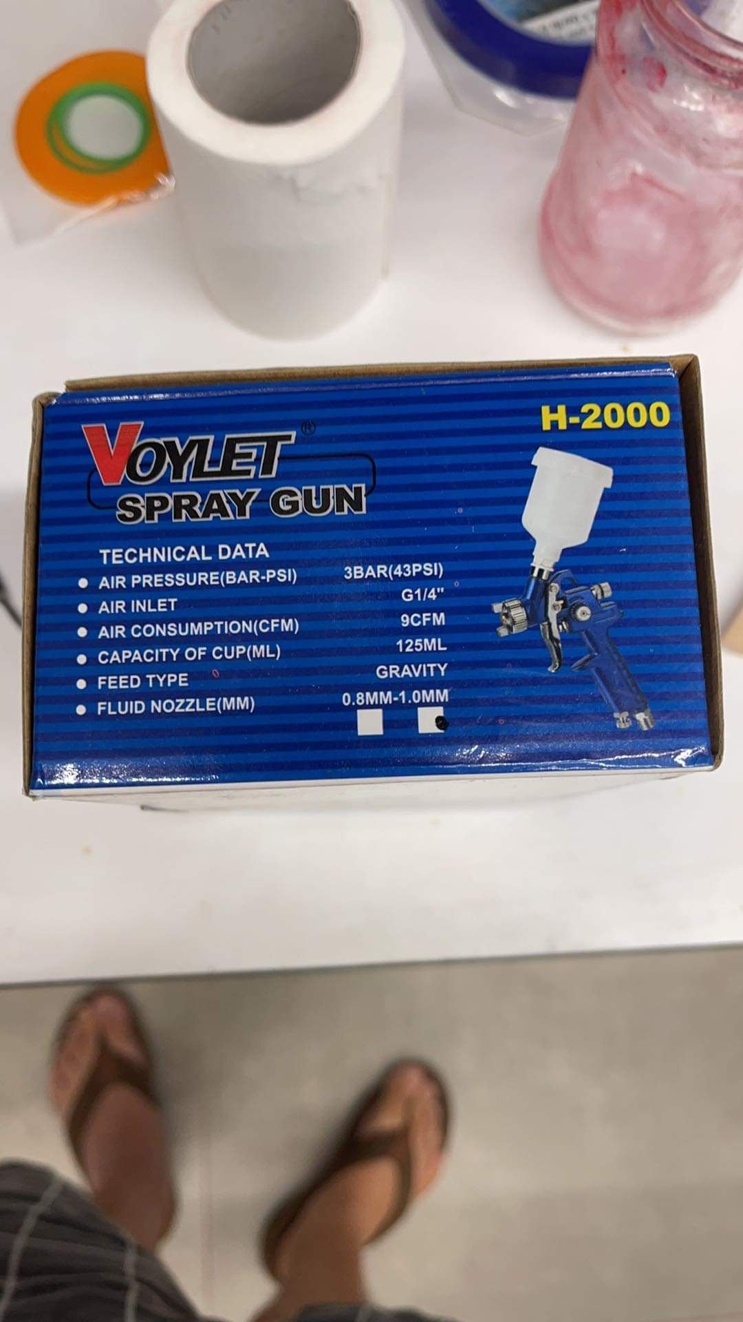

Beautiful work Isaac. After all the years of following your other builds, I have only 2 questions. What is the name or model number of this particular spray gun and the size needle you normally use to achieve these painting results? Thanks in advance.
Old 10-21-2021 | 02:22 AM
  #41
najary's Avatar
Joined: May 2003
Posts: 1,201
Received 37 Likes on 32 Posts
Hi,
The nozzle size is 1mm
Best regards,
Isaac Najary
Old 10-21-2021 | 02:35 AM
  #42
najary's Avatar
Joined: May 2003
Posts: 1,201

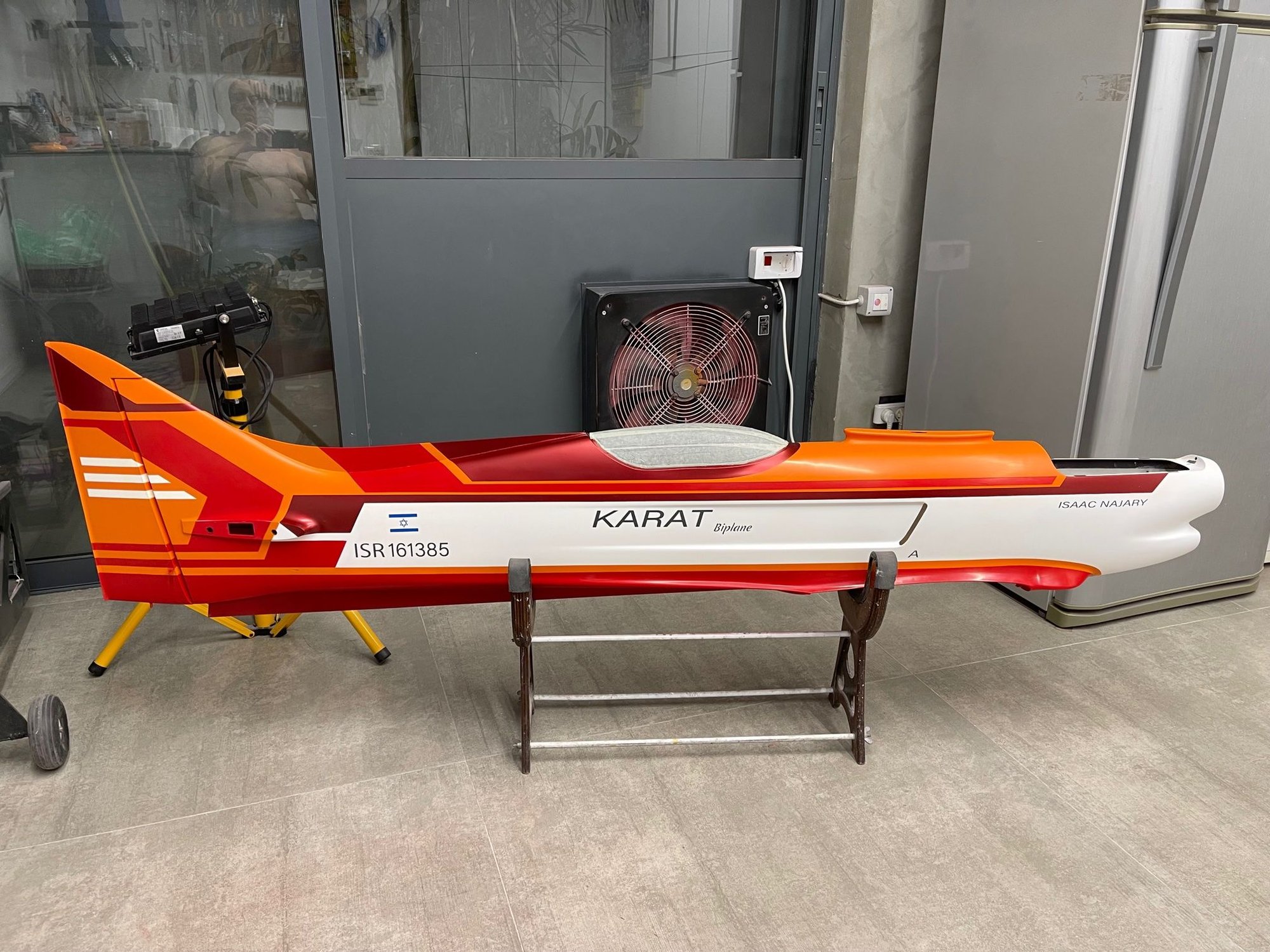

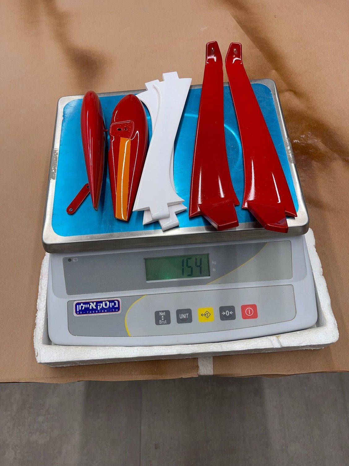

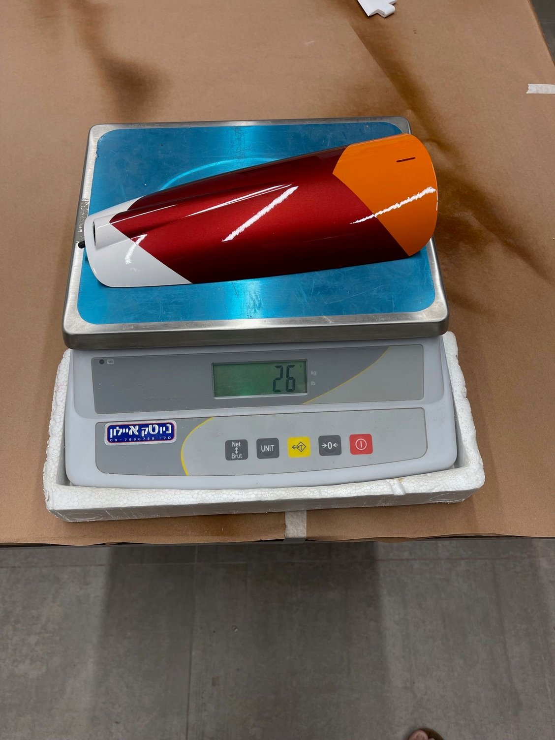

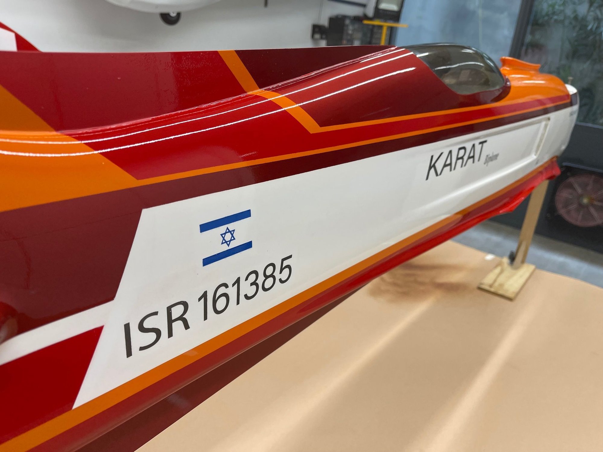

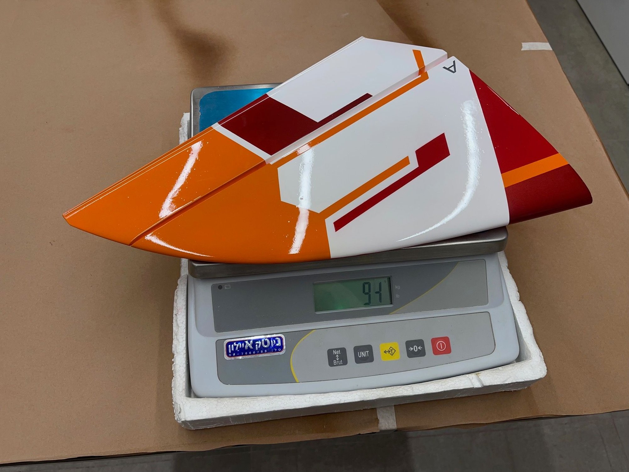

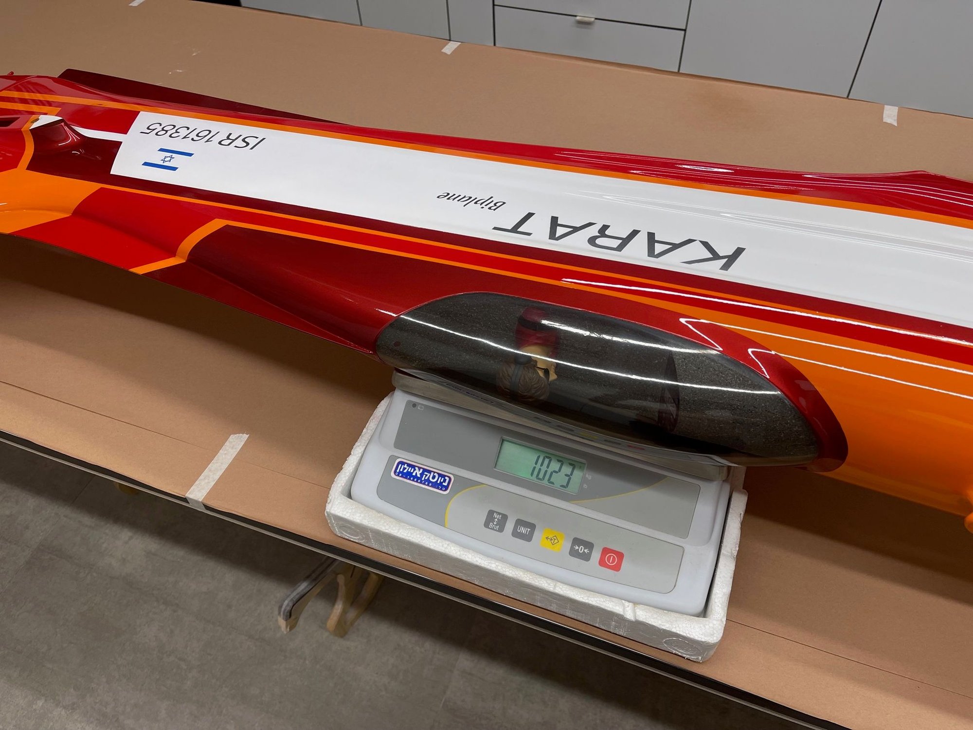

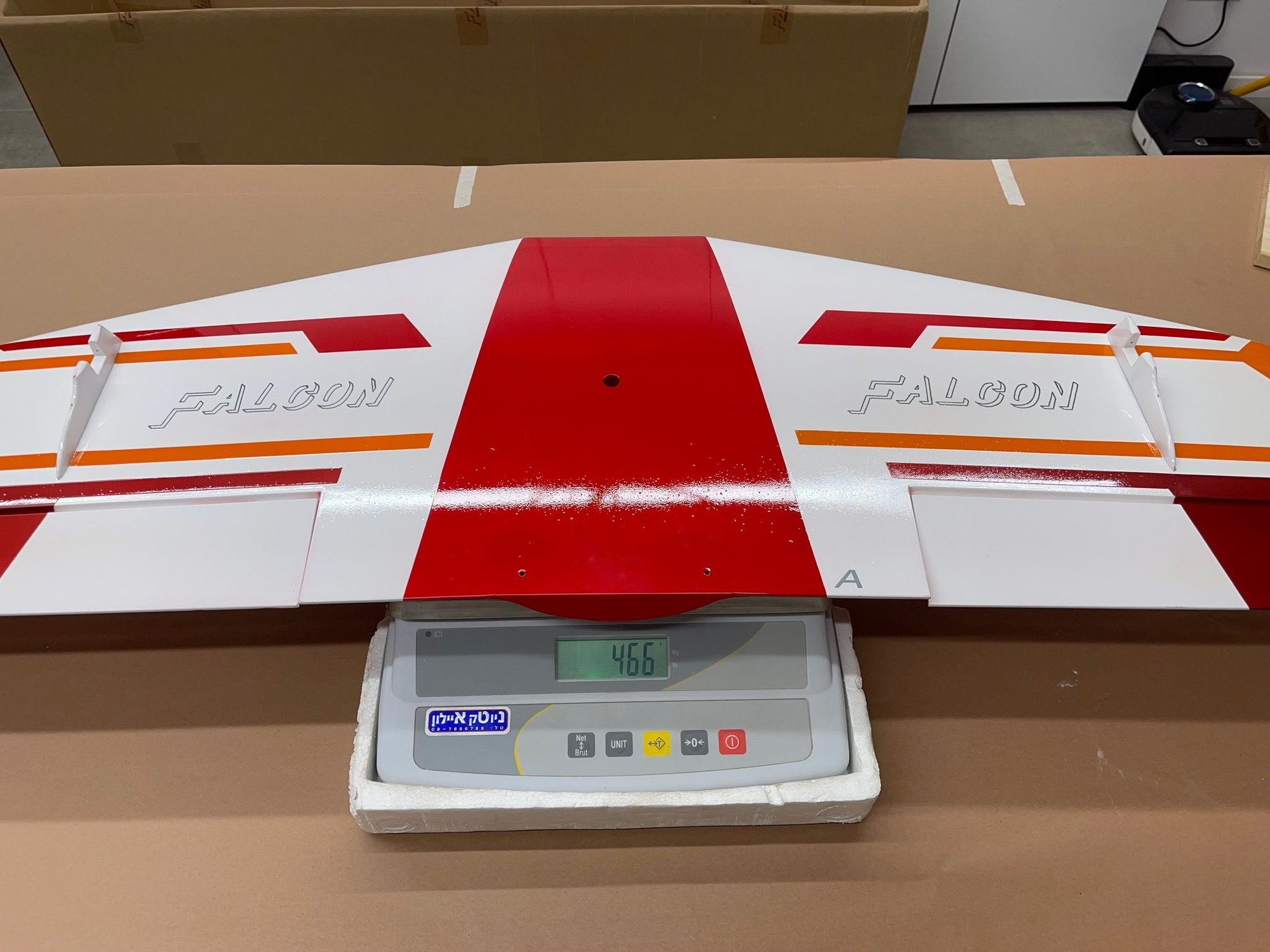

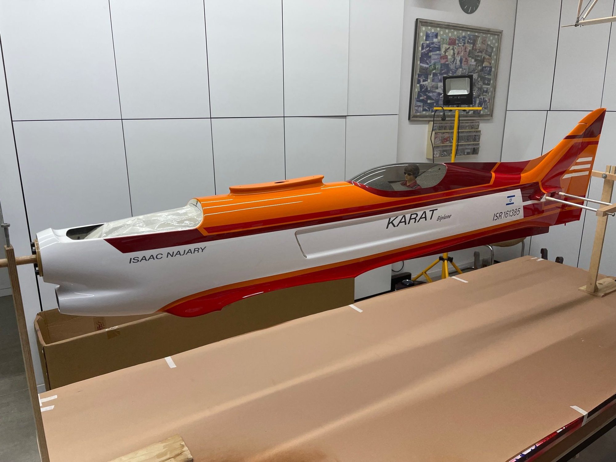

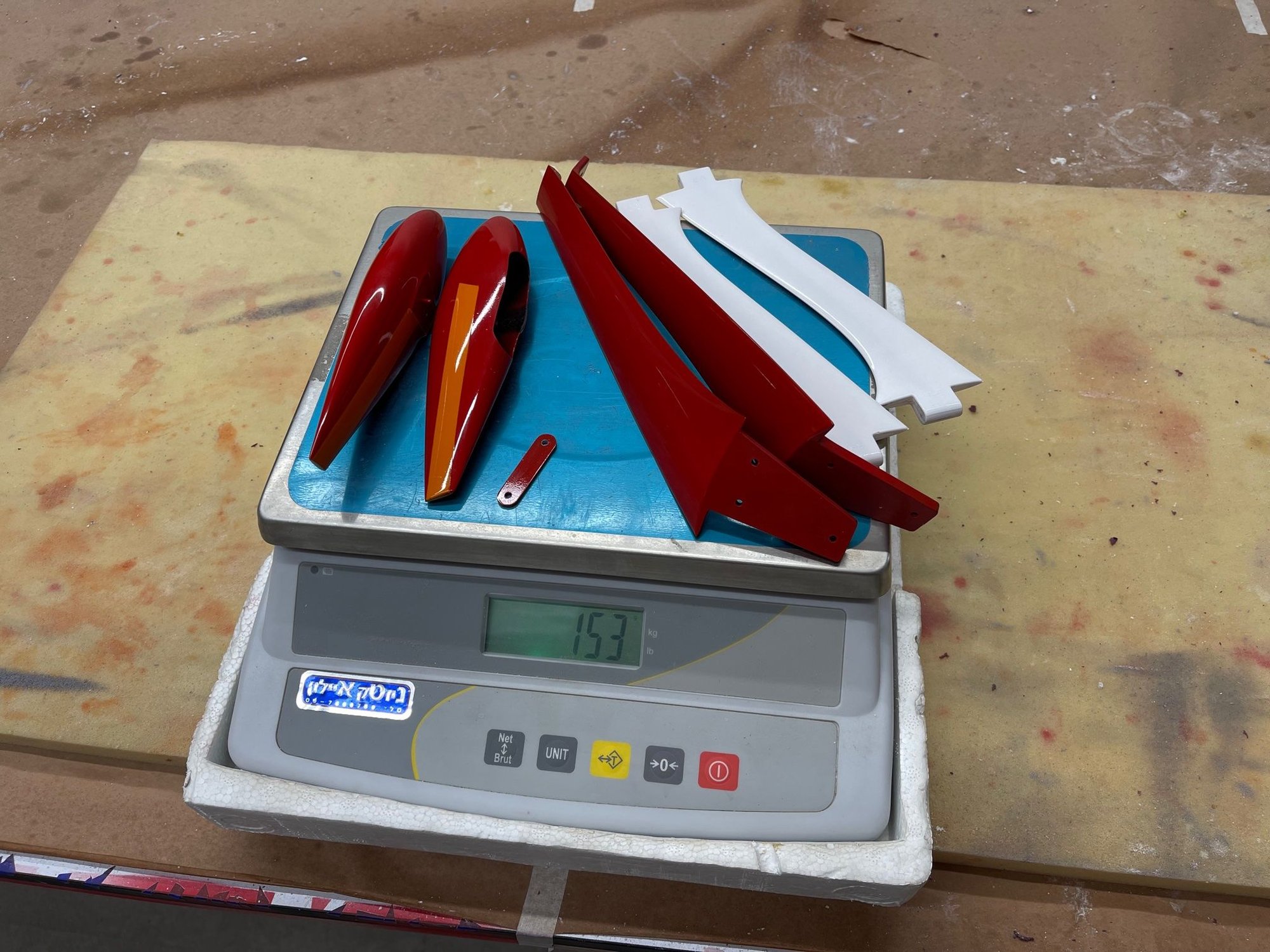

KARAT finish process - step 9 (last)

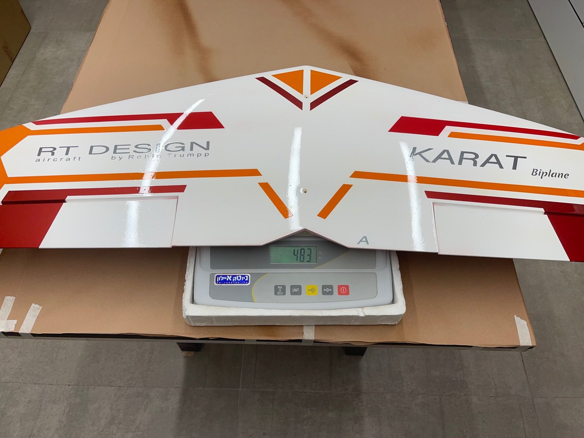

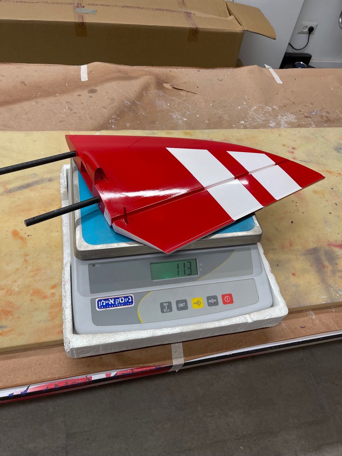

The total finish weight is 265 gram.

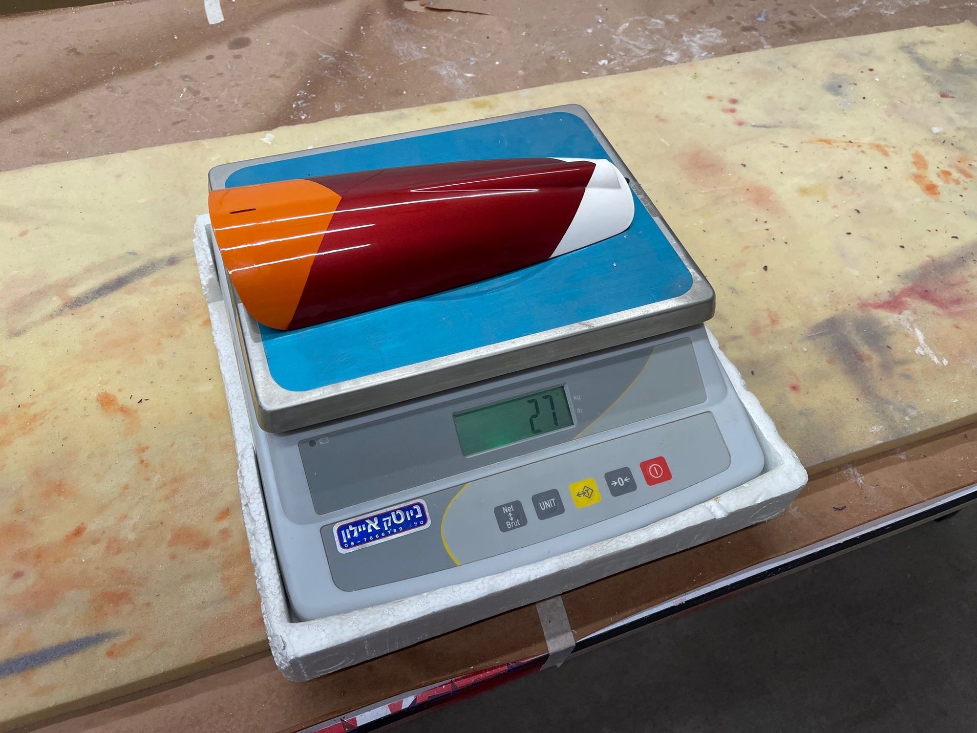

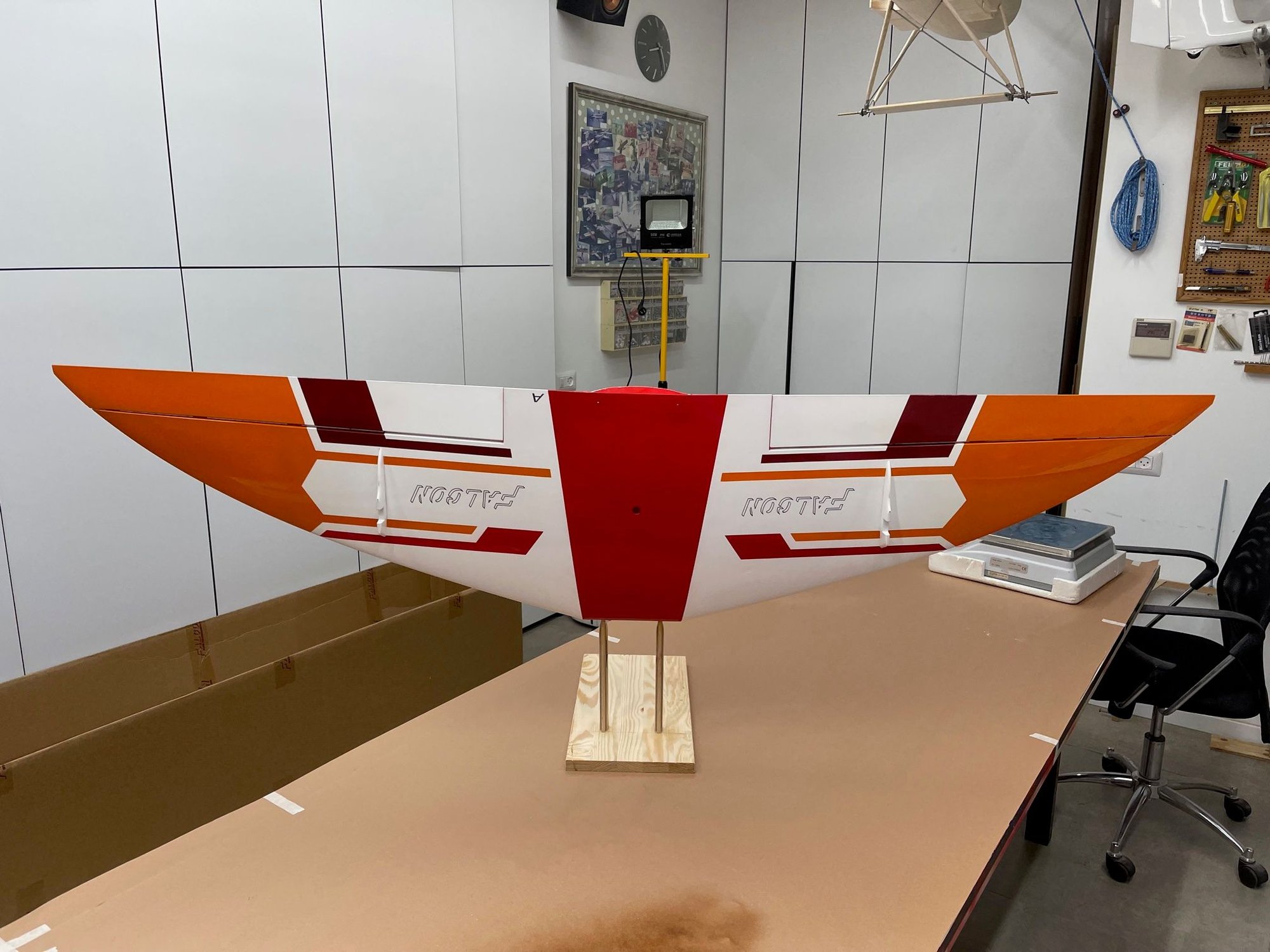

More
wattsup (10-24-2021)

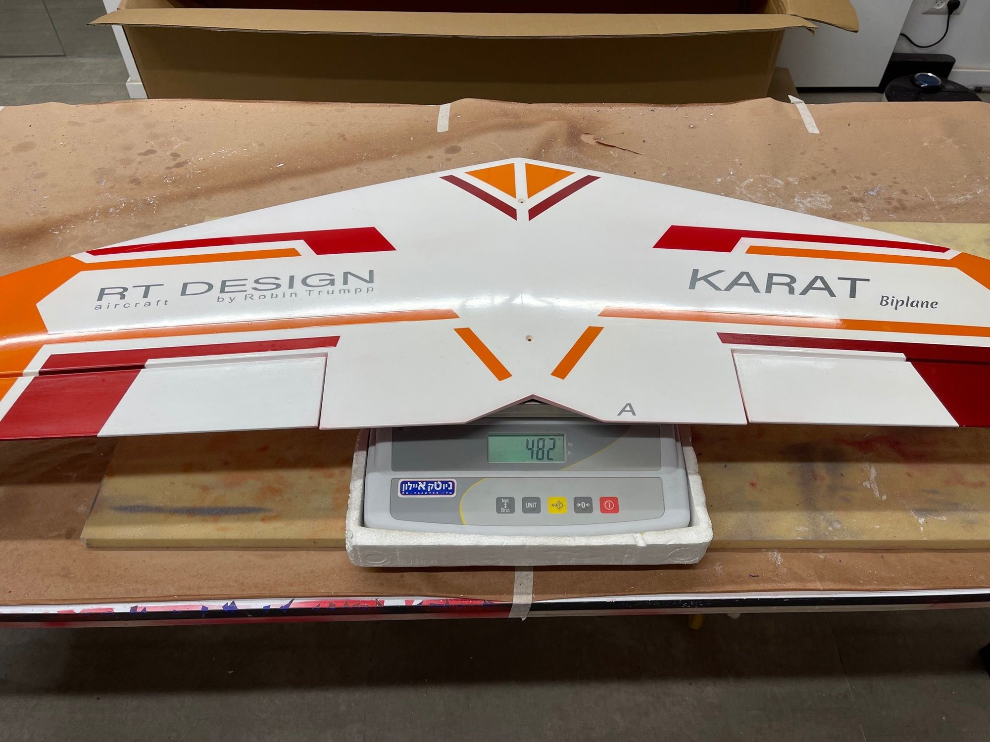

More

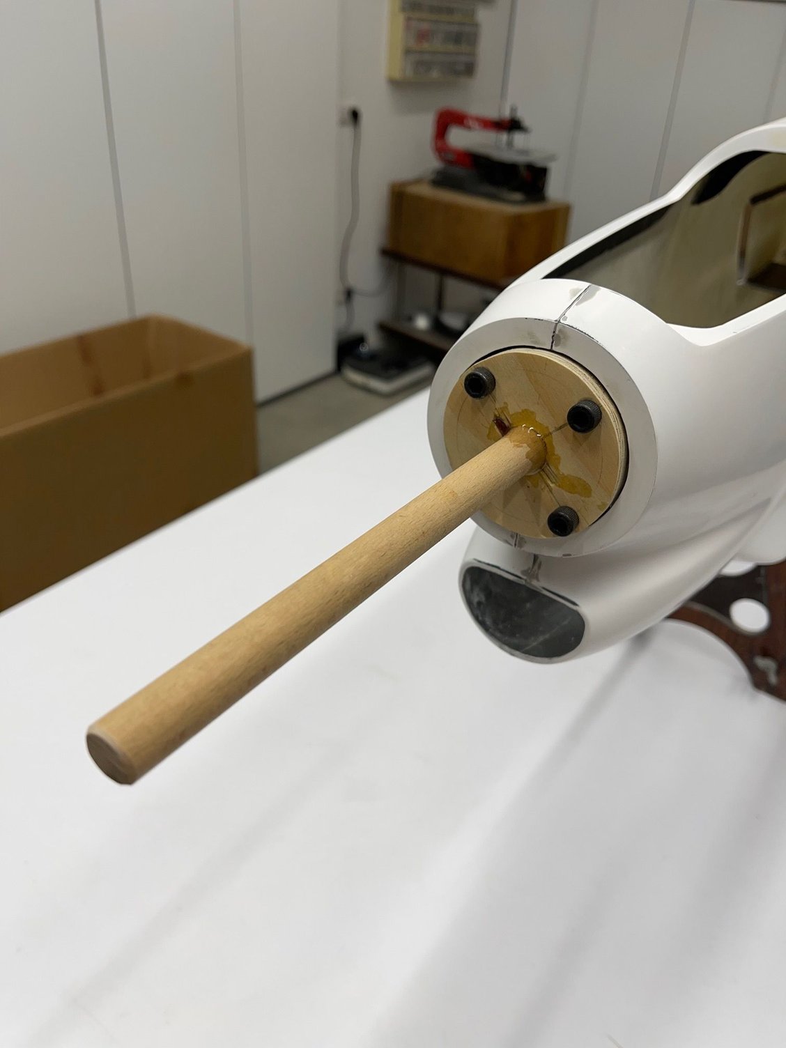

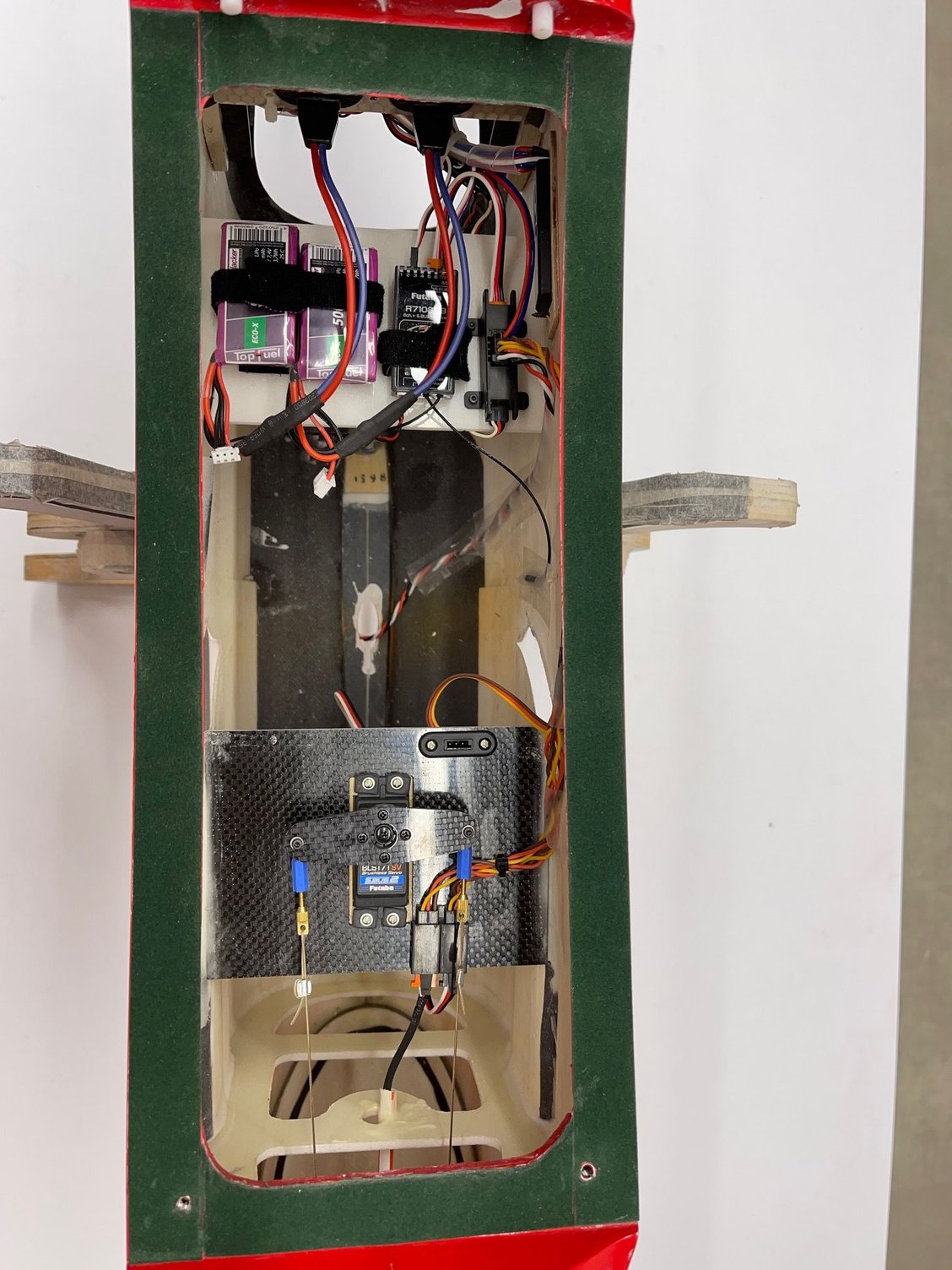

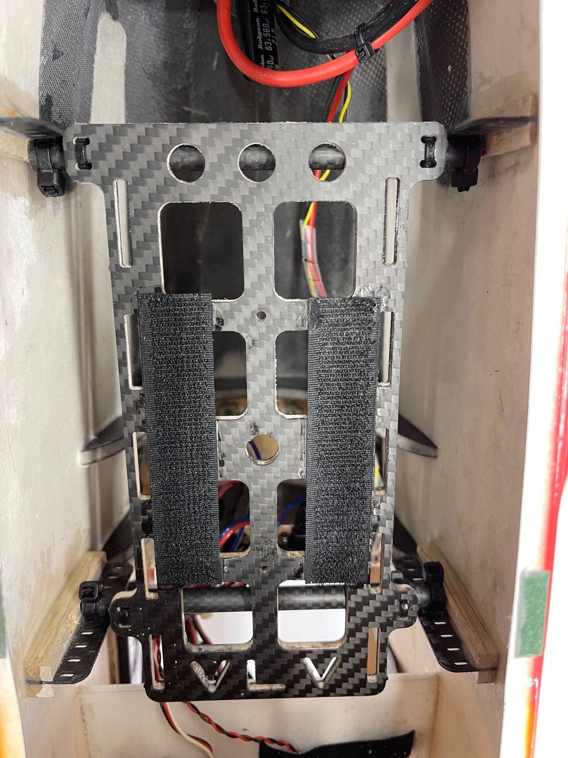

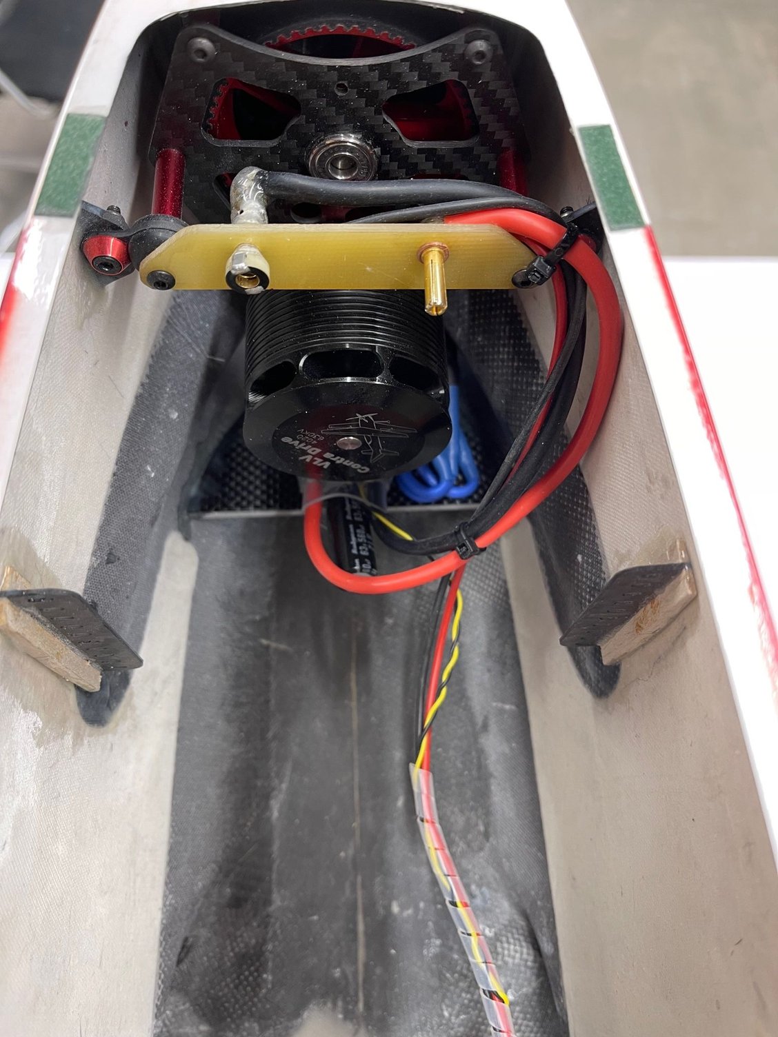

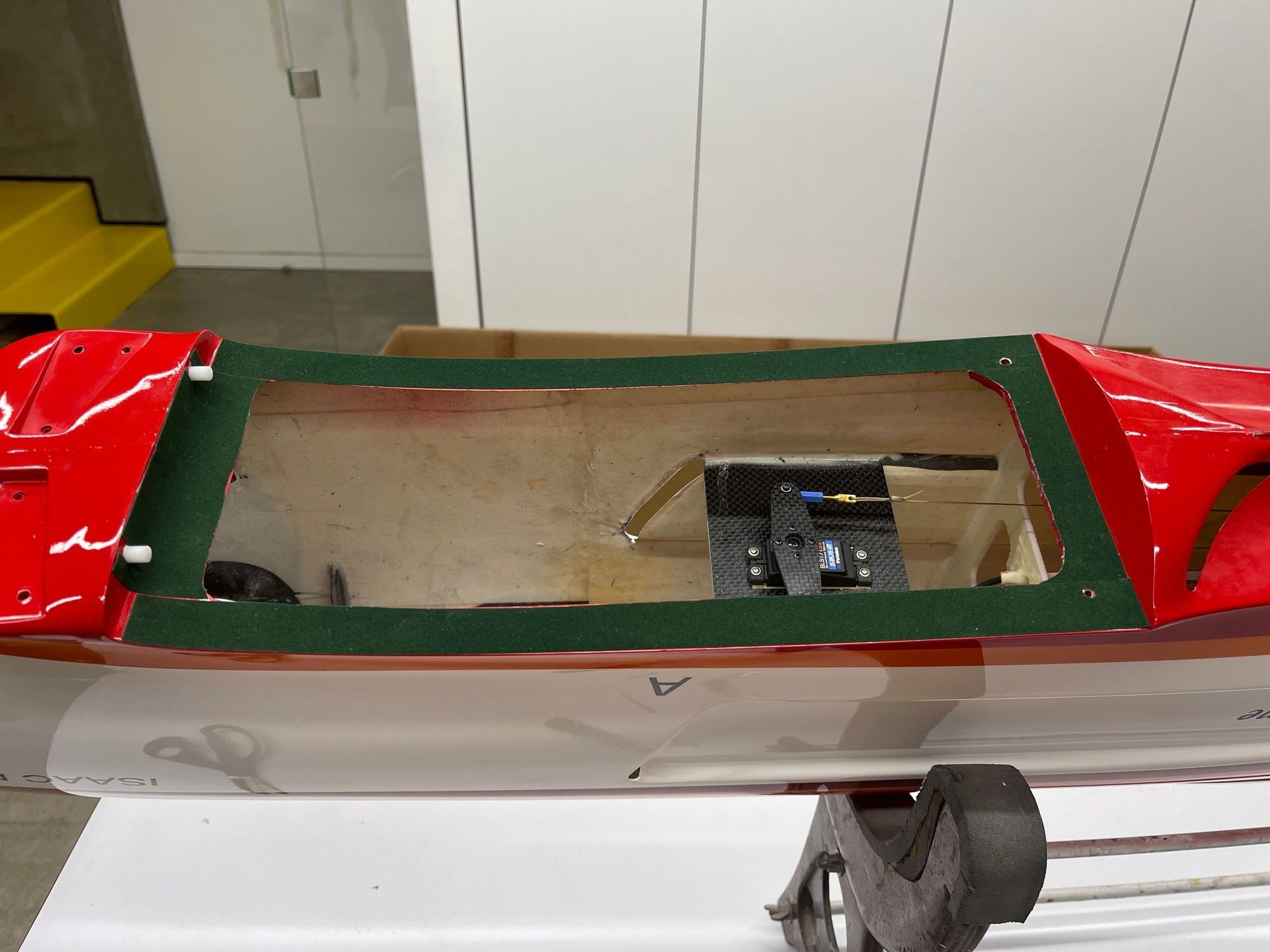

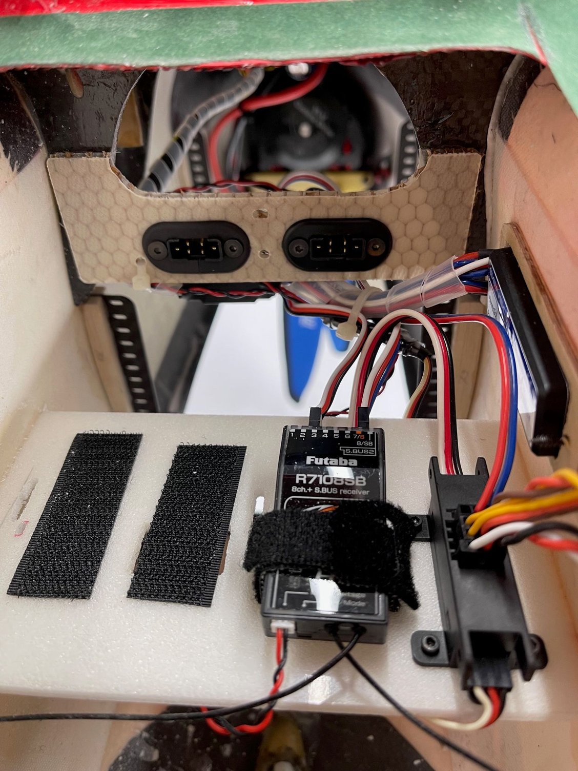

Hello Isaac.

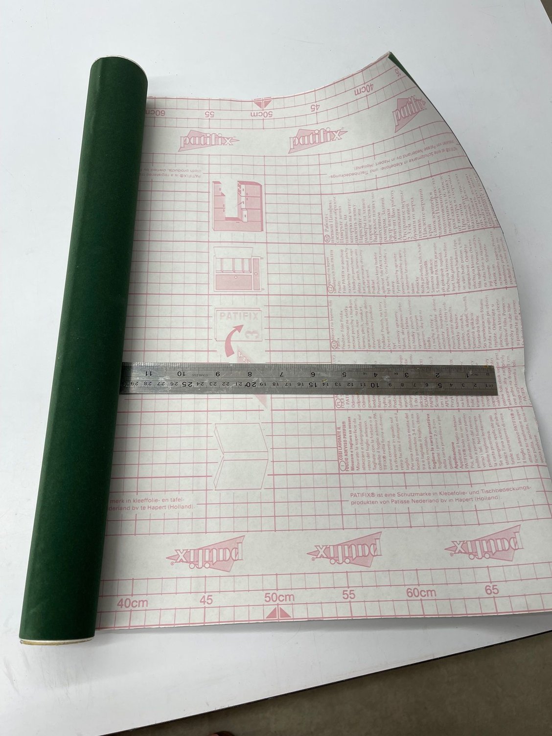

I am enjoying reading through all of your build threads and they are teaching me so much. I have a couple of questions:
1. what type / brand of paints do you use?

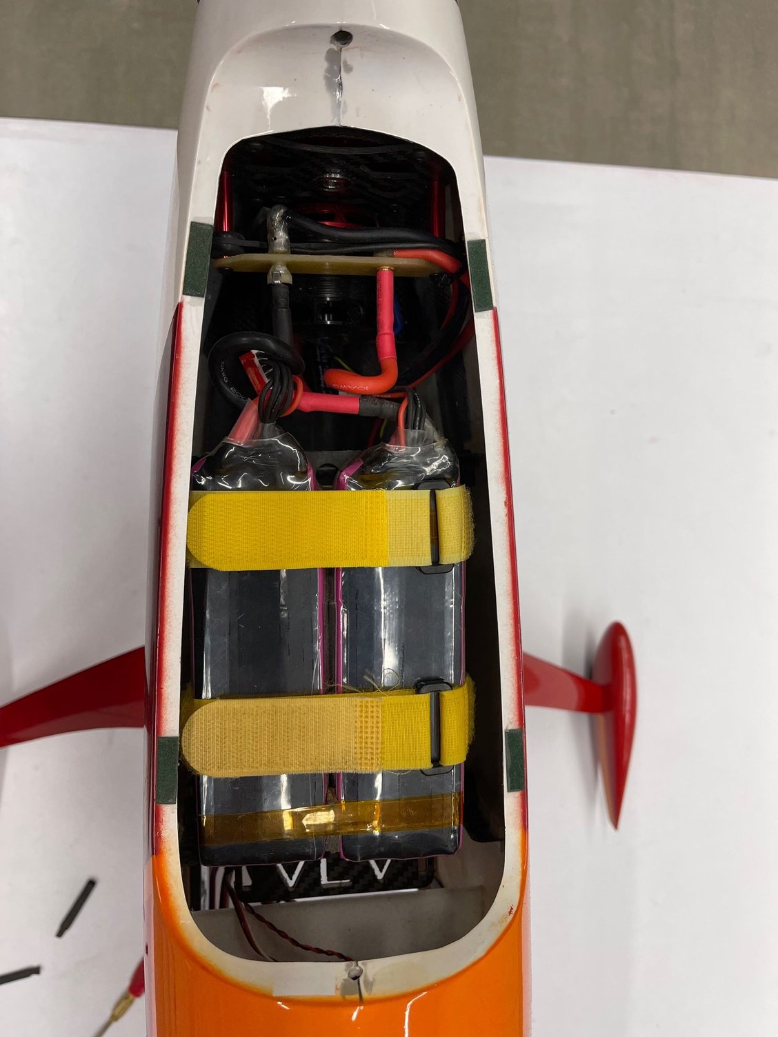

2. What is the purpose of the Patifix self-adhesive?
thanks, Bill
Old 10-29-2021 | 09:03 AM
  #46
ini
Joined: Apr 2003
Posts: 219
Received 11 Likes on 10 Posts
From: , FINLAND
That Patifix is thin felt layer on sticker. Reduces vibration and noice, also wear of contact surfaces.
Old 10-29-2021 | 09:14 AM
  #47
Joined: Mar 2018
Posts: 119
Received 9 Likes on 7 Posts
From: Shawnee Hills, OH
I kinda thought that's what it might be. I've just never seen it pictured on any build threads before.

Originally Posted by GorillaToast
Hello Isaac.
thanks, Bill
The brand of paints is DUPONT.
