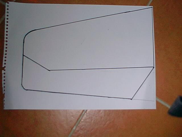

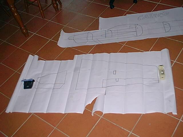

Hey guys. This is my first own design 2 metre pattern model. I'm only 12 so i'm redy to listen to whatever you have to say about it. Anything would be helpful towards it. So far i've just planned the fuse. The plane is called a calypso. To get a clearer picture you have to zoom in. Sorry guys if you can't make out some of the things its just that I can't get it on the computer any other way.

Hello Chris,
it looks very nice, I hope it will fly as good as it looks
My only suggestion is to place the mean landing gear further back-wards, or you can get a plane the will see all the corners of your airfield before it takes off. I should place it right before the leading edge, if your gear is pointing a little back-wards like you've drawn it.
But it looks good, very good

Thanks kurt. I will definately put the wheels further back like you suggested.[8D]

here is the stab and the wings. a the moment the elevator is a little bit to small at the center.

Is it just me or is the Root chord bigger on the wing plan than the fuse profile???
Not meaning to hang (you know what, they'll ban me if i keep swearing) on your plan..
the area for the wing looks about right tho

i'm not sure but i will make sure to check it. it may just be because i took the fuse photo from further back than the wing. but thanks for letting me know.

here is the new and improoved stab!:

That's a nice agressive wing taper ratio... should have very quick and positive aileron response. You might want to devise a way to somehow experiment with different wing and stab locations to test out in flight.
