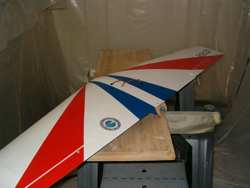

Getting there! Jon & Flywilly have probably given up on me, but my Skystar will fly before the seasons over!
Fuselage in primer, colors this weekend. Wing (and stab) complete, covered with Ultracote. Belly pan was glassed & painted. LG & wheelpants done. Color scheme will be similar to the Alliance pictured...
Using a YS 1.10, Johnson header & Mac's quiet pipe. 14-12 APC initially. Trusty JR 8103 radio...had planned on the new JR 9 channel but Horizon is as slow announcing that radio in the US as I have been slow in building. MK hardware.

Finally...mine is completed!
MK Skystar 90 powered by a YS 1.10
Trusty JR 8103 PCM, 4131 servos
Weighs 7 lbs 13 oz.
Would like to hear from anyone else how is flying or building either this model or the similar MK Super VR-90.

Hi Scott, congrats on a very fine looking aircraft! Nice job on the Canopy too!
I hope you'll have a lot of fun with it. I have to service my engine with new bearings but I can't wait to get it back in the air, it's a very smooth flier.
