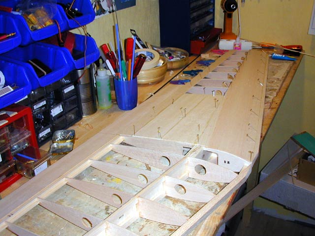

I'm in now and there's no going back. 4 hours worth of glueing made the wing look like this. Ran out of Zap so I could sheet only one side today.
Now I know why I need the local hobby store. Ain't no way I'm waiting for glue delivery now, I need a fix quick
The kit is really something else. Never seen such a part fit and prefabrication. Even the main sheeting of the wing is precut. Everything just slots in! Now I know the meaning of the word FIT. This is state of the art. I've never seen anything like it in 15 odd years of kit building.

I had fun and games building my wing ended up with an almighty twist in it due to some mistake I had made, ended up getting a set of foam cores made.
How did you construct your wings, did you use a jigging strip or some other method.

I've just framed up an Aurora - a small MK pattern model. The kit was very cheaply prices (about $150 AUD including shipping from Singapore). The design is ver similar to the Skystar, only smaller. I've just loved the precision of the cutting, the rebates and the way everything just fits together.
I do agree that the wing an fuz do need jigging to get a straight result. I took a punt and just packed up the trailing edge equall along its whole lenth while building and sheeting top side. Seems to have worked out okay, but next time, I'll set it up on my adjusto-jig. (Never built a bad wing yet with that device). I'm looking at investing in a magnetic board (own build) for fuzes though, as I got a little banana twist, doesn't affect alignment of wings - tail group, just looks bad.

Mike, I don't know how you were able to do that, my wing just came together like a jigsaw puzzle. I built the first half over the plan and the other with the plan hanging on the wall. I built them the same way as boths halves are identical. I did align everything by eyesight at crucial points such as before glueing the top spar, TE/LE, shear webs and sheeting. Such a tapered symmetrical wing should have a jig to be guaranteed straight but I've always relied on eyesight to get it even, and this looks to be the straightest wing I've built so far.

My best guess is that the twist went on later.
I had built the two wings and had a break of a few weeks before i joined them.
It was a hot part of the summer and i think it was the heat in my shed/workshop that did the damage. Well that is my excuse and I am sticking to it.

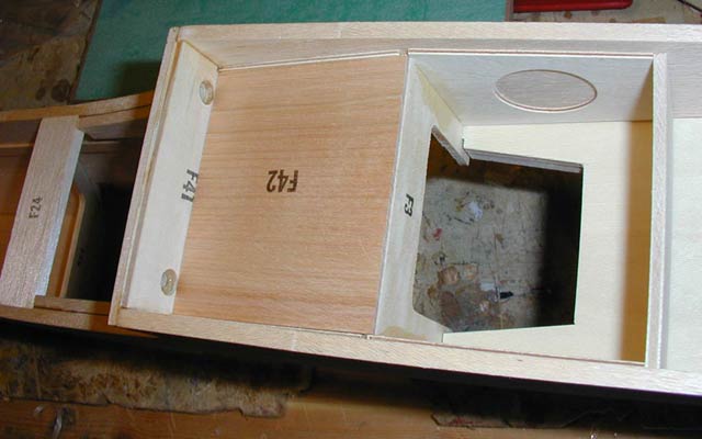

Here's a few pics of the fuse. The turtledeck was in fact not that great but still no real problems to build straight. Incredibly impressive fit and quality of the engine mounting block and the undercarriage block. Both come prelaminated of rock hard balsa and a hard wood that I do not know the English name for. The u/c block even has a preshaped lip. Both fit with millimetre presicion, just look at the picture with the u/c block fitted. Not glued, just pushed into place.

Ha Jon...that looks really good...ain't nothing like a well designed and thought out kit. Kits like that keep it interesting from start to finish. Do you have a web site address for MK???

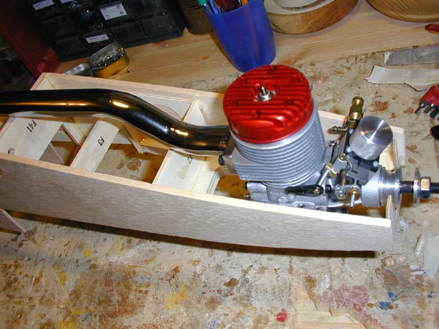

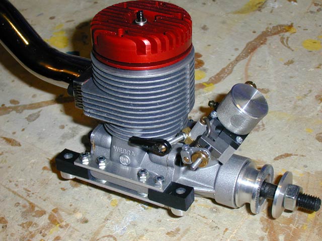

Here's the engine. It's a Webra .80 Racing Longstroke Competition w/pump. I hope it'll live up to it's name. It certainly fits nice although the header should have had a cm more rise to clear the wing. I may just saw it off before the wing and use a length of reinforced silicone to clear the wing. The mount is MK, made for O.S 90 FS. Fits nice but a little trimming of the rubber blocks was needed. The engine will be completely concealed within the glass underbelly.

Jon, if you are careful with a torch, you can gently heat the header and give it a little bend. I've done this on several headers without any problems. Just remember you're working with aluminum so go easy on both the heat and the amount of force you use to bend it.

Jon...That is the first slide barrel carb I have seen on a plane motor...used them in r/c car racong mostly.
The header is easy to bend ...heating it will sure help...I bend Macs headers all the time...just a little heat is needed. I wear welders gloves and just heat the section and give it a bend.

Interesting! The header is chromed, so it'll probably peel, but does that matter? Fit is more important than looks. I can give it a whirl but what kind of torch are we talking about, something I can pick up in a hardware store? And what sort of heat is required? I've never worked with metal.

To bend aluminium successfully you need to anneal the metal. Firstly rub a bar of ordinary household soap all over the area you want to bend. Use the bar of soap dry and keep rubbing until you get an even coating. Next using a small propane torch which here in the UK can be obtained from any do it yourself or hardware store, heat the coated area with the torch keeping the flame moving. Do not play the heat in one place and keep heating until the soap turns completely black. At this point stop and allow the metal to cool down completely to room temperature. You will now find that the metal will be very soft and the bend can be made with very little force. Aluminium alloys actually age harden, so if you now leave the header for several days it will eventually revert back to the hardness level it had before you annealed it. The bending process also work hardens it a little so if you need to adjust the bend once youve made it you should re-anneal using the soap indicator method.
Hope this helps.
