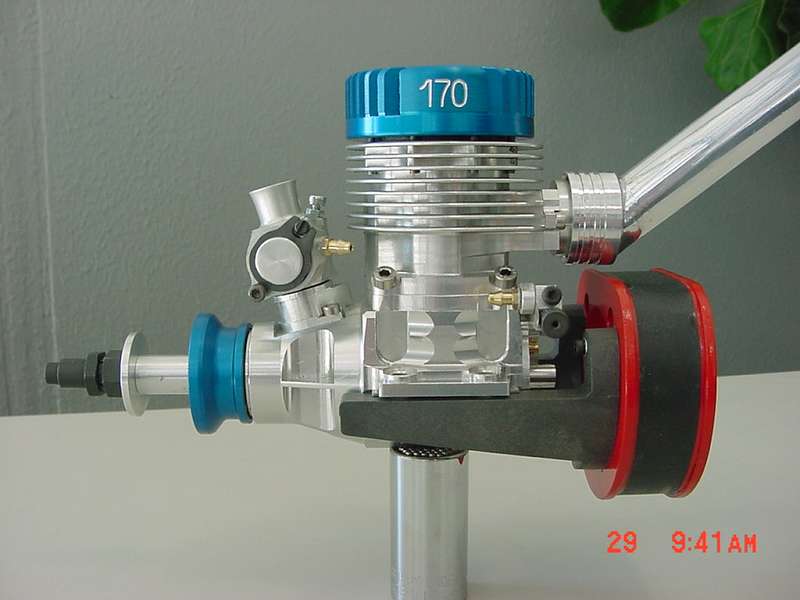

Merle is really great to deal with. I am putting togeather my first pattern plane, a Focus version 1 and wanted a softmount that didn't need a nose ring. I emailed about an A style mount and told him I need it for a Mintor 170. I got a response back very quickly. I told him I wanted one, sent him a money order and a few days later the mount was at the house. The Mintor fit perfectly. The top of the mount was squared off to allow clearence for the header. He was very helpfull. He also let me know that if I had any questions mounting it to let him know. Email him and he will help you out.

hey guys i just got my mintor 170 in and i have the OS mount for it, it fits perfect but the header runs into the mount???? do i have to cut it down?

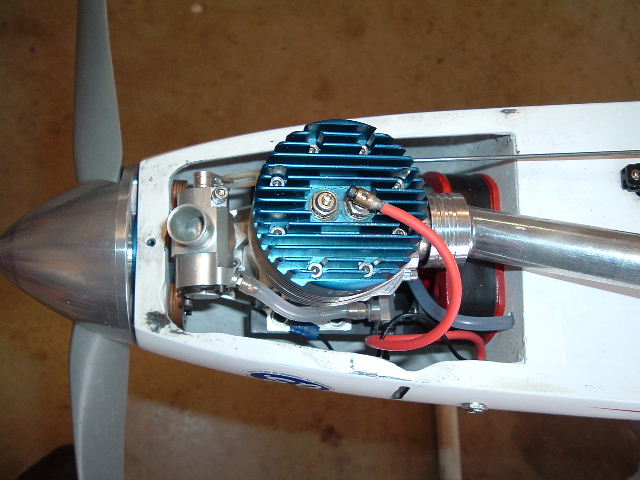

Here is what I did to make mine work. This is my custom mount. I originally had my Aries setup for an OS.
If you are still building the plane it will work if you mount the engine way out to the end of the beams.
Wayne G.

Do not cut the mount for the clearance you will ruin the mount. If you want I could make you one like mine. Email me off line.
Wayne
