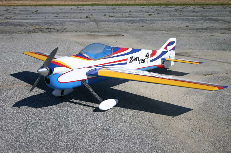

The only things I did to lighten it were: remove retracts and install Bolly CF gear
What sized Bolly gear did you use on the Zen? Nice looking plane, with FG.

It was the Bolly F3A Large... with their matching fiberglass wheel pants.
Made some 1/4 ply plates in front of the former and needed to add some plywood shims to make the gear 'level' when the plane was level. The shims weren't necessary but made the gear incidence zero. Kinda hard to explain, a picture is worth a 1000 words. I'll try to get some of those if you're interested.

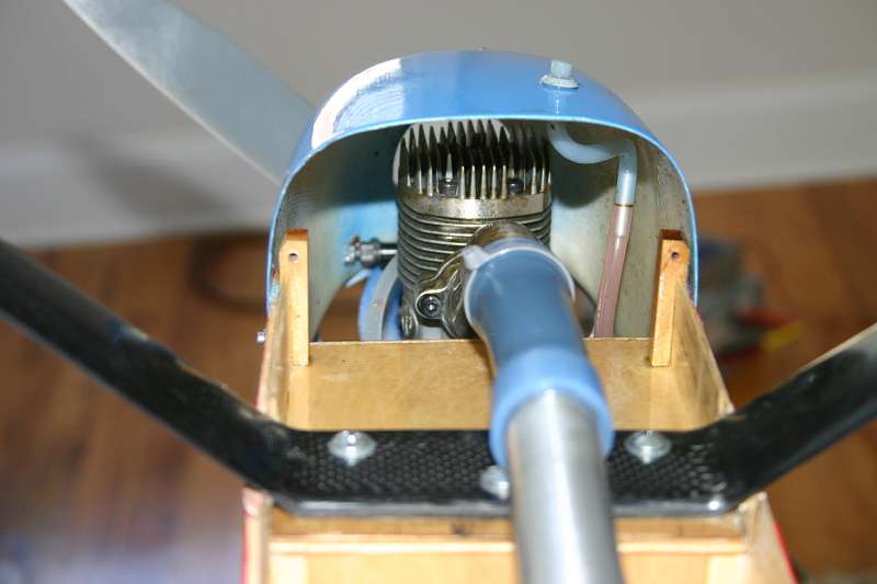

I know this isn't the shot of the firewall forward but it gives you a good pic of the landing gear installation...
Elevator and Rudder servos are Futaba 9206 and Throttle is JR DS3301. Ailerons are HS-5625MG (for now - will upgrade soon). Also using a Tettra tank.

Here are pics as promised... finally!
Did not modify the pipe tunnel but my buddy Erik did on his to accomodate his Webra pipe on the Webra 145. Basically he eleveated the rear of the pipe and made a cutout in the belly pan and sheeted it. So the end result is the pipe angling downward towards the ground. Mine is flush with the bottom of the wing as you can see.
I only made a small hole in the fiberglass fairing at the rear part of the pipe to accomdate the exhaust deflector.
Will take more pics when I have the cowl off. Hope this works for now. I apologize for not getting these sooner.
