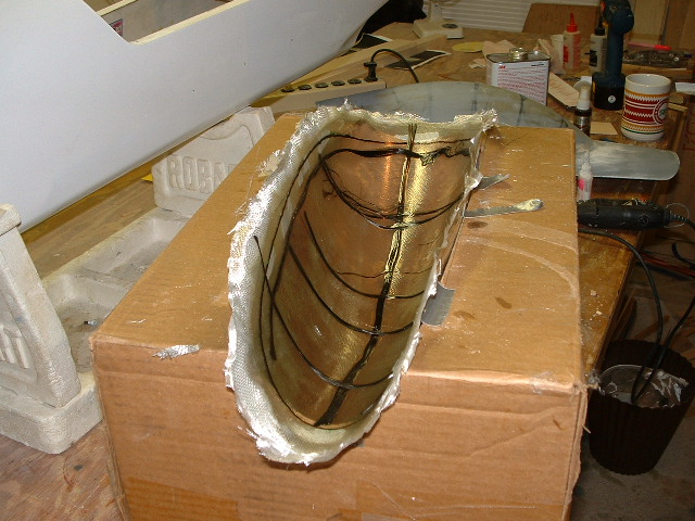

Tony our guys here have experience with ZNLine, PlProd and Piedmont and the Temptation glass work so far has been excellent. We cut all of our own wings so that part I can't comment on but the contractor that they are using for the glass has been great and the supply has been there too at very reasonable prices. It's good that an American company is striving to bring US flyers quality and value. Mike
My Feedback: (92)
Posts: 2,089
From: Rosamond, CA
Hi Mike,
I have only seen one Temptation kit, and the fuse was good, but the surfaces were not the PL/ZN quality. Maybe the Splendor will show improvements there.
Stephen,
I can't really help you there. I am not sure what the differences are myself. I think there is a difference in the amount of building done, and if the kit has all the honeycomb formers and servo mounts included. Maybe an email to PL will answer your questions.
Stephen,
Hey Guys not take anything from you about what you are saying about your airplanes, but remember the originator of the threads request. Anyone interested in buying a PL kit should contact Ultimate RC (Russ Honea) in Broken BOW, OK 918-258-0061
My Feedback: (34)
ORIGINAL: dflynt
I have a ZN line Supreme kit and I really like it. But if I had to choose, the winner without any doubt is the Partner. The Supreme has a large clear canopy which is heavy and very flimsy. I don't like clear canopies (anybody have a carbon replacement yet?). David
David,
You can get a kevlar/composite canopy hatch from ZN and do away with the clear canopy.
My Feedback: (48)
Joined: Jan 2004
Posts: 131
ORIGINAL: Doug Cronkhite
David,
David,
Thank you Doug -- I will pursue it. I kept wavering on whether I would try to create my own mold, but I would rather pay for one crafted by a professional.
David
Don Ramsey has posted a document describing my process for building the Partner @ http://www.cox-internet.com/donramsey/. Presently it's all words, however, there are 70+ photos that compliment the document that Don will post as he gets time / space. Most of the info is relative to any PL Prod kit, hopefully it will prove useful to someone.
Earl
Earl
My Feedback: (76)

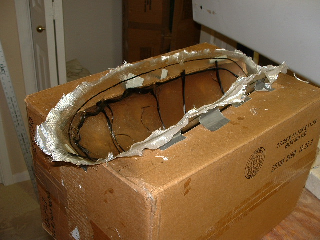

Here is another option. I took my clear canopy and made a cardboard box support crutch. Then I wax the inside of the canopy and spray PVC mold release in the clear canopy. I lay up a fiberglass canopy with Dave Brown CF toe and 8 ox glass cloth. Attached are some photos. I ended up saving a 0.5 oz over a clear canopy arrangement.
