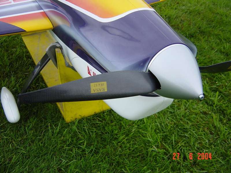

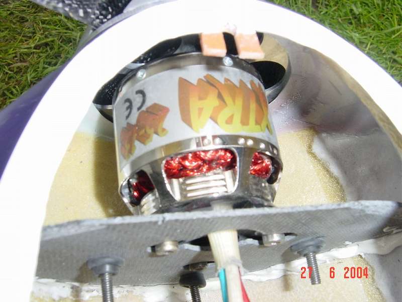

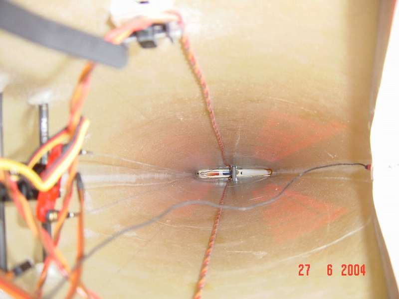

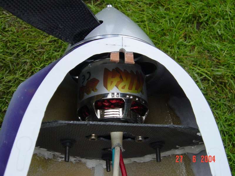

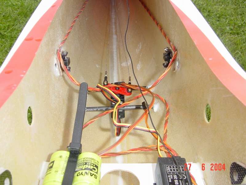

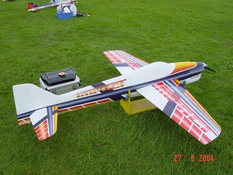

Hi Guys,
This past weekend I was at a fly-in here in Denmark where Bernd Beschorner (TOC competitor) and Manfred Greve Jr. were present. Manfred brought his completely new Impact powered by an electric motor....!! He finished the model in 3 (three) days, and the all up flying weight with a Plettenberg "outrunner" motor and Kokam 10S3P 6000mAh battery pack is 4600grams. Weight of the battery pack is 1400grams. The outrunners seem to be the new trend, as opposed to the more noisy geared motors such as the Hacker used by Jason and Tony F.
Manfred recently made a test for the German magazine FMT of the most popular electric motors for F3A, and the result was quite interesting when measuring the noise @ 3meters...
Hacker (geared, spur (straight) gears): 93dB
Lehner (geared, helical gears): 89dB
Torcman (outrunner): 88dB
Plettenberg (outrunner): 88dB
Ohhh, and Bernd flew his new Delro 42% Ultimate, beautiful!!!!!
I have attached a few pictures... [8D]

Morten thanks for the pictures. Can you provide the model number of the motor?
Old 06-29-2004 | 06:36 PM
  #60
Joined: Feb 2003
Posts: 493
From: Brisbane, AUSTRALIA
Default RE: Composite ARF Impact
Morten
Could you please give your impressions of flight performance of both the model and engine.
Peter

Hi Guys,
Some quick answers to your questions:
Motor is a Plettenberg Extra 25-13. I was told that the power output running the 10S3P Li-Po pack is 2.2kW, this is approx. 3HP.
More info can be found here: http://www.plettenberg-motoren.com/Xtra/Xtra.htm
Only in German though...
The flying qualities of the Impact seemed very nice. I only saw Bernd Beschorner fly it, and needless to say it looked extremely smooth in the hands of one of the worlds best F3A pilots. He flew the F-05 schedule, and the rolling circles and rolling loops were a thing of beauty. By the way this was the first time he flew the model, but I guess this tells more about the abilities of the pilot than the model....
The power of the motor seemed more that adequate, and I guess 3HP for a 4.6kg model is more than adequate. Also the 18" prop is a bit more effective than the 16" and 17" used by the 140-160 2-strokes.
First of all however it amazes me to see the slow flight performance of the electric pattern models. I saw the same when Jason flew in Poland, and it really gives the impression that the pilot has all the time in the world to make the required corrections. Also the braking down wards is phenomenal, there is no doubt in my mind that we will see a boom in electrics in the years to come. Wolfgang Matt has also made the switch, so it must be working... However the price and maintenance of the batteries should go down a bit more before we have the perfect solution.
