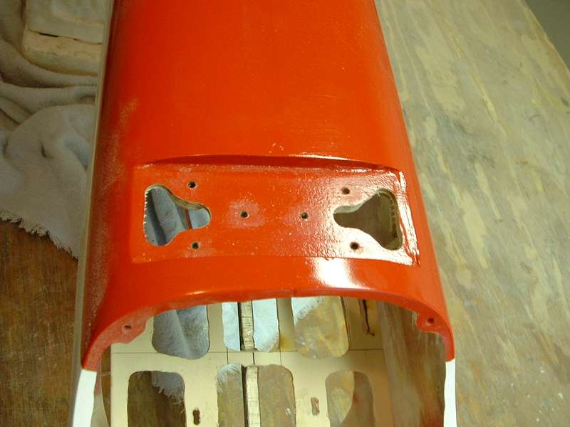

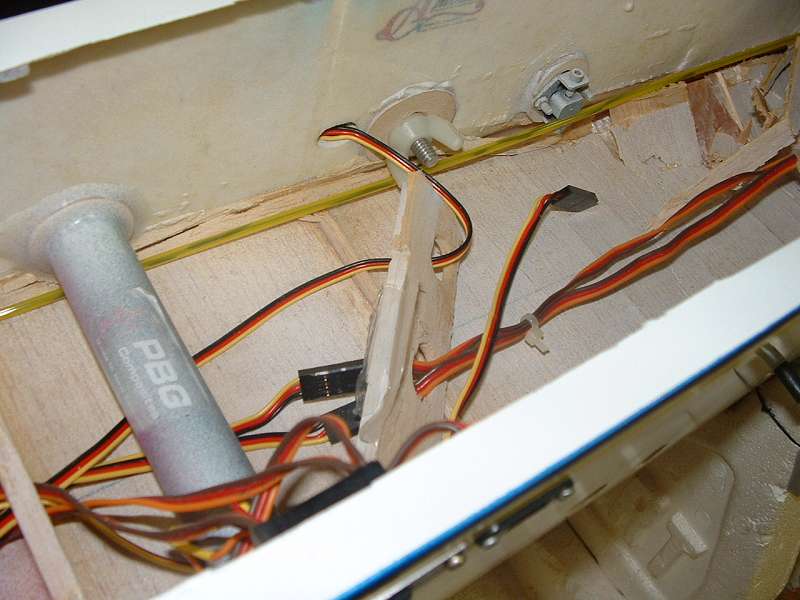

I dinged my #1 Eclipse at the Temple contest last month. While I was making the fuselage repairs, I converted it to electric. I am using the Hacker C50 14XL 6.7:1 motor, the Hacker Acro 90 speed controller and the Thunder Power TP600 10s3p batteries. The project can in a tad bit over the weight limit at 11#-6oz. I can get it under the weight limit by eliminating my repaired wheel pants, installing a BEC, lightened TruTurn spinner and aluminum nut. It's still raining here in Houston, so I'll try to test fly the plane next weekend. Here are some before pictures.

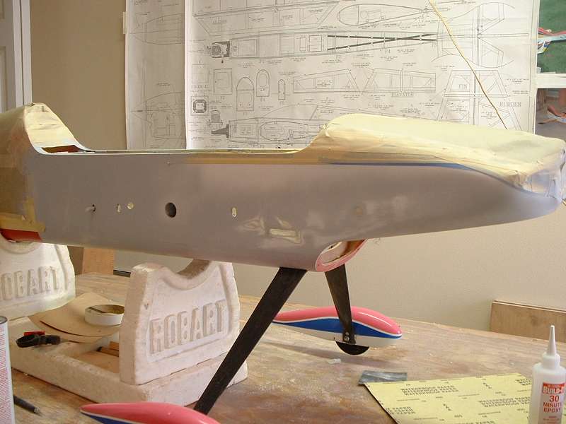

While repairing the fuselage, I moved the lading gear mounts down some 2.25 inch. This will allow me to clear the APC Electric 22-12 prop. Here are some photos of that modification.

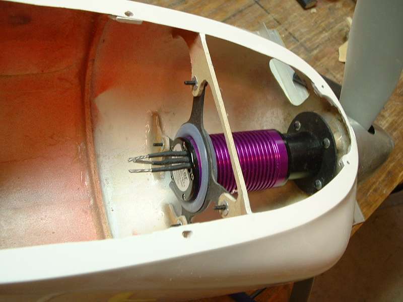

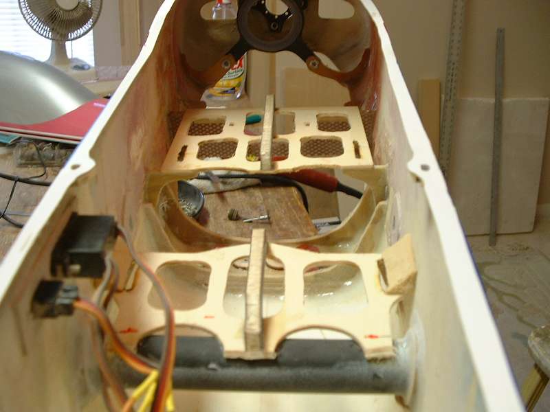

Next I needed to remove the fire wall and install the motor support rings. Here are some photos.

Here are some photos of the motor installation. I drilled #6-32 threads in the drive hub to make it easier to pull.

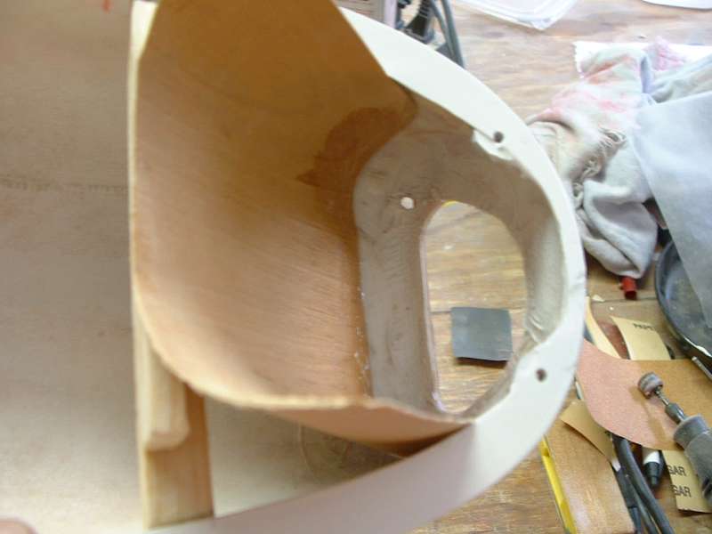

Thanks for the support. Here is a picture of my chin cowl with the air duct baffle. I went back and checked out my fuse weights. This fuse was one of the heavy ones at 33 oz (fuse, canopy chin cowl). My #2 Eclipse was a lot lighter at 29.5 oz. My Smaragd-z was only 27 oz. So just staring with a light fuse and eliminating the 2+ oz repairs, I can easily get my next plane under the weight limit.
Steve
