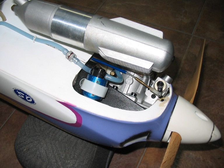

I'm just finishing up my Zafiro with a ST90 and a jett muffler. Mine seems to be coming out very nose heavy. Anybody have that problem? Where did you balance yours?
Old 05-17-2005 | 11:46 AM
  #40
Joined: Dec 2003
Posts: 21
From: Rosario, ARGENTINA
Default RE: CA models ZAFIRO impresions?
Hi JVB,
I'm using an APC 14x8 for pattern. Still I didn't try to fly 3D, but I think that an APC 15x6 is good for 3d. Is just my opinion...
Jeff-RCU
I had the same problem with mine. The solution was put the elevators servos in the tail. I dont remember the exact point of CG, I'm going to check the point later and then to tell you.
I had the servos into the fuse, in the CG aprox.
Hope that I have been useful.
Sorry for my english, I speak spanish.
Hernán.

Hernan,
THanks, you english is wayy better than my spanish! What engine did you use in yours?
Old 05-18-2005 | 07:54 AM
  #42
Joined: Dec 2003
Posts: 21
Jeff,
I used a OS91FX with original muffler. The problem I had was when remove the perry pump and put the fuel tank on the F1.
Hernán
