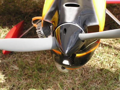

Old 10-09-2004 | 02:20 AM
Posts: 499
From: wilberforce, OH
Default RE: CA models ZAFIRO impresions?
I just got my Zarfiro today and man it is Beautiful.. Marcello was at Joe nall this past year ,and he had this plane and the fantasy.. He let me fly the Zarfiro and it was awsome. the plane is a good pattern plane and the 3D is great . Why didn't they have this stuff 10 years ago.. He had a OS 91 FX in it ,no tune pipe.. here is a picture of the engine up close.. dewey

Old 10-09-2004 | 09:41 AM
Joined: Dec 2003
Posts: 21
From: Rosario, ARGENTINA
Yes, is easy to modify and have enough space, you must to make a hole and a small compartment for the tuned pipe, wait to see the pictures.
The YS110 is a great engine and I think that is not too heavy, just a little more than OS91FX.
I think that YS110 is good for 3D flight and the OS91FX for IMAC. Marcelo recommended me anyone of these two engine...
Hernán.[8D]

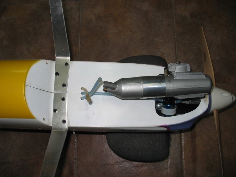

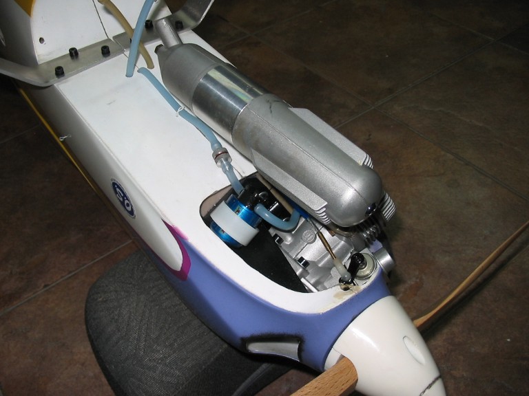

Old 10-11-2004 | 10:48 PM
Joined: Dec 2003
Posts: 21
Well, these are the pictures...
ID:	181830   Click image for larger version
ID:	181831   Click image for larger version
ID:	181832   Click image for larger version

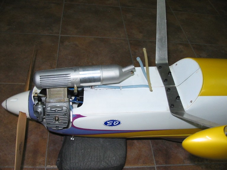

Old 10-11-2004 | 10:51 PM
Joined: Dec 2003
Posts: 21
and more...
ID:	181834   Click image for larger version
ID:	181835   Click image for larger version
ID:	181836   Click image for larger version

Old 10-12-2004 | 03:22 AM
My Feedback: (182)
Joined: May 2002
Posts: 1,085
From: Pittsburg, KS
Hernan,
Thank you for the pictures!!
Well, I think it will be better off to get a performance specialties one piece tuned muffler than a regular tuned pipe with header if used with 91FX. I hate work on the glass fuselage for pipe tunnel.
Otherwise, a 4-stroke will be a good idea.
By the way, what kind of paint is it?
IP
Old 10-12-2004 | 10:56 AM
Joined: Dec 2003
Posts: 21
PatternFlyer,
If you want more pictures with details, just tell me, is no problem...
I think that the YS110 is more than enough power, if you do not want to modify the fuselage this engine is the best choice.
I tell you that the OS91FX is too a good choice, the vertical is unlimited... think about that... [8D]
The paint I used is polyurethane bicapa, 2 components, for finishing (automotive paint).
I did prepare the colors bases with the samples of Oracover (I used Oracover films).
Hernán.

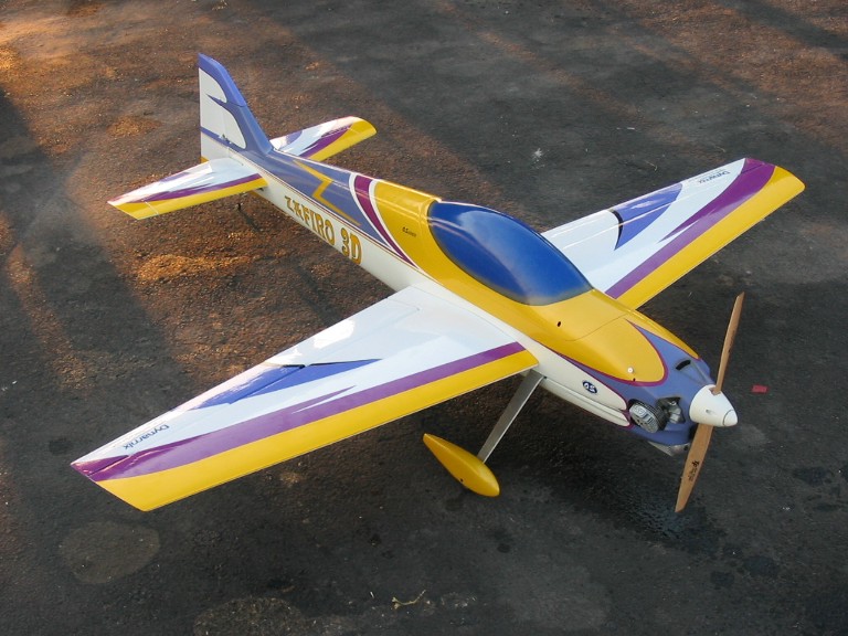

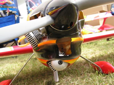

Old 10-31-2004 | 11:27 PM
miniCAP's Avatar
Joined: Apr 2004
Posts: 52
From: Pocatelo, ID
Well, I finally finished my Zafiro. I flew it today for the first time. It was quite windy so I didn't attempt anything other than keeping it in the air. Despite the gusts of wind, it handled very nicely. This is my first pattern plane so I don't know exactly how to describe how it flew other than very fast and it went where I pointed it, let me repeat, very fast!
So, here are the specs:
YS 1.10
Hatori pipe
JR 8103 with three DS811 and two Hitech digital mini servos and one other generic mini for throttle
Paint is PPG and covering is Monokote
I haven't been able to weigh it yet but it seems pretty light and by the way it flew I think it is alright. The take off was very short, power simply is not an issue. I cruised about half throttle into the wind and idle downwind (not kidding). As for stalls, it was pretty uneventful, which is ok with me. Landing was easy and smooth. It needed a little down and right trim but it was not bad at all. I can't wait until it's calm so I can push it a little more. Overall, I am very pleased with the plane. It was fun putting it together and I learned a lot. I chose to put in wing adjusters but I don't know how necessary they were. Adding the pipe wasn't to bad, just a little more work but I love the lines of the fuse, especially the front so I wanted to preserve as much of the fuse as I could.
