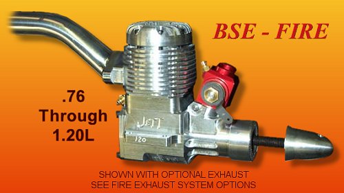

Dub does configure some of the engines for speed applications. You will read a great deal about whiplash and diamond dust speed planes. The key here is that all of the engines are build and configured to order, based on the application for which they are intended.
Over the past couple of years, Dub has developed the big-block BSE engines into amazing powerplants.
Although Dub does make an awesome "90" engine, the SJ-90L and BSE-90L, the Jett BSE-100 and BSE-120 were designed from the ground-up for pattern/3D/scale applications. They turn larger props at lower rpm. All 3 engine are "60" size cases, and they match the mounting dimensions of the OS91FX. Any of the Jett engines are available in either side or rear exhaust configuration. The BSE-120 FIRE version, engine only and spinner nut, weighs about 21oz.
The engines typically are set up to turn in the 9000-11000 rpm range, but when set with a longer pipe, they gladly turn down in the 8500-9500 range.
The engines are not pumped, as with the OS91 or ST90.
As a pattern flyer from some time ago (1980s, early 90s), I sure wish I had one of these back when I was flying
I had a sweet flying EU-1A that would have really enjoyed having a 90L in the nose.I hope this is useful, and provides another "90" size option to consider. Any questions, feel free to email or PM.
Bob

I will grant you they are not inexpensive. Definately not along the lines of chinese built products. More along the lines of the top end Japaneese and European built pattern engines of a few years ago though.
Looking back a bit, I seem to recall paying somewhere along the lines of $220 - $325 for OS61P, YS61, and Hanno 61 engines 12-18 years ago. I believe the YS120 was more. I would imagine most folks considered those rather expensive. I know I did! They were a far cry from the $99 webra speed .61 I first started pattern with
Along those lines, the Jett engines are not too far out of line.
Consider this though, they are made in Texas, USA, made from domestic materials, real chrome sleeve, one of the best carbs anywhere, each one is test run and set up before you get it, and are supported with customer service directly from the man who designed, fabricated and built the engine. As I tell some folks, there is a lot more to the value of a product than its price
Anyway... hopefully they provide for some options.

Wow, thanks for the information. I'm gonna have to try a Jett 1.20 FIRE. I'd still like to put a pump on it (like a Perry/Varsane) so I could mount the tank on the CG. Any problems that you know of with that set-up? Also, who makes the headers - they look very nice. A Jett 1.20 really weighs the same as an OS .91FX ??
As for price - you get what you pay for. Numbers - based on the serial numbers on the Hanno SPecial. I don't think OS made more than 10,000 of them (actually, I think they made about 7,000 of the original version and maybe 2,000 of the MKII). By the time the MKII came out, the YS 1.20 was dominating pattern. The MKII was supposed to be the penultimate .60. Anybody out there ever run one - please comment. Conversely, in 1997 (give or take a year) Great planes sold 40,000 OS .46FX engines in North America - That's ONE year. The OS 1.40RX is still a great pattern engine and I'm sure OS doesn't see a need YET to produce a more powerful, pattern specific engine.
DOes Jett have a web site??
Happy flying!!

jettengineering.com is the web site. The BSE engines page has most of the 1.20L info on it.
Headers.... I believe Johnson is making those for Dub. They are available in a few different rise sizes.
Pumps...... Dub has in the past utilized the perry pumps in a few applications. I've tried them too. In most cases, they work ok. In some cases, they were not quite as effective (mainly on the higher rpm engines). That was using them as "direct supply" pumps. In some cases, we found better results simply running a 2oz tank as a header tank right behind the firewall, which was fed by a tank over the CG.
More recently I have been experimenting with the iron bay regulator and fully pressurized system, and also gathering some info using the perry pump with a return-loop system (works more like a fuel pressure regulator) similar to what the helicopter guys use. Results are promising, but I don't have enough data and flight time to claim a victory quite yet. Cold weather is setting in... not sure how much time I will get in testing over the winter.
As Dub likes to say... everything works once in a row. When you can duplicate the results consistantly a great number of times, then you are on to something. So I tend to error on the side of caution before making any official recommendations
If you wish to get more specific information on Dub's pump tests/experience on the 1.20, drop him a note directly at [email protected] and he will glady reply.
Bob
