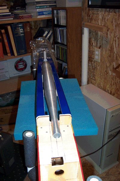

#278
Join Date: Feb 2004
Location: Homedale,
ID
Posts: 56
RE: Excelleron 90

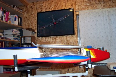

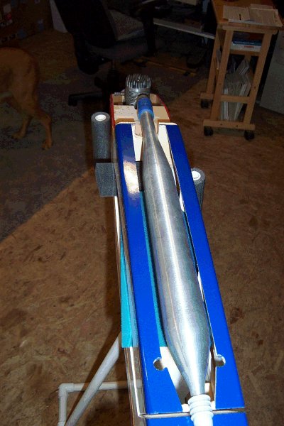

Hi Bob,
I did not realize that the picture did not clearly show that the pipe is partially in not on the belly pan. I thought I would get some of the cutting out of the way before I attached the belly pan to the wing. Good advise on the cut out width. I need to expand the belly pan cutout also. I will be moveing the fuel tank to the rear and down as low as it will go so that it will clear the pipe cutout in the firewall and to get it closer to the carb level. The rear of the tuned pipe clears the fuselage behind the wing but I think that I will use the exhaust deflector as an insulator and to get the exhaust away from the belly.
ORIGINAL: aerobob
Looking good! You may want to widen the clearance on the sides of the header where it goes over the firewall. My ST thumps pretty hard at low idle, and there's a considerable amount of sideward movement.
Have you started on the wing bottom tunnel?

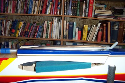

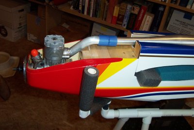

#282
My Feedback: (198)
Join Date: Feb 2002
Location: El Reno, OK
Posts: 6,707
RE: Excelleron 90
It's just one zip tie per flying session. I remove the one on the pipe neck. Since it is soft mounted, it is pretty easy to work it out of the short coupler piece. All the flex is a good thing; reduces noise and vibration.
I should have mentioned that.
The canister is held on my pipe mount with an o-ring that loops around the canister, and under screw heads on either side of the pipe cradle. It isn't very easy to install, but then that doesn't get messed with unless it breaks!
#284
Join Date: Feb 2004
Location: Homedale,
ID
Posts: 56
RE: Excelleron 90
AeroBob,
No, just the opposite. I appreciate the input. I was thinking clearance for heat and didn't really know how hot the pipe would get that far back. I had not given that much thought to the engine rocking around. I looked closely at your pictures and saw that you had considerably more clearance. Easier to make it bigger then smaller.
I tell Ya, I'm not that meticulous. I just want it to resemble something like a straight cut. I was also trying to see when I should stop bending the header. I'll do some more cutting and get it sheeted. I'll put up more pic's then and see what you think.
A very Happy New Year to you Bob and to everyone else too.!!

#286
Join Date: Mar 2003
Location: EDMOND,
OK
Posts: 101
RE: Excelleron 90
Bob,
I ran into the same problem on my TS 120 engine lugs as you did with the ST 2300. What type of grinding bit did you use to grind off the lugs?
Greg
Greg
#287
My Feedback: (198)
Join Date: Feb 2002
Posts: 6,707
RE: Excelleron 90
It's the #115. 5/16" diameter, end and side cutting bit. Looks like a mill bit. I held the dremel parallel to the crankshaft and just worked the square edge of the bit from the outside edge of the lug working toward the crankcase. It worked very nicely. Easy. Wally World has the bit, too.
I also mounted the engine mount with 6-32 socket heads into blind nuts, easier to shift/change for different thrust/offsets, etc.

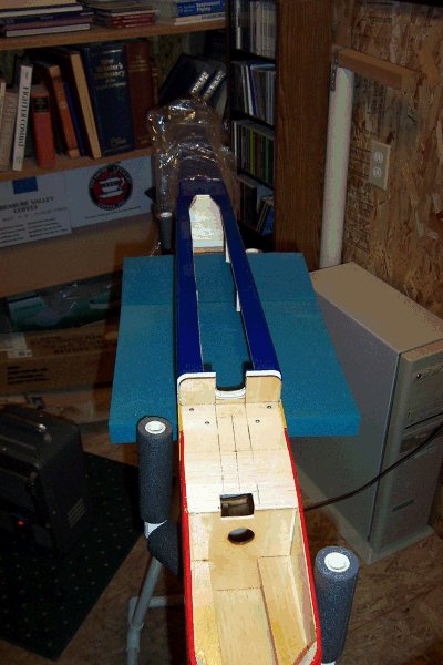

#288
Join Date: Feb 2004
Location: Homedale,
ID
Posts: 56
RE: Excelleron 90
Hi Pattern Student,
I'll put up some more pictures here and I will have better ones tomorrow. I have the wing together now so I can mount the belly pan. The pipe will clear the fuselage past the wing. The pipe is on a downward angle to do that. You could leave it flat and modify the fuselage further back but I don't see that it is necessary. This way the pipe is more in the breeze for cooling. Does anybody see a down side to this?
Question for AeroBob. Did you mount the belly pan with silcon sealer as the manual states to do or cut the covering and epoxy the belly pan on?
ORIGINAL: Pattern Student
Hey olddogg60,
Thanks for the pix of the TT120/pipe set-up. Do I correctly understand that you did NOT have to do any surgery to the fuse behind the wing T.E. to clear the pipe exhaust? I can't quite see what I think I want to see from the pix.
Hey olddogg60,

olddogg60 - VERY nice work on the tunnel, and going behind the t.e. Proves that it's do-able...so...maybe I will consider a 1.20 on a pipe like you're doing for Exc. #2 (still NIB) Looks VERY nicely done!!
#295
Join Date: Feb 2004
Location: Homedale,
ID
Posts: 56
RE: Excelleron 90
Thanks aerobob. I widened it all up as per your advise.
Did you reinforce the wing center section?
Bill
but most of it was where I had my CF weave epoxied to the wing anyway.
#296
My Feedback: (198)
Join Date: Feb 2002
Posts: 6,707
RE: Excelleron 90
Yep. I marked the tunnel on the joined wing, then carefully removed the covering on the bottom. In the bare space that left, I used some .5 oz CF weave cloth (not matting, this is a unidirectional fiber stuff from Lonestart Balsa) laminated with epoxy. May not do honkus for reinforcement, but the psychological factor was helpful. I only did the bottom, also.
#297
Join Date: Feb 2004
Location: Homedale,
ID
Posts: 56
RE: Excelleron 90
Pattern Student,
Here are a couple of more pic's. The wing and belly pan are just set in place and the pipe is resting on the fuselage at this point. I haven't figured out the rear pipe mount yet but I will raise the pipe off of the fuselage just a bit. In the one pic the belly pan is removed so you can see the pipe clearance from the wing.
Bill
Bill
#298
Join Date: Feb 2004
Location: Homedale,
ID
Posts: 56
RE: Excelleron 90
Thanks Bob. I understand. Peace of mind. Your pipe mount is attached to the CF then?
Bill
ORIGINAL: aerobob
