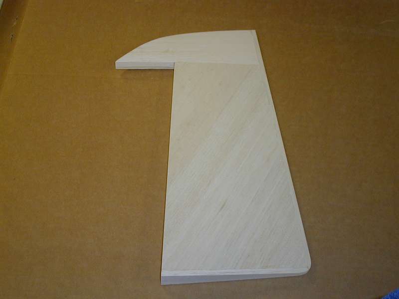

I too didn't like the rudder for the Impact. My stock rudder straight out of the box was 82 grams! (and that is without all the hinges and post). I decided to experiment with building an all balsa one and just bevel the hinge line and use CA hinges, then seal the gap. It is still a work in progress but here are some of pictures of what I've got so far.
So far I have saved about an ounce (the all balsa rudder is 54 grams...before shaping and beveling). Based on several other Impacts I've seen in the area, I decided to move the rudder pull-pull horn above the stab, a position that allows for straighter and more convenient rudder servo installation.
Anybody else have any weights for their redone rudders?
-Erik
Nice work Erik! I will try to do the foam cut for mine over the next week and see where I come out on weight.
I will also likely change the location of the rudder horn as you have done -- and I know a couple of others plan to do the same.
David

I am using ball links but I am not using the phenolic control horns. I picked up some uni-directional carbon fiber from Aerospace Composites and cut out all new horns. They are extremely stiff and I have had no problems. The other thing you could do is set up the Impacts controls like the scale aerobatics guys do. They order a second set of control horns and mount them side by side with a gap between them big enough to get the ball link between them.
I am a strong proponent of building a new tail components for the Impact and have written about this before. The stock parts are much too heavy. Good job!

Almost Matt, I am hoping to fly her next week end, after our last talk on the phone I did decide to go with the ladder assem. from the rear former to just behind the canopy and carbon push rods for elev. control and got the elev. servo's out of the tail. My ladder I built came in at 1.2 ounces with the glue and the elev. control rod assem was about 1 ounce without clevises. The hold up was waiting for all the stuff to arrive from central. All I have left is installing new leading edge on the old rudder, close up the back of the fuzz and hinge. I am looking at how easy it looks to build a whole new rudder { pics in this thread } I may just build a new one. I will give you a ring tonight.
Yes, the rudder is very simple to put together from sticks. I do that all the time. That size rudder should come out at around 45 grams ready to install. That's more thean 1 1/4 ozs saved on the tail, which will compensate for the ladder considerably
The other major factor is the actual flying of the lighter rudder. Much longer servo life and quicker actuation and damping.
