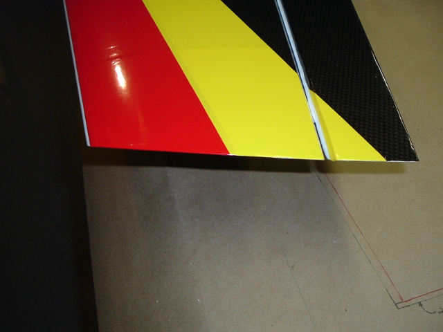

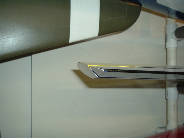

Alrighty.....I'm working on a Excelleron/Typhoon/Epsilon close to 2 meters want to be pattern plane. I'm ready to cut the cores for it and have a question about wing tips.
The wing tips on the Epsilon are very simple and light....one 40 degrees cut and an 1/8" cap.(pics).
I'd like to know if this kind of tip has bad habbits or should I stay with the traditional shape?

Doc -the slashed tip is a very old design trick -and properly used - works great.
It simply acts as dihedral
Most new pattern designs are very similar to stuff done over last 15 years - the large cowls don't really add anything- in the way of drag -tho they can screw up prop flow.
The best part is the increased torsional rigidity at front of the model
For those still using the shaker engines - this is a worthwhile - for an electric motor - not of any benefit.
However, the deep fuselages with increased forward lateral area, are good for the sequences and the lighter and stiffer the airframe , the better.

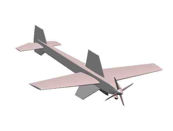

My two cent...a picture is worth more than thousand of words....

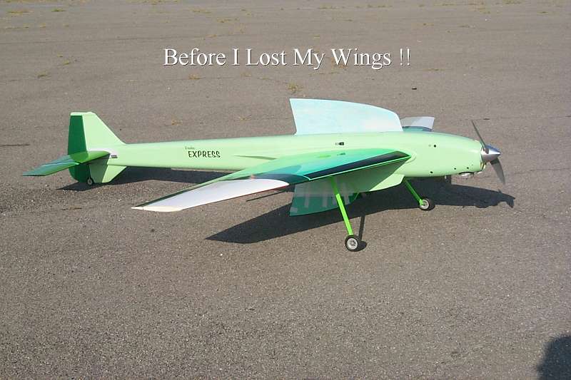

I wish Nat Penton would post in here....the "Voodoo Guru" allowed me to fly his plane (image 1) after the LARKS meet last Fall. It is the most neutral thing I have ever flown...period. He is a true aerodynamics thinker and tinkers constantly with new theories. His use of an anhedral stab is partly to keep at least some area of the stab in clean (or cleaner) air in all angles of attack. This design also includes flow straighteners that reduce the effects of torque, etc. This plane has zero engine thrust...not sure of other incidence numbers on stab and wings...they are probably at or near zero. Oh yeah, he is also a master at building light...70" (approx.) wingspan, 78.5" length, 8.5 lbs., OS91fx. The voodoo express is strangely stable in all axes.

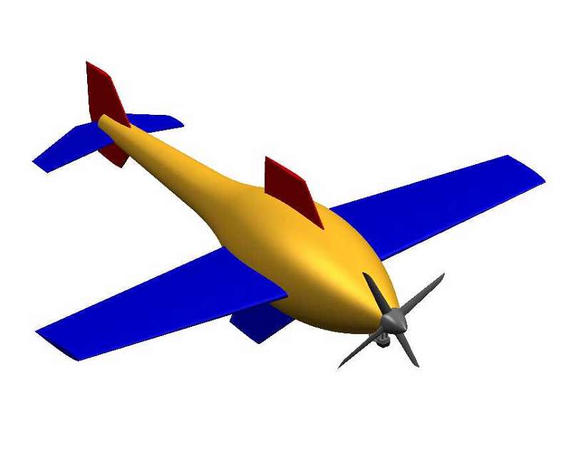

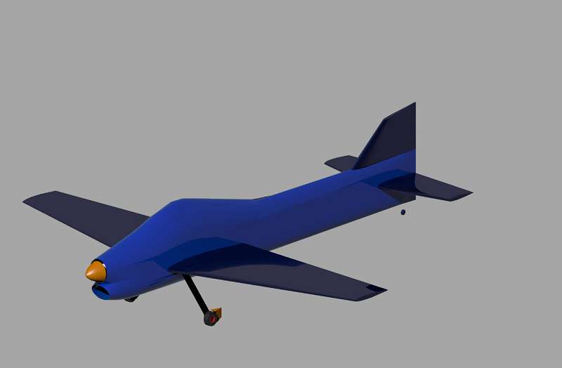

I hope to build one of my own sometime this year...see 2nd image.
Some people are all about parasitic drag????...I thought, what if we were to mate this with nature's aerodynamic model of the raindrop? See 3rd image.
Where are you Mr. Penton?
This is a great forum.
-Mark
