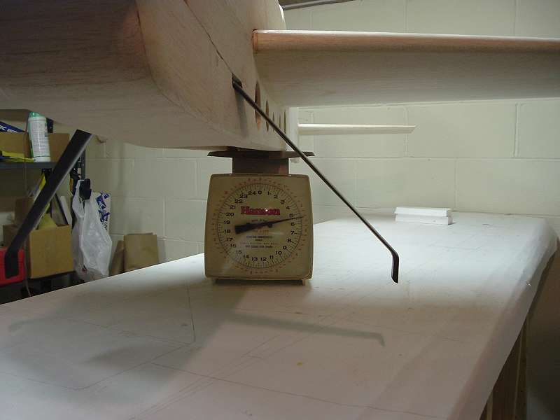

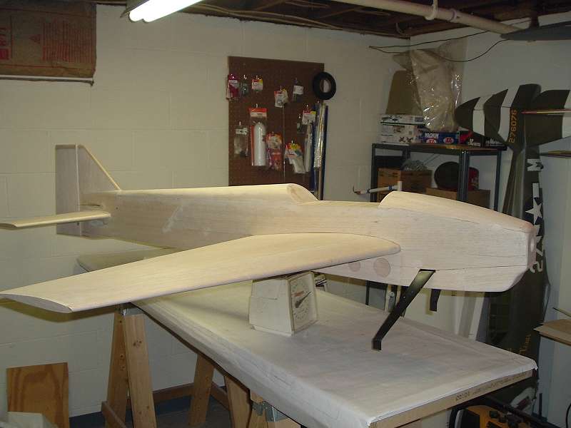

I have a question about Ultacote.
The pics show my latest efford in a close to 2meter plane with Gator mount/CF LG/1 servo/pushrod installed and its close to 5.5lbs. If I were to cover it in one color, how much weight would I be adding? (Ball park figures are OK) Plane is 75x75

Thanks JVB...that sounds like it'll get me close. I was hoping someone had been at the same stage I'm at now and had a idea of the weight it would add...but this will work
Thanks again LShaver
