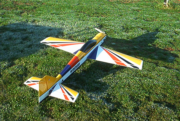

Is there enough room to get a YS 110 in the Widebody 60? With a Hyde mount?

I have a 110 in mine and it fits in ok, but I'm using a more standard mount. I glued blocks infront of the bulkhead for the cowl to screw into, that gave me a little extra space to put it in. Its a very good combo though, very powerful motor. Mine came in slightly above 7.5 pounds and could be built lighter.

I miss mine too! It was the best flying 60-90 sized pattern plane I have ever flown, in my book it had no equal. I don't know about the infinity, leo or excelleron, but the WB 60 was hands down the closest thing I've ever flown to a 2 meter plane without being a 2 meter plane!
Stupid power line. May she rest in pieces...
