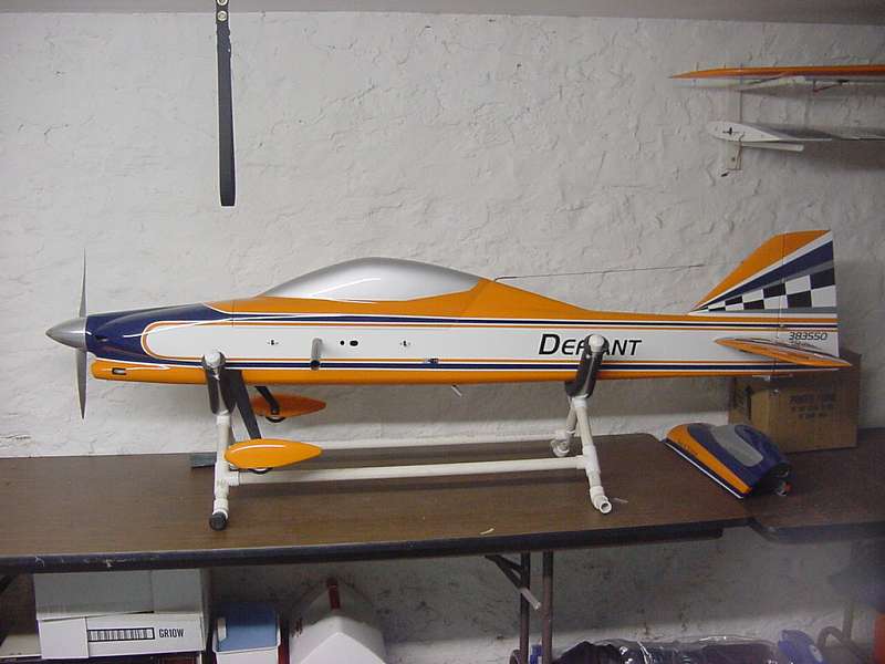

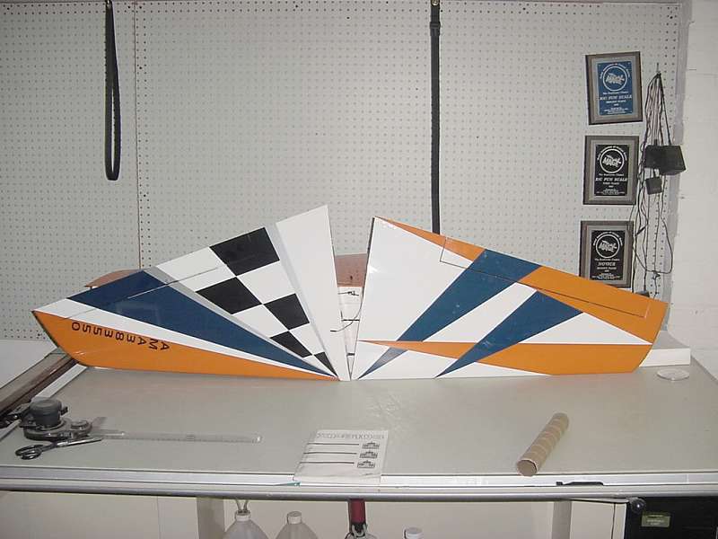

I just finished making some modifications to my birds. Both received a new canopy and chin design in attempt to increase side and frontal area. It'll be interesting to see what difference the changes make
Next will come new wings and stabs to complete the make over.

Looking good, Todd! Additional canopy area should really help slower rolling stability, and slower knife edge w/less rudder. Should decrease your workload on rudder a lot!
Hope to see those pretty soon!!

It's always a pain redoing something thats already flying, but always room for improvement. I'm hope the larger canopy accomplishes exactly what your thoughts are Bob. Hopefully I'll be able to find out soon. I need all the help I can get to compete with you guys this year!
Charlie, the new wings will be similar to the last version. Same airfoil, but I'm increasing the span from 72" to 75". I'm also moving the tips forward a half inch. The stab is going to be replaced on the airplane pictured with the same stab thats on my newest plane. Its thicker, larger and seems to fly smoother. My goal this winter was to get both planes the same. Hopefully I haven't screwed them both up!

The wing I flew last year on DEF2 (72") was quite a bit smaller than DEF1 (77") but did'nt snap as well IMO. However the wing on DEF1 would not drop into a spin as good as the smaller wing. The wing on DEF1 had the extreme swept tips which might have helped its snapping,
The new wing will be in between these two. Total wing area will be around 980sq in" The stab on DEF2 is the one I'm staying with, its still not real big and seems to be quite a bit smoother than the small stab on DEF1

Todd, I wish I knew more about stab design... the only thing I know is Mike Harrison once was coaching me and pointed out that stab size had a tremendous effect on spin entry and slow speed stability...I never did get to follow up with him much.
It seems that more successful 'current' designs have a lower aspect ratio; not really a lot of span, but plenty of squares near the root. The three birds in my house right now appear to have same percentage thickness as the wings, and the same planform....and I have no idea why, unless it's to "make it look about right"
Stab size is important in terms of pitch stability. Depends entirely on the kind of flying one needs the model to do. For older pattern where a model essentially drew straight lines and curves with large radii, a larger stab produced smoother, more graceful flying. That is, larger stab as a percentage of wing area.
Present day patterns require much greater acrobatic ability from a design, with ability in both smooth lines as well as snaps and spins, in various attitudes. Smaller stabs will reduce the pitch stability of a model and allow it to perform far more aerobatically than the earlier designs could.
Stab thickness matters little as long as it is within reasonable window. Too thin and structure becomes unstable. Too thick for the chord involved, and desired crisp response maybe compromised.
Tail Volume Coefficient is a parameter that should be understood by anyone designing. In my experiments, TVC's within a certain window produce snappier, crisper maneuverability, yet straight lines and smooth curves are easily flown as well.
Fin/rudder size affects yaw stability just as a stab affects pitch. However, unlike the horizontal surfaces (stab vs wing), the vertical stab only has the fuse to stabilze plus the vertical component of the wing area(due to dihedral.) Older designs tended to have wings placed lower in the fuse which meant more dihedral and hence a greater vertical area component. We could get away with a pencil thin fuse and still have decent yaw effect because of the wing dihedral.
As wings were raised, they had to get flatter for reduced roll coupling. That tended to reduce rudder effectiveness, since the effective fuse lateral area was reduced. These models were extremely stable in yaw and had trouble performing crisp snaps and spins. Fuses required a deeper section around the cg to get improved rudder effectiveness again. That's where we are today.

Your input is very interesting and greatly appreciated. One of my first "real" pattern planes was a SL1 that I flew for several years. This plane had a very large stab at 36" and was placed pretty high in the fuselage. It was one of the worst snapping/spinning planes I ever flew.
I do have trimming question for you or anyone else that can help.
The wing on the Defiants sets on the thrust line which I know is uncommon in todays designs. The wing has no dihedral and the stab sets 1/2" above the thrust line. What I like about this arrangement is how axial the plane rolls. It does have a slight pitch to the belly on rudder input, but from what I read most planes do. In advanced, I was able to get away with flying it this way, but this is something I'm going to have to correct before flying the new Masters pattern. What do you feel is the best way to correct this problem? Currently my wings are set at -0- incidence and the stabs .5 to .75 negative (leading edge down). Do I need to zero the stab and try a little positive in the wings?
Todd

Todd, if you have wing adjustability, increase wing incidence before you do any thing else. I am talking 1 to 1 1/2 degree positive, not just a couple turns on the screws. Do one thing at a time. Most likely the plane will require a bunch of down trim. That's okay. Observe the knife and start removing some of the negative from the stab. Eventually you will most likely arrive at a stab that is also positive relative to the reference line. The model will look like it is flying with the tail a little high possibly.
If no amount of tinkering with the incidences helps enough, then add a dorsal fin about 1 1/2" wide by about 12" long (triangle actually) from the base of the vert fin, forward. That will improve the character of the knife edge and you should be able to take out about half of themix you are using now.
Observe how the downline is affected. With the wing at about 1 degree pos, and the stab at about 1 degree pos your down line should be pretty close. Check your up line. If the up line pitches to canopy, add a little down thrust about 1 degree. Most likely it will not pitch to gear, but if it does, after an extended vert line, then you may have too much down thrust. But I doubt it.
Make sure you track all your changes so you can return to where you were.
Let me know how you make out
