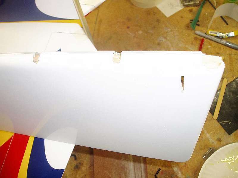

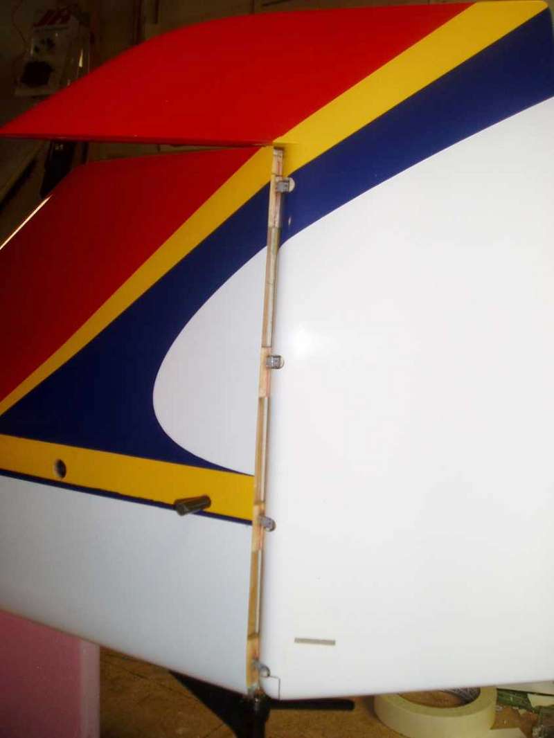

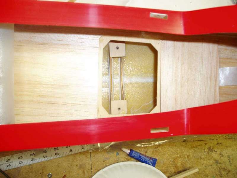

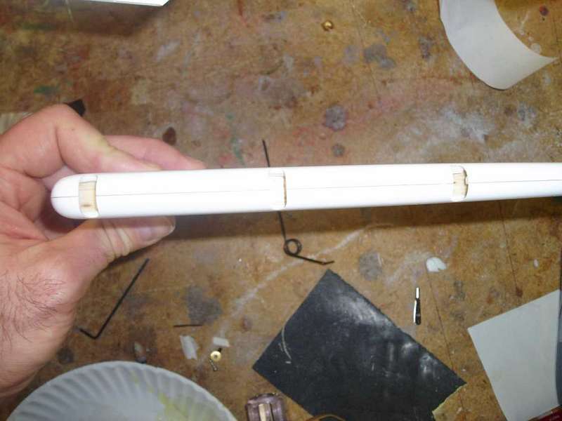

A few shots to show my paranoid reaction to the rudder hinging design. As designed, it would leave about 3/8" of unsupported Robart hinge to either side of the hinge line, i.e., the mounting points are rather deeply recessed into the skins to make it all look nice and have the rudder's rounded LE fit within the fin's TE skin, but the concern this raises in my mind is that the Robart's will flex and stress a good bit this way. Though not all the closeup pictures of the rudder mods didn't come out well, the last one shows fairly well what I did to make myself feel better abuot it all. Just CA'ed some hard balsa inside to firm things up for the hinge points. This required sawing off the bottom piece of the rudder LE to allow me to slip the balsa pieces up through the rudder LE, but the scar hides well down there with all the tailwheel HW clutter.

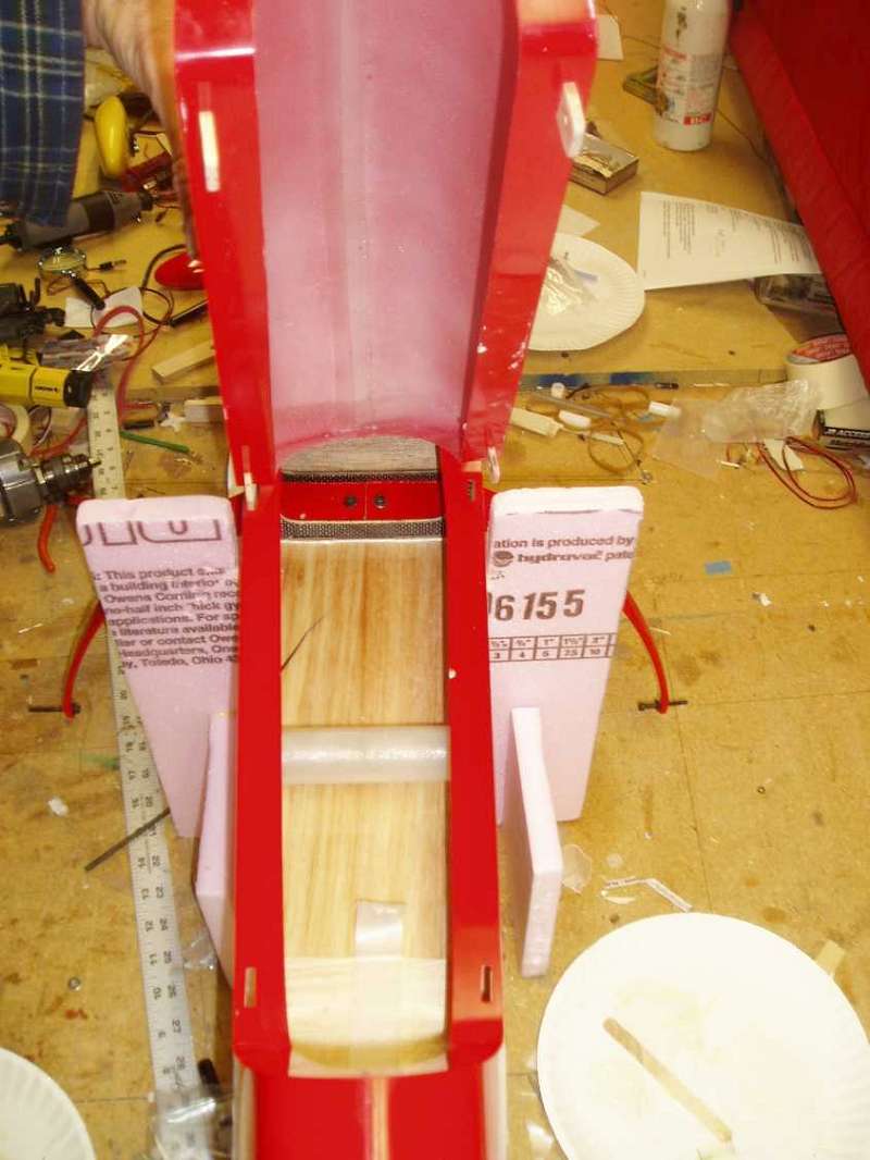

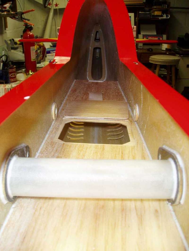

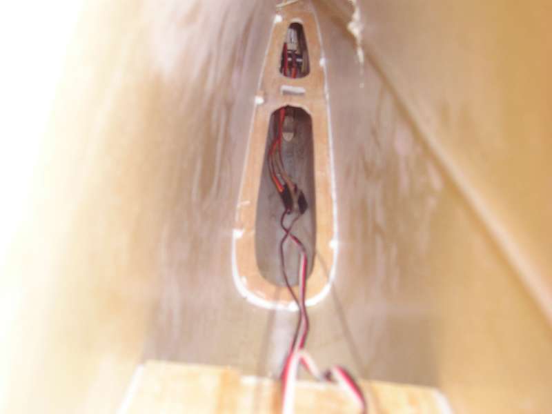

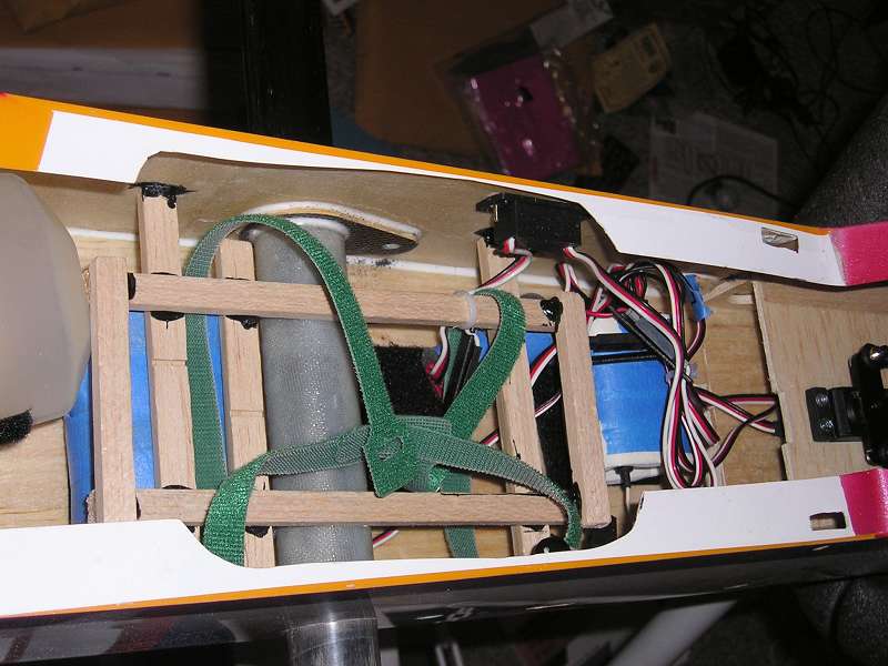

A little more detail on the inside to show the LG setup, the pipe mount, a view aft inside the fuselage. Nice, neat work they do here.

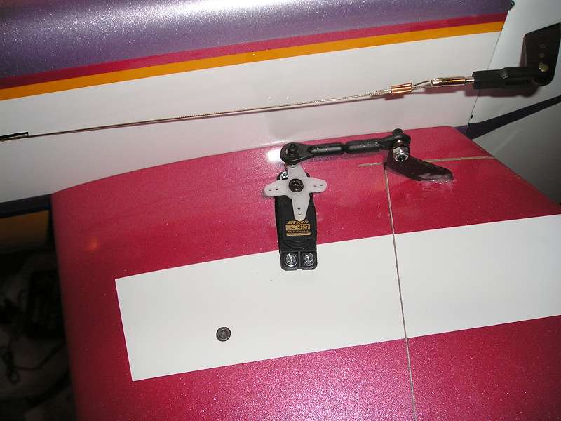

Default RE: OTOP PICS!!!
What type elevator control linkage are you going to use ?
tommy s
Old 04-06-2005 | 04:45 PM
  #29
My Feedback: (42)
Joined: Jul 2004
Posts: 878
From: Randolph, NJ
I'm still puzzling through how I will do the elevator connection. Most likely, a CF pushrod, standard stuff. It's interesting though - they provide some nice little FG laminated balsa pieces to build rudder & elevator servo trays from. Now, based on the stock dimensions of the trays, the rudder servo will wind up completely aftwards in the radio bay, right behind the access hatch for the pipe. This leaves only a spot in front of it to lay the elevator servo on it's side. It appears to be a really tight clearance to get the CF rod to go under the rudder servo. I can modify everything and all that, but it just looks a bit tight by factory standard design. I spoke to Carla at Planes Plus today and a photo instruction disk is on the way. To be completely fair, I think the reason I didn't get this with the order is because I had a buddy take this straight back from Toledo and in all the post-show rushing around, the disk got forgotten. Everything is pretty much self explanatory anyway and so much work is already done for you, it's almost criminal .

Old 04-06-2005 | 05:49 PM
  #31
My Feedback: (42)
Joined: Jul 2004
Posts: 878
From: Randolph, NJ
You're thinking about maybe doing pull-pull on the elevator? At a glance, the locations for the phenolic horns appear to be a bit too far outboard to make that an attractive solution, meaning that the cables would probably have to exit the fuselage fairly far ahead of the stab location. I think it should be fairly straightfoward to do typical bearings or pushrod guides in the tailpost.

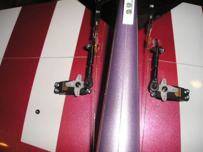

Instead of using a CF rod, I just put two mini digitals in the stab. Plane balanced with the battery right in front of the wing tube.

hmmm, I could do a pair of 9411SA's. Combined weight is about .8oz more than the mini's I think, but it's what I happen to have. It would sure go together more easily.

Yes, putting two minis in the stab is definitely the easiest way to go. I've never
done that , always worried about them moving exactly alike.

Did you use the stock hinging on the rudder and if so are you happy with
how it works ?
tommy s
Old 04-13-2005 | 09:56 AM
  #46
rgreen24's Avatar
Posts: 1,113
From: Omaha, NE
Tommy I did use the smaller robarts hinges, at first but they broke, so I went with the next size up.
