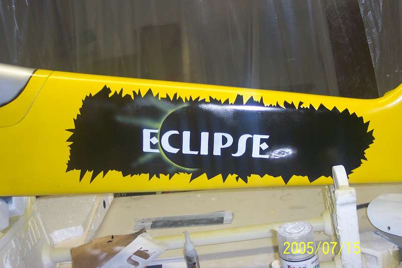

Old 07-15-2005 | 07:36 PM
  #39
My Feedback: (10)
Joined: Oct 2003
Posts: 3,349
From: Lebanon OH
Default RE: Eclipse rebuild and questions
After the airbrushing..........(brushed the eclipse and the words onto the plane)
Note: That bright white spot on the bottom right of the word '"Eclipse" is just light from the flash.
Other side of the fuse is about the same as well.

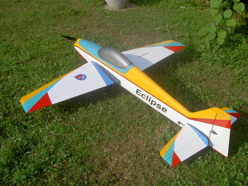

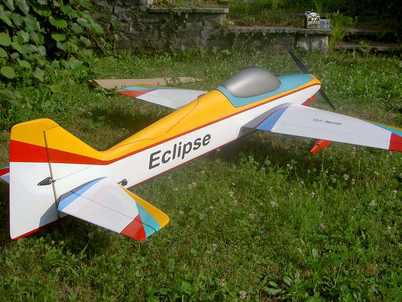

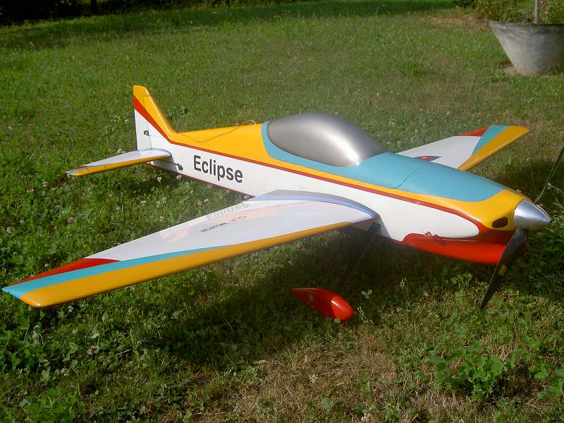

Neo02's Avatar
Joined: Aug 2003
Posts: 289
From: Lugano, SWITZERLAND
SweetPea,
good luck with your rebuild, it is coming out VERY nice!!!
I just finished my Eclipse last week, will set it up this week and plan on flying it next weekend. Here are some pictures of the finished plane.
Regards,
-Fabrizio

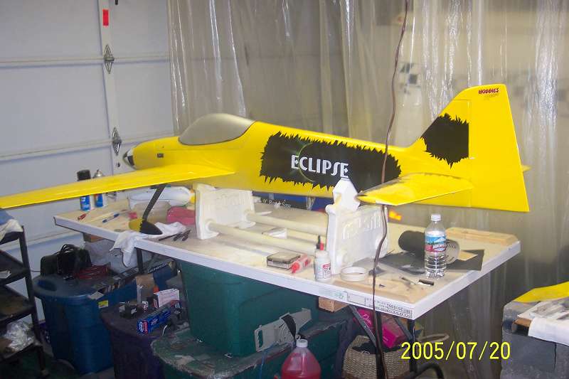

Old 07-21-2005 | 01:24 AM
  #43
My Feedback: (10)
Joined: Oct 2003
Posts: 3,349
From: Lebanon OH
Things left to do......
Left wing---design on top/ Hinge sealed
Right wing---Design on top....Needs checkers top/bottom
Rudder---Design on sides
Gear plate installed
Install Elevator tray (already made)
Everything should be done tomorrow, except the motor. I'll leave that for tomorrow night or Friday
It may fly on Saturday???????
Below are some close ups.....you can just see some of the black paint raised on the first one......there is also lots of sawdust on the fuse also from fixing the wings.....
ID:	299768   Click image for larger version
ID:	299769   Click image for larger version

I know, I know.......the crash happened back in May.....its now Oct.
It almost been 6months.....but 2 TDY's and lots of long work days just haven't given me the time to head to the shop.
Good news though is everything is done except the painting of the chin cowl.
I'm going to finish it this weekend....I might even re-maiden the aircraft on Monday since its a holiday for the Gov't!
