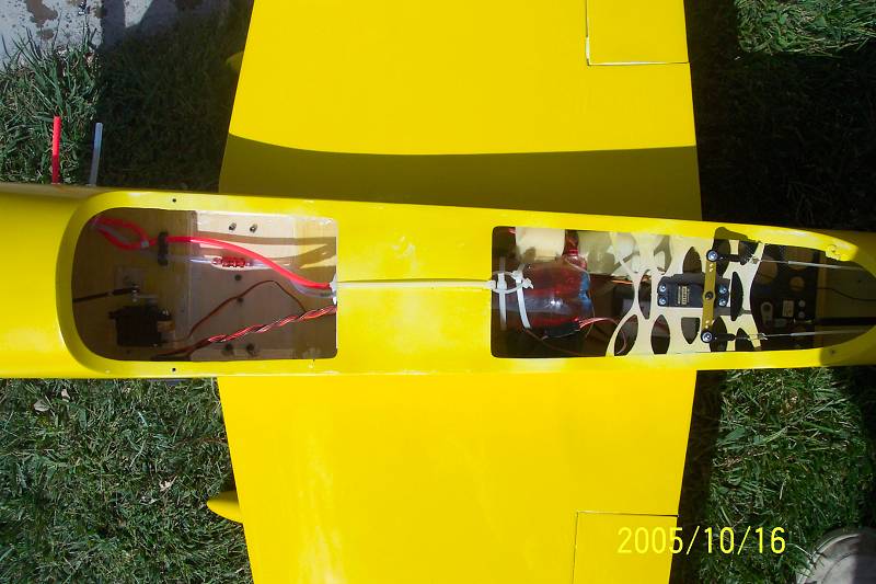

Default RE: Eclipse rebuild and questions
Got the stab incidence set.....I need to get a longer incidence bar for the wings.
Test run the engine at the house.
All appears to be good.
Weight right now was 10.10 lbs
Orginal weight was 10.8lbs.....Not too bad
I still need to add graphics to the top of the wings and some more JR etc graphics on the wings also.

Things have moved real slow!!!!!!!!!!
I got the motor running in the last week and was waiting for time to maiden it.
I've also been working on my new eclipse and Su-26 (though not much).
I took it out to the field today to attempt the re-maiden. Couldn't get things to go well.
-first the motor bolts came out
-next the nose ring bolt came out
-couldn't get the low end to sit right.
took it home and checked the diaphram......it was a little gunked up, so I cleaned it.
gave a manual compression and splash fuel in my face......out of the head.
I took off the black top and low and behold the gasket on the top was mishapen......so I took the new gasket for my 140L and replaced it on the the 140fz......Hope to reattempt the maiden tomorrow.
Old 12-24-2005 | 04:59 PM
  #55
My Feedback: (10)
Joined: Oct 2003
Posts: 3,349
From: Lebanon OH
What a wonderful day..........
First I try to start the plane.........not happening.
Then I realized that I may have put the diaphram cover on backwards.......What a pain to take the engine out of the plane at the field....but this plane was going to fly today if I had to hand launch it and glide it around.
Once that was put on correctly it started right up.......flew wonderful....you'd never known that it was a POS after the crash.
Knife edge needs some coupling, but other than that, just a few clicks of right trim and once I realign the elevators they won't need trim either. (trimming them actually put them straight)
Oh by the way.....its sunny/70/2mile breeze down the runway here in Vegas on Xmas Eve!
