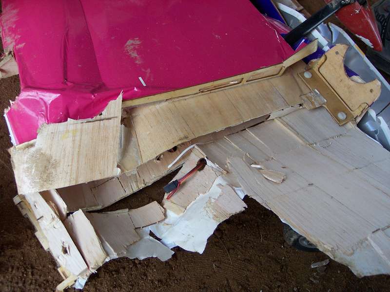

This is urgent message for those of you with the new Icepoint with the one piece wing. I watched the wing come apart at the Andersonville pattern contest. The pilot was in Advanced class doing a 45 degree downline with a negative snap in the middle. Downline was established then came the snap. The wing exploded! It broke right at the joint where the 2 halves were put together. INspection at the crash site the break was very clean, I mean scary clean. The glass cloth used was the thinnest that you can find and not wrapped that wide. The spar structure is all balsa with no ply visible and there was not evidence on any glue at all in the spar joiner box where one would think that a ply spar should have been epoxied into.
For those that have the Icepoint do yourself a favor and take a close look at the middle of your wing. The balsa sheeting is very thin and like I said the glass cloth is very thin and there is only one layer of it. Very easy to seperate the balsa sheeting.
The was another pilot there with a Icepoint who was very interested to see the make up of the wing and was to make immediate repairs to his bird.
The snap was no more violent than any other snap and there was not a lot of speed build up prior to the failure. Luckily all the debree came down within 20 feet and the portion of the wing that failed was very evident.
There were several witnesses to this crash so it was not pilot error putting too much stress on the plane.

He's not kidding. Maybe it was an isolated incident, but it failed utterly in a negative snap. No flutter, just a clean failure.

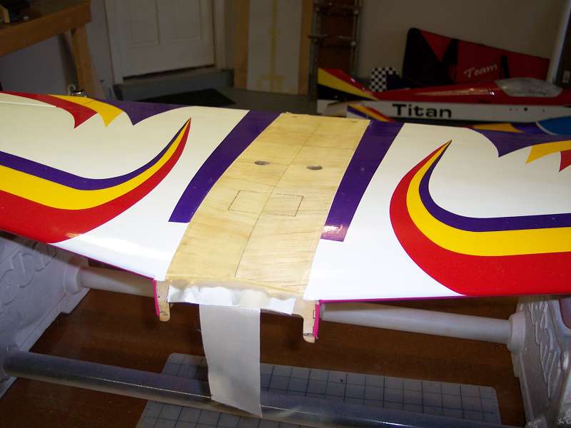

I used two strips of fiberglass cloth - One 2 inches wide and another 4 inches wide. The West Systems epoxy is nice and thin, and I also heated it up slightly with a heat gun to get it to soak down into the existing fiberglass and wood. The roll of TP is there to blot off the excess epoxy.
The trick to getting the "China-Kote" covering off the top is to score it lightly - don't cut thru the fiberglass - along the inside edge of the purple trim pieces. Then heat the covering material with your covering iron set to a high heat setting. It will peel right off. You might as well go over the rest of the wing and seal everything down while you have your iron out and the epoxy is curing anyway. . . .
I was the "other guy" with the Icepoint at the contest. I REALLY enjoy flying this plane, it grooves very well; so fixing the problems I've had with this plane is well worth the effort. Here's what I did this morning in the course of about an hour, let it cure all day. I'm pretty confident that this fix will make the wing very strong - however we won't find out until I move up to Advanced if it is "snap certified" :-)

I support the idea of adding 20 oz FG cloth to the center section. I thought that it was in my review, I know I posted the idea in several places. I did it to mine.
The planes that have extra glass-clothed their center sections are holding up. (I know "Famous last words!")

Well, I've watched Frank do snap after snap after snap after snap with that plane, nothing I would consider "excessive load". He liked the way it flew a lot.
I was also shocked....well, more like disgusted to see what was holding that center section together. I'd put more beef on a 40 size plane! But if the extra glass works, then it's an easy enough fix. I just hope it doesn't move teh failure point out further past the glass....balsa spars are ok if it's done right, but I prefer balsa laminated with carbon. That's a great spar! And bullet proof. But I digress, we're talking about an ARF.
Thanks for the pics Keith! Hopefully that'll keep her in one piece.

Three layers of 80 gram [50 gram if you're brave] glass cloth stepped out at 6, 9, and 13 inches across the centre line should be adequate.
If the wing seat is fashionally wide, make the central layer a little wider than the widest point on the seat, and step out the other layers accordingly.

My intenetion of this thread was to pass on information to present and future Icepoint fliers. There was no intent to slander or in any way say anything derogatory about Ultra-RC. True this situation was to be handled by Frank and Ultra-RC and I commend them for replacing the aircraft, but for those flyers out there that are flying the aircraft the only way they are going to know about a possible weakness is through a forum like this. These are the people that are out in the system day in and day out.
I would think that the manufacturer would like to warn people about a possible problem. Like I stated in the beginning of the post I was the first on the scene and took my time going through the wreckage to find all possible pieces of evidence as to what would have caused this crash to happen.
Again way to go Ultra-RC for taking care of Frank, he's a good flyer and seemed to really be enjoying the aircraft until the unfortunate accident took place. I also think that the measures that the company took to warn people is appropriate and I wish that other companies would follow suit when a problem comes up with their products.
Erik

[quote]Carefully remove the Ultracote covering approximately 3/8” in from your marks towards the center section of the wing. Scuff the exposed constructed area. Apply medium to heavy fiberglass cloth, covering the exposed area, with an epoxy based resin. Repeat the process for the other side of the wing. Allow to cure over night. Trim and sand any excess.
With reference to the new instructions, wouldn't it be safer to extend the cloth further out beyond the wing seat?
If the glass finishes inside ,or at, this line, there's a stress riser there. I've seen a couple of wings fail that way.
