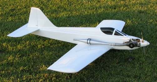

The start of the tip stall on landing was my own fault. I did not do any HIGH slow speed test and was taking it way to slow to start. Just a leason learned to test the slow and high speed charactoristic of the plane a little higher next time. Here is a pic of my baby.
