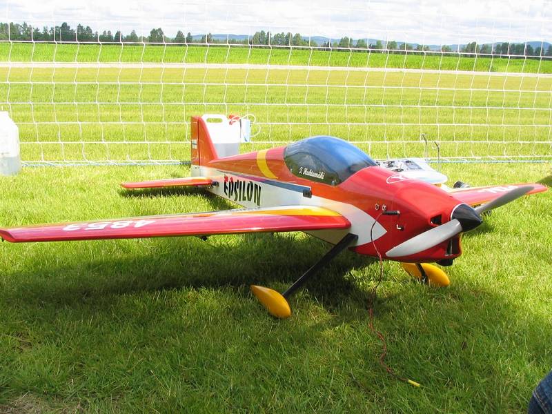

I will be starting a CA Models Epsilon (90 size) muy pronto and need help with the engine. I want to have enough power for 3D with plenty of power to pull out of a torque roll.
I originally was planning on putting in a ST90 but am seriously thinking about a Saito 100 as well. Now that I am looking around I am also considering an OS 1.08.
Will a ST90 or Saito 100 give me plenty of power and unlimited vertical?

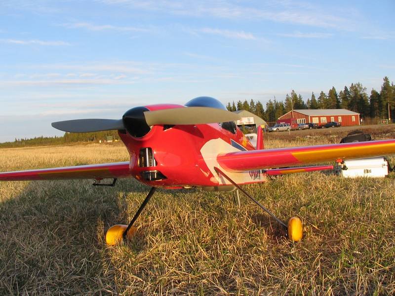

I have YS 110 on mine. I haven't done so much 3D goofing with it, but it sure pulls out of torque roll... I haven't seen Saito 100 in action but what I've read about it here in RCU it does not have enough power for 3D with Epsilon... Marcelo Colombo uses OS91FX on his Epsilon. And as you can see on the Epsilon video it sure has enough power...

I highly recommend you to use a OS 91FX with stock muffler. It has enough power to pull out of a torqueroll, and it's cheaper than 4cycles engines.

MI EPSILON ESTA CON UN ST G90 , ES FANTASTICO, MUCHA FUERZA CON UNA APC 14/6 LOGRAS VERTICAL INDEFINIDO, EL ELEVADOR LO HICE CON DUBRO 500 UNO PARA CADA ELEVADOR CON UN SERVO CENTRAL.
UNO DE LOS ePSILNB QUE FABRIQUE, ME LO PIDIERON CON LOS SERVO ATRAS, PERO EL CG QUEDA MUY ATRAS (+-43%),
CUIDADO CON LA BOTADA DE ALA DE ESTE MODELO!!!!, SI TRATAS DE HACER HARRIER TE DARAS CUENTA.
EL ePSILON ES MUY PERO MUY BUEN AVION, FLOTA COMO SI NO TUVIERA GRAVEDAD,,,,, SI LO TRAES EN UN RALENTI ALTO Y LO PONES DE CUCHILLO EL AVION SIGE VOLANDO COMO SI NADA....(COMO DECIMOS EN CHILE: ES LA RAJA!)
AL MOTOR DALE TODA LA INCLINACION QUE TE PIDA EL COWLING.
